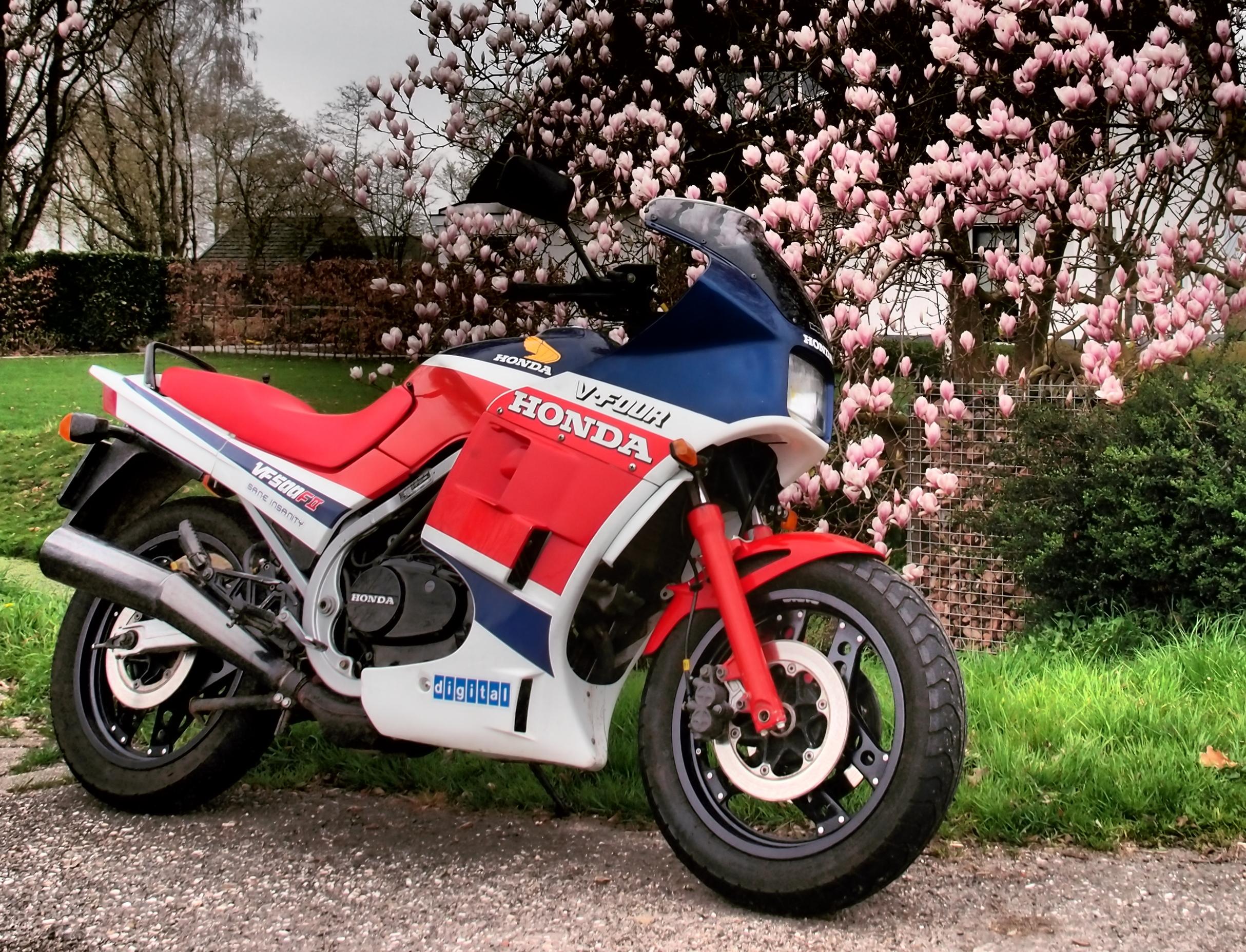

Nowadays you can give just about anything 10 feet and an Instagram filter to make it look good:

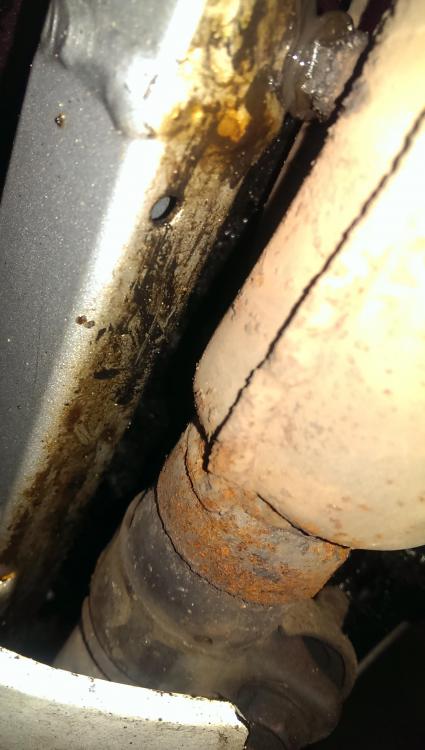

With the carbs out of the way, the real fun begins. One design flaw on these bikes is the unfortunate exclusion of drain holes on the bottom frame rails. What this means is, water that makes its way into the frame collects in the bottom rails and has nowhere to go. Best case, in a hot dry climate, this evaporates without much issue. Most of the time though, it means rust. In colder climes, that water will freeze which bulges the thin steel tubing before/while making it rust.
This frame was badly bulged on the right side, and the decision was made to tear the bike down entirely to address that.

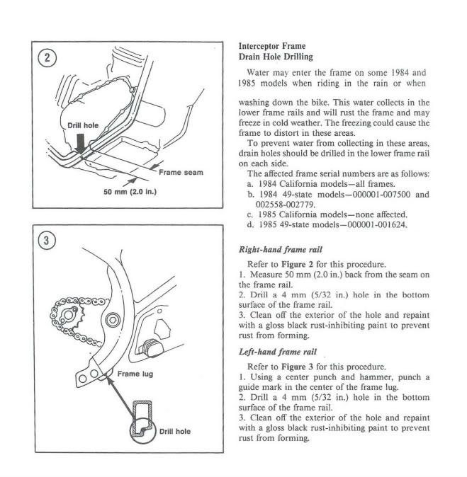

Interesting about the rusted frame. There is a service bulletin about this. My Euro 85 frame has drain holes as does my 86. However there is rust up there too.
Interesting! I didn't realize there was a bulletin for this. The bike falls under category "b", but it's obvious the service was never done.
Also interesting that holes drilled per the bulletin would not have been an adequate fix for this bike - the worst of the damage was at the base of the downtube, not behind the seam. Wonder if this bike was parked on an incline? Or maybe prolonged centerstand use?
I plan to drill (2) 1/8" holes in each tube, 1 fore 1 aft on each side, that should help a lot.
35 minutes ago, jeremyr62 said:
I wonder how the water gets in, in the first place.
On the left side, it can enter through the open top of the removable frame tube section. On the left AND right, water can enter a joint at the end of the upright tube under the seat/rear of tank which has a straight path to the lower tube due to the frame being comprised of a 3d stamping welded in halves vs tubing with closed joints.
In this image, it is the "T" joint seen in the middle, top of pic:
From the outside it appears the frame  and subframe tubes are separate, but they are in fact stamped inner and outer halves, welded together vertically on the fore and aft edge joints. The frame is hollow from the top of the "T" joint, all the way down and back up around to the headstock.
