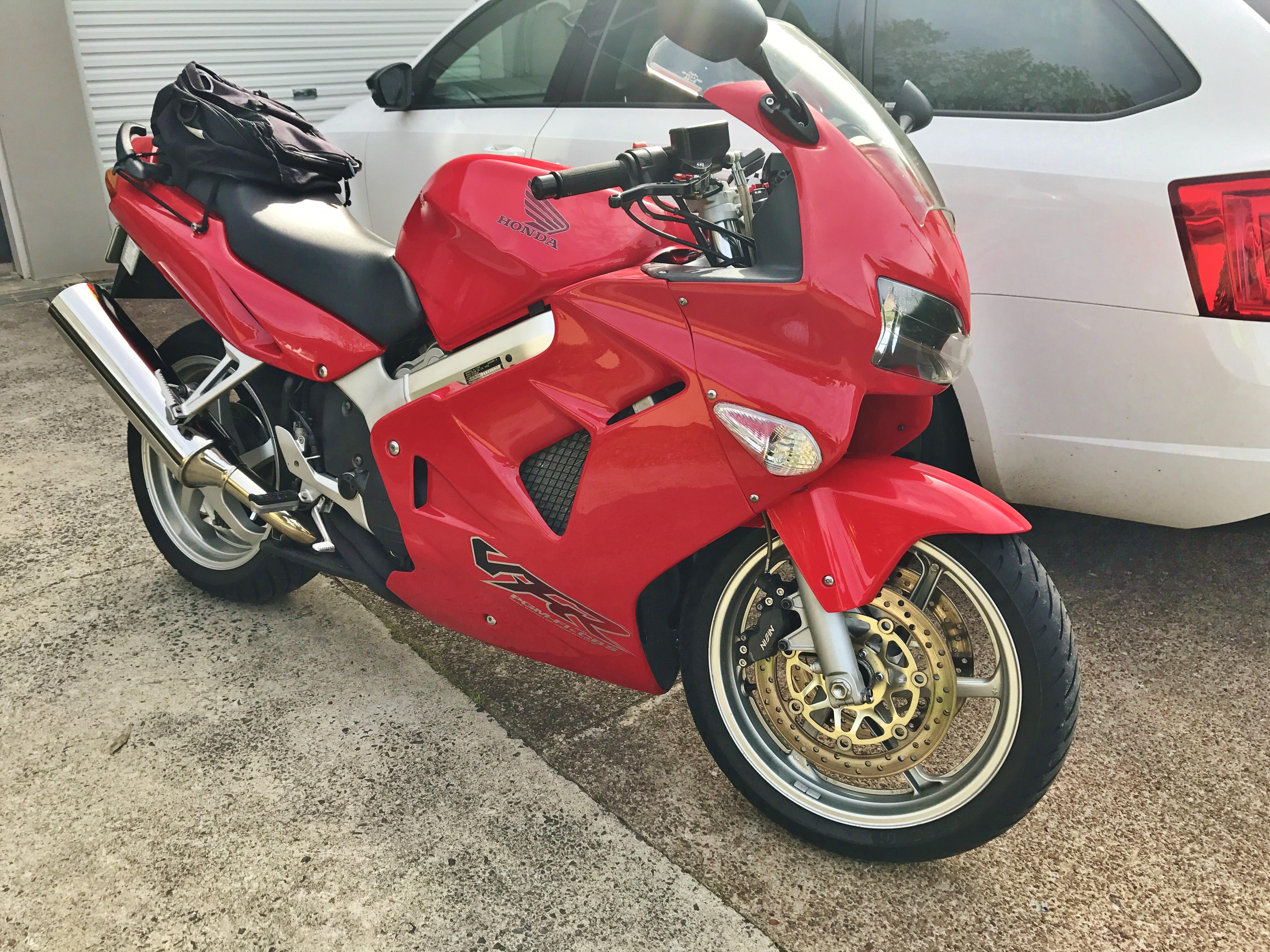

vfrtas Posted June 25, 2018 Posted June 25, 2018 Fitted my DMr fork cartridge kit on Saturday. Went for short 20 km ride first noticed improved slow steering response .more composed thtough bumpy stuff and more stable on cornering happy with that i think that was the last piece of the puzzle 😆 3 Quote
