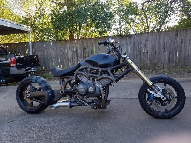

Spraintz Posted April 4, 2016 Posted April 4, 2016 Aight folks, need a lil help here. I have a custom bike project that has been in process, on and off for a few years. Well, the frame is done, engine is mounted, and I'm finally ready to fir ethis sucker up and do some final testing before finishing it up, problem is .....I can't get ole girl to start Through the course of this project, I have gathered the following in hopes that the wiring and startup would be using as close to the stock VFR800 as possible: 98/99 engine stock harness ECU fuel pump bank angle sensor relays only things that are not from a VFR, is the ignition switch, and the engine stop/start switch......but I have wired those to match the 98-01 wiring diagram and continuity I have everything plugged up and ready to test, ignition on, engine kill to ON, start button will spin engine...........but I have no fuel pump prime when engine kill is switched to ON, and obviously no start so far I have checked all of the following per the service manual: fuel pump (functions when directly connected to 12v) engine stop relay fuel cut relay bank angle sensor neutral switch all fuses kick stand switch (jumpered closed) all of that tests fine.....but the fuel cut relay is not "relay-ing"...and the pump is not getting power I have done most of what I can think of but if anybody has some suggestions, it would be much appreciated. Quote

keef Posted April 4, 2016 Posted April 4, 2016 I got no idea. I'd really like that if it didn't have the raked out front end. But it does have plenty of room for a front mount rad now. Nice work. Quote
Spraintz Posted April 4, 2016 Author Posted April 4, 2016 Thanks keef, surprisingly.....it doesn't "feel" all that raked out when sittin on it Quote

Member Contributer 2FAST4U Posted April 5, 2016 Member Contributer Posted April 5, 2016 It looks like the wheels, swing arm, and forks came off an R1. Your bike reminds me of what Honda ought to build: a modern-day V65 Magna. For the life of me, I can't understand what possessed them into building bikes like the NM4 or CTX700N instead. Quote

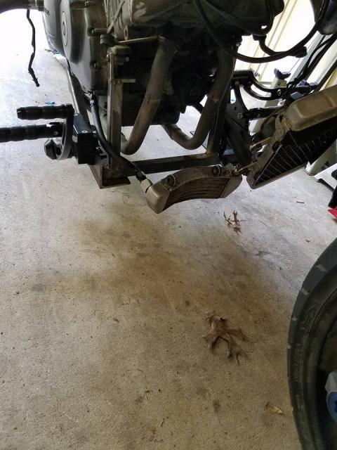

The Phantom Posted April 5, 2016 Posted April 5, 2016 Wild looking bike. Good on you for taking a different path with your build! There's been some abominations over the years where people have tried to take VF/VFRs down this path, but yours works! Post some more pics please... what's the set-up for cooling? Have you tested the fuel pump itself? Quote
Spraintz Posted April 5, 2016 Author Posted April 5, 2016 (edited) Thanks!! Yes, fuel pump functions when connect directly to 12v, fuel cut relay tests good......but pump does not come on when engine kill is switched to ON Went with a Ducati S4R oil cooler, just have one of the VFR radiatoir dangling at the moment.....but I'll be doing a front radiator, once I find the one with the hose connections just where I want. but all that kinda stuff is easy......gotta get it fired up first Edited April 5, 2016 by Spraintz Quote

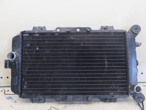

The Phantom Posted April 6, 2016 Posted April 6, 2016 Went with a Ducati S4R oil cooler, just have one of the VFR radiatoir dangling at the moment.....but I'll be doing a front radiator, once I find the one with the hose connections just where I want. I posted 4th Gen radiator dimensions and pics in this topic: http://www.vfrdiscussion.com/forum/index.php/topic/82913-radiator-sizes/ Quote
Spraintz Posted April 6, 2016 Author Posted April 6, 2016 an older Vulcan radiator has the hose connections right about where I would want em, upper near center coming back........and lower on the left corner, also coming back. But again....kinda doesn't matter if I can't get her fired up lol Quote
