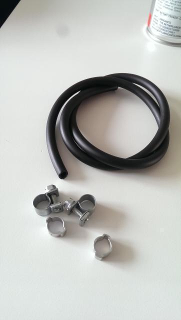

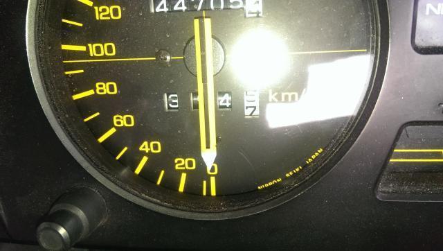

Member Contributer Dutchy Posted June 19, 2015 Author Member Contributer Posted June 19, 2015 Well, Keny found out the hard way (on the The Bridge between Denmark and Sweden) that the vacuum hose from carburetor to petcock was leaking, so I checked mine. Yep on its last legs so.......................... It rained for most of the day but there was a break in the weather so time to put the odometer to And there was even time for a wash and wax job! Life is good.. 1 Quote

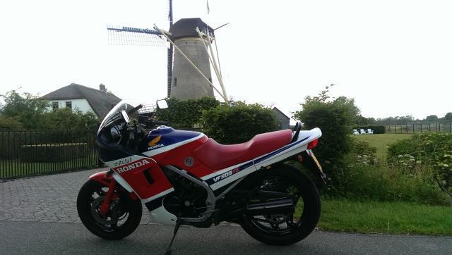

Member Contributer Dutchy Posted June 21, 2015 Author Member Contributer Posted June 21, 2015 On 6/18/2015 at 0:27 AM, RollinAgain said: Not one damn Windmill in the video....what a waste of time. Sorted!!! 2 Quote

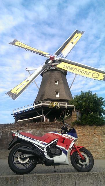

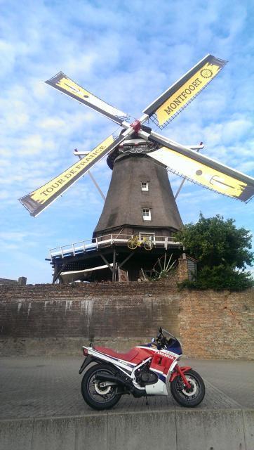

Member Contributer Dutchy Posted June 25, 2015 Author Member Contributer Posted June 25, 2015 This year, Le Tour de France will start from Utrecht and will pass through my "backyard". Along the route, preparations are underway Need to do some work on/underneath the tank so decided to see how far she'd run until she stop.... Reserve came on around 220km, and came to a complete stop at 314km Had s small fuel canister with me so rode to the nearest station 1 Quote

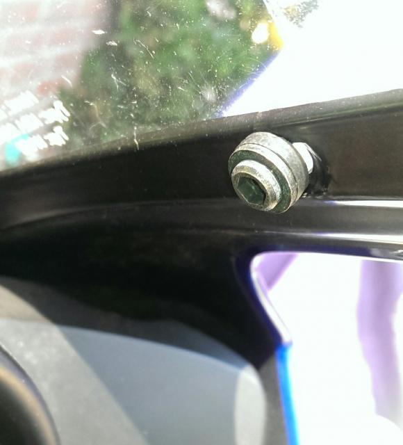

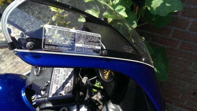

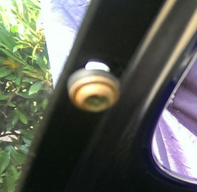

Member Contributer Dutchy Posted July 3, 2015 Author Member Contributer Posted July 3, 2015 The fairing nuts were grotty and I fitted an aftermarket screen that needed a finishing touch. Quote
