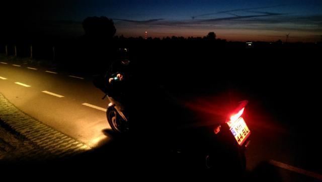

One thing I learned last night is that with the rear shock +3mm in length, I need to adjust the headlight aim up a bit........
That double piston rear brake caliper sure grips fine, to the point of locking up the rear (or I should slow down a bit at night???)
Thats a importan thing to do, as a to low adjusted headlight gives a short light range, spechally on low beam.
I recall the VF500 headlight had a supricing good light pattern adjsted correct, did ride 6 hours+ in the dark going north in Sweden early May.
Ok could be a bit brighter, but still good, far better than I tought it would be.

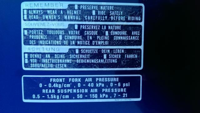

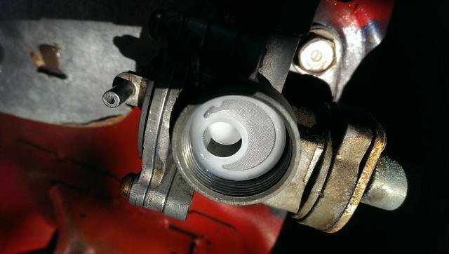

Today she got a "cup fuel filter". As per the fiche, 1986 model no longer had them but I want one!
There is no room/space to fit an inline filter under the tIMAG28061.jpgank.
I had also sourced new tank decals on Ebay (plug here for Ebay seller hielorojo who gave excellent service and his prices much better than a UK seller -with silly shipping charges-) since both had faded.
Armed with youtube knowledge, heat gun, plastic scraper, WD40, kerosine, lampenolie I started removing them.
Well, that proved not as easy but he who perseveres, wins!
Ok not quite... the old warning decals had what appeared air bubbles but upon removing the sticker, it looks like the sticker got somehow "etched" in the paint. After trying every trick I very very carefully scraped the surface and the paint came off.
So I ended up degreasing the surface and put the new decals on.
It looks much much better than before, but not "factory new". But then again, The Netherlands is no Japan!labels.jpg

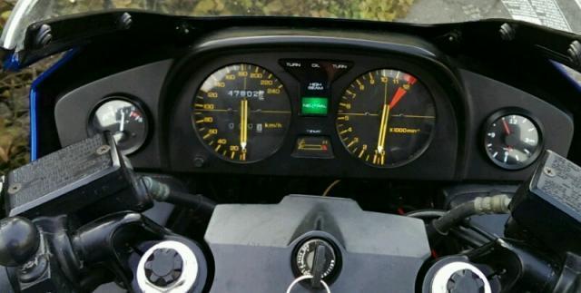

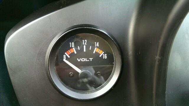

Ok, no turning back now......
Tadaaa!!!!!
Nice work Dutchy.. Allthough I have a different mindset... All I need is an oil light and a RPM dial (and a really big RPM dial if possible).
But I like the style.. Was afraid it wouldn't fit the space, Think there is marginal any room left between the cowl and the back of the dials, but I am glad it worked out..
How are the steering stem bearings holding out.. Still no play, or did you have to readjust them ??

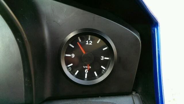

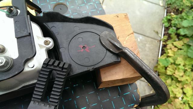

Inside of dashboard has 57mm diameter circles so I had to carefully allign the 52mm cuts...IMAG2841.jpg
Nice. I like it. And good of you to make sure Redslut earns her money...
