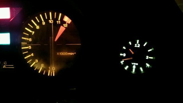

Member Contributer Dutchy Posted October 3, 2015 Author Member Contributer Posted October 3, 2015 Darkness falls across the land..... Thank you Keny Thank you to the mule! Quote
keny Posted October 4, 2015 Posted October 4, 2015 So its winter already in Holland? Looking great and now you know the time as you ride. Quote
Member Contributer Dutchy Posted October 4, 2015 Author Member Contributer Posted October 4, 2015 Yeah Keny, I had this down for a winter evening..... messed up fitting the Stebel, see electrical post.. Quote

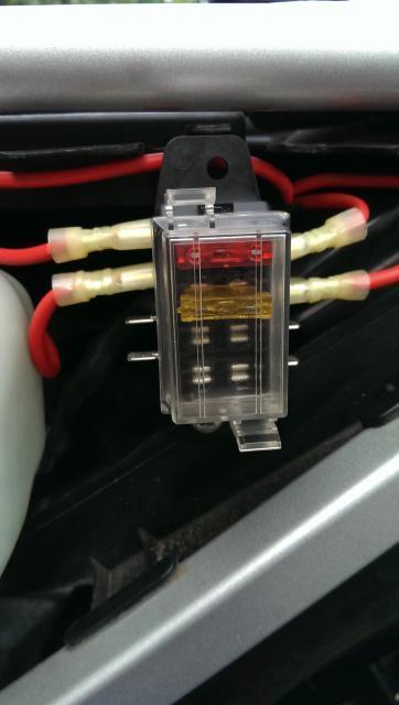

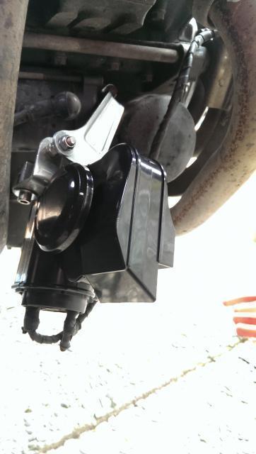

Member Contributer Dutchy Posted October 6, 2015 Author Member Contributer Posted October 6, 2015 The claxon and extra meters routed via a fuse box Hidden from view by the lower cowl, it shoudl be ok in this spot. One of the FIAMMs on redslut is close to the header too with no ill effect. Will keep an eye on it though, may add another bracket mounting point. Quote

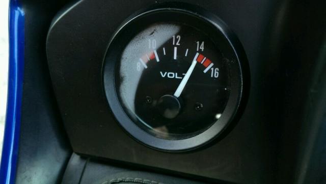

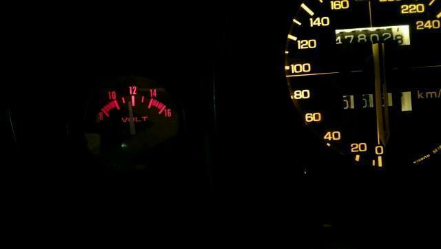

Member Contributer Dutchy Posted October 10, 2015 Author Member Contributer Posted October 10, 2015 Hhhmmmm was greeted by this in the morning and it stayed there all day..... It did not spoil my day :-) Gimme shelter... Quote
TheDutchy Posted October 10, 2015 Posted October 10, 2015 (edited) Check the battery fluid levels.. If the battery gets a bit low on level, it might get up in that range.. Not to worry, not as long it gets in the 14.5+ range.. Edited October 10, 2015 by TheDutchy Quote
Member Contributer Dutchy Posted October 10, 2015 Author Member Contributer Posted October 10, 2015 Oh I am not worried with the voltage, that idles at 12+ with lights on and heated gloves. The 14is at 2000rpm and upIt is the moisture inside that is a bit annoying.... :-)U missed a nice ride.... Quote

Member Contributer Dutchy Posted October 10, 2015 Author Member Contributer Posted October 10, 2015 Ah yes my bad, front is a 15T... Had a good 240km run indeed! I will remove the voltage gauge and see if I can dry-out the moisture inside.. It will be even sunnier tomorrow, but with 11C it will feel more nippy..... Not as nippy as southern Sweden at 03:00 wearing summer gloves..... Quote
