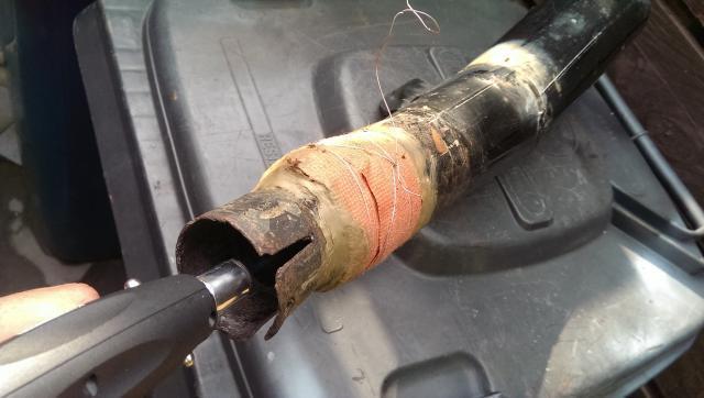

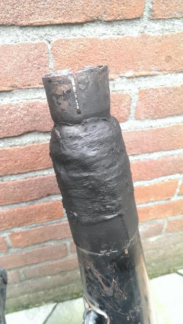

Member Contributer Dutchy Posted August 19, 2015 Author Member Contributer Posted August 19, 2015 If all goes as planned, the cavalry will arrive to save the day. In the mean time, 10 euros worth of Holts Gun Gum tape and paste filled the gap. Yes that is my creme brulee torch doubling up to warm the muffler :-) Quote

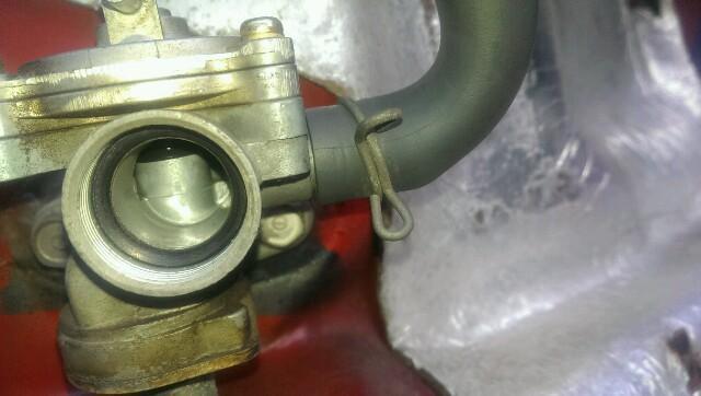

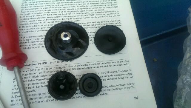

Member Contributer Dutchy Posted September 3, 2015 Author Member Contributer Posted September 3, 2015 Inspecting the fuel tap, I realised that fitting the vacuum hose to the little fuel drain is not clever.... It also found that the repair kit "fits vf500f2" will not. It is way smaller.. The new smaller diaphram is very flat whereas the oem one is is a "hat" shape. No holes or tears. So is this one eol or is this normal? According to the manual, there should be a small siff/filter inside but it is not there. There was a tiny bit of crap inside the cap that is screwed on at the bottom. Worth getting one or adding an inline fuel filter? Quote
timmythecop Posted September 3, 2015 Posted September 3, 2015 The petcock is the achilles heel on this bike. There us a bix box headed your way with a rebuildable one in it. Quote

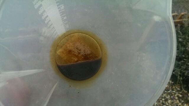

Member Contributer Dutchy Posted September 3, 2015 Author Member Contributer Posted September 3, 2015 On 9/3/2015 at 7:21 AM, keny said: the one whit a black cap is engine breather/waste pipe, and yes you can, as should let the water/oil mix out of there, just yurn the blug whit a canister below. Got some 15cc of what had the consistency of ketjap manis, but did not smell like it :-) On 9/3/2015 at 11:46 AM, timmythecop said: The petcock is the achilles heel on this bike. There us a bix box headed your way with a rebuildable one in it. Cheers Timmay! Can we all keep our fingers crossed that Dutch Customs will not go berserk on import duties??? :-) Quote
keny Posted September 3, 2015 Posted September 3, 2015 Got some 15cc of what had the consistency of ketjap manis, but did not smell like it :-) About half the amount I had in mine....but same stuff Quote
Member Contributer InvisibleCities Posted September 3, 2015 Member Contributer Posted September 3, 2015 Hope this is of some help with the petcock - the '86 is different (larger) than the '84/'85, here in the US, so not sure these will work for you. Good luck! Quote
Member Contributer Dutchy Posted September 3, 2015 Author Member Contributer Posted September 3, 2015 Super! good to see that part #2 in your pics is "hat" shaped, just like mine. Quote

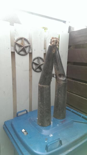

Member Contributer Dutchy Posted September 3, 2015 Author Member Contributer Posted September 3, 2015 Reasons to be cheerful........part 1 They will clean up nicely No customs bill attached! Quote
keny Posted September 4, 2015 Posted September 4, 2015 (edited) For the exaust, I think cocacola will be your friend to make them look nice, as too mutch polishing will make the black crome less black... Edited September 4, 2015 by keny Quote
Member Contributer Dutchy Posted September 4, 2015 Author Member Contributer Posted September 4, 2015 Submerge them in it? Quote
