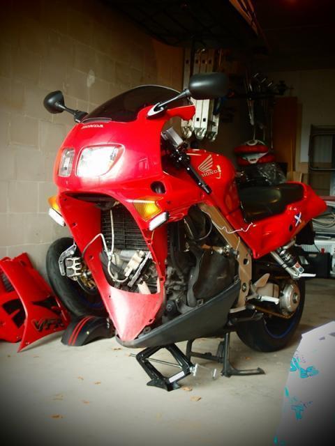

Member Contributer Rice Posted November 27, 2013 Member Contributer Posted November 27, 2013 shark.jpg Quote
