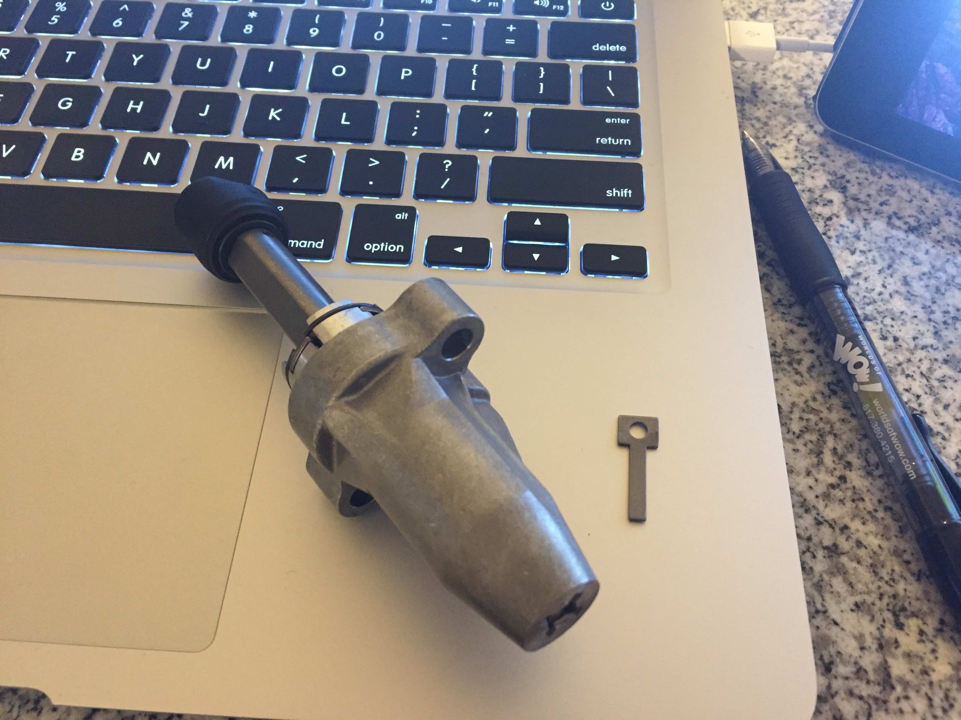

Phongeer Posted December 3, 2016 Posted December 3, 2016 I took the key out of my new CCT, the shaft extended and now I don't know what to do...  Going to change my front CCT tomorrow so I'm reviewing this excellent thread to get ready. Gathering tools, found the purchased CCT and while looking at it, well, I uh removed the key. And the shaft extended. And now I can't figure out how to retract it. I'm assuming it should be retracted when replacing?  Quote
Phongeer Posted December 5, 2016 Posted December 5, 2016 I followed the tutorial and was able to change my CCT. No more knocking = I'm not embarrassed to ride again! Thanks for the write up. 2 Quote

Member Contributer whiteknuckles Posted July 27, 2017 Member Contributer Posted July 27, 2017 Opening this up for another question. At the start of this thread, there is mention of a "key" above and below the 7th photo. I know there are two bolts on either side of the CCT, and there appears to be a bolt at the center of the CCT that is also removed. Are the pliers being used to grasp the key while the CCT is pulled from the case to prevent the shaft of the CCT from extending ?  If so, do you apply a pulling force to the pliers, or do you use the pliers to keep the key in place while you remove the CCT? Quote
