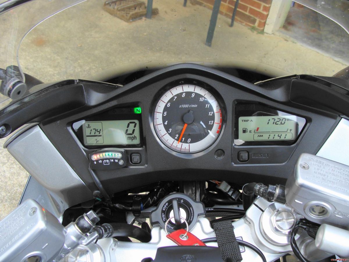

Forum CEO HispanicSlammer Posted October 21, 2009 Forum CEO Posted October 21, 2009 Well I found it helps to use a simple volt monitor, I have a led model - one led that blinks green, solid green, yellow, red, and blinks red for low voltage. It helps to know when your bike needs troubleshooting and maintence. You get very used to the solid dull green color of a good charge, then when it changes color like when its ideling or the engine is off you notice it right away. It gets your attention when it changes color the intensity goes up and you have time to react to it, find a place to pull into or turn around and head home. http://www.signaldynamics.com/products/Modules/HUVM.asp Quote

wasmeneh Posted October 21, 2009 Posted October 21, 2009 I purchased and installed the same one Hispanic Slammer talks about. I love it. I attached the led light to my Garmin mount. Being stranded once is enough....great peace of mind. Mike Quote
