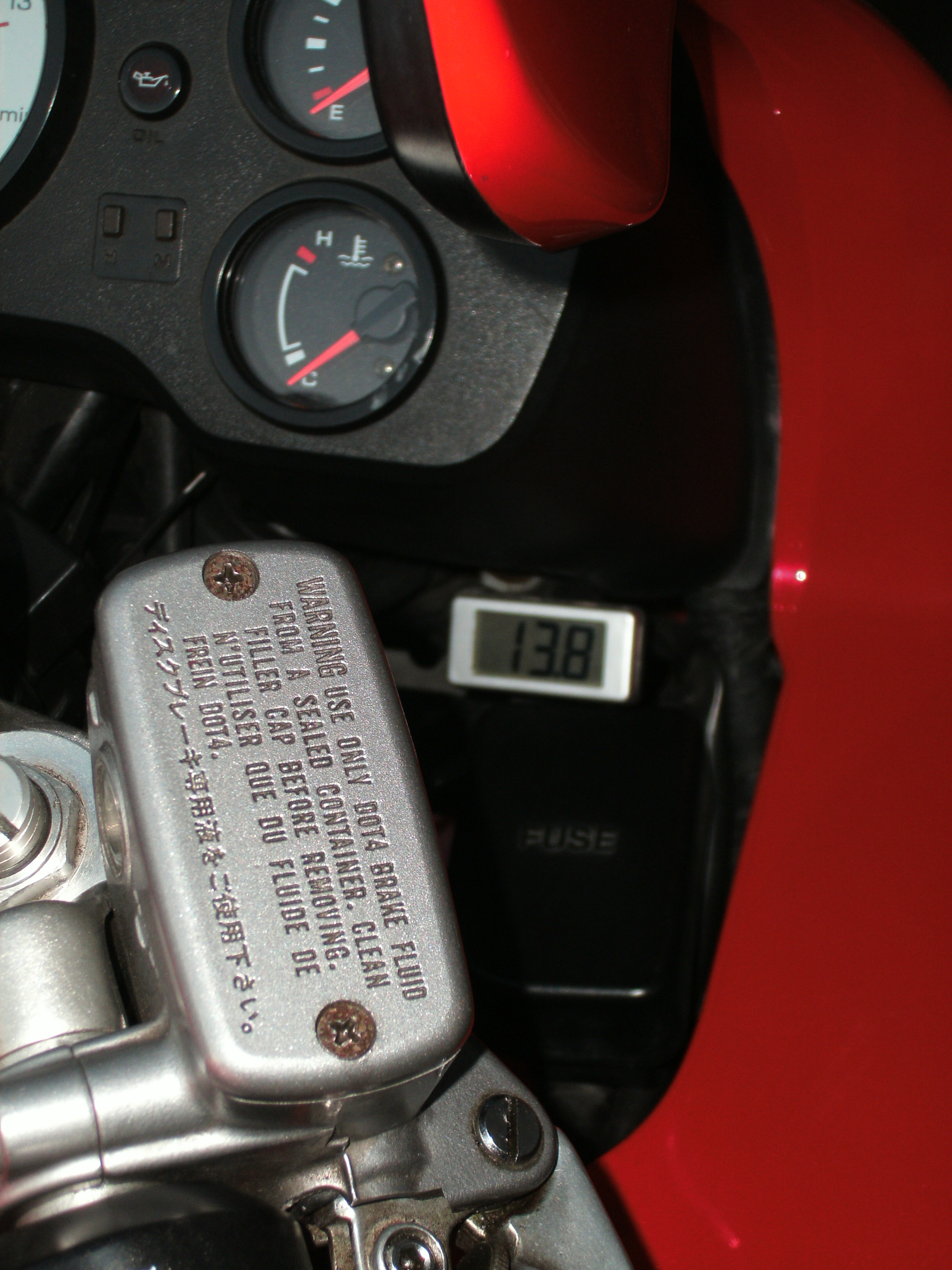

I have a Signal Dynamics Voltmeter too but got a thing for keeping a stock appearance. Since my VFR isn't ABS there was an empty space on the right idiot bar so I got a little...creative.14TheGOAL.jpg
Edited by RDT64
You got so creative that for the life of me I can't see it. Is it hiding in plain site, or should I get my eyes checked?
