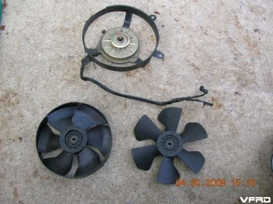

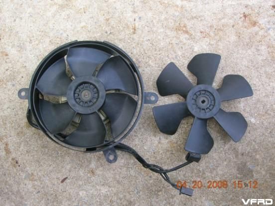

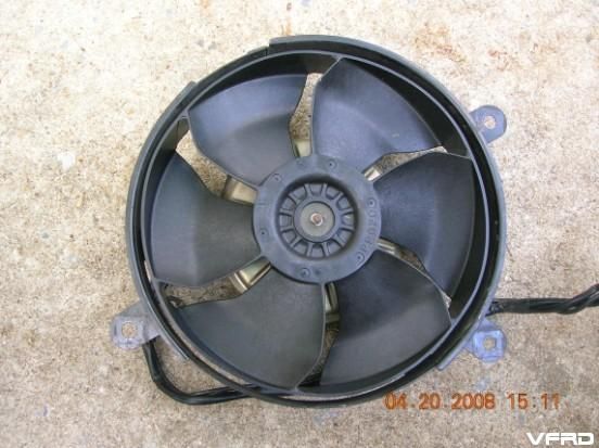

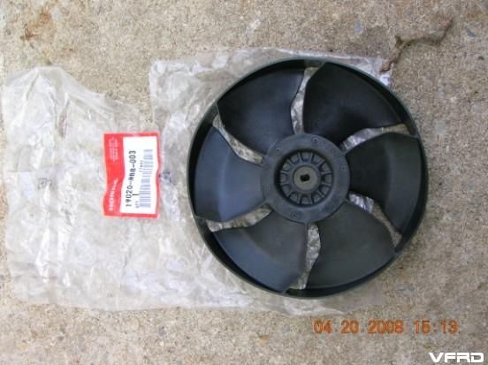

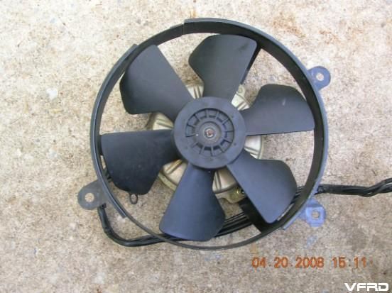

JES_VFR Posted April 21, 2008 Posted April 21, 2008 I was, we hit 85 here this week and the VFR started getting mighty toasty in stop and go traffic. I have bitched before about the stupidity of Honda's puller fan design on the left side rad. For me the scenario is something like this. If I'm cruising around at more than 20 mph, my water temp is 195 or less. As soon as I get into stop and go driving, the temperature will begin to creep up. It will go up pretty darn fast if I'm stuck behind one of the city buses or next to delivery truck where you can just feel the heat pouring off the other vehicle. Now once it hits 225 the fan switches on and the fun begins. The temperature does not go down, instead it will continue to creep up, In fact just the other day it went all the way to 230 before the light changed and I turned onto a side street so I could get out of traffic and move some air through. As soon as I get moving more than 25 mph and can keep moving that fast, the temp will come down. I have repeatedly checked that the fan is turning at full speed and even stopped to feel the heat being blown out the front of the bike. So while I was on lunch Thursday, I wandered back into the Honda parts aisle to the section where we have cooling fans. I had a halfhearted hope that I could score a replacement fan for a vtr1000f. I was basing this choice on several facts. One the fans share the same locking nut on the shaft, they were specified as the same diameter, the motors are supposedly the same size and spin in the same direction. Well we had one and since it was just sitting there on the shelf I bought it to put my own eyeball on the problem. I had nothing really important that I could do anything with this afternoon,.. So I broke out the tools to see how hard could it be? Well here are the pictures. Here is the original stock Honda fan with the locknut removed from the shaft. DSCN1189.jpg Here are the two blades side by side with the motor above DSCN1188.jpg Here is the VTR fan blade slid on the shaft waiting for me to smear some paste locktite on the shaft threads DSCN1190.jpg And another shot of the new fan inside the shroud and the old blade next to it. You can clearly see here that the VTR fan blades move the air in the opposite direction of the VFR fan. DSCN1191.jpg On pair of photos with the Honda packaging in the background so you can see and get the part number. DSCN1193.jpg DSCN1192.jpg I yanked out the pair system while I was in there and installed the block off plates from our own Toro1. I don't know about the rest of you, but the inside of the covers and the hoses was coated with a black oily film. I bet that was not good for power or emissions either! Anyway I put it all back together, then started the bike and pretty much just let it sit until it was warm enough to engage the fan. Even in the still air of the garage, the 225 temp immediately started to drop and in minutes it cooled off enough that the fan switched back off. Yeah the heat blowing back from the left side was noticeable, but it was not excessive nor did it last very long. I let it cycle like that a couple of times while I did things like lube the chain, adjust the throttle cable, inspect the welds on the sideracks, etc. After three more cycles, I shut it off and declared it a sound victory. IMO, this is how Honda should have done it all along. Quote

Darth Bling Posted April 22, 2008 Posted April 22, 2008 I was, we hit 85 here this week and the VFR started getting mighty toasty in stop and go traffic. I have bitched before about the stupidity of Honda's puller fan design on the left side rad.... DSCN1192.jpg ...IMO, this is how Honda should have done it all along. Excellent post Jes. I'm going to have to have to perform this swap myself. :fing02: I've found that the VFR's cooling system works very well when you're stopped. But, if you're riding around between 10-20 mph, the radiator fan loses all of its efficiency since it has to push against the wind. But, once you get up to highway speeds, the wind easily overpowers the fan and the bike cools down. When I was in Billings, MT last summer, I was putting around town at about 15 mph. It was about 95°F out and I was currently running water with waterwetter (good stuff!). Well, my bike overheated, bad. I was seeing temperatures over 250°F and my VFR was puking radiator fluid everywhere. When I got on the interstate to head back to my hotel room, the temperature of the bike was hovering around 238°F as I was running an easy 85 mph. I refilled the bike later than night after it cooled down and i had lost 1/2 of my radiator fluid. There were a bunch of Goldwings there too and their bike's have the same stupid radiator setup that the VFR has too, and they were all having overheating problems just like me. Stupid Honda.... Quote

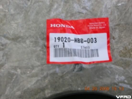

JES_VFR Posted April 23, 2008 Author Posted April 23, 2008 So the part number in the photo is for the reversed helix right?? Off the VTR?? That is the correct part number for a US market VTR1000f. The new fan is louder when running than the old one. I don't know if that is because its moving the air out or if the blades just are a different design. Did get into a little bit of traffic tonight coming home (I was kind of stuck in the right lane with a rear tire going down from a nail :fing02: :fing02: :beer: )!!!! Anyway at about the third light behind the morons who have nowhere better to drive their smoking hulks of 1960's GM crap, I hear the fan kick on. The temp was 224 flicking to 225, where it sat for a minute, then it started to go down. A couple of minutes later, the temp is hovering at 219 and the light changes, as soon as I get moving, I'm clear of the GM heatmobile and the temp drops to 200, then 196. Before it would have climbed to 230 and hung there for a couple of miles. Quote

Member Contributer y2kvfr Posted April 23, 2008 Member Contributer Posted April 23, 2008 I was, we hit 85 here this week and the VFR started getting mighty toasty in stop and go traffic. I have bitched before about the stupidity of Honda's puller fan design on the left side rad.... DSCN1192.jpg ...IMO, this is how Honda should have done it all along. Excellent post Jes. I'm going to have to have to perform this swap myself. :fing02: I've found that the VFR's cooling system works very well when you're stopped. But, if you're riding around between 10-20 mph, the radiator fan loses all of its efficiency since it has to push against the wind. But, once you get up to highway speeds, the wind easily overpowers the fan and the bike cools down. Although I've never had my '00 puke all over the place, I do think the design is flawed. I see the same results as Darth for speeds below 30mph. The temp keeps rising unless I either STOP or wick it up to 45+. John --- definitely keep us posted. I think it may be a winner of a swap! -t Quote
