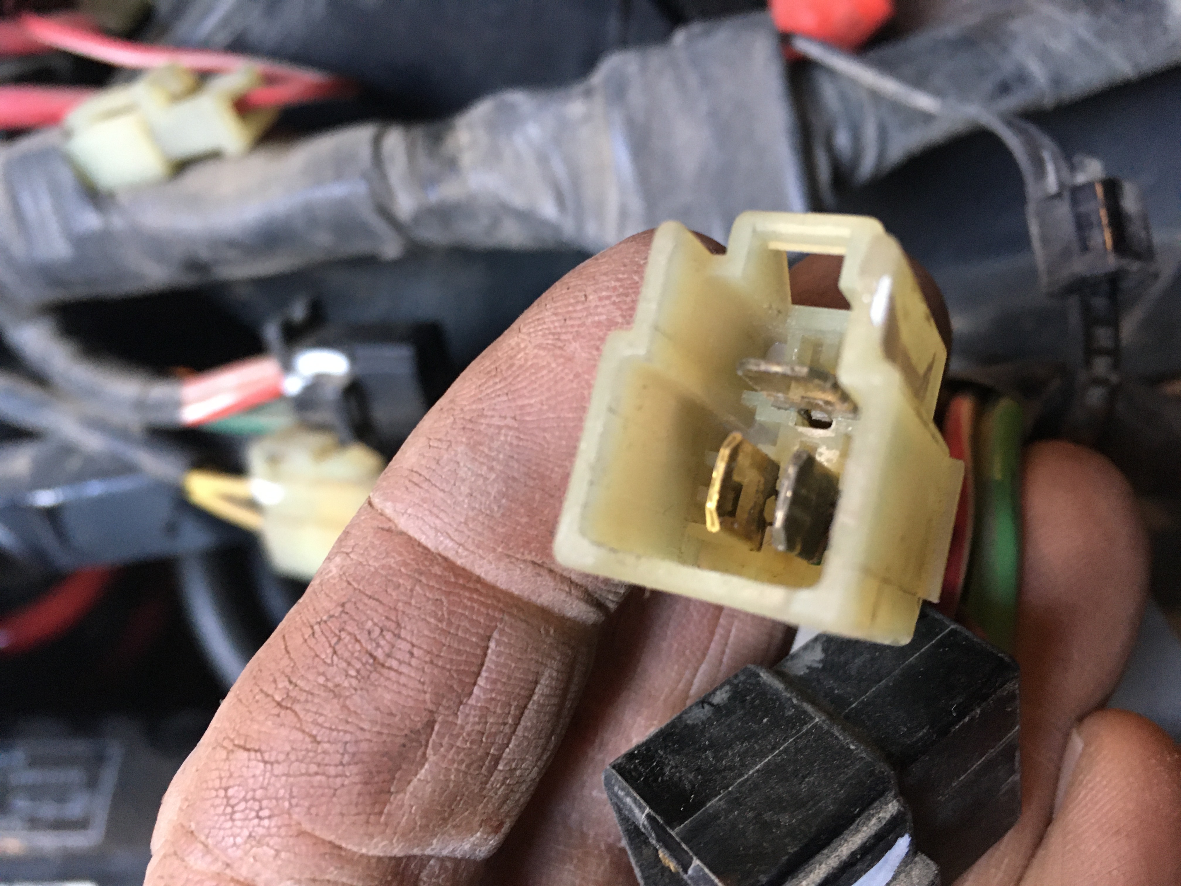

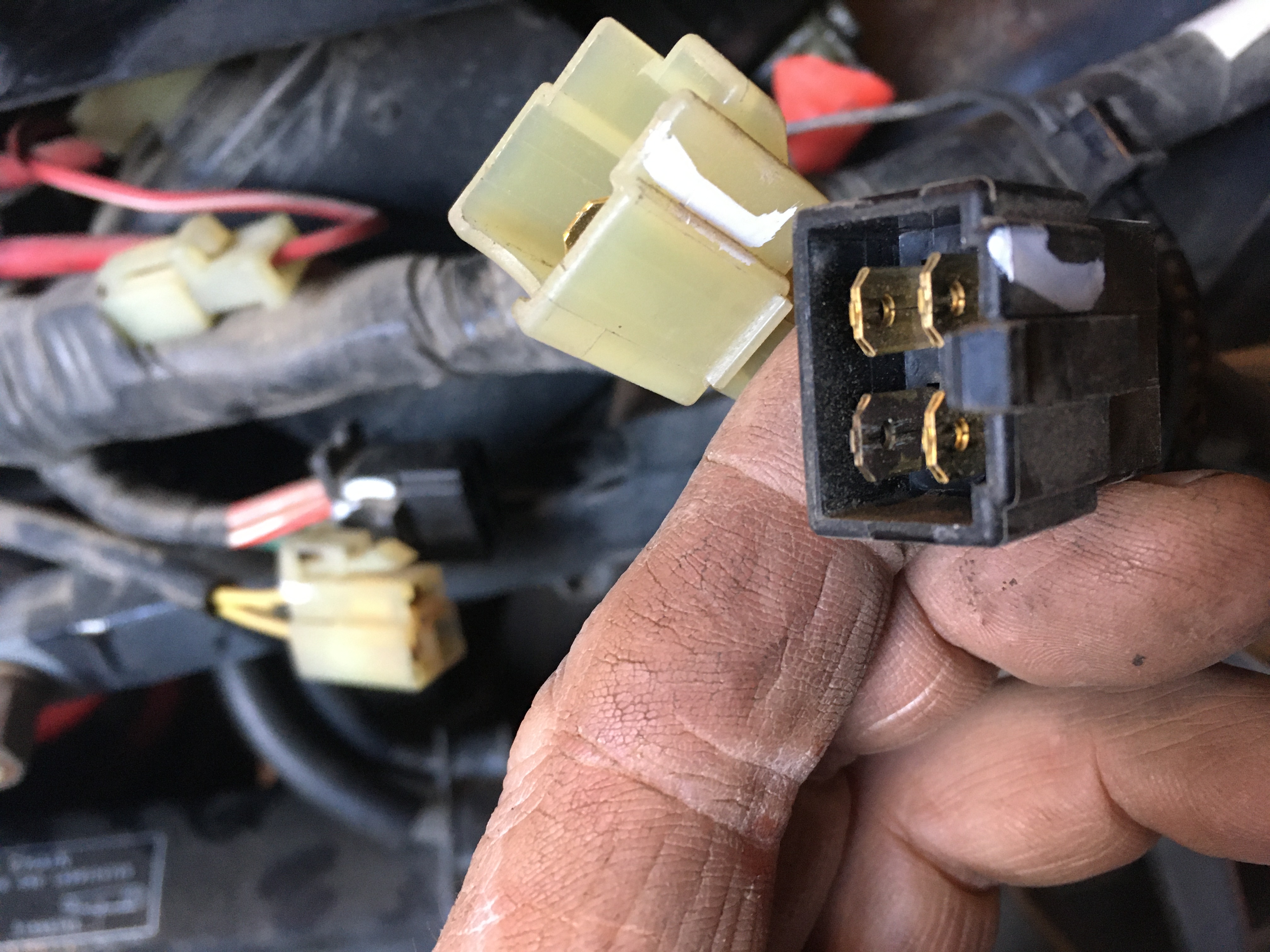

Looks like I have some extra work to do as well, I had a quick look at the stator wires etc. and noticed they were dam warm on the final warm up for a winter oil/filter change.
I pulled the connectors apart and I would say there is signs of heat damage.

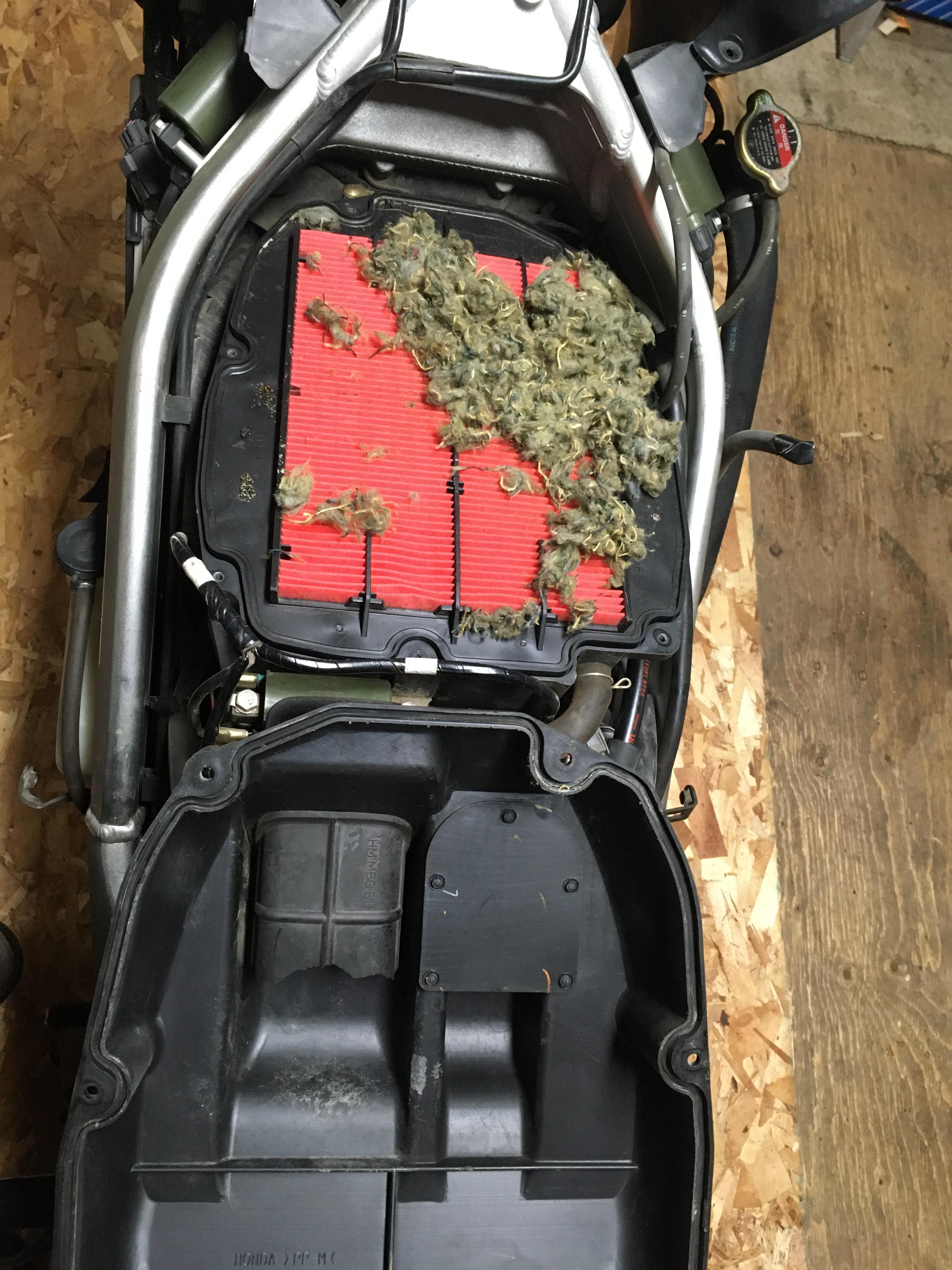

And lastly I came across something I have heard of many times but nothing seen, a mouse nest on top of the air filter, I have to surmise that this nest was in the air box out west and hitched a ride here The little bugger was even chewing on the inside of the air box
