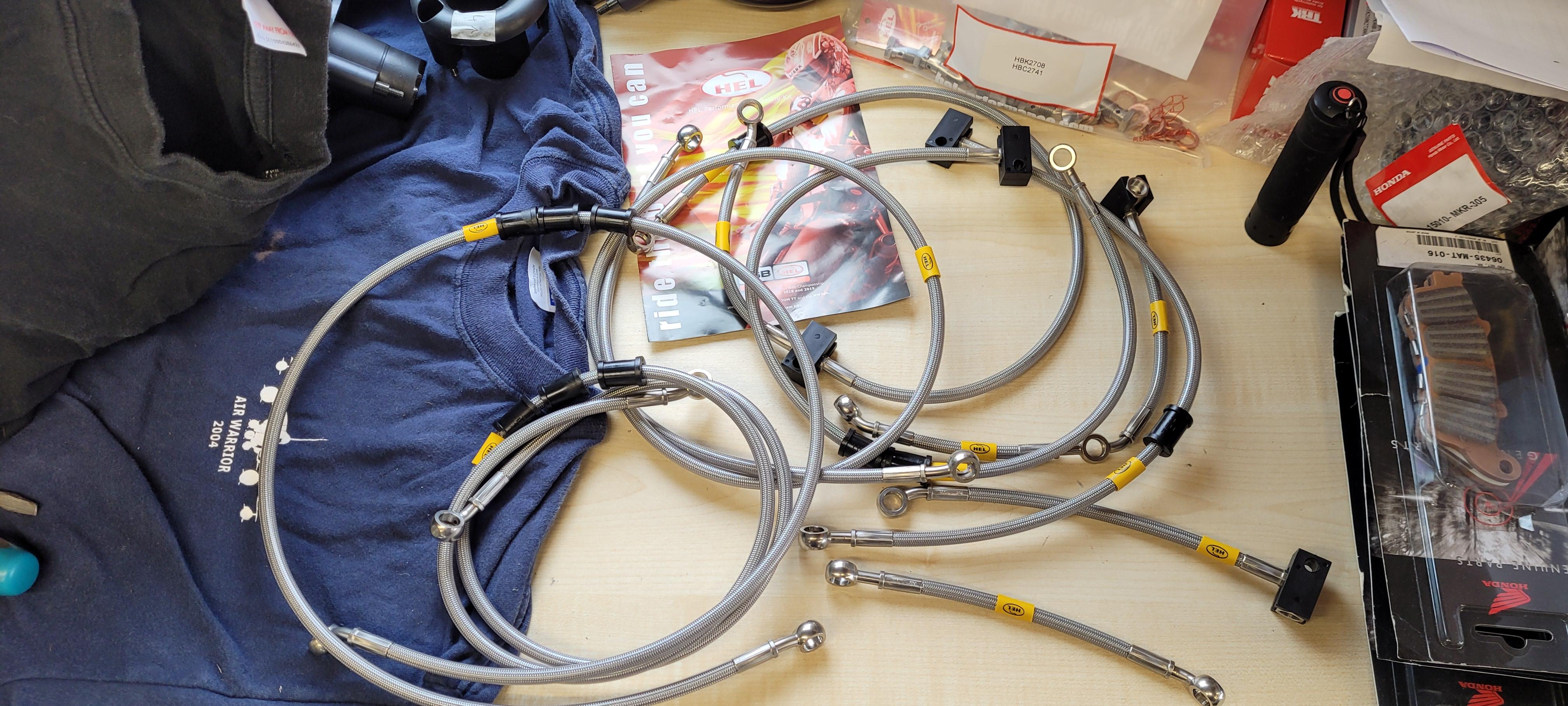

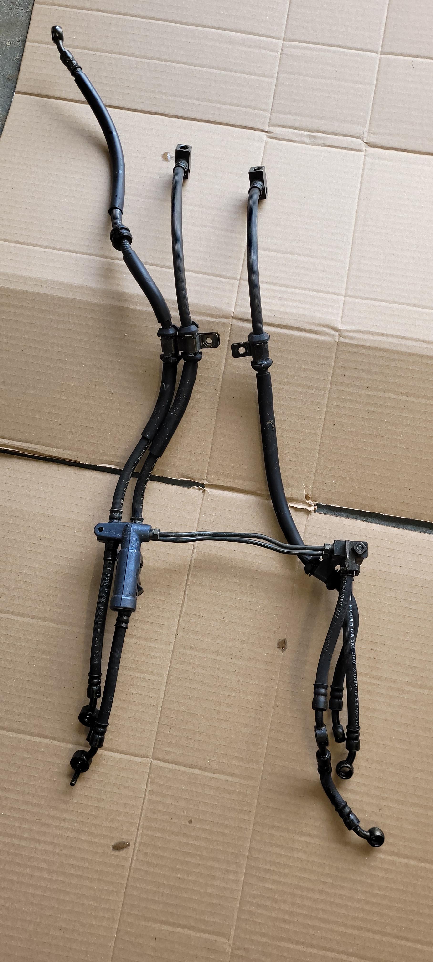

Here's the HEL kit. Sadly no instructions or markings but it should be easy to tell which goes where. Currently struggling to get the pipes free that run across between the front calipers.

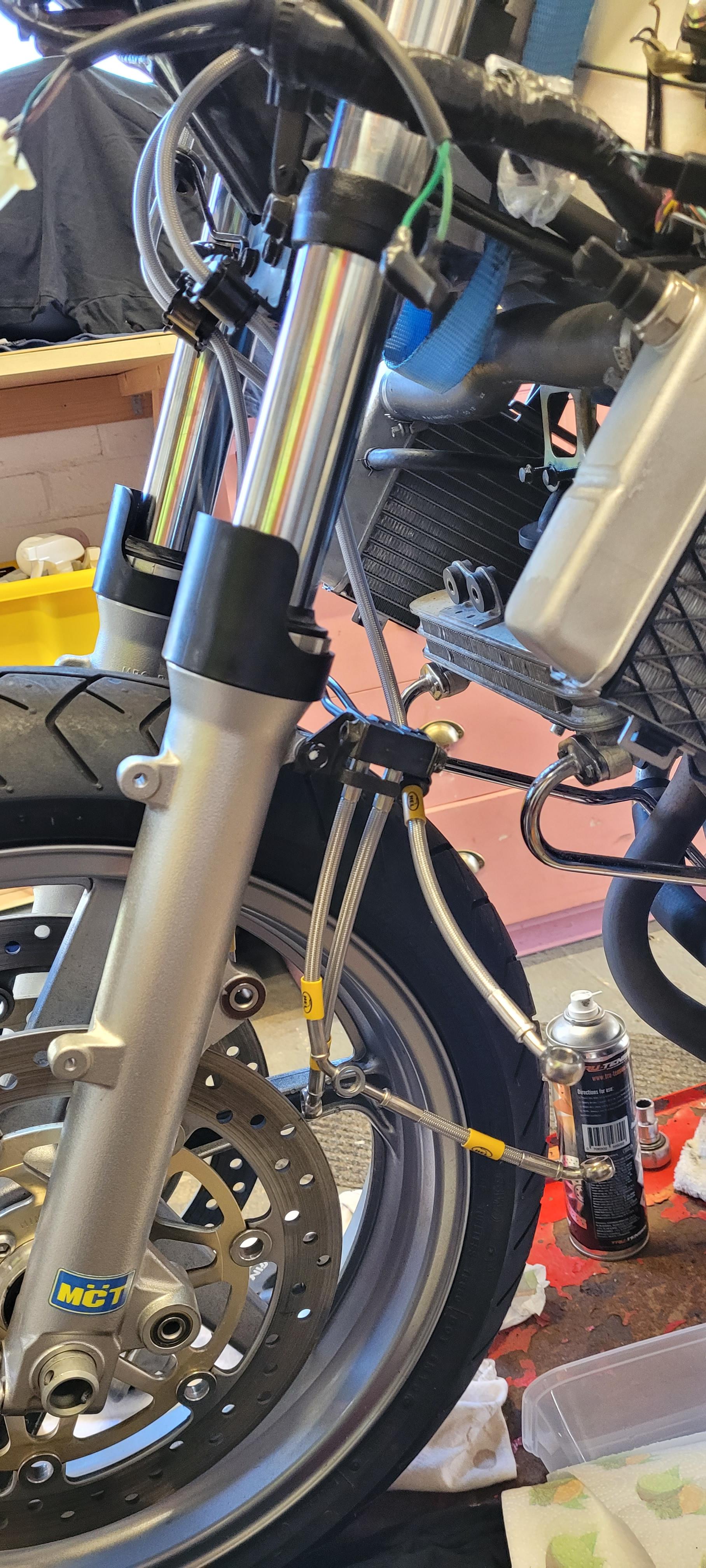

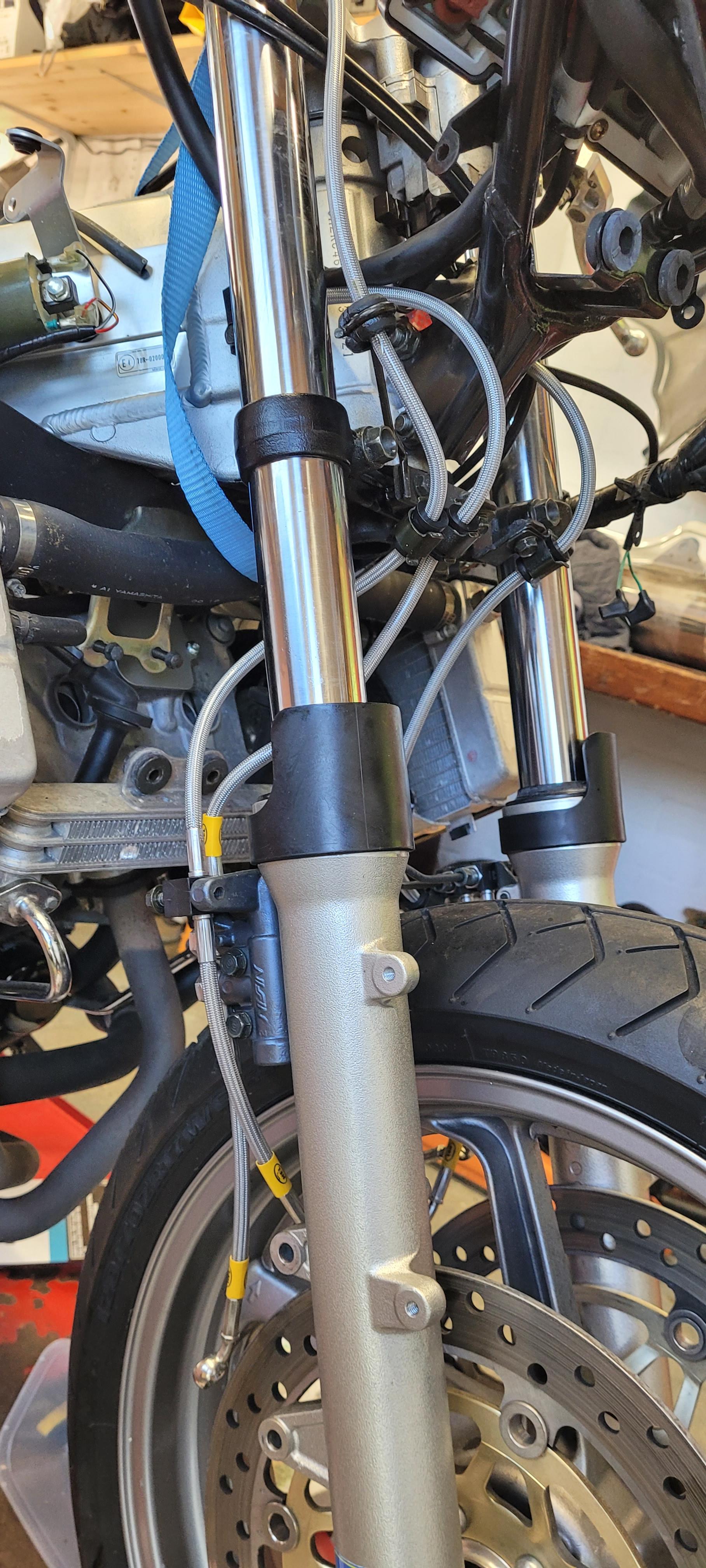

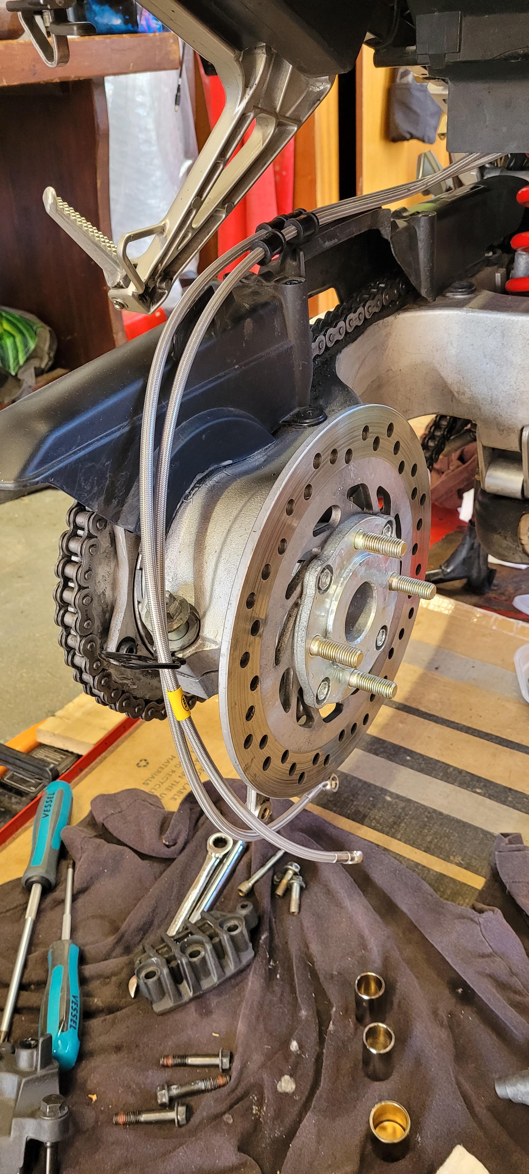

Braided brake hoses fitted. A clutch line was included in the kit too, but that will have to wait for another time. Just the callipers to rebuild then fit and bleed.

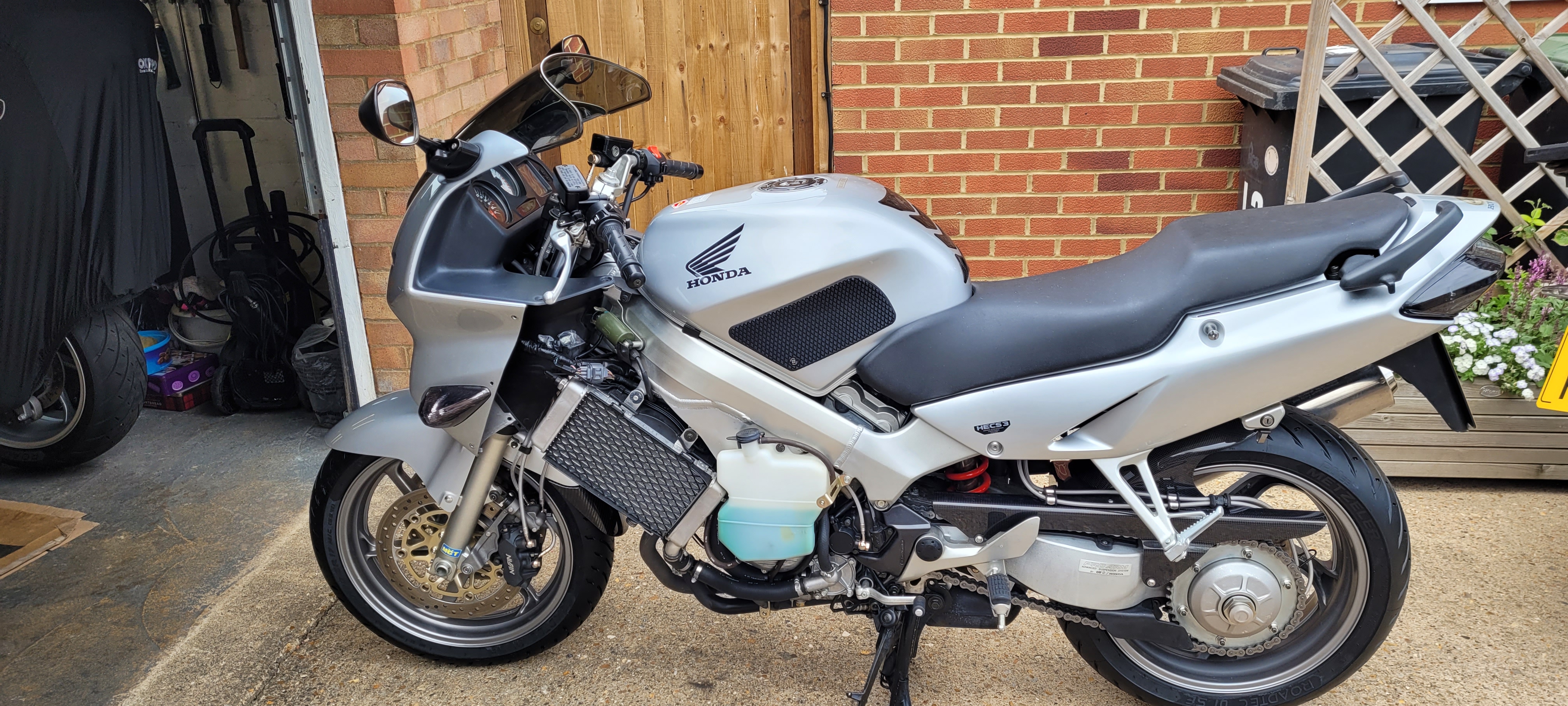

Progress!
Wheels fitted with new tyres (Metzeller Roadtec 1), clutch bled, carbon-look Skidmarx hugger/chainguard fitted, front and rear plastics fitted. Checked out the new all round LED lights and they look pretty good. Have put the old incandescent bulbs back in the headlamp for the MoT. I'll put the LED bulbs in in slower time and check out what the spillage is like. Blinged her up a bit with carbon-look fuel filler cap and key cowl vinyl, fitted mirror extenders, oil & filter change done.
And.....she started first time! Thank you Mr Honda, although admittedly I didn't really mess with the injectors or the engine.
I'll book an MoT as soon as the new number plate arrives. It's the same number, just on a plain plate. Then when she's fully legal, there's only a coolant change, balance the SVs and refit the lower plastics. I may do those jobs before the MoT, depends on work.

MoT test booked for Friday morning.

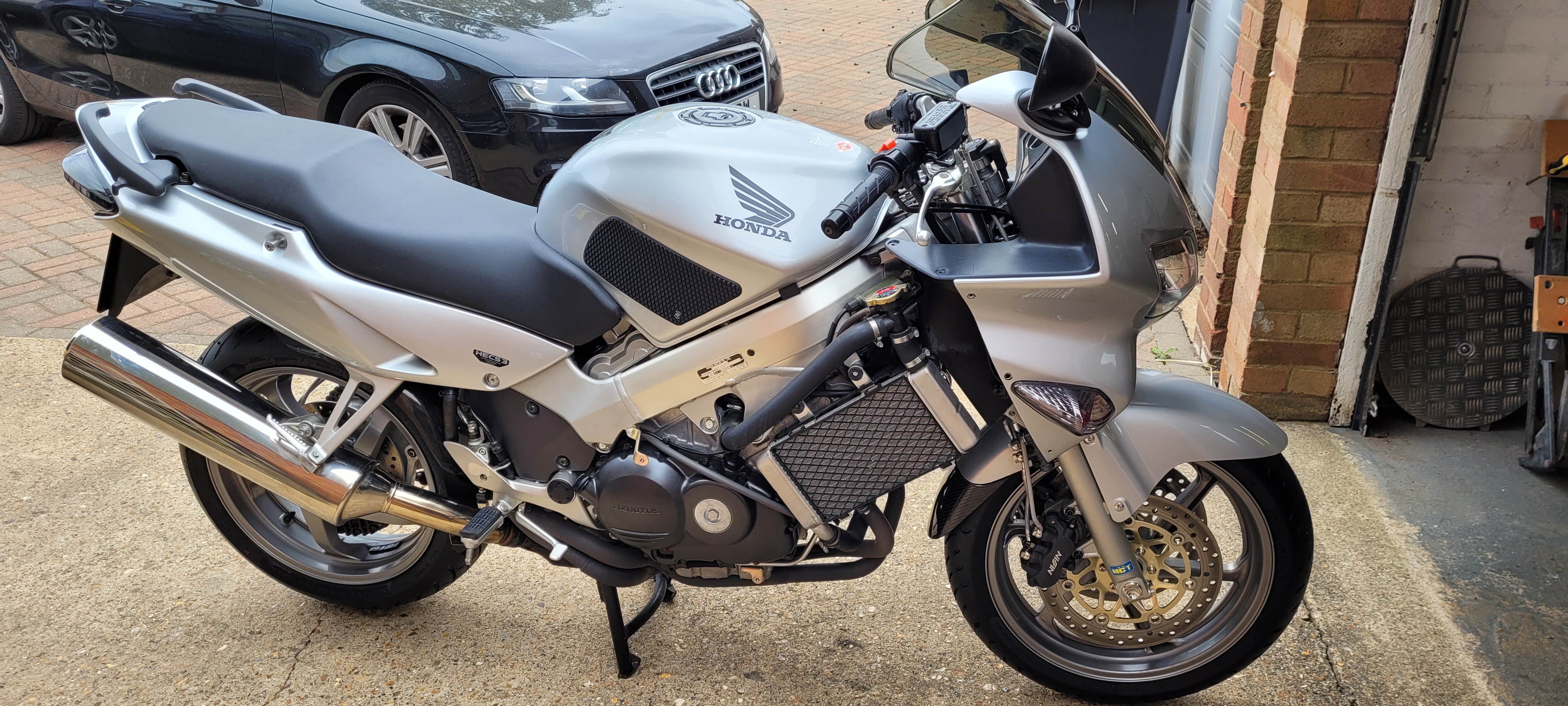

Here she is. Lower fairings will go back on after MoT when I've changed the coolant; I don't want to disturb it all and then find I miss the MoT cos I haven't had the time to fix it. I'll give her a good check over tomorrow, ensure all bolts and nuts done up tight and all the electrics work.
Fingers crossed.
And she passed with no advisories. :wheel:

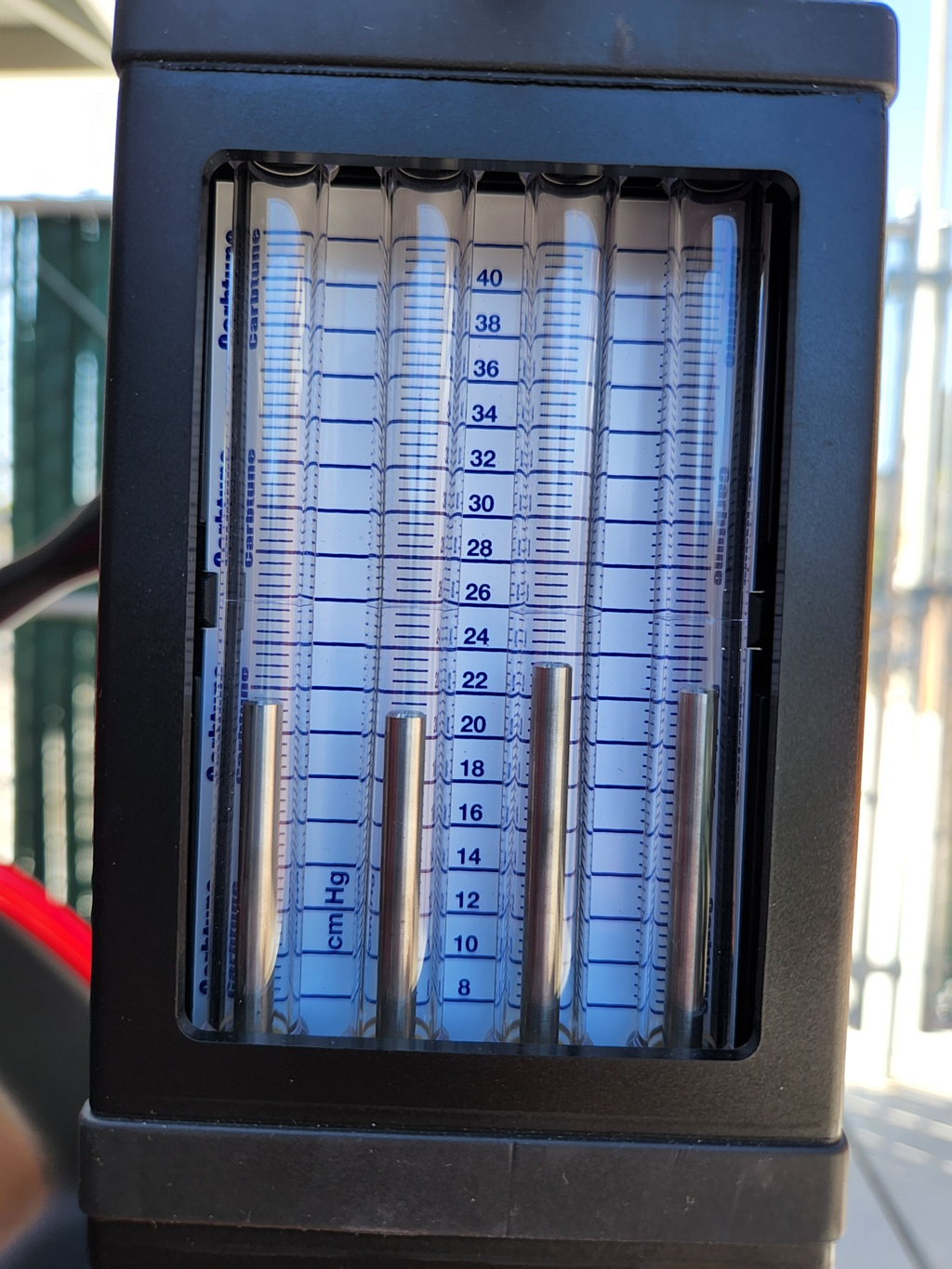

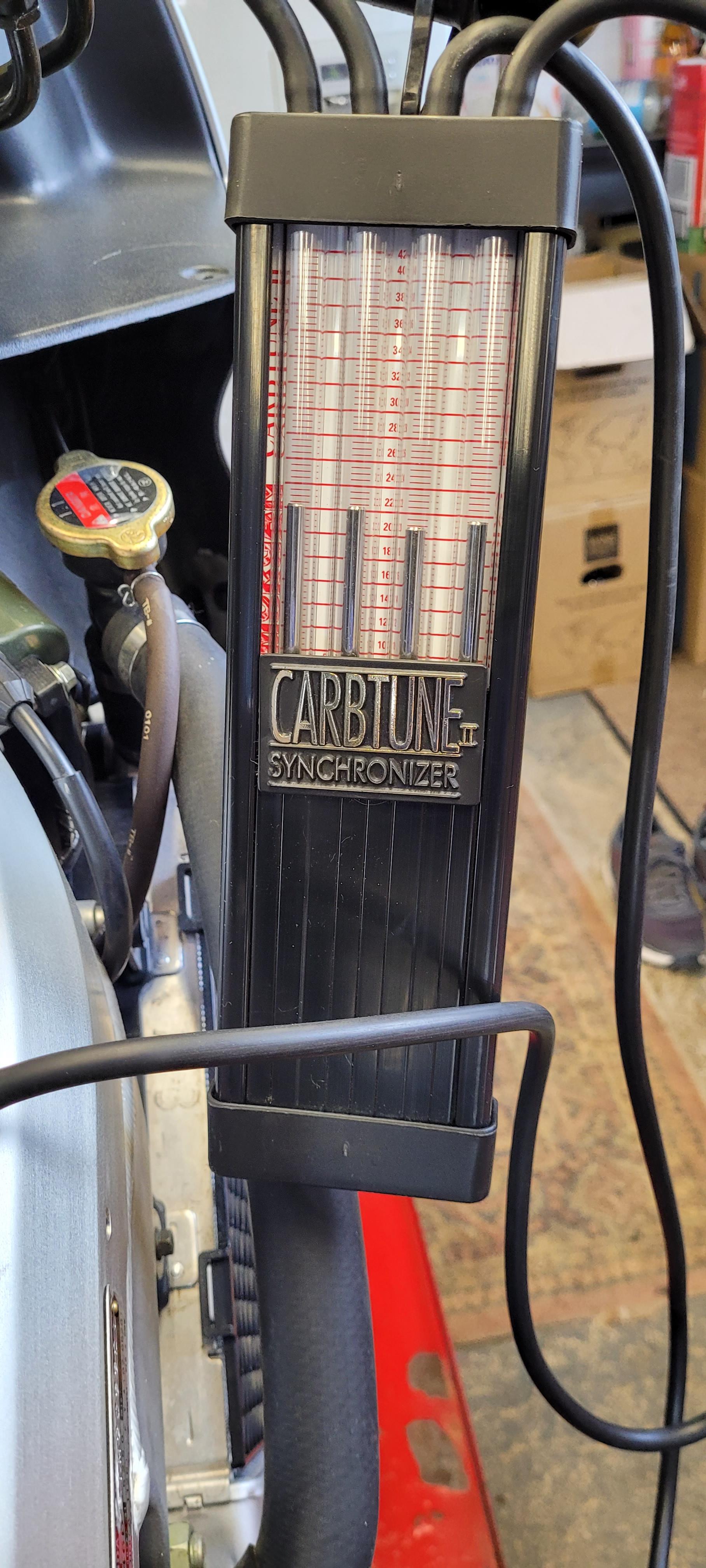

SV's done, once I'd located the Carbtune - haven't needed it for a few years. Easier than I remember as well.

Hi Skids.
With a 5gen you need to increase 3 and 4 not decrease it, apparently the manual is incorrect.
Cylinder 3 adjust to 20mm more vacuum than 1.
Cylinder 4 adjust to 10mm more than 1.
Cylinder 2 to match 1.
Carbtune each major graduation = 20mmHg. Each minor graduation = 5mmHg.
Hi Skids. Have a read of this. I can't remember who the poster was or find the post it was in, but I copied the text as reference some time ago. Many others have set their 5gens to this and it definitely works.
5th Gen Starter Valve Synch.
I know, its a bit strange to find incorrect procedure in workshop manual 22 years later. But no one did it, and I want to share my story now.
According to 5th gen manual, 3rd cylinder vacuum pressure should be dropped to 20mm compare to 1st. Most of us read it as dropped DOWN, and translated manuals have it mentioned as LESS vacuum for 3rd and 4th.
When I got my bike, it had flat sync for all cylinders. I did full maintenance some time later, through workshop manual, include starter valves synchronization. In very first day after, I noticed some surging when low throttle, it was a bit twitchy during city riding. Very uncomfortable to keep some speed at low throttle opening. Most of internet discussions about nervous VFR had tips about PAIR blocking and other redneck mods. Some of them suggested to always keep revs over 4k, because VFR doesn't love low revs... That's true, but I had very smooth bike before maintenance, even on very low RPM.
First - I adjusted flat sync back. It helped me a lot, motorcycle became very friendly again. Then I did it opposite to manual. It means 3rd cylinder adjusted to 20mm MORE vacuum than 1st, and 4th 10mm more than 1st. And the bike is smooth as butter. Even better than flat, and MUCH smoother than official way.
From here I want to explain why it helped. In service manual for 5th gen, they showed fuel injection diagrams. It has independent maps for each cylinder. On these graphs you can see - 3rd cylinder get lowest fuel portion, 4th a bit more, and 1+2 even more. I checked it with injector opening time frames. Diagrams are true, 3rd cylinder has less fuel than 1st on idle. For same mix ratio, fuel/air, we should feed less air into 3rd cylinder. It means we need close starter valve a bit, as result we will have MORE vacuum.
Thanks @Grum and @Tirso, I recall reading that thread when it was posted but figured it was wrong.
I shall re-adjust in the 'opposite' sense.
This is as close as I could get them.
#1 215mm
#2 210mm
#3 235mm
#4 225mm
But I also have another picture/reading and they're
#1 190mm
#2 195mm
#3 210mm
#4 200mm
They're all within the +/- 5 so I guess they're fine?
