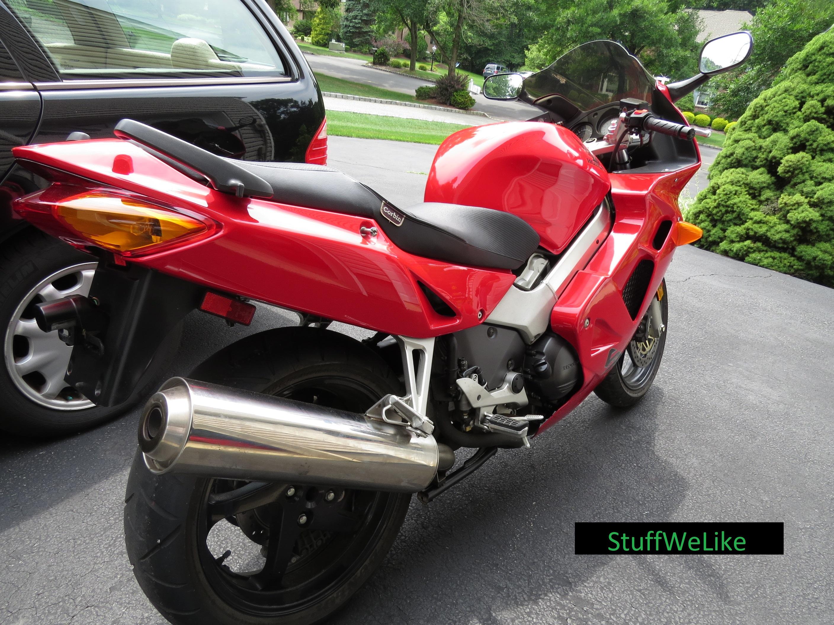

stuffwelike Posted December 1, 2021 Posted December 1, 2021 Hi. I'm relatively new to this VFR forum. I came from the Ninja 600 world. But now love my VFR. I logged in last year, I think. But never posted, I think. Been a lurker for years, though. My bike's a 98, 5th gen. Super low miles. Is anyone here from Northern New Jersey? Reason I ask is that I'm not that mechanically skilled when it comes to motorcycles. I can do basic maintenance only, like change oil, filter, clean the chain, grease it, etc... basic stuff only. I'm looking for a motorcycle mechanic in Morris County, New Jersey, who I can bring my bike to for service. Need new tires, and the rectifier replaced. And whatever else needs to get upgraded. Still reading up ... Thank you. 3 Quote
TimC Posted December 2, 2021 Posted December 2, 2021 Welcome to VFRD! 🙂 Thanks for sharing that photo of your gorgeous 5th gen, too! 1 Quote
