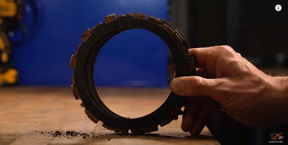

Kbear Posted October 10, 2021 Author Posted October 10, 2021 Came across this and thought I would share. Will Car Oil Ruin Your Motorcycle Engine? | The Shop Manual - YouTube 1 Quote
Member Contributer Grum Posted October 10, 2021 Member Contributer Posted October 10, 2021 Excellent video kbear, one I think every motorcyclist should see. Personally have only ever used m/c specific oils for the reasons described in the video. Don't see why you'd contemplate or risk using a car oil when there are so many excellent m/c oils out there. As always and especially with oil! YMMV. 1 Quote
Member Contributer ShipFixer Posted October 10, 2021 Member Contributer Posted October 10, 2021 1 hour ago, Kbear said: Came across this and thought I would share. Will Car Oil Ruin Your Motorcycle Engine? | The Shop Manual - YouTube All true. At the same time, it takes a lot to get to the case where the auto oil = clutch slip. We used to have a diesel test engineer on the board who explained all of this very well. He would also add here that he goes for a low ratio between viscosities so it reduces the dependency on the VI modifiers...I.e. lower ratio will retain viscosity longer. Quote
Kbear Posted October 10, 2021 Author Posted October 10, 2021 12 hours ago, Grum said: Don't see why you'd contemplate or risk using a car oil when there are so many excellent m/c oils out there. I'm one who really can't wrap my mind around why mc owners would want to take a chance on automobile oils either. To save a couple dollars here and there on using such oils is really not worth it. In the long run it will do more harm than good. Inevitably, you always get the mc owner that will state "I've used this or that type auto oil in my motor for 15 years with no issues". That's all fine and good if you really don't give a shit about what you own. I feel more sorry for the motorcycle than I do the owner at that point. Not sure anything could be said to change anyone's mind that is dead set against using mc specific engine oils. “Those who never change their minds, never change anything.” - Winston Churchill Quote
Member Contributer BusyLittleShop Posted October 10, 2021 Member Contributer Posted October 10, 2021 3 hours ago, Kbear said: . In the long run it will do more harm than good. Negative... either Auto or MC oil will meet and exceed your mileage expectations... There is no such thing as "for wet clutch" oil... given that motorcycles are small part of the main oil market share our motorcycle oil is chiefly reformulated Auto oil... In fact we don't find sufficient differences in additive package between Mobil 1 Auto or Mobil 1 4T MC oil... However there is a biting difference in cost... Here are virgin oil samples of $4.89 a quart Mobil 1 Auto Oil 10W40 and $9.98 a quart Mobil 4T Motorcycle specific oil... the additive packages are so similar that our wet clutch wouldn't know the difference... Quote
Member Contributer Captain 80s Posted October 10, 2021 Member Contributer Posted October 10, 2021 Which are the additives in oils that are advertised to deal with the shearing effects of transmission gears? A wet clutch has never been my concern. Quote
Member Contributer VFR78 Posted October 10, 2021 Member Contributer Posted October 10, 2021 “are so similar that our wet clutch wouldn't know the difference” They are different. 1 Quote
