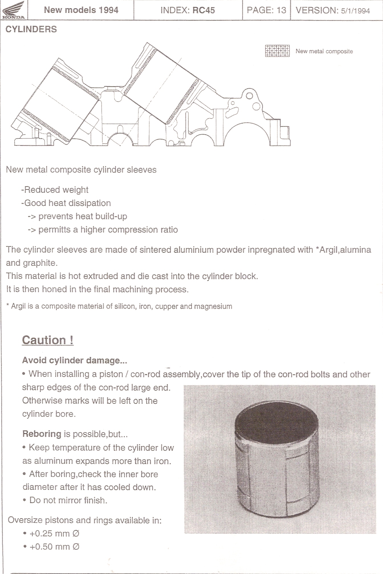

Member Contributer BusyLittleShop Posted February 19, 2021 Member Contributer Posted February 19, 2021 To handle the rigors of racing Honda's RC45 employs cylinder sleeves made of aluminum power impregnated with Argil alumina and graphite... (note Argil is a composite material of silicon, iron, copper and magnesium) Stock Honda cylinders whether VFR800 or RC45 will meet and exceed our mileage expectations... expect to see over 300K plus miles on 30 grade oil... 1 2 Quote

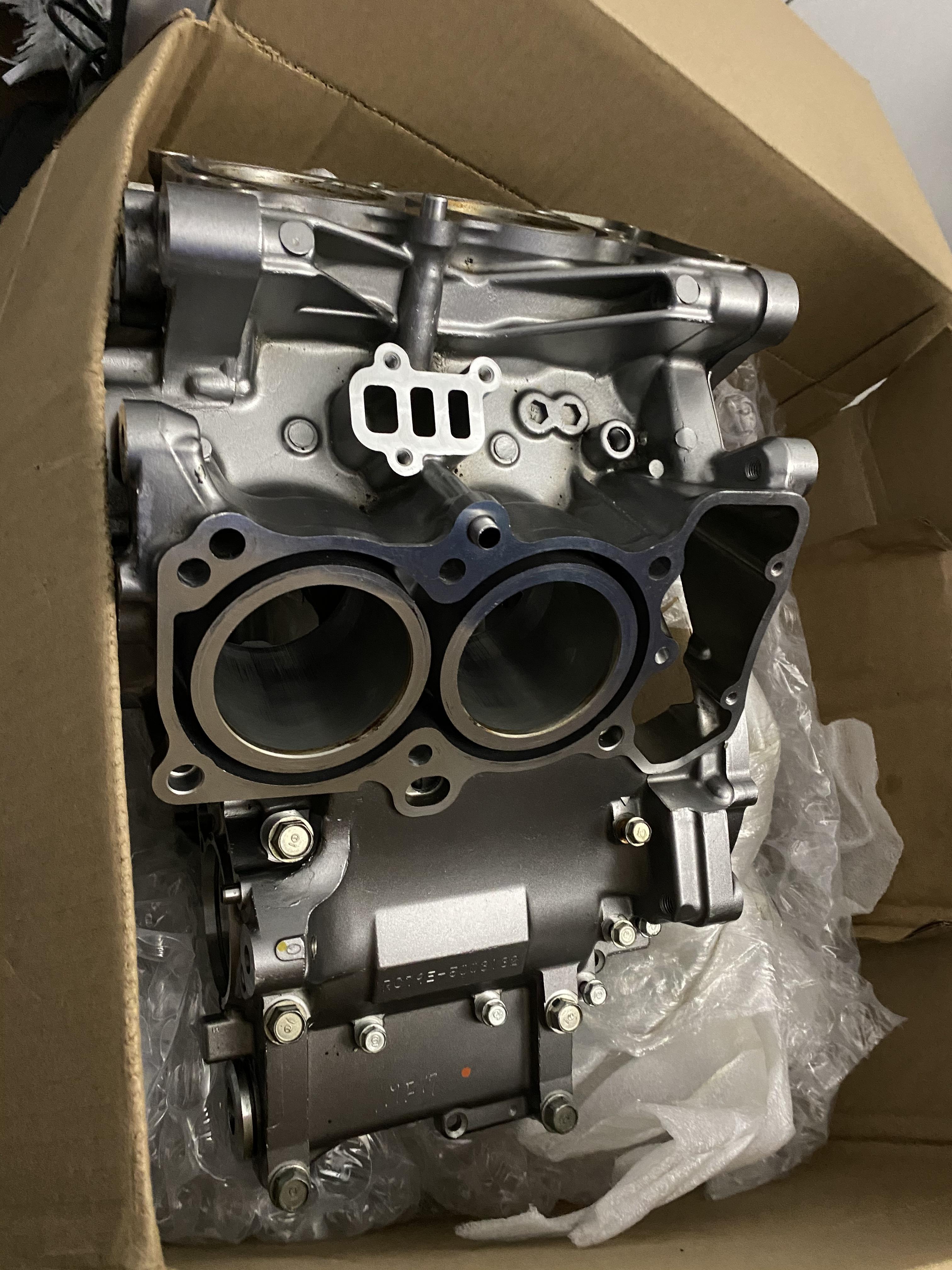

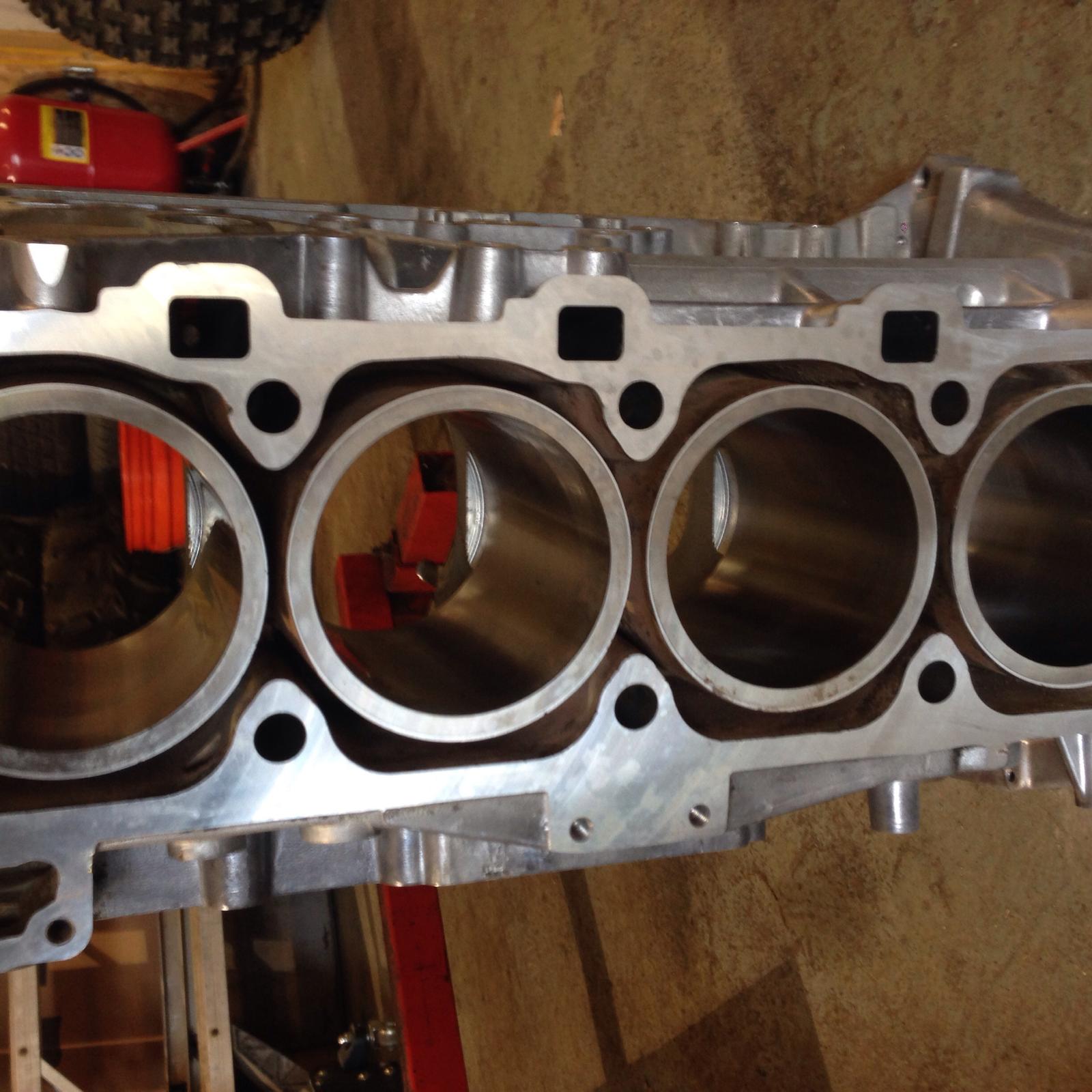

Vfr800witdawaffle Posted March 11, 2021 Author Posted March 11, 2021 Alrighty guys so I bought a spare crank case I’ll let you guys know which route I went with in the future as things progress. Also I’m going to see if I can use the 81mm pistons used in the new cbr1000rr-r sp. I already ordered one and I’m going to see if I can find some new rods to use and I think the wrist pins in the Honda cbr piston are 18mm. Quote

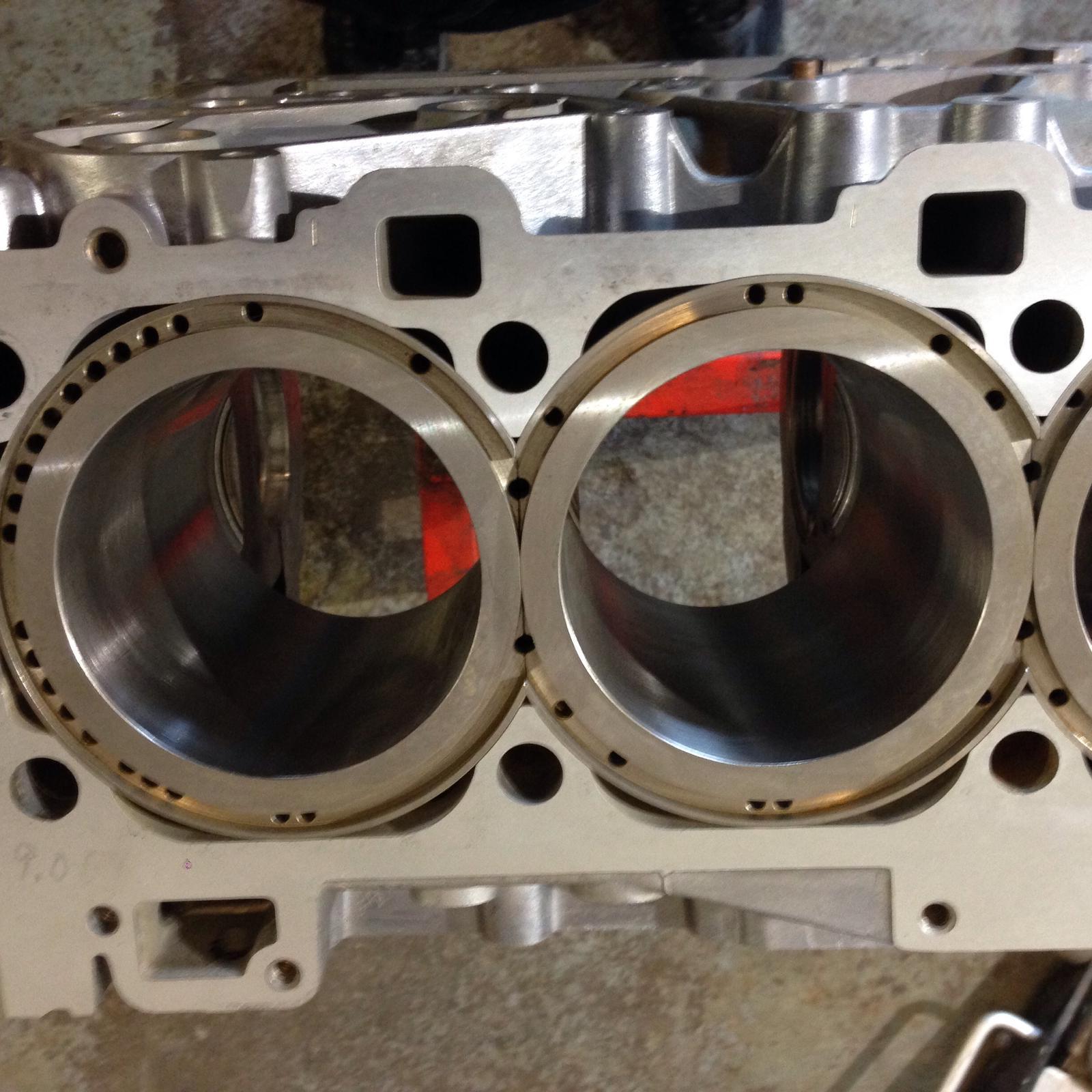

Member Contributer Cogswell Posted March 11, 2021 Member Contributer Posted March 11, 2021 That is new - yes? I haven't looked - but that must be a nice chunk of $. That shot gives VTEC owners a good look at where the spool valve lives - right in the base of the V. They never see it unless they remove the throttle body. You might want to check out HighSideNZ's thread from circa 2015. He successfully overbored his 5th gen block to 825cc and also did a cam re-grind. It might be interesting to compare notes with him to see how he approached it. The whole thread was captivating. I haven't seen him post in a while but I think he checks in every so often. Super nice guy - helped me out with a project - without him I could not have competed it. Maybe shoot him a PM with what you're up to. Just a thot . . . Quote
Vfr800witdawaffle Posted March 11, 2021 Author Posted March 11, 2021 I actually got it for 200 bucks used. Someone crashed one and it was on eBay. I snatched it up once I saw that the price for a new one is 1800 usd on partzilla. I think I’m going to convert it to a closed deck so I can bore it out to 81mm. 1 Quote
Member Contributer tbzep Posted March 11, 2021 Member Contributer Posted March 11, 2021 Used or not, it's a beautiful hunk of aluminum. I used to love to look at my VF-500F's exposed engine when I was but a pup. Quote
Member Contributer DannoXYZ Posted March 11, 2021 Member Contributer Posted March 11, 2021 On 3/11/2021 at 8:32 AM, Vfr800witdawaffle said: I actually got it for 200 bucks used. Someone crashed one and it was on eBay. I snatched it up once I saw that the price for a new one is 1800 usd on partzilla. I think I’m going to convert it to a closed deck so I can bore it out to 81mm. Yeah, boring out to 81 won't leave much of original cylinder in place to support dry-sleeves. So you'll want to go with wet-sleeves that also convert to closed-deck at same time. Top flange touch each other as well as outer block for support. Good enough for 260-bhp/ltr engines, so you should have plenty of overhead. There's actually a step on outer-block to support under flange. I prefer to have sleeve's flange 0.0015" above deck for additional head-clamping. Also make sure deck-plate is used for boring. Honda B16/B18 engines have same 81mm bore and many are upgraded using wet-sleeves, so there's many shops that can handle this. 1 1 Quote
Member Contributer Cogswell Posted March 11, 2021 Member Contributer Posted March 11, 2021 That was a steal - looks brand new. Once to fruition and I suspect that some clutch upgrades may well end up being in the mix. Very much looking forward to seeing more updates. Quote
Member Contributer Cogswell Posted March 11, 2021 Member Contributer Posted March 11, 2021 2 hours ago, DannoXYZ said: Yeah, boring out to 81 won't leave much of original cylinder in place to support dry-sleeves. So you'll want to go with wet-sleeves that also convert to closed-deck at same time. Top flange touch each other as well as outer block for support. Good enough for 260-bhp/ltr engines, so you should have plenty of overhead. There's actually a step on outer-block to support under flange. I prefer to have sleeve's flange 0.0015" above deck for additional head-clamping. Also make sure deck-plate is used for boring. Honda B16/B18 engines have same 81mm bore and many are upgraded using wet-sleeves, so there's many shops that can handle this. Modern machining methods really are impressive. I half expected to see a jet of oil spraying on it while working as happens in some CNC processes. I should study on it more as I don't know as much as I'd like to. Quote
Member Contributer DannoXYZ Posted March 11, 2021 Member Contributer Posted March 11, 2021 Yeah, modern machining is extremely advanced. Speeds for these cuts in alloy are slow compared to high-speed drilling and milling bits in steel, so not much heat is generated. Alloy block and chips also carry away heat quickly. Coatings on tool-bits have improved tremendously as well. AlTiN and TiAlCN coatings are extremely hard with low-friction to reduce heat. And they may actually shatter off cutting-bits if hit with coolant/lube due to thermal shock. Final honing/cross-hatching operation in steel sleeves using diamond-hones will require lube. Here's beginning-to-end sleeving operation on Honda engine. What surprises me is how wet-sleeves are only slip-fit, not even interference-fit like dry-sleeves. These sleeves have 100kpsi strength, or about 3x more than old-style cast-iron dry-sleeves. I used to do lots more old-style dry-sleeving using cast-iron liners inside bored-out alloy cylinders. But that gets too weak for larger bores due to thinnest of original and inserted sleeves. Even though total thickness may be 4.0mm, they have only strength of their 2.0mm individual layers. It's load-in-series equation like stacking 2 springs on top of each other or chains. Each layer still have to face same max-load. Quote

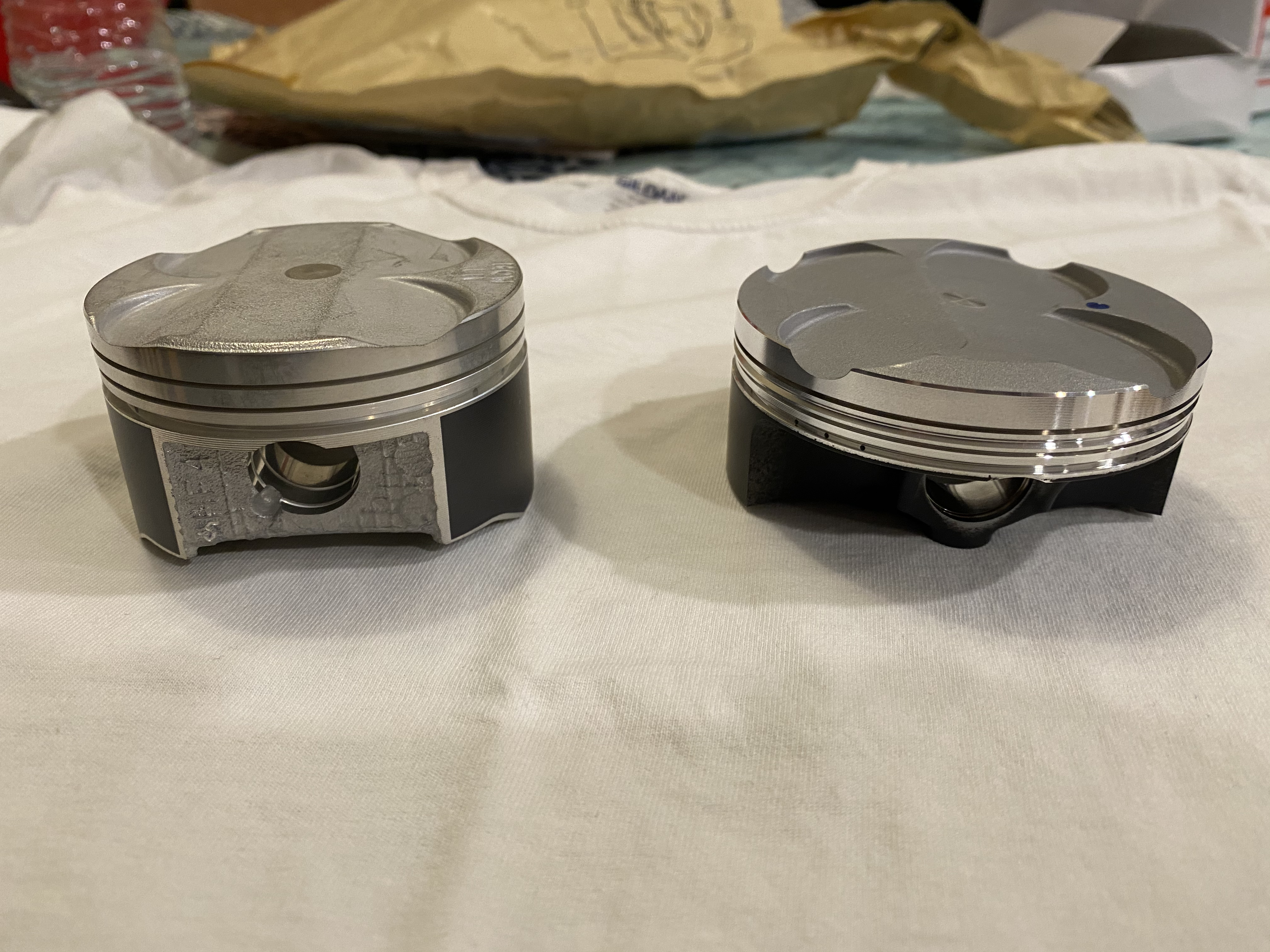

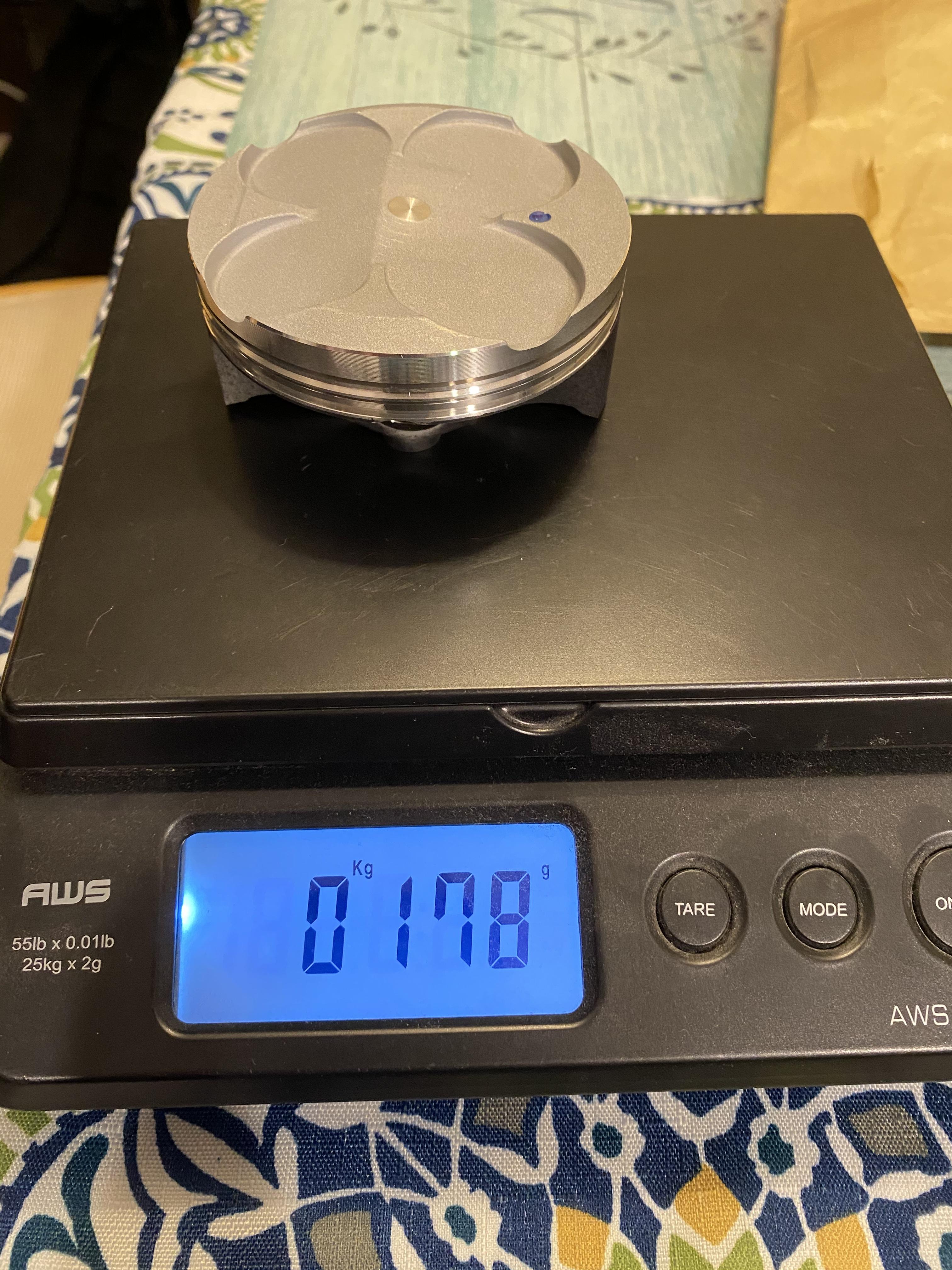

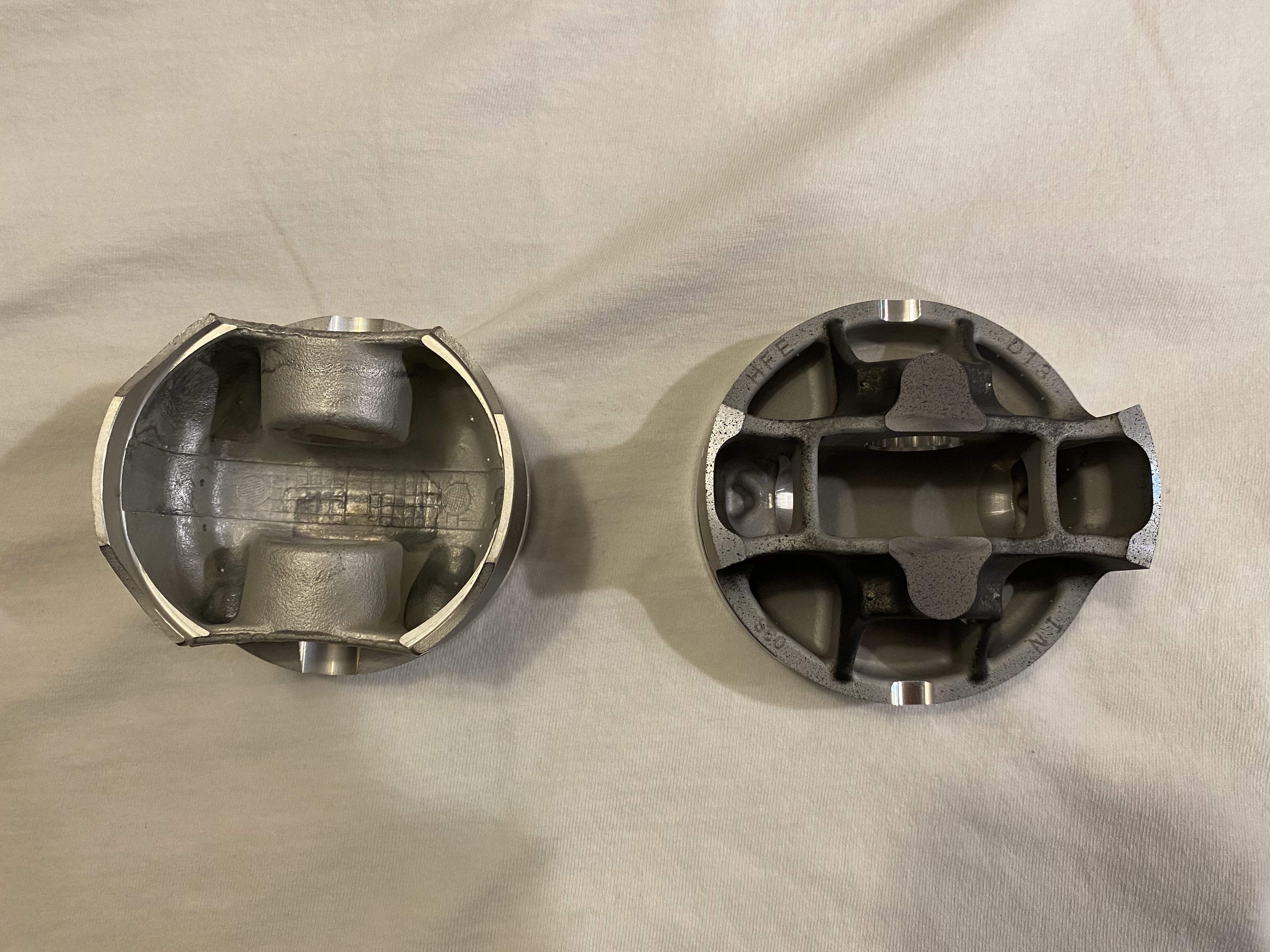

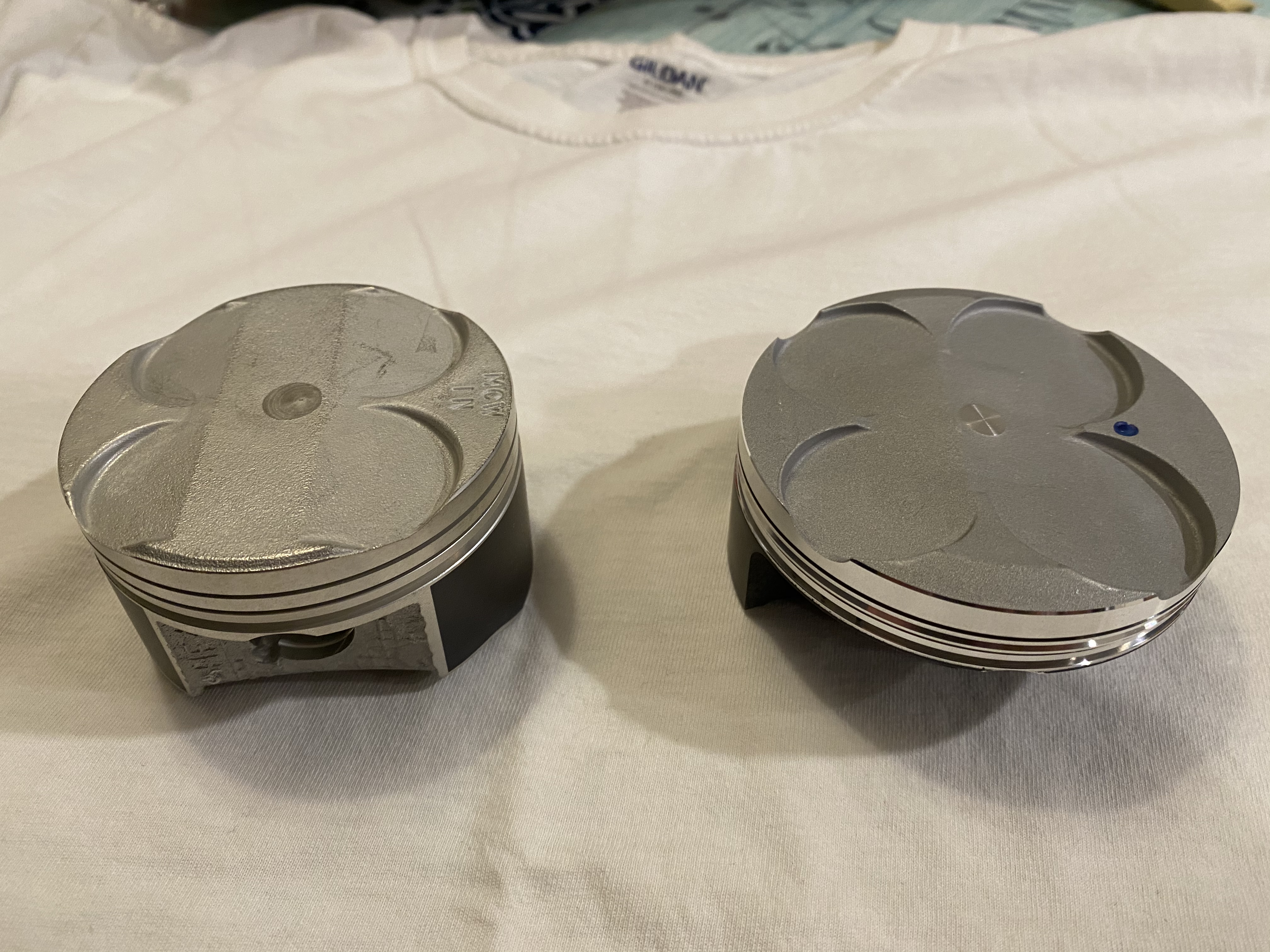

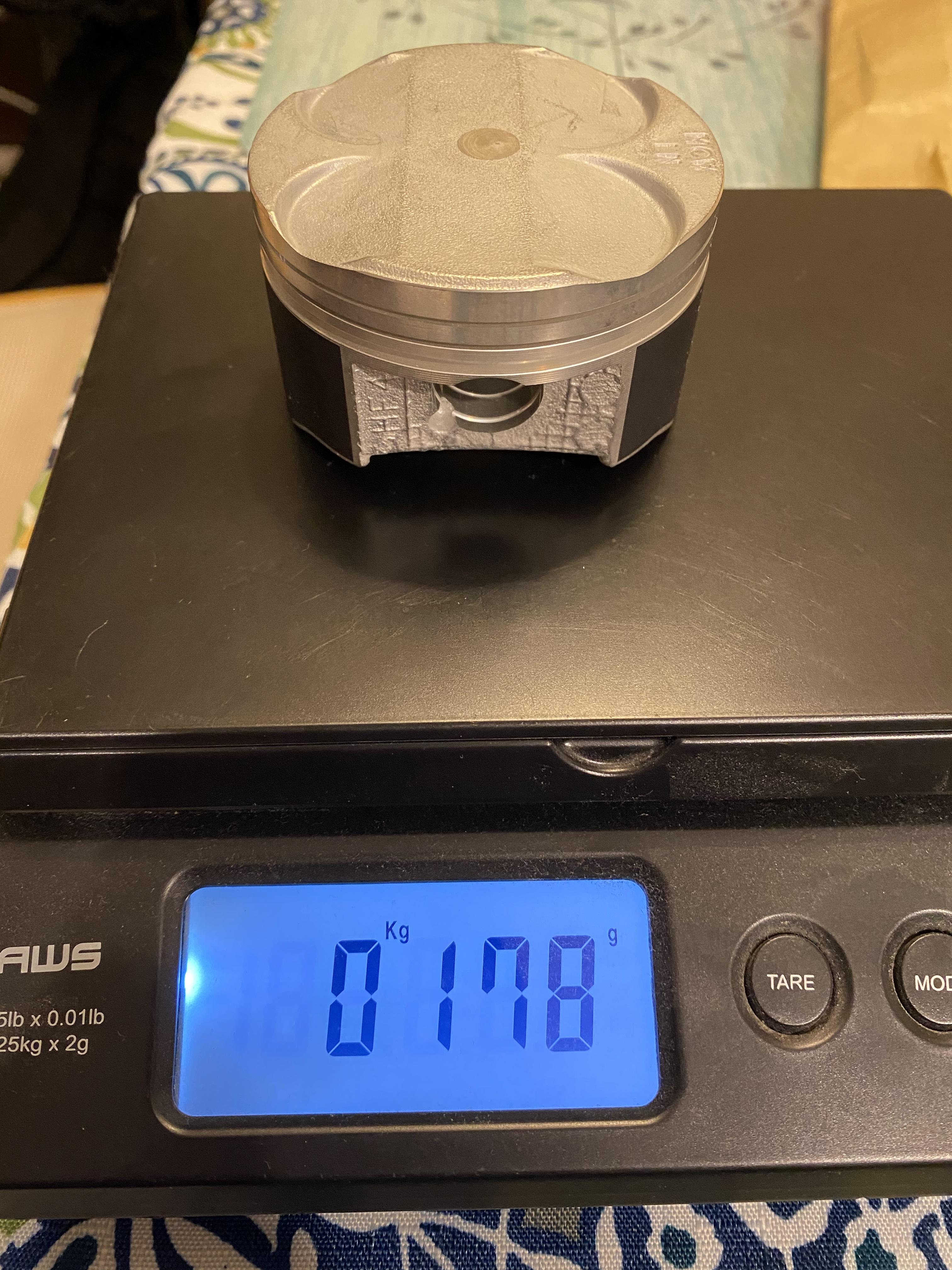

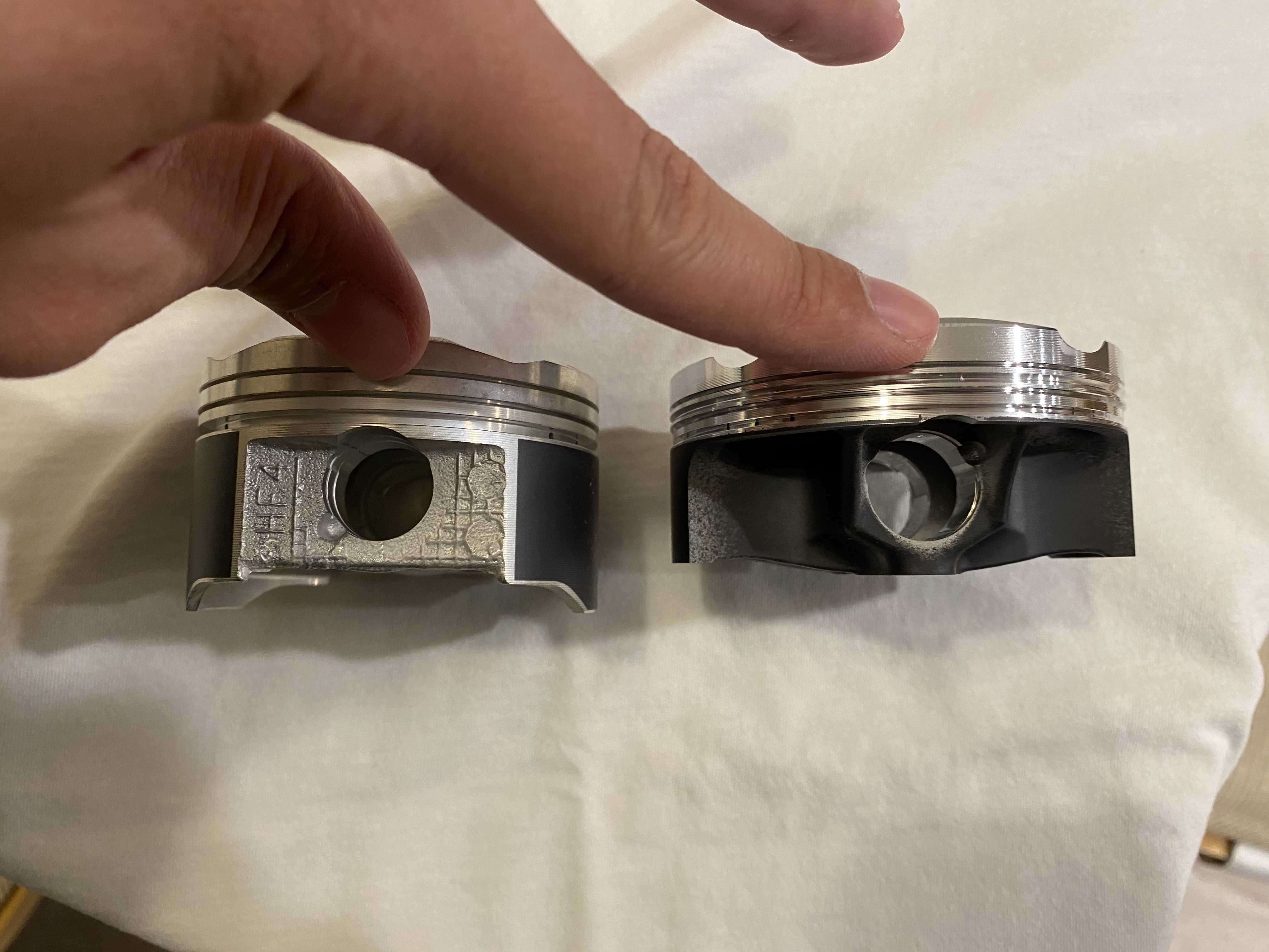

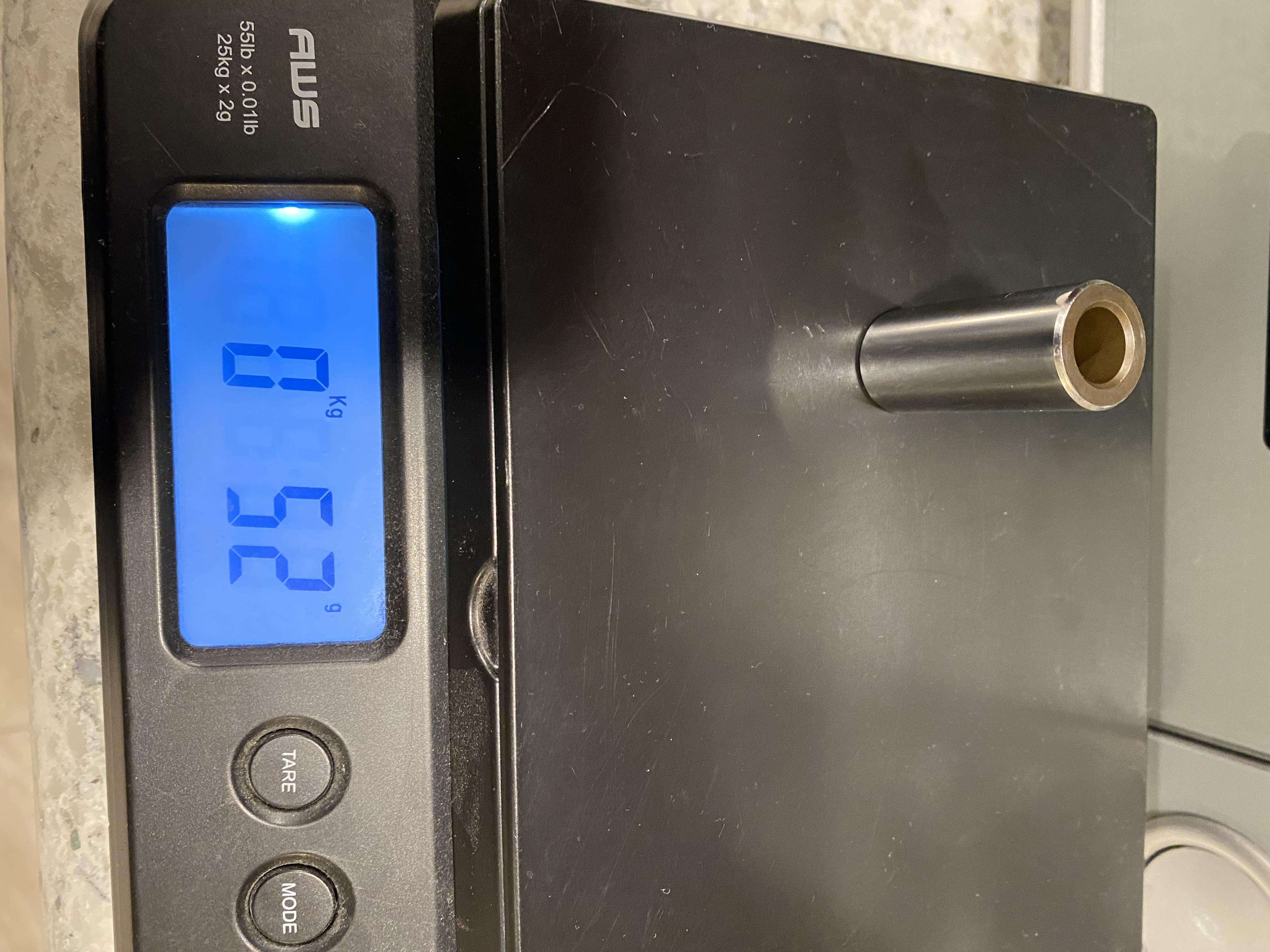

Vfr800witdawaffle Posted March 21, 2021 Author Posted March 21, 2021 So guys the cbr1000rr-r piston came in and I got some photos and weighed it. I’m going to get a better scale as I don’t want to go around balancing the darn crank and I’m also going to see if I can have the oiling holes made a bit bigger at at a good machine shop. Quote

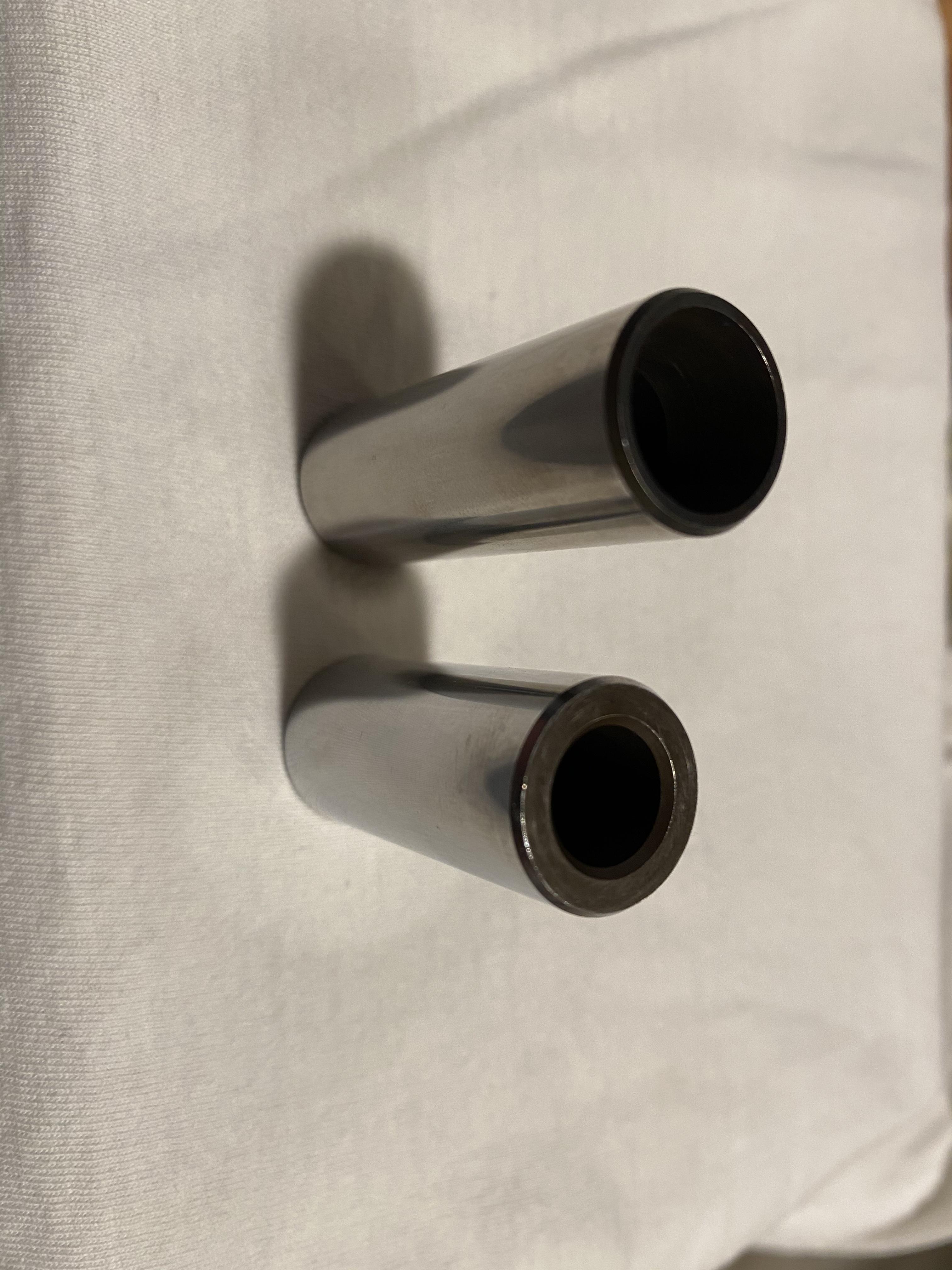

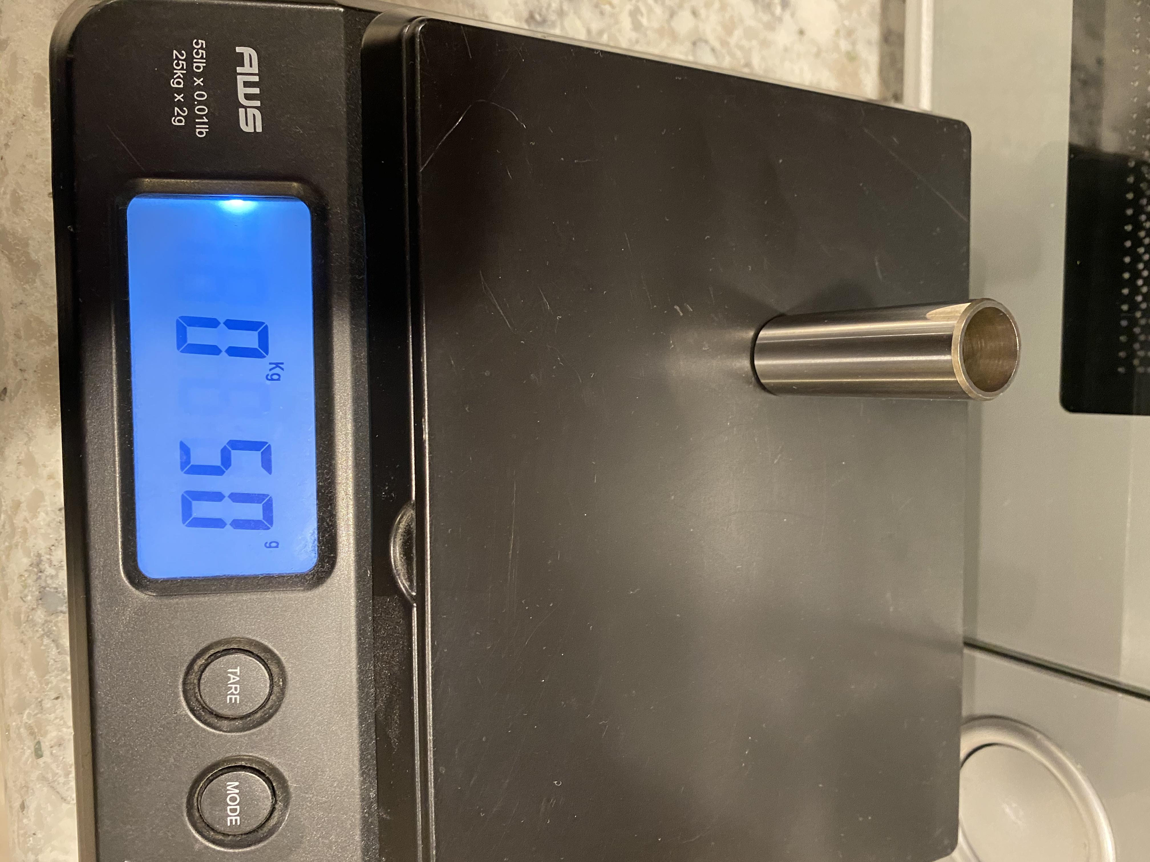

Vfr800witdawaffle Posted March 21, 2021 Author Posted March 21, 2021 I also weighed the pins and the cbr pin is only a couple grams heavier. It’s also beefier looking. The interceptor pin is 17mm in diameter and longer while the cbr is 18mm. I’m going to have to use a different rod. I’m going to look at oem steel offerings from other manufacturers including Honda. Trying to keep costs down and I will not be using titanium. Titanium rods don’t last as long as steel rods when it comes to putting down hundreds of thousands of miles. Quote
Member Contributer Mohawk Posted March 21, 2021 Member Contributer Posted March 21, 2021 Ambitious project, first person I've come across to try it on the 8th gen. Your biggest headache will be compression ratios. The stock MMC is the best possible liner, for wear & longevity, nothing else comes close. Unfortunately like other alloy based solutions, you need a thick alloy wall the contain the forces involved. The open deck cylinders have a stock OD of 88mm with a 72mm bore. Giving 8mm wall thickness. The MMC's are 2.5mm at their thickest point, thus you need to bore to 79mm to completely remove them. If you intend to bore for 81mm pistons then you may run into issues around the bottoms of the cylinders, due to the staggered layout, the lower cylinders are partially bored through the structural walls. A large bore may cross or expose/cut off oil ways. The only suitable liner would be a 2mm walled iron liner due to the loss of alloy from the bore. And as was previously noted, changing to closed deck solution is probably the best option to ensure bore stability & to get a flush fit & avoid liner slip. If you can get them you may be able to repurpose VF1000R liners. IIRC the stock bore is 77mm with either 4 or 5mm wall & a closed deck lip. Re piston wrist pin, the 1K one is stronger than it needs to be due to the higher rpm of the 1K, so you should be able to lose the extra couple of grams & get the complete piston to the same weight as the stock one. I will wait with anticipation of your progress. I've been planning the same thing for years & never had the time & funds to do it. 1 1 Quote
