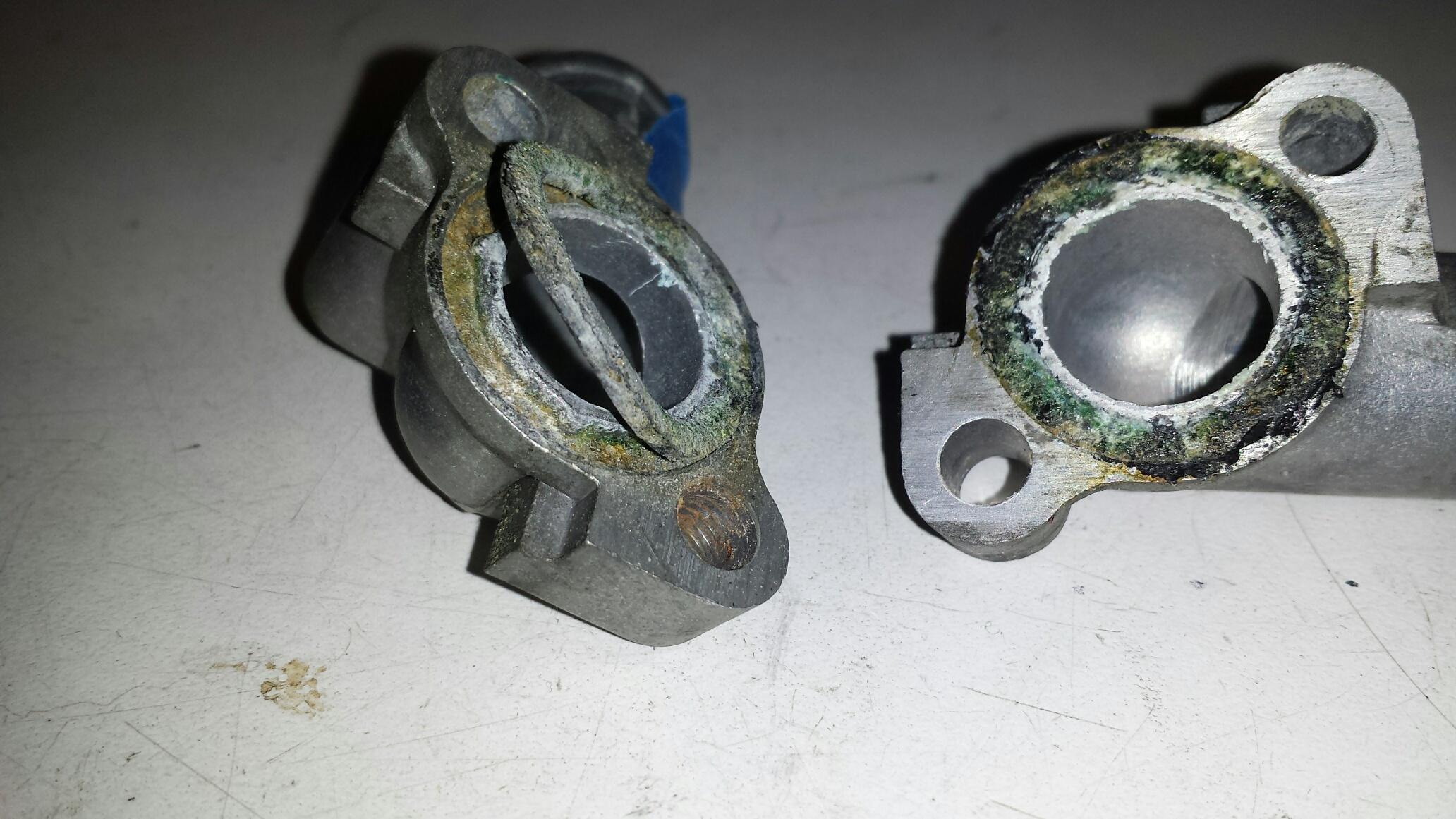

This is the condition of the o-rings in the water joints in the V.
Fresh o-ring
Call a penalty on me for piling on - I've been at my 5th gen's hoses, etc.  Even though it's a very low mile bike and has had regular cooling system maintenance, when I removed the two water necks from the V, I found mine in very much the same condition . . . These things are absolutely petrified.  Strangely other joints in the system look new and the o-rings are in fine condition (though those o-rings are also being replaced).   So the condition of the two (below) is not due to lack of maintenance or mileage, just age.  Rather than attempt to clean these, they're relatively cheap (about $20 for the pair) so a new set is on the way along with new o-rings.   So it seems regardless - if a motor is old enough, it's going to experience deterioration in the rubber cooling system components.  Thankfully these are all still available from Honda.  Once they're gone - I suppose my 5th gen will be my personal museum piece.
Hi Cogswell.
Your pictures seem to show a fine example of perhaps a chemical reaction to the o-ring rubber. The housings are very nice and clean internally, a testament to your good cooling system maintainance. I just wonder wether the o-ring specs are not compatible to engine coolant chemicals, there really seems like some bad chemical reaction going on with the o-rings over a long period. Just a thought!
Cheers.
