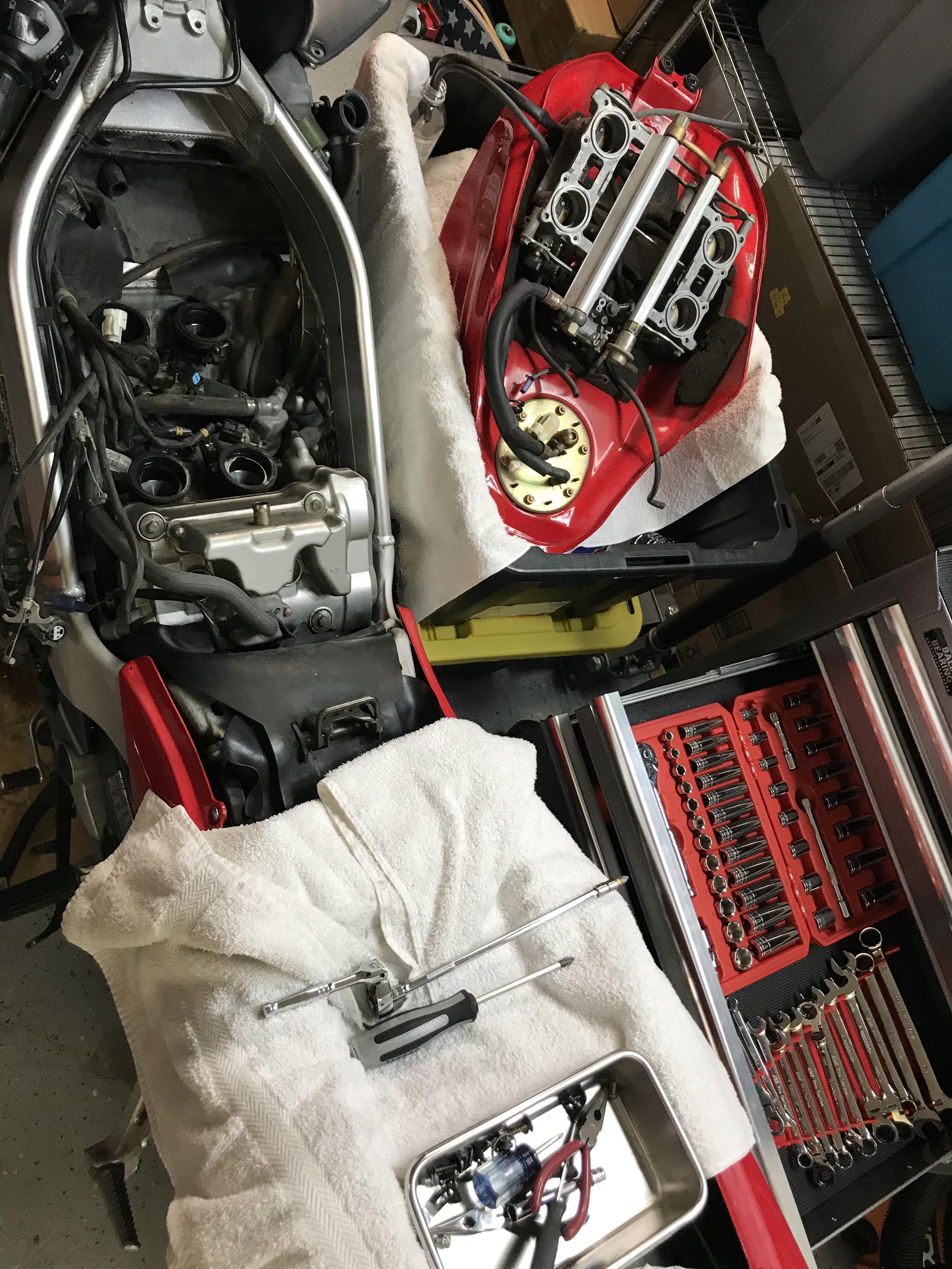

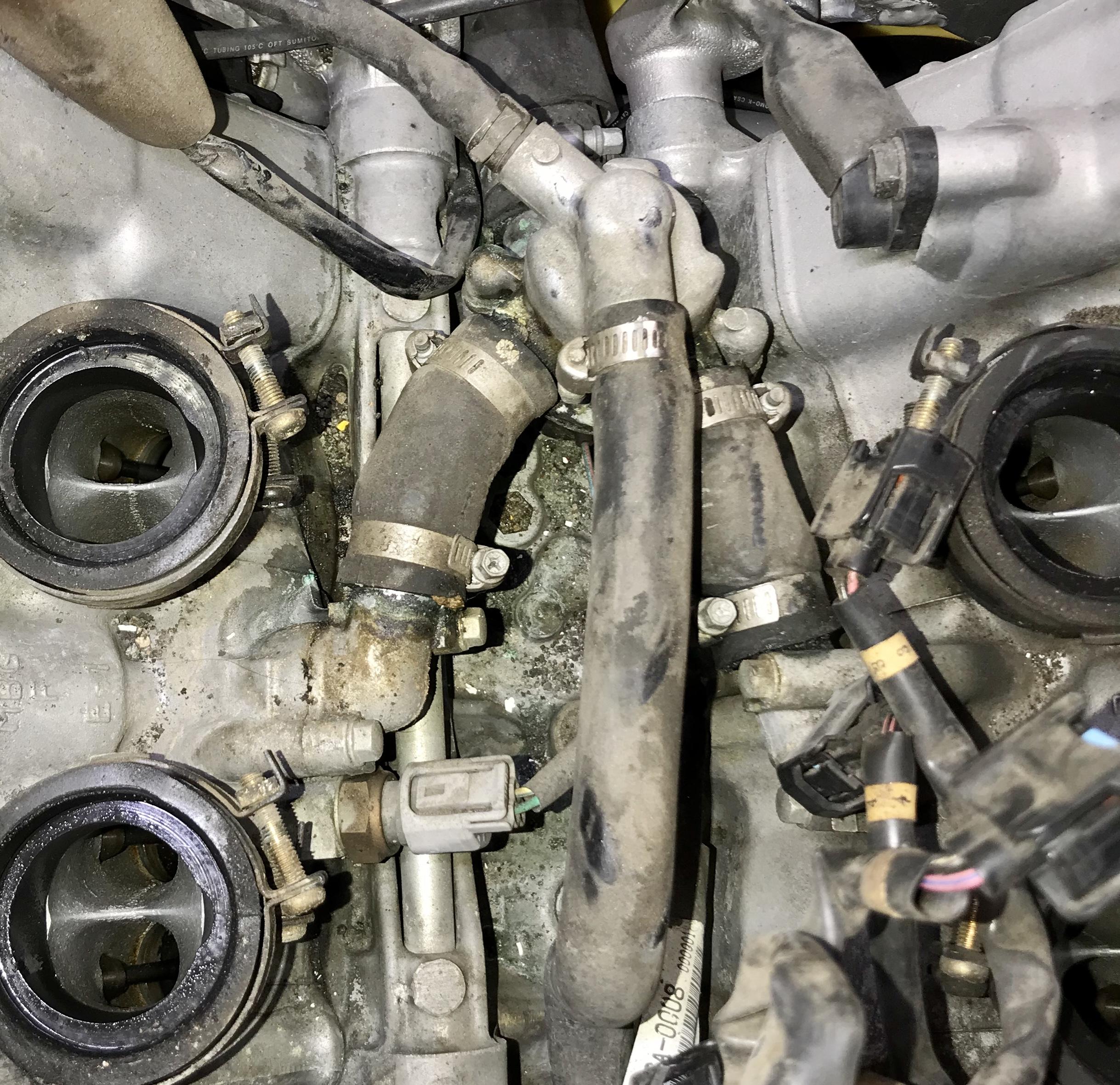

8200rpm Posted February 19, 2020 Posted February 19, 2020 Bought this awesome ‘98 49-state model with a weeping thermostat hose. Level in the reservoir drops about 1/4” every 1k miles or so. Just enough to make a stench every ride but not enough to drip on the ground. Major chore getting the airbox and all the connectors and hoses off. That little hose attached to the bypass control solenoid gave me the fits! I also needed a 4 foot piece of wood to dislodge the throttle bodies from the intake boots. I found one screw, a collar and and two washers in the V crevice. Hope to never see this part of the bike once I’m done. Replacing 10 coolant hoses, 5 o-rings, a thermostat and a new radiator cap for good measure. Between rebuilding calipers and bleeding the linked braking system and replacing the thermostat on a VFR, I think most other bikes will be much simpler to work on. Anyone ever clean, balance and calibrate injectors? Can I remove the fuel rail without disconnecting the fuel lines from the gas tank? 1 Quote
Member Contributer Cogswell Posted February 19, 2020 Member Contributer Posted February 19, 2020 It is a pesky devil, isn't it? That's long been the knock on the V-4 - two of everything - 2 cylinder heads, 2 sets of cams and covers to remove for a valve adjustment, and then all that stuff crammed down in there where it's hard to get at. But the result is V-4 magic! Be sure all your hoses are tight - 1/2 turn too loose and you'll be chasing another coolant leak with all that to do over. If you're having the injectors cleaned (good idea BTW), RC Injector service is in SoCal and would be a quick turnaround for you. $25 per plus shipping. I just sent mine to WitchHunter Performance in Duval, WA which was cheaper, but he has a 3 week backlog. Removing them has a set procedure that includes removing the TPS - too long to describe, would recommend reviewing that in the FSM before going further. Also, be kind to the throttle body boots. They are no longer available so if they get borked you'll have to find them used. Maybe a PITA for now, but you'll be glad to did this and have the satisfaction of doing it yourself. It's a nice looking ride and deserves the service. Cheers 5 Quote

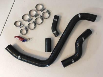

Member Contributer Thumbs Posted February 26, 2020 Member Contributer Posted February 26, 2020 Samco do silicone hose kits for the bike https://www.samcosport.com/wp-content/uploads/2020/01/GBP-BIKE-HONDA-2020.pdf For 98-01 bikes they list 15 hoses 1 1 Quote

Member Contributer JZH Posted February 27, 2020 Member Contributer Posted February 27, 2020 I made my own silicone hoses for the yellow bike in California. Per Mohawk's pioneering efforts several years ago, which he detailed here some time ago (there's a link to his thread in my "Yellow Peril" build thread). You could, of course, do the same with quality rubber hoses--for a lot fewer bones... Ciao, JZH 1 Quote

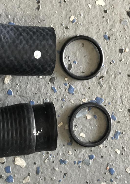

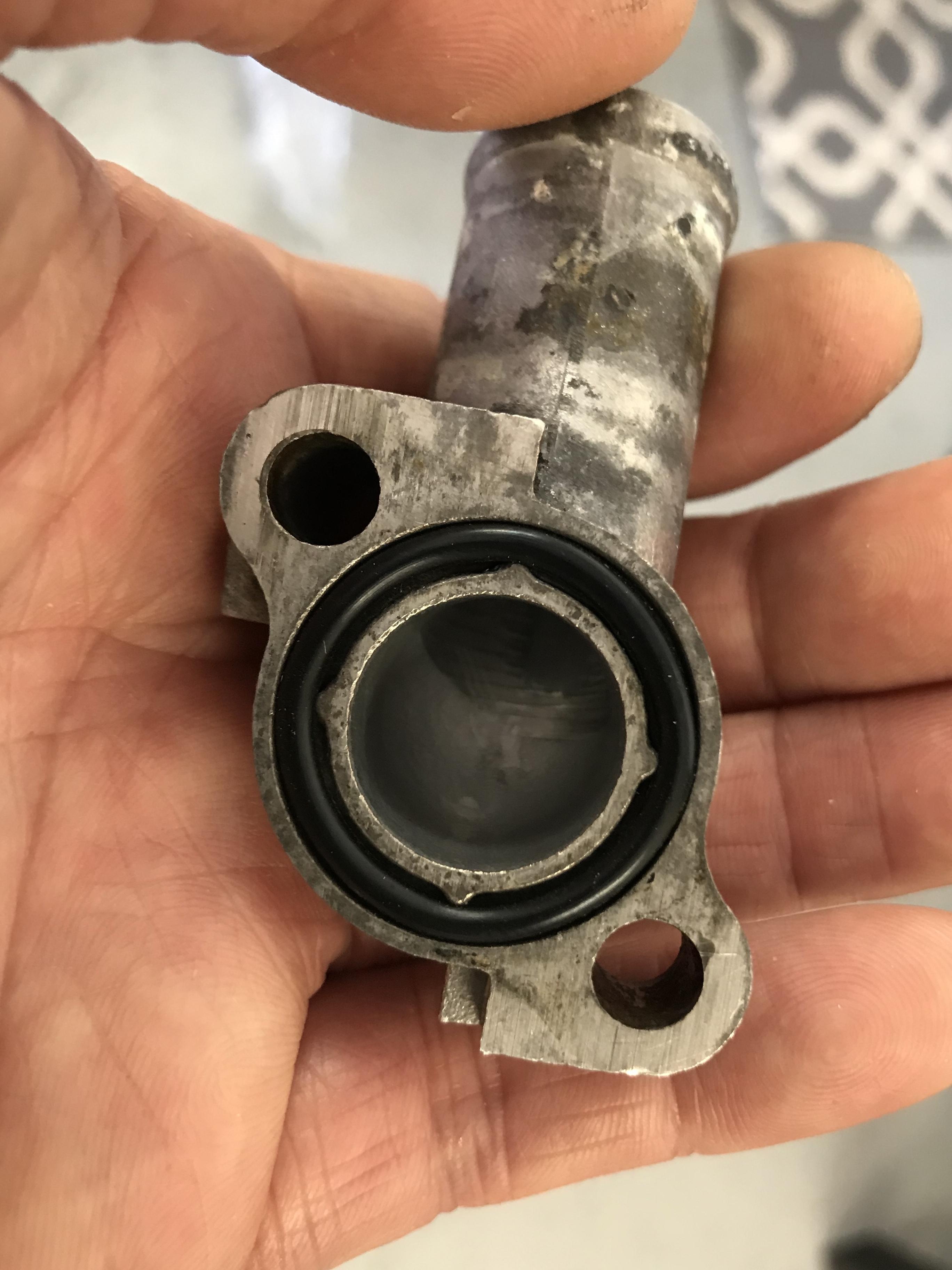

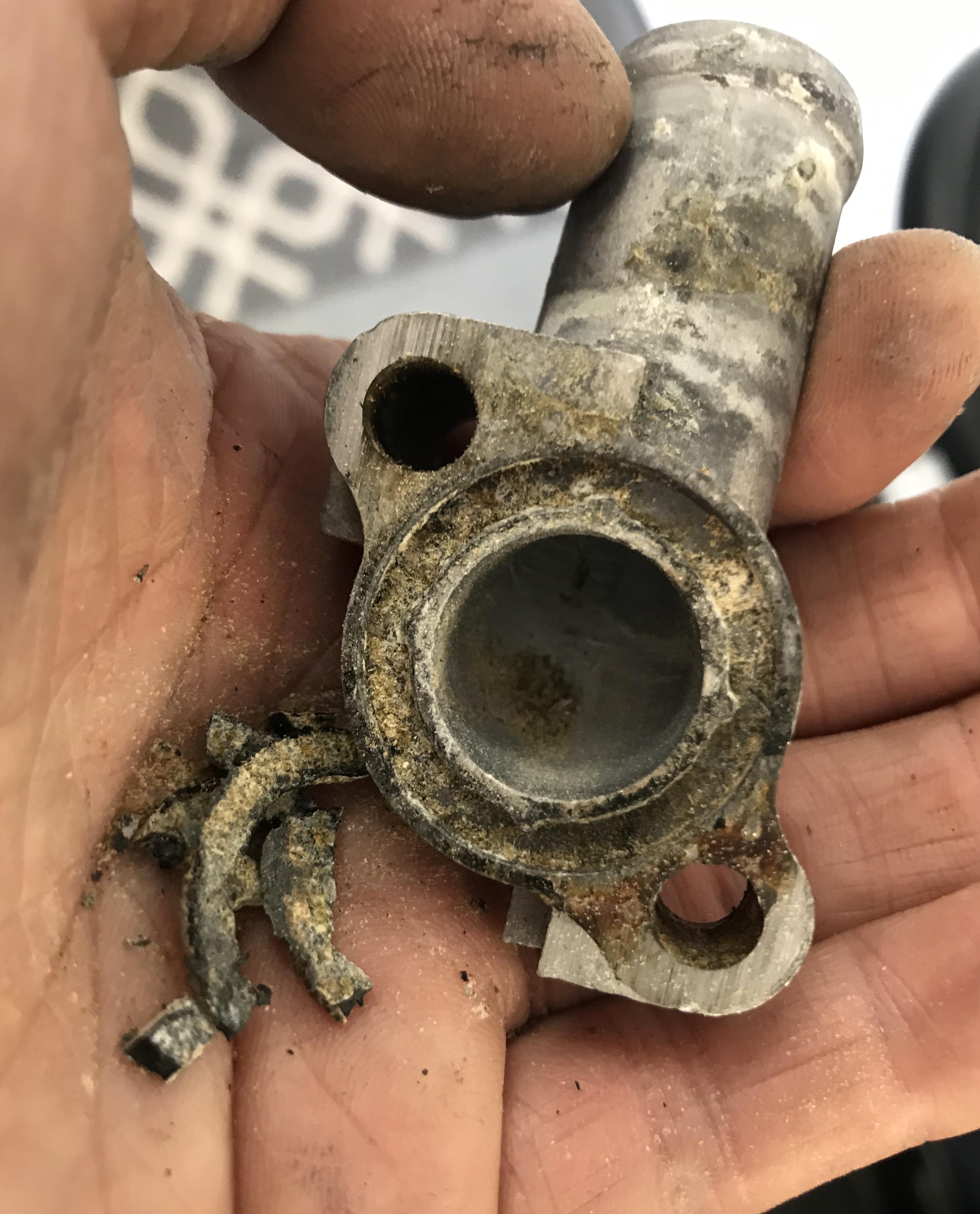

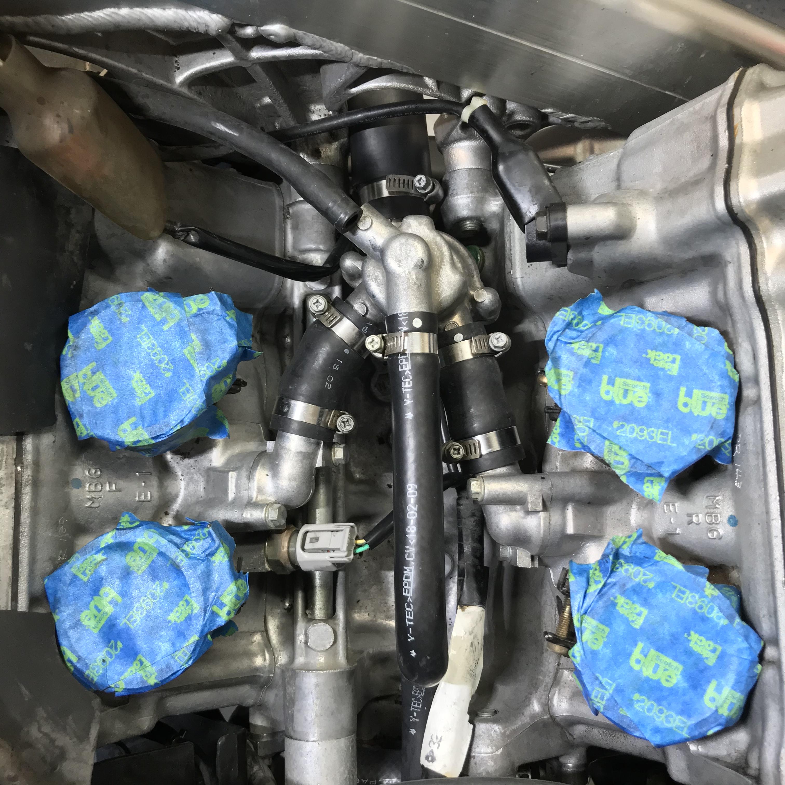

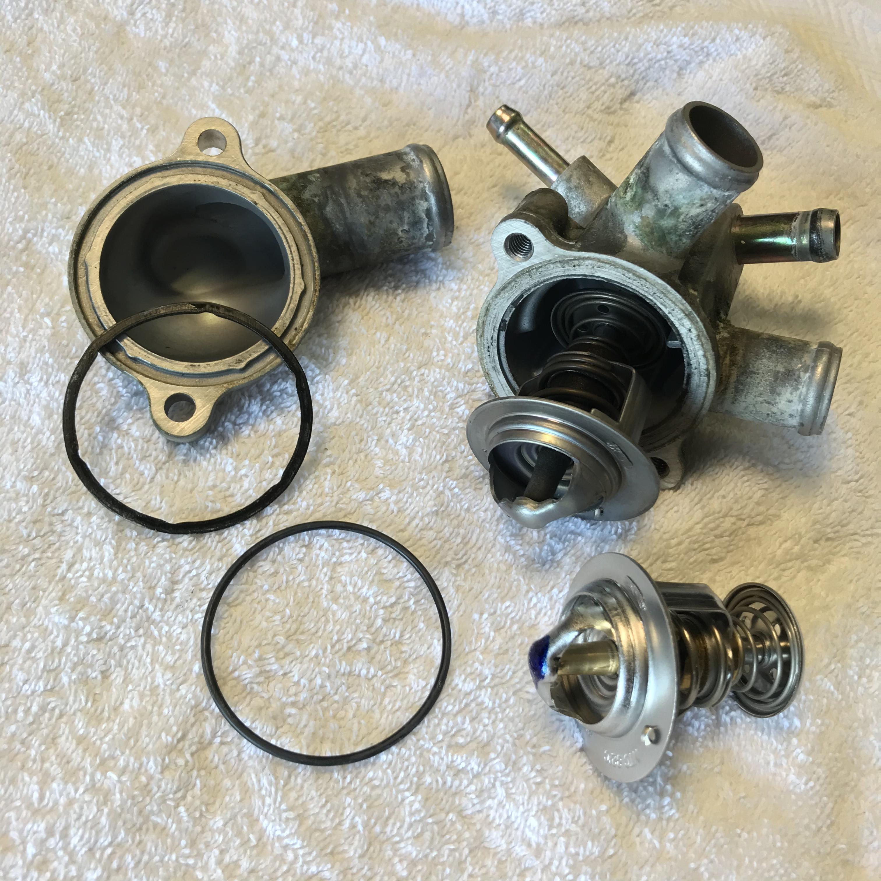

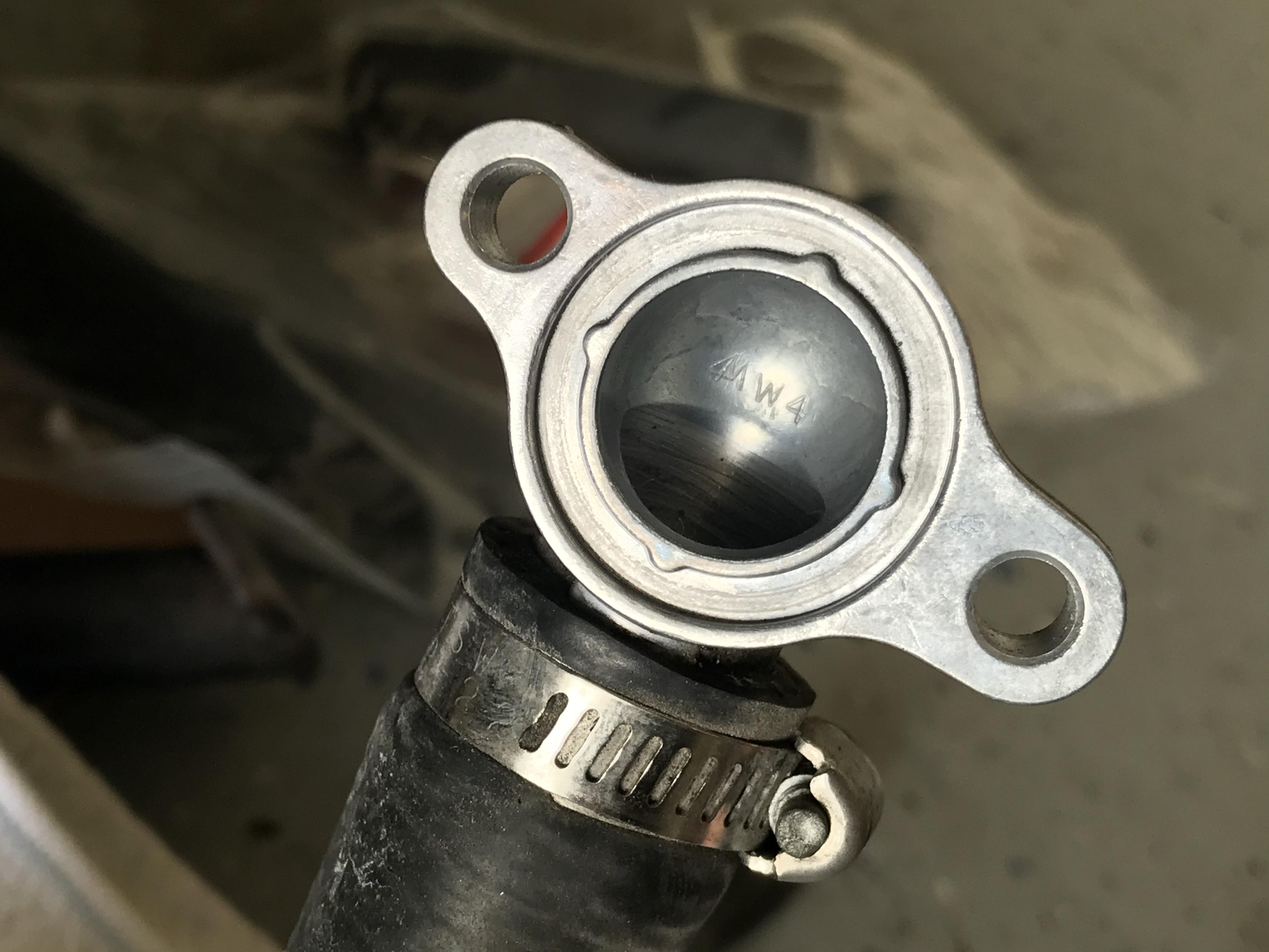

8200rpm Posted March 1, 2020 Author Posted March 1, 2020 It’s coming together now... For anyone replacing hoses, please remember to replace the o-rings in the water joints to the head in between the V and the two on the port side. Inside channels look great! O rings were FLAT and hoses were swollen. This is the condition of the o-rings in the water joints in the V. Fresh o-ring New thermostat and o ring for the housing Looking better... I decided to replace the overflow hose into and out of the reservoir tank and also the air bleed hose from the starboard side radiator to the thermostat housing. Those are still in the mail, so the throttle bodies need to stay off the bike until then. Not being able to ride sucks. 3 Quote
