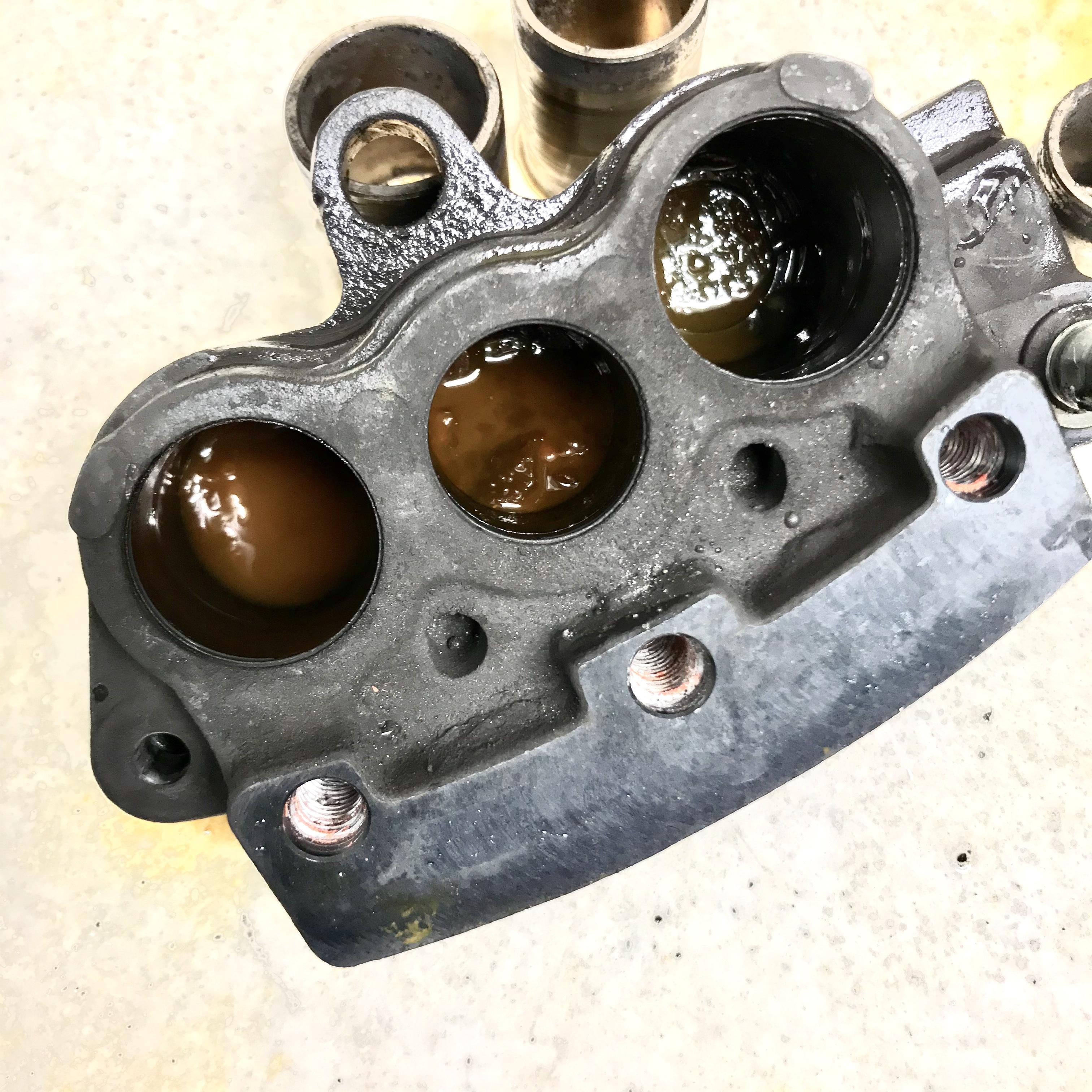

8200rpm Posted December 29, 2019 Posted December 29, 2019 The engineer at Honda who green lighted the combined braking system must have been a masochist, didn’t do his own maintenance or sold his personal motorcycles prior to a brake system tear down. I rebuilt all three calipers (cleaned the pistons, replaced all seals and boots, installed new pads) and the front master cylinder. I would have rebuilt the SMC and rear master cylinder had I known the amounts of disgusting sludge that was in the system. There’s also the delay valve and proportional control valve which aren’t even serviceable units. Short of pulling all the hydraulic lines and tubes and running hot water through it, following the bleeding process in the service manual is the only way to clean out all that sludge. And what a chore that was. I miss the two piston single caliper front with single piston rear brake on my Hawk GT. What an easy affair that would have been to rebuild. 1 Quote
Member Contributer Grum Posted December 29, 2019 Member Contributer Posted December 29, 2019 Great job on the rebuild, but think you shouldn't be too hard on Honda! My three previous VFRs with combined braking systems performed flawlessly. The blame for the terrible state of your hydraulics is the previous owner. If the brakes and clutch were properly flushed/bled within every two years I'd doubt you'd be going through this process. Hope it all goes back together well. Quote

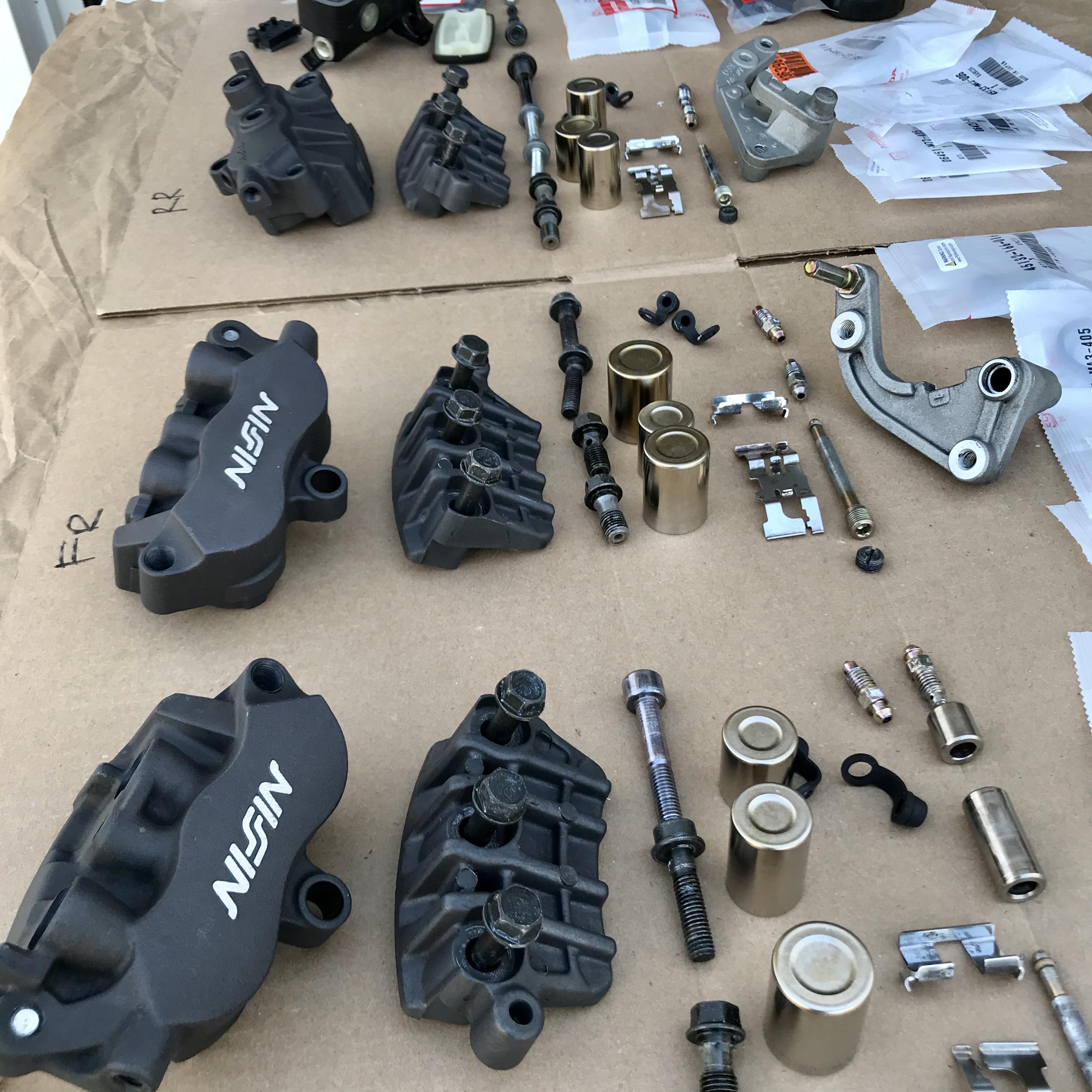

Member Contributer Cogswell Posted December 30, 2019 Member Contributer Posted December 30, 2019 I'm impressed by how methodically you organized all the parts - looks good. Sounds like you have it sorted. Your bike is lucky to have a new owner that's giving it the respect it deserves. 2 Quote
8200rpm Posted December 30, 2019 Author Posted December 30, 2019 30 minutes ago, Cogswell said: I'm impressed by how methodically you organized all the parts - looks good. Sounds like you have it sorted. Your bike is lucky to have a new owner that's giving it the respect it deserves. Thanks. It made re-assembly a lot more efficient. Took the assembly line route and did one task to all calipers at once rather than building one caliper at a time. Quote
