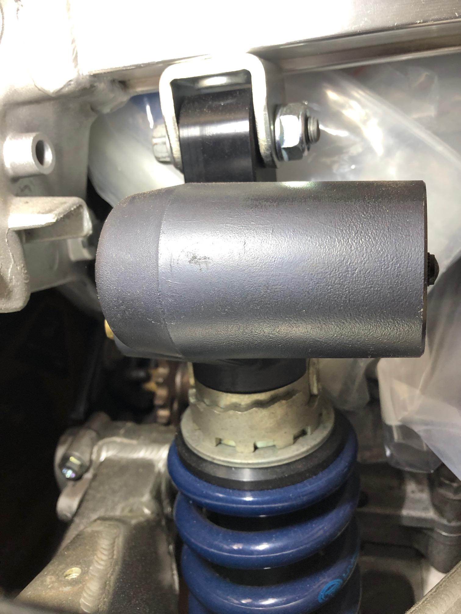

Member Contributer Rush2112 Posted October 18, 2019 Member Contributer Posted October 18, 2019 26 minutes ago, Fritzer said: I just talked with Jamie and he graciously took a little time to educate me on the options. One option was to install his brand new shock with spring at $675. This option brings you into serious racing type speeds. The other option is for me to ship him my showa unit and he revalves, installs new seals, and new spring at $295. This option improves general handling & is good into track day events. In addition to the rear shock, he also recommends respringing/revalving the front forks at $335. If you need the seals and bushing replaced also, that might be additional cost? I am assuming that shipping is in addition to the costs mentioned above. After a talk about my riding style, Jamie felt that the showa rebuild/revalve along with the fork enhancements, I would be a happy camper. And it is not too expensive. So when I get my suspension apart in the dead of winter, I will send Jamie my shock and forks. I will share my findings after the VFR gets its suspenders back on. If your up for it, I would recommend buying a used CBR929 Showa rear shock and send that to Jamie for rebuild/respring. They are cheap on the auction sites and it will give you greater adjustability for compression and rebound dampening and it has an external reservoir to help keep the shock oil cooler and last longer than the original... I'm pretty sure he does it for the same $295 as your stock shock and you will get better performance 👍 Quote
Member Contributer Fritzer Posted October 18, 2019 Author Member Contributer Posted October 18, 2019 1 minute ago, Rush2112 said: If your up for it, I would recommend buying a used CBR929 Showa rear shock and send that to Jamie for rebuild/respring. They are cheap on the auction sites and it will give you greater adjustability for compression and rebound dampening and it has an external reservoir to help keep the shock oil cooler and last longer than the original... I'm pretty sure he does it for the same $295 as your stock shock and you will get better performance 👍 Does it need any modifications to fit into the VFR? Quote
Member Contributer Rush2112 Posted October 18, 2019 Member Contributer Posted October 18, 2019 50 minutes ago, Fritzer said: Does it need any modifications to fit into the VFR? Jamie makes and installs an adapter for the top bolt on the 929 shock that makes it a direct swap out/in with the stock shock and adds a little rear ride height to improve handling. Quote
Member Contributer Fritzer Posted October 18, 2019 Author Member Contributer Posted October 18, 2019 40 minutes ago, Rush2112 said: Jamie makes and installs an adapter for the top bolt on the 929 shock that makes it a direct swap out/in with the stock shock and adds a little rear ride height to improve handling. I just had a email conversation with Jamie regarding the CBR929 to VFR conversion. He has discontinued that option and explains why in this excerpt from his response. The simple answer is no, the 929 shock does not work on your VFR. What we used to do was take about half the parts of a stock CBR929 rear shock and mate them to new parts that we designed and fabricated ourselves to build a shock specifically for the VFR. There are many details to consider when doing this, details most people won't be aware of. Without attending to all of those details the 929 shock would be very dangerous to ride. Since the introduction of our BD40 series rear shocks we discontinued the CBR929 conversions. The BD40 is not much more money but allows us to offer features you can't get using the 929 as the base. The BD40 also offers performance advantages as well. To attempt to adapt a CBR929 shock to your VFR would actually cost more in the end than one of our BD40 shocks. Appreciate the idea anyway. Thanks Quote
Member Contributer Rush2112 Posted October 18, 2019 Member Contributer Posted October 18, 2019 1 hour ago, Fritzer said: I just had a email conversation with Jamie regarding the CBR929 to VFR conversion. He has discontinued that option and explains why in this excerpt from his response. The simple answer is no, the 929 shock does not work on your VFR. What we used to do was take about half the parts of a stock CBR929 rear shock and mate them to new parts that we designed and fabricated ourselves to build a shock specifically for the VFR. There are many details to consider when doing this, details most people won't be aware of. Without attending to all of those details the 929 shock would be very dangerous to ride. Since the introduction of our BD40 series rear shocks we discontinued the CBR929 conversions. The BD40 is not much more money but allows us to offer features you can't get using the 929 as the base. The BD40 also offers performance advantages as well. To attempt to adapt a CBR929 shock to your VFR would actually cost more in the end than one of our BD40 shocks. Appreciate the idea anyway. Thanks No worries, do what works for you and I trust Jamie implicitly. Just for clarity, Jamie isn’t saying the 929 shock is dangerous to ride he is saying if he didn’t attend to all the details it would be dangerous... I just wanted to head that off before any swirl started 😎 Quote
Member Contributer Marvelicious Posted October 19, 2019 Member Contributer Posted October 19, 2019 I was always under the impression that a significant amount of rework went into his revalved shocks. When he started, 929 shocks were his best option. Now that he's built a reputation and a following, being able to work with brand new parts probably allows him to spend his time where it's useful and having his own brand allows him to keep prices competitive. 2 Quote
