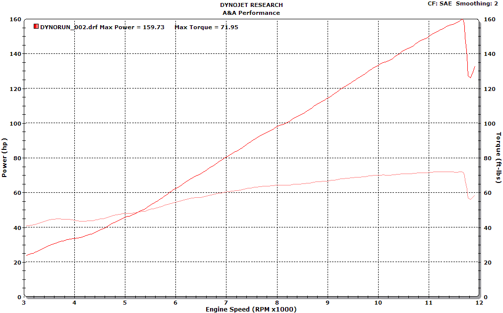

WackenSS Posted June 30, 2020 Author Posted June 30, 2020 OK u have alot more heat 2 dissipate so overheating will be problem, innit ? on a bike prone 2 run run hot alreadi ?? Well one should think so, but actually it is not a big deal with this Nordic climate. Second year with the SS i rode it to Italy so I know what everyone is talking about for sure - almost 2 weeks of no boost and had to make a Heineken roadside cooling duct to keep it under 110° while cruising at 120km/h on the superstrada.In top of that, the loctite on the rotrex pulley gave in due to heat causing catastrophic failure to the splines. Had to go home with the belt in the luggage and limp home keeping it under 5500rpm with PC disconnected and barely any throttle available. Just 2600km...First fire up after parking in my garage at home 2 if my iridums gave in due to an AFR never seen in a vfr before Quote
WackenSS Posted June 30, 2020 Author Posted June 30, 2020 Well, it'll hold this much: How much more does he need?!? (I'm missing my Yellow Peril,,,) Ciao, JZH It was at 183hp/76nm in 2010.Clutch has proven to be rock solid!To be honest, I'm more worried about the transmission and the brakes... Quote
