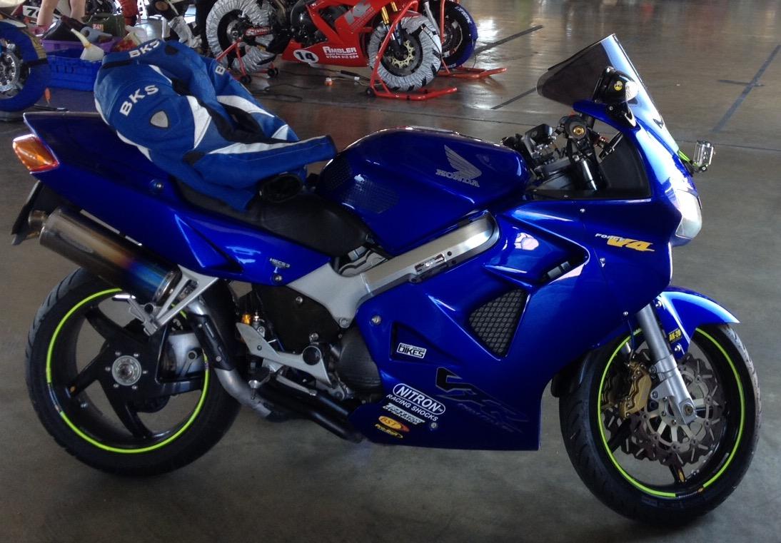

Member Contributer Mohawk Posted June 8, 2019 Member Contributer Posted June 8, 2019 There ya go nice and light BST Carbon Wheels for an RC45, not a straight swap, but worth it IMO, but the price might shock you. Front is 2.25kg, rear is 3kg, these are the road use ones with alloy hubs. The race version are lighter still with magnesium hubs. Stock 5th gen wheels are 4.5 & 6 kg respectively. This setup with Ti front axle & all bolts in the brakes, pinch etc saved 4.5kg of unsprung weight, & in the rear with Ti bolts, my own design Cush drive etc saved 6.5kg, that’s 11kg out of the bikes weight from the best place possible. 2 Quote
Member Contributer FJ12Ryder Posted June 8, 2019 Member Contributer Posted June 8, 2019 Unless your roads are much better than mine, I'd save those carbon fiber wheels for track use only. Light is good, but sometimes light is also fairly fragile. Quote

Member Contributer Mohawk Posted June 9, 2019 Member Contributer Posted June 9, 2019 23 hours ago, FJ12Ryder said: Unless your roads are much better than mine, I'd save those carbon fiber wheels for track use only. Light is good, but sometimes light is also fairly fragile. Can you justify that statement with some technical knowledge ? I used to make this stuff for F1 & Aircraft. The TUV tests in Germany are arguably the toughest in the world. All other manufacturers use one wheel per test, there were 7 tests, so 7 wheels. BST subjected one single wheel of each type to all 7 tests then X-rayed the wheel, followed by chop testing sections & no faults/damage was found. I'd trust these further than I would magnesium or stock cast alloy wheels. The handling is transformed with these, it handles like CBR600RR now. At a trackday last year I was running with a GSXR600 race bike that's much lighter with similar power 👍😎 YMMV 2 Quote

Member Contributer FJ12Ryder Posted June 9, 2019 Member Contributer Posted June 9, 2019 1 hour ago, Mohawk said: Can you justify that statement with some technical knowledge ? I used to make this stuff for F1 & Aircraft. The TUV tests in Germany are arguably the toughest in the world. All other manufacturers use one wheel per test, there were 7 tests, so 7 wheels. BST subjected one single wheel of each type to all 7 tests then X-rayed the wheel, followed by chop testing sections & no faults/damage was found. I'd trust these further than I would magnesium or stock cast alloy wheels. The handling is transformed with these, it handles like CBR600RR now. At a trackday last year I was running with a GSXR600 race bike that's much lighter with similar power 👍😎 YMMV So you subjected BST street motorcycle wheels to these tests, or race wheels and aircraft wheels? Just an opinion about lightweight wheels. I've owned some lightweight wheels for my bicycle and they generally have caveats about very rough roads or too much weight. I've seen heavyweight steel and aluminum wheels severely dented/cracked by an unavoided monster pothole or object in the road. I wonder how these lightweight wheels would have reacted to that kind of severe input. You ride what you want, and I'll ride what I want, and we'll both be happy. But my opinion still stands, but it's just an opinion. Quote
Member Contributer Mohawk Posted June 10, 2019 Member Contributer Posted June 10, 2019 I didn't test any wheels, BST the company that make them put them through the TUV acceptance tests as required to sell them in Europe, as do all other manufacturers. But the point was BST have enough faith in their product to use a single wheel for all seven tests. Where as every other manufacturer uses a single wheel per test, as they don't believe their wheels could survive all the tests ! Light does NOT mean weak, check the next plane you fly on, not alot of steel there. Any older 737/757/767 or 747 you fly on, I & some colleagues made the carbon material for our sister factory to make the floor panels that your seat is attached to & that you walk on to it. They have had millions of feet, thousands of flights/landings & are still going strong. Just because certain cycling parts are made a bit flimsy, does not mean all carbon parts are. BST wheels have a 400Kg weight rating ! https://intheknowcycling.com/2018/10/14/carbon-road-bike-wheels/ The other major difference, is that alloy or metal wheels have ZERO bend tolerance, so hitting a big pot hole or large rock, will dent them if the tyre deflects enough. A carbon rim has some structural flex in these extreme circumstances, so is less likely to permanently deform, plus being lighter, they experience less impact force to begin with & the suspension can deflect faster due to their reduce inertia. Bicycle rims, have basically NO tyre suspension, racing tyres are pumped to silly pressures, to reduce rolling resistance, which means most shock gets transmitted straight to the wheel rim, especially hard edges of pot holes for example. Motorcycle tyres have a good depth of tyre to absorb a lot of impact & are attached to suspension where as most road bicycles don't have suspension. I've dented a few steel & alloy bicycle rims in my life, plus a couple of motorcycle alloy ones too. But yes, feel free to use what suits you. 4 Quote

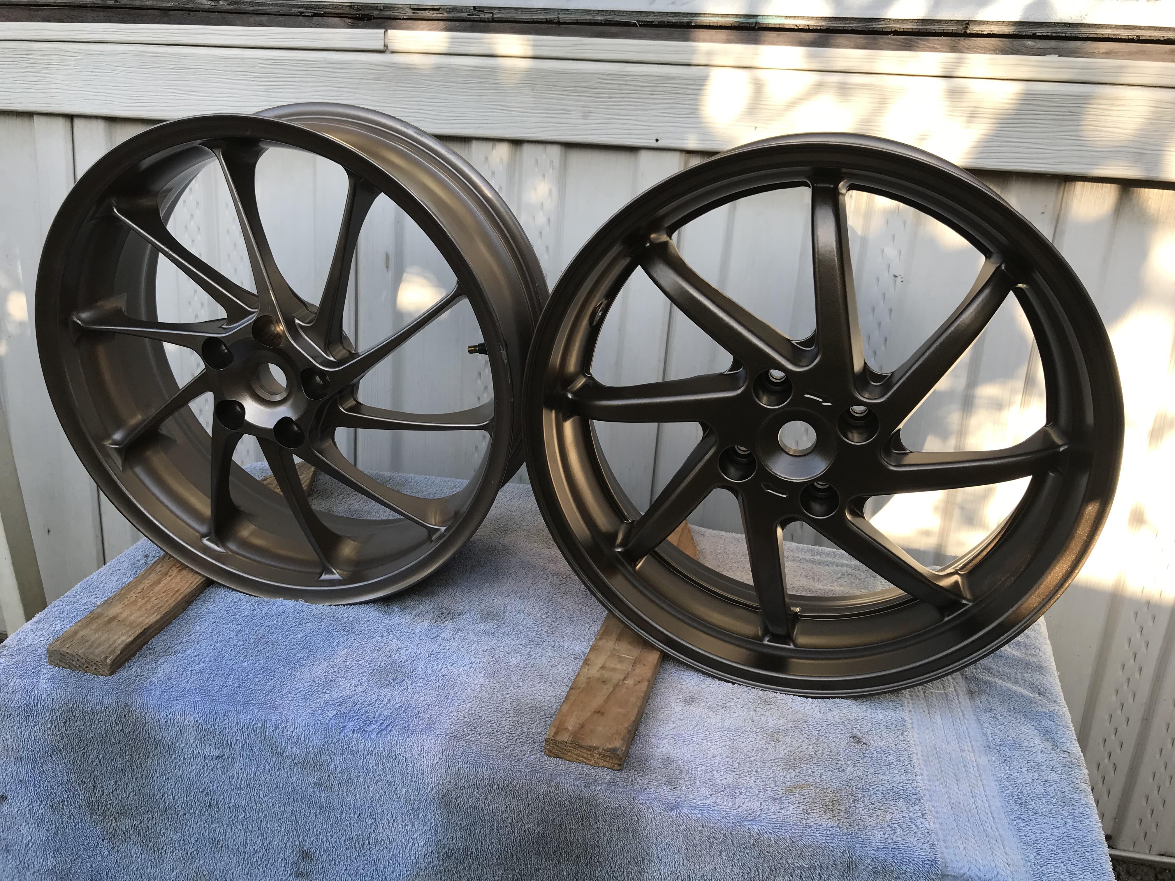

Member Contributer sfdownhill Posted June 28, 2019 Member Contributer Posted June 28, 2019 Here’s the admittedly subtle difference between Honda Pyrite Brown Metallic (8 gen accent color) and the way my powdercoater applied Prismatic Triple Bronze. I recommend that anyone having powdercoating done with a specific color in mind have a test part done or at least get color swatches. Quote
Member Contributer adkfinn Posted June 28, 2019 Member Contributer Posted June 28, 2019 36 minutes ago, sfdownhill said: Here’s the admittedly subtle difference between Honda Pyrite Brown Metallic (8 gen accent color) and the way my powdercoater applied Prismatic Triple Bronze. I recommend that anyone having powdercoating done with a specific color in mind have a test part done or at least get color swatches. Sorry you had to find out the hard way, but thank you for sharing your experience with us so that others can avoid this mistake. 1 Quote
SEBSPEED Posted June 29, 2019 Posted June 29, 2019 19 hours ago, sfdownhill said: Here’s the admittedly subtle difference between Honda Pyrite Brown Metallic (8 gen accent color) and the way my powdercoater applied Prismatic Triple Bronze. I recommend that anyone having powdercoating done with a specific color in mind have a test part done or at least get color swatches. It doesn't appear to be top coated with clear powder, you might try having them shoot you a sample with clear on top. It will change the look of the base coat, most always lightening it a few shades. Might get you close enough - if so, they can simply top coat your parts for the same effect. Quote
Member Contributer sfdownhill Posted June 29, 2019 Member Contributer Posted June 29, 2019 8 hours ago, SEBSPEED said: It doesn't appear to be top coated with clear powder, you might try having them shoot you a sample with clear on top. It will change the look of the base coat, most always lighter ing it a few shades. Might get you close enough - if so, they can simply top coat your parts for the same effect. Cool - thanks Seb. A clear topping coat is a good idea - like adding whipped cream to anything - might very well lighten things up. I will check w the applicator and see if he’s up for a test. Quote

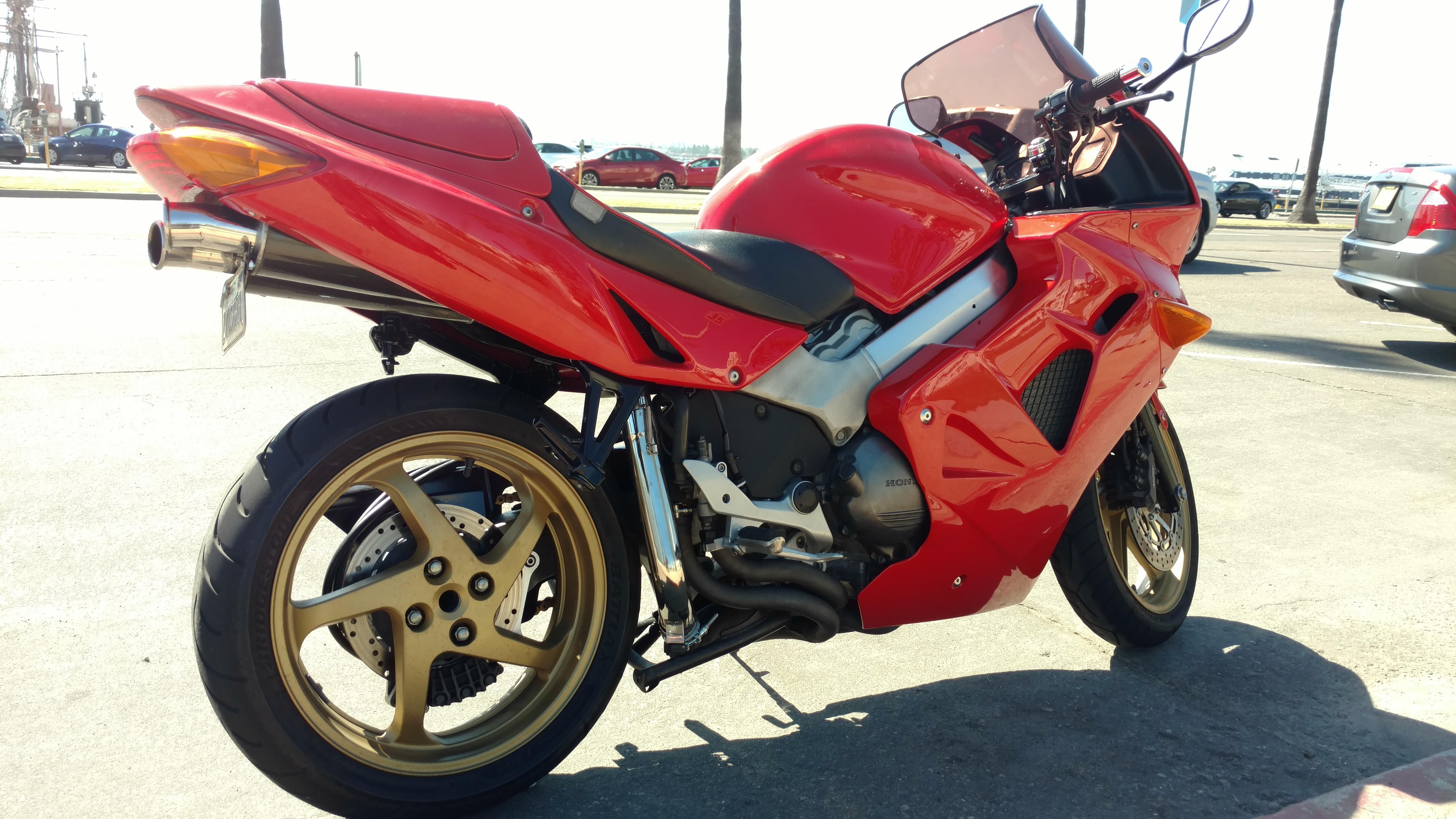

dozyproductions Posted September 14, 2019 Posted September 14, 2019 Black isn't the worst choice ;D Hides the dirt! I've been powdercoating my wheels gold for every red VFR I get. Looks AMAZING, but it definitely let's everyone know when they're dirty or not haha. (Clear coats on top should be a given) Then again, you should clean them every week anyways. Here's a picture for any reference. 3 Quote
