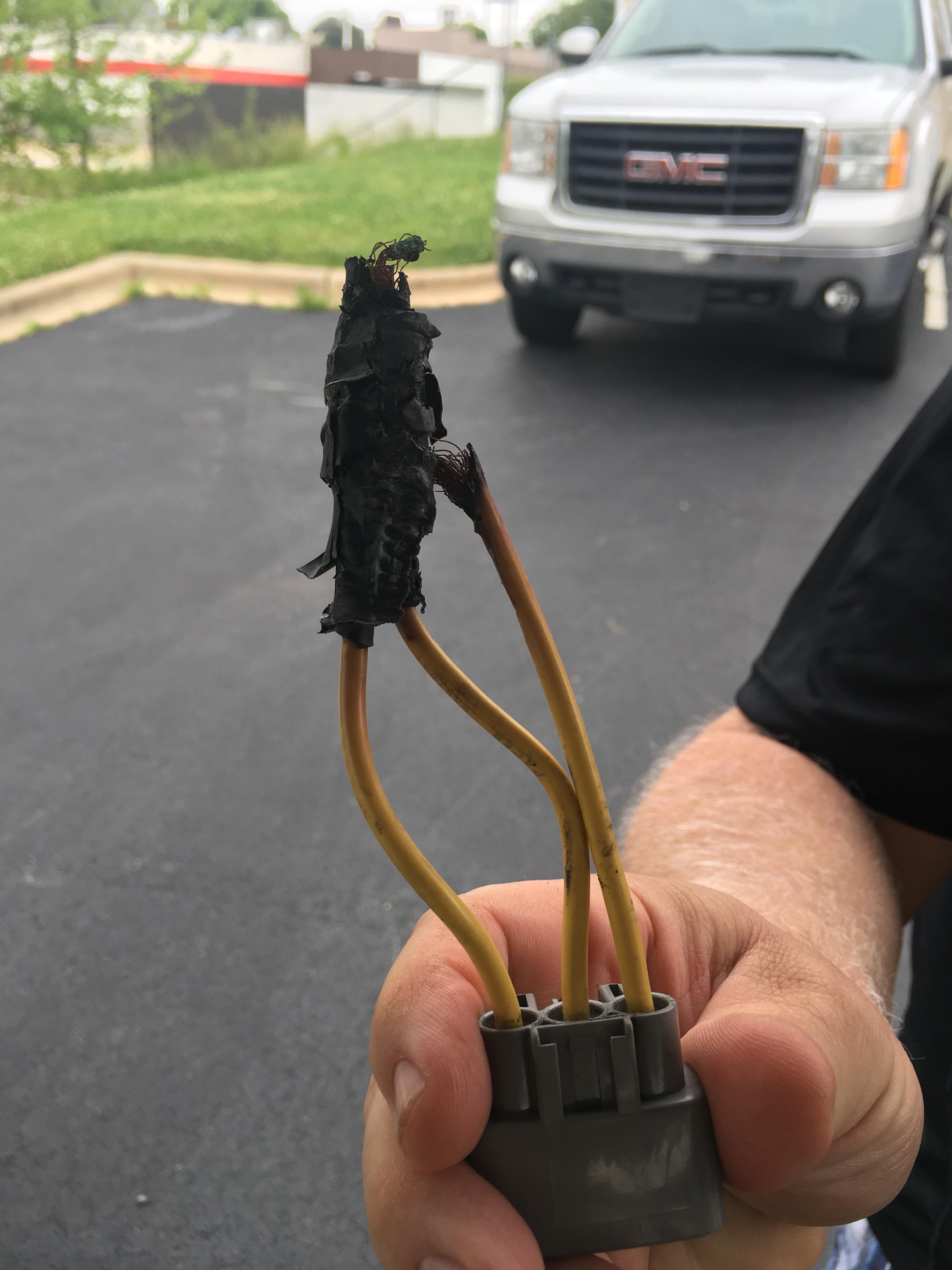

Sweeper Posted November 29, 2018 Posted November 29, 2018 So, mine turned out to be a bad splice? The stator and r/r had been replaced by the previous owner. They both checked out fine but we started looking at a ball of electrical tape and found that the heat had melted the splices, heat shrink, and the tape into a ball. If you end up in this place, don't wrap the wires together. Just an example of how much heat they can make without a fuse blowing. May or may not have something to do with spending that whole day riding in a down pour. 3 Quote

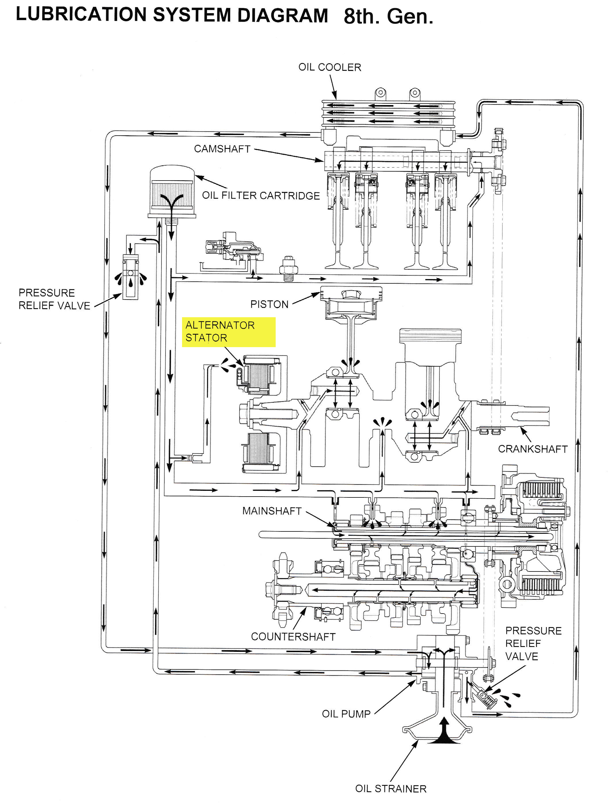

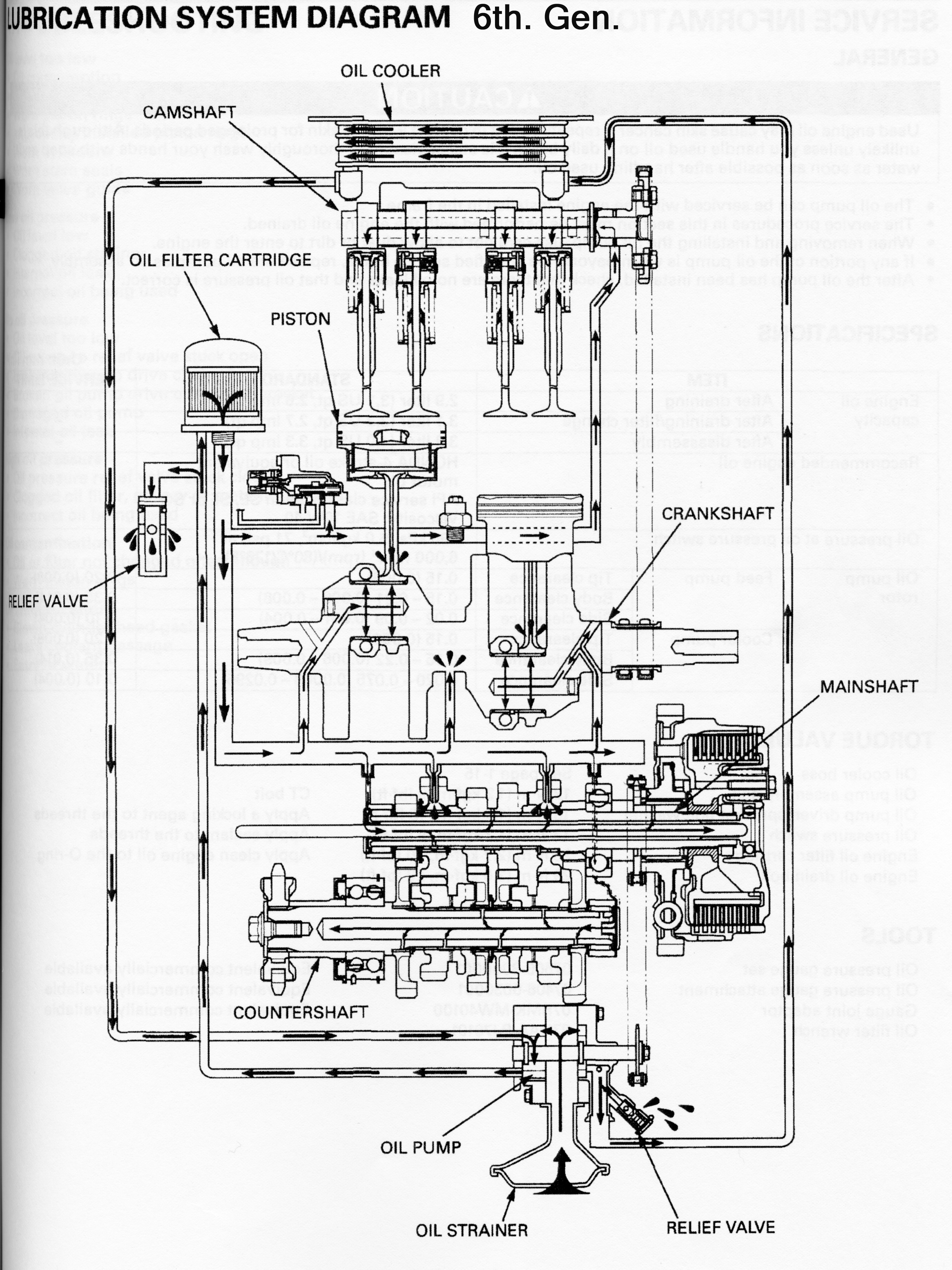

Member Contributer Grum Posted November 30, 2018 Member Contributer Posted November 30, 2018 18 hours ago, anth85 said: thanks, guys. From posting on another forum, they suggested it's most likely the R/R. I've already sorted a new battery being delivered tomorrow since I'd paid for one anyway and since the R/R is supposed to be a weak point on these bikes I figured I'd put a new one on anyway for peace of mind. I'd have liked to test it first, but I'm at work at my voltmeter isn't, if I don't order today it won't come before the weekend so I'd most likely have to limp around on it for longer. Hi Anth85. Disagree with the statement of the R/R being the weak point. There are far more Stators that have failed than R/R's. Just unplug the connector to your R/R with the three yellow wires, measure the wires (from the non R/R side) to Ground, there should be no sign of low resistance if there is your Stator is shorted to ground, a very common issue with 6th gens. This issue appears to be caused by a lack of cooling oil over a specific area of the stator, they all seem to fail in the same area on the stator. Interesting the 8th gen has added forced oil cooling to resolve this situation. My own personal experience with the 6th gen is two failed stators and no issues with the R/R. Cheers. 3 Quote

Member Contributer JZH Posted November 30, 2018 Member Contributer Posted November 30, 2018 9 hours ago, Grum said: Interesting the 8th gen has added forced oil cooling to resolve this situation. What did they change? Ciao, JZH Quote
Member Contributer Grum Posted November 30, 2018 Member Contributer Posted November 30, 2018 12 minutes ago, JZH said: What did they change? Ciao, JZH Hi JZH. Check out the lubrication drawings for both 6 and 8 gen, notice the addition of the oil spray for the 8gen stator. Cheers. 2 Quote
