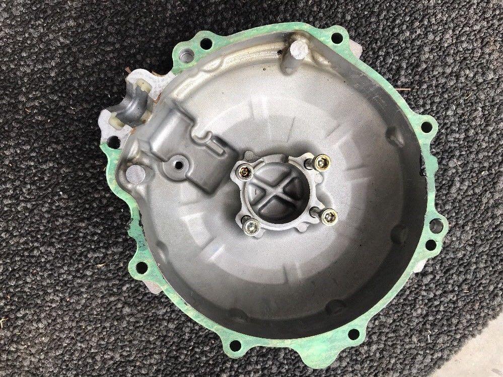

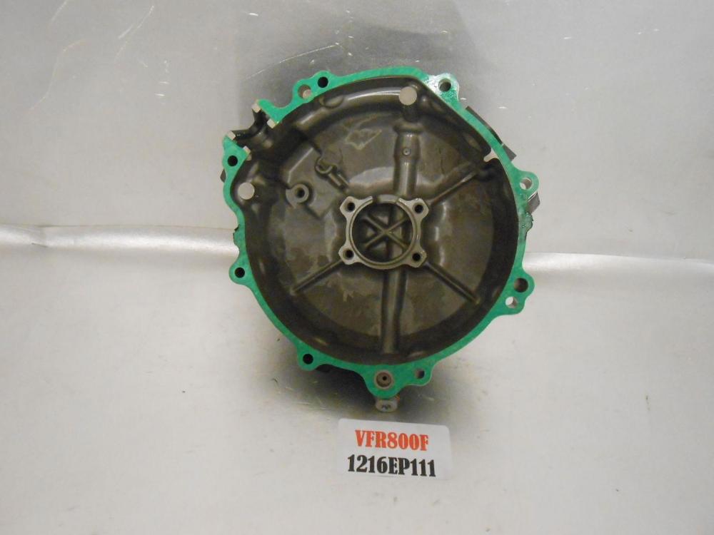

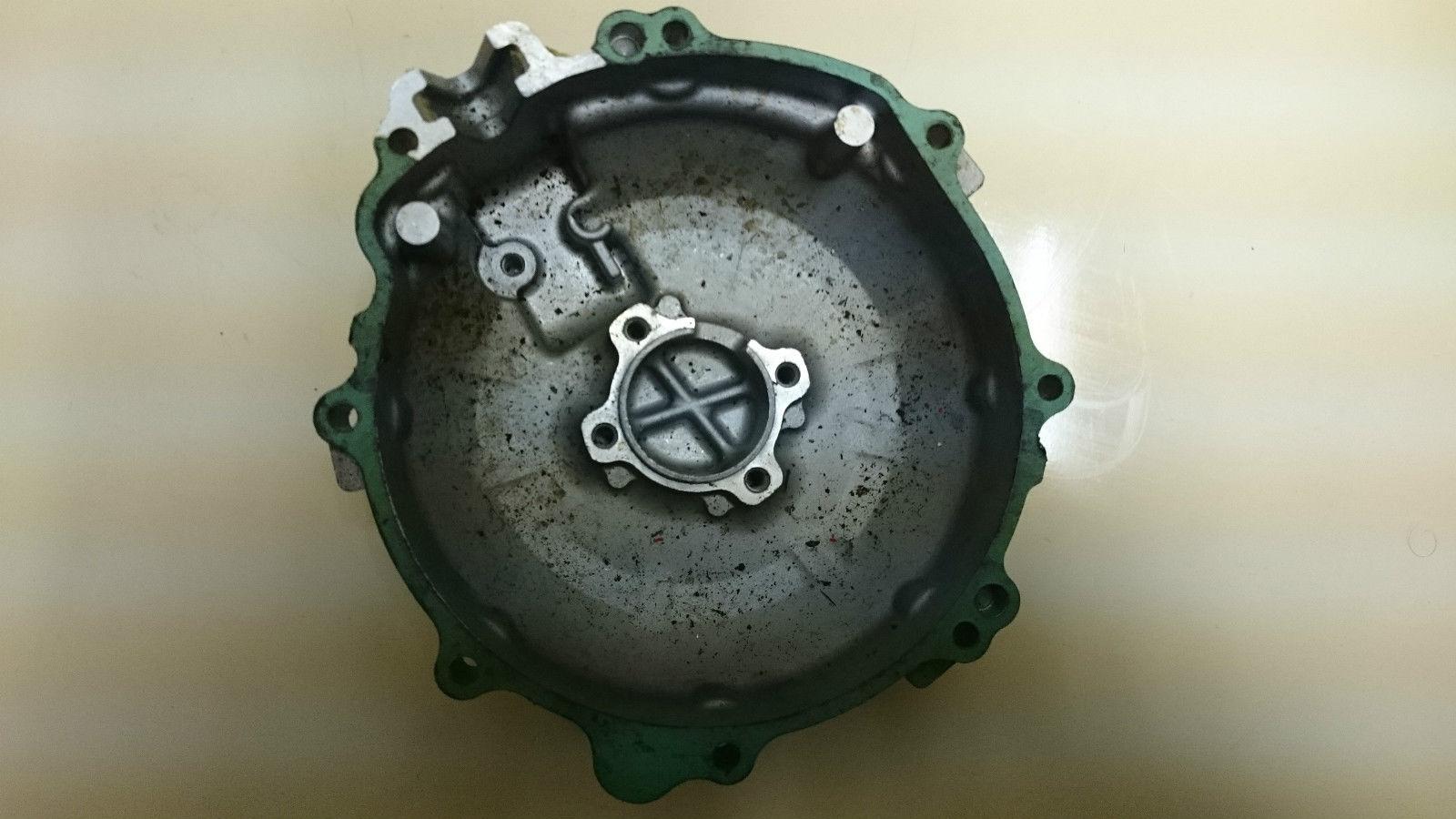

Member Contributer JZH Posted November 30, 2018 Member Contributer Posted November 30, 2018 12 hours ago, Grum said: I wonder if it's retrofit-able? Engines are very similar...but I assume they've drilled the case, because I don't see any specific part in the microfiche that would spray oil onto the top of the stator. Ciao, JZH Quote

Member Contributer Grum Posted December 1, 2018 Member Contributer Posted December 1, 2018 5 hours ago, JZH said: I wonder if it's retrofit-able? Engines are very similar...but I assume they've drilled the case, because I don't see any specific part in the microfiche that would spray oil onto the top of the stator. Ciao, JZH The 8gen Stator housing is very different to the 6gen. Firstly, there is the addition of a Magentic Pole sensor and its wiring plus the 3 phase Stator output wires. Secondly, there is a built in oil gallery that has an orifice coupling to the engine housing, this ports oil to the stator windings giving it good heat transfer. The other big plus as to why we are not hearing of electrical issues with 8gens is the fancy new efficient R/R and lighter electrical loads. Cheers. 2 Quote

Member Contributer JZH Posted December 7, 2018 Member Contributer Posted December 7, 2018 On 12/1/2018 at 4:04 AM, Grum said: The 8gen Stator housing is very different to the 6gen. Firstly, there is the addition of a Magentic Pole sensor and its wiring plus the 3 phase Stator output wires. Secondly, there is a built in oil gallery that has an orifice coupling to the engine housing, this ports oil to the stator windings giving it good heat transfer. The other big plus as to why we are not hearing of electrical issues with 8gens is the fancy new efficient R/R and lighter electrical loads. Cheers. Seems we're hijacking the thread slightly, but check this: 2014 VFR800F 2002 VFR800 VTEC 1998 VFR800FiW I suspect the 8th gen engine case is also drilled (so a retrofit is looking unlikely), but it is funny that the stator covers have always had that large blank pad area now being used for the oil feed... Ciao, JZH 3 Quote
