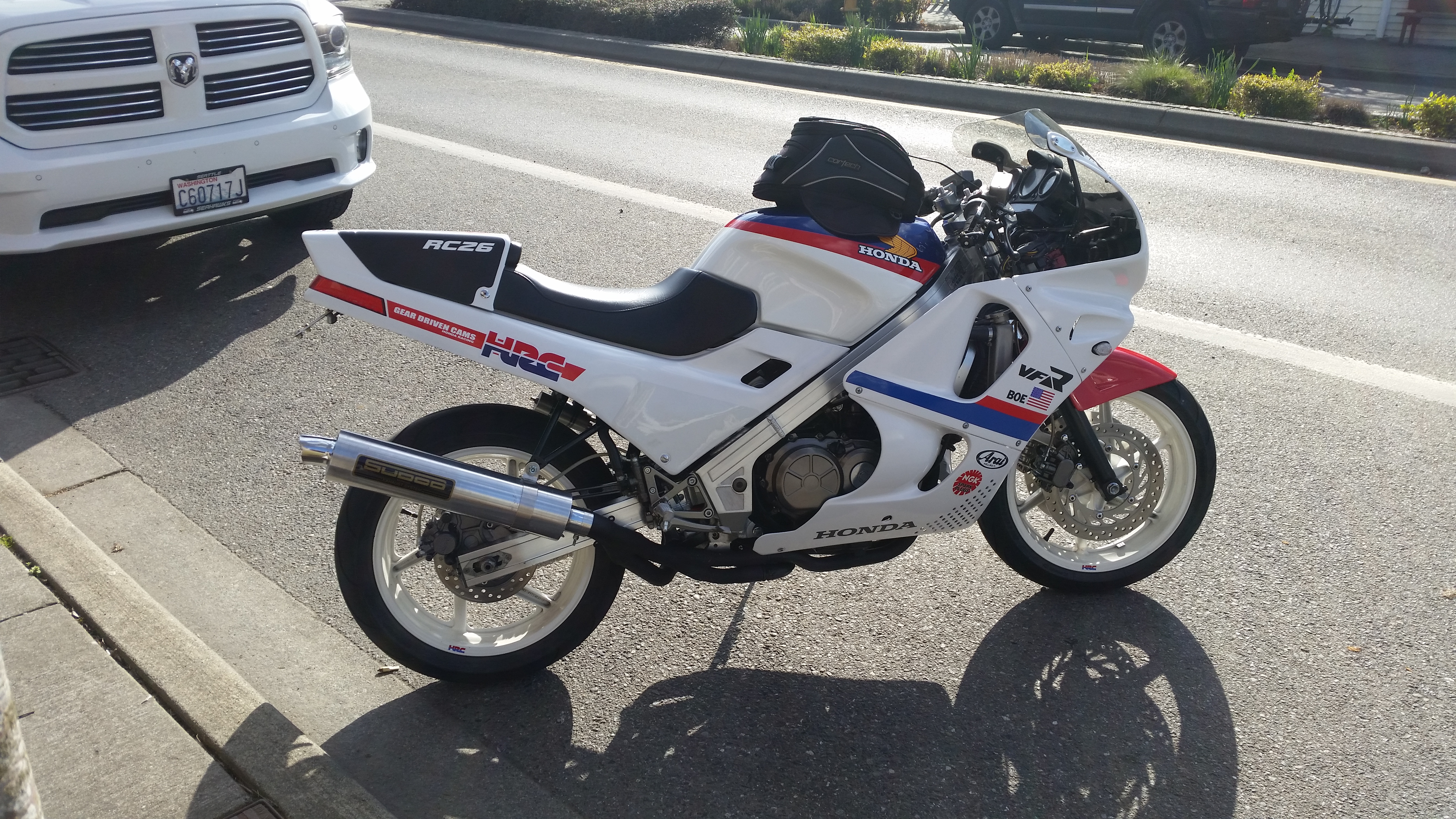

Member Contributer Captain 80s Posted April 1, 2018 Author Member Contributer Posted April 1, 2018 Got out for some road miles in the new livery finally. Some nice roads along the Snohomish River. This bike is so capable it's rediculous. Need to dial the suspension repeating the same secluded bumpy twisty road soon. Quote

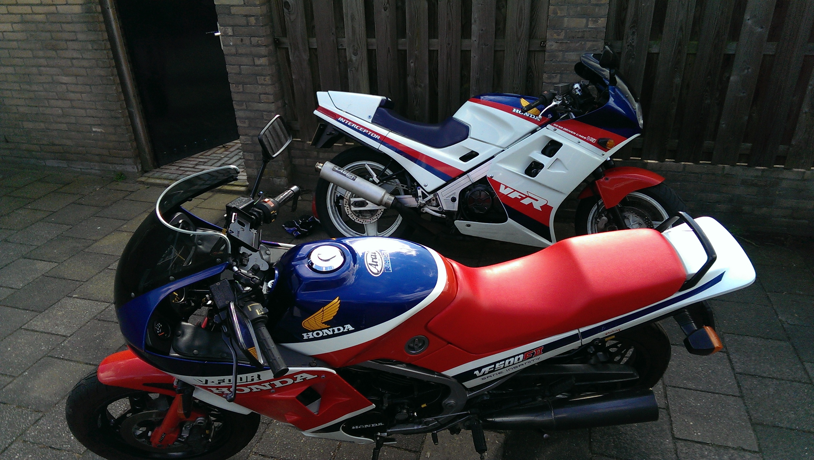

Member Contributer Dutchy Posted April 1, 2018 Member Contributer Posted April 1, 2018 RWB's remain a thing of beauty..... Yours clearly is in the category: "All VFR's are beautiful, but some VFRs are more beautiful than others" -George Orwel Here 2 regular pigs... Quote

Member Contributer Dutchy Posted April 1, 2018 Member Contributer Posted April 1, 2018 the RC24 is not mine.... Quote
Member Contributer Popular Post Captain 80s Posted February 3 Author Member Contributer Popular Post Posted February 3 Been a few years of trouble free goodness. The bike continues to be very capable and fun. The need for new tires inspired me to put together a "RC26-II" Upgrade Kit. Restored F3 forks with RT Springs. F3 front wheel. Brand new front Nissin calipers and pads. F3 5.0" rear wheel with a matching rear caliper. New rear brake arm solution. Real clean and simple. 11 1 Quote

keny Posted February 14 Posted February 14 On 2/3/2025 at 6:50 PM, Captain 80s said: a "RC26-II" Upgrade Kit. Restored F3 forks with RT Springs. F3 front wheel. Brand new front Nissin calipers and pads. F3 5.0" rear wheel with a matching rear caliper. So did you go up in rear tire size as you got a wider rear rim? Quote
Member Contributer Captain 80s Posted February 14 Author Member Contributer Posted February 14 3 hours ago, keny said: So did you go up in rear tire size as you got a wider rear rim? Nope. 160/60-17, just like the F3 had. Puts a real nice profile on it. Just like my Hawk with a 5.0" VFR wheel. No reason to go to a 170, bike doesnt need it and they are just more expensive. Not wide enough for a 180 and again, the bike doesn't need it and I wouldn't want it anyway. 1 Quote
