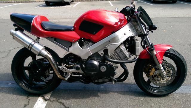

Member Contributer vfrAustin Posted September 20, 2014 Member Contributer Posted September 20, 2014 I recently modified my 99 VFR800 to a naked and used one side radiator at the front. I relocated the stock oil cooler to the front lower area behind the headers. My concern is that the smaller rad, although in a better location up front, may not keep the engine cool enough. There is plenty of room for a larger, much larger, oil cooler. Should this be a great help in keeping the engine cool? Are oil coolers very effective in cooling? I do not want to change my rad set up. Any input would be appreciated. Thanks Quote

Member Contributer Mohawk Posted September 21, 2014 Member Contributer Posted September 21, 2014 Is there enough clearance under that rad for the front wheel ? It might hit at full compression ! The oil cooler can help, a bigger one would reduce the temp of the oil returned, but it would work better if placed in front of the header pipes. The cooler lines on the VFR feed the cooled oil to the high pressure pump pickup chamber, so it will have an effect. That said the oil needs to be at a reasonable temperature to do its job properly. Too cold allows sloppy plain bearing fit, to hot causes seizure, so there are limits, as oil was NOT intended specifically as a coolant in this engine. Looks good. Quote

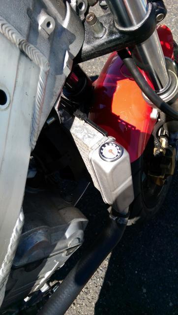

Member Contributer vfrAustin Posted September 27, 2014 Author Member Contributer Posted September 27, 2014 Ok,a couple updates. I installed a thermometer but did not install the oil cooler yet. Conditions of ride. 80 degrees and full Sun. I installed this thermometer that extends into the right side of the rad. Yes, some call it a meat thermometer. A thermometer is a thermometer. I was averaging 180 to 190 degrees. In town I saw 200 at low speeds. Quote
Member Contributer gll429 Posted September 28, 2014 Member Contributer Posted September 28, 2014 I installed this thermometer that extends into the right side of the rad. Yes, some call it a meat thermometer. A thermometer is a thermometer. I was averaging 180 to 190 degrees. In town I saw 200 at low speeds. AWESOME!!!!!! just how did you do it? Quote
Member Contributer vfrAustin Posted September 28, 2014 Author Member Contributer Posted September 28, 2014 Be sure the length is a match. Heat range is perfect and glass lens. Get drill bit with exact match. Exact, test on sacrificial metal. Drill at desired location. Very thin so very easy hole. Add high temp silicone to top of shaft and area that will seat. Insert and walk away. Let cure. Done, $7.68 Quote
Member Contributer gll429 Posted September 28, 2014 Member Contributer Posted September 28, 2014 dude.. you drilled a hole in a pressured system and used silicone to hold it??? how long has it been on there? i really thought you trimmed that shafter and epoxied the sucker or something .. never guessed you drilled a hole. Quote
Member Contributer vfrAustin Posted September 28, 2014 Author Member Contributer Posted September 28, 2014 Yes I did and rode for hours minutes after I installed actually. There is a nice ample footprint for a gasket to form. Got a good ride in. Time will tell. No reason for me to feel it will fail. If it does I just use a dab of JB. We are talking a tiny perfectly plugged hole. Each there own. Quote
mello dude Posted September 28, 2014 Posted September 28, 2014 Dude, I thought you welded or brazed or something like that. Quote

Member Contributer vfrAustin Posted September 28, 2014 Author Member Contributer Posted September 28, 2014 "Dudes" , it will hold. I did advanced hydrodynamic calculations. Plus, the cap blows at something like 16 so that is all it will need to hold. Stop worrying, it,s just metal.. Quote
SEBSPEED Posted September 29, 2014 Posted September 29, 2014 And if it doesn't hold, you know where to go to have that tiny hole welded up... Quote
Member Contributer YoshiHNS Posted September 29, 2014 Member Contributer Posted September 29, 2014 Did you test that meat thermometer? I bought one, and it wasn't close to being accurate. When a glass of ice water registered at 24F, it got tossed in the 'not for flight' parts bin. Quote
Member Contributer vfrAustin Posted September 29, 2014 Author Member Contributer Posted September 29, 2014 Someday I will test. Now I ride!!!! And if it doesn't hold, you know where to go to have that tiny hole welded up...[/quote Thank you in advance, maybe? Fat lady is silent... Quote
SEBSPEED Posted September 29, 2014 Posted September 29, 2014 Gotta say, I have my doubts re: the slip fit and silicone. This weekend will be a good test. I have a few spare rads here just in case... Quote
