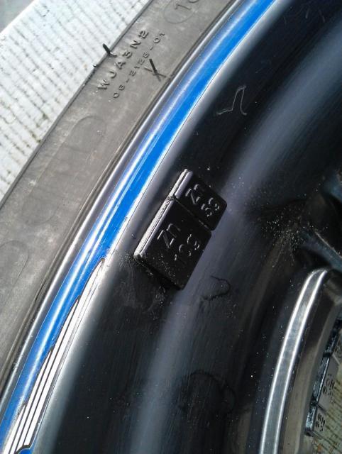

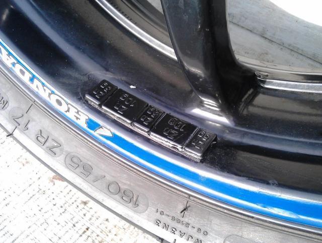

Member Contributer Dutchy Posted November 11, 2013 Member Contributer Posted November 11, 2013 Had my rear wheel balanced on Saturday. When the PP was fitted the balancer machine was not yet in (new shop starting out). I did notice some imbalance it at certain speeds so now the machine was in, it got done It needed 35gramms on one side and 15 on the other. Got the rattle can out to hide the weights somewhat. So if deflating the tire and rotating a bit will eliminate -some- of the imbalance, I will ask him to try this next time/tire...

Member Contributer apexandy Posted November 12, 2013 Member Contributer Posted November 12, 2013 Had my rear wheel balanced on Saturday. When the PP was fitted the balancer machine was not yet in (new shop starting out). I did notice some imbalance it at certain speeds so now the machine was in, it got done It needed 35gramms on one side and 15 on the other. Got the rattle can out to hide the weights somewhat. IMAG2386.jpg IMAG2387.jpg So if deflating the tire and rotating a bit will eliminate -some- of the imbalance, I will ask him to try this next time/tire... Spray paint on your newly powdercoated wheel???
Member Contributer Dutchy Posted November 12, 2013 Member Contributer Posted November 12, 2013 I taped off the rim and any stray paint removed with some terpentine! I like a clean rim!
keny Posted November 12, 2013 Posted November 12, 2013 It needed 35gramms on one side and 15 on the other. Got the rattle can out to hide the weights somewhat. There is actually black colored weights awable, so no spay can would be needed. I had the guy that painted my wheels HRC gold paint a few weight straps same color to get a nice look as i change tires.....HRC gold weights not awable in shops....
