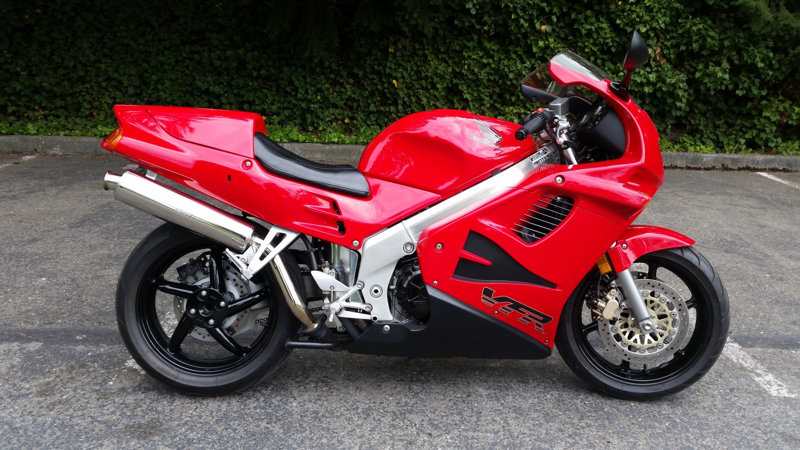

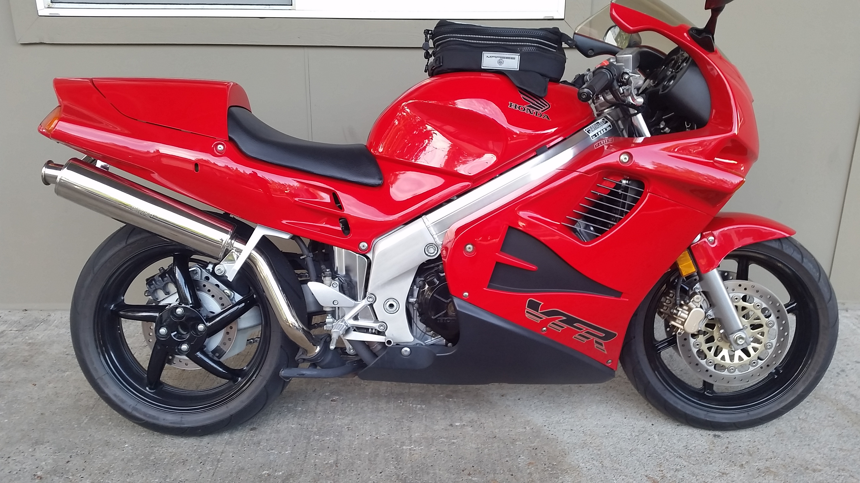

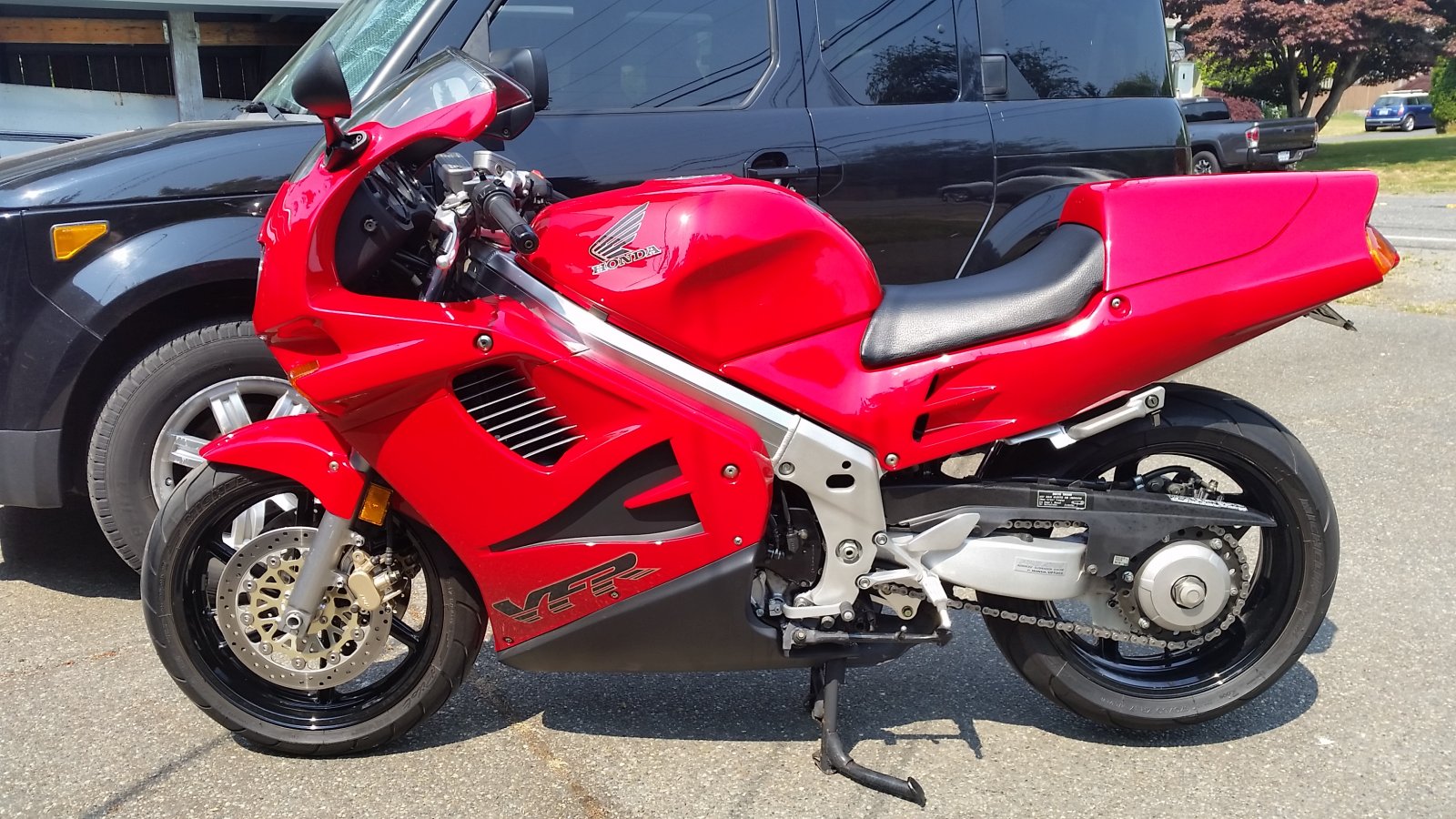

I had been looking locally for a very nice 94 - 97 VFR for a couple years with no luck.  There were some examples, but none were as nice as I wanted or cheap enough to change my mind to a project.  This is the day my 95 rolled out of the transport van from across the country.
11K miles.  Two seats, this modified one and a stock one that was still to arrive in a box, along with another seat cowl and the original mirrors.  Damn near perfect.

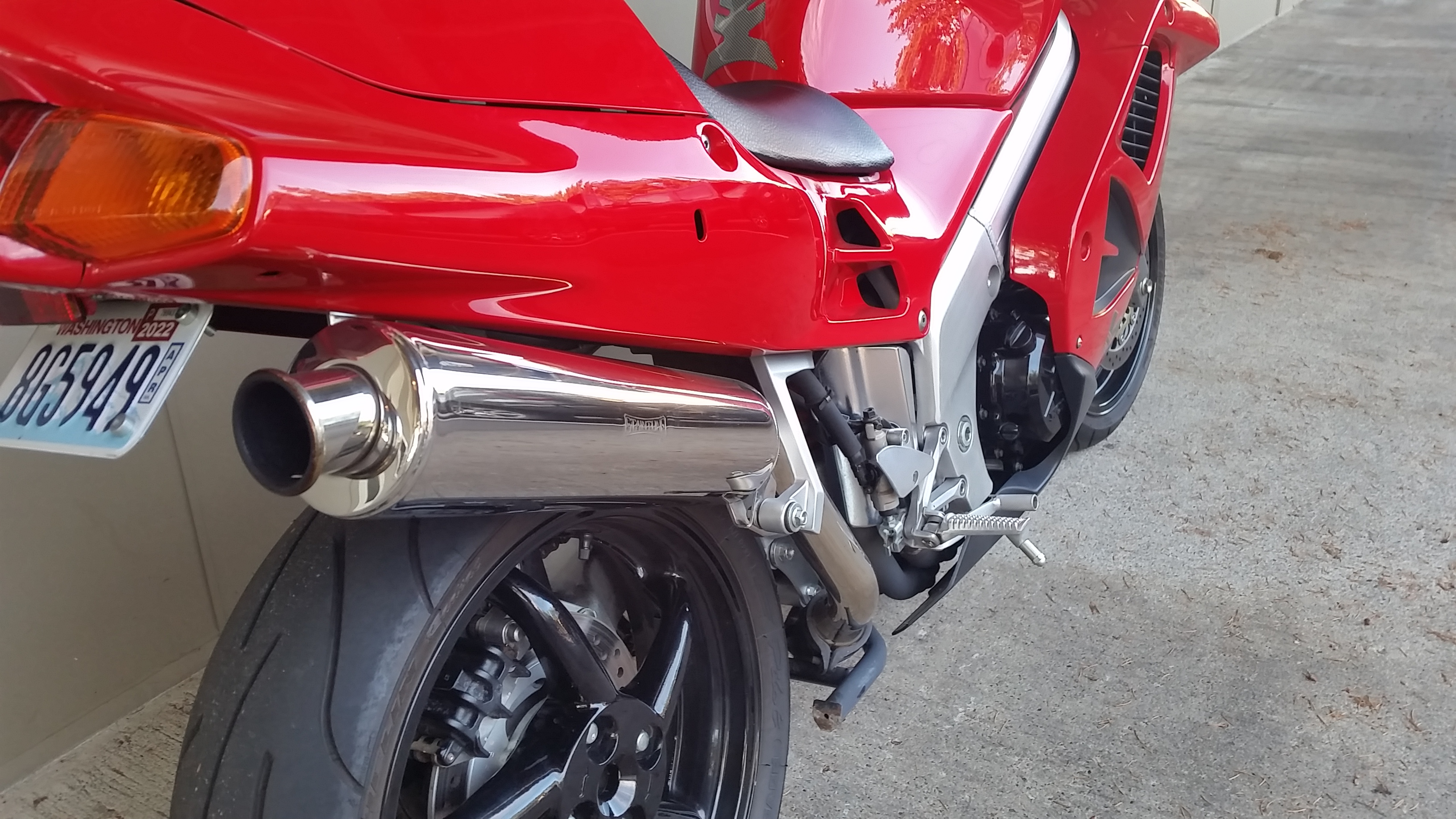

Well, it arrived last Summer and I had some great rides on it in between painting my house.  The Staintune sounds just lovely and the bike runs perfect.  I did a couple small things, one of which buying another set of passenger pegs and doing a delete.
If the muffler didn't have that lower mount I wouldn't have bothered on the right side.  But I didn't want an empty bracket hanging there and I sure as shit was not gonna start cutting and grinding on the Staintune.  Took HOURS to get it right.  I had to fill and shape the voids after removing that much bracket.  I could have always went with a welded up or custom alloy bracket, but I wanted to at least try and mod the Honda piece for a somewhat stock-ish look.  It actually looks way better in person, that is as small as I could make it and have something left to work with.
Left side was "easy".  Still had a pretty good amount of time shaping and blending.  Wanted to retain seat latch and handle.
Then this Summer I was balls deep again finishing painting my house.  I had taken the bodywork off in prep for going thru a few things and life got in the way.  So when I (finally!!) finished the house this Summer, wrapped up the outdoor projects and winterized all the other bikes, she rolled back on the lift.

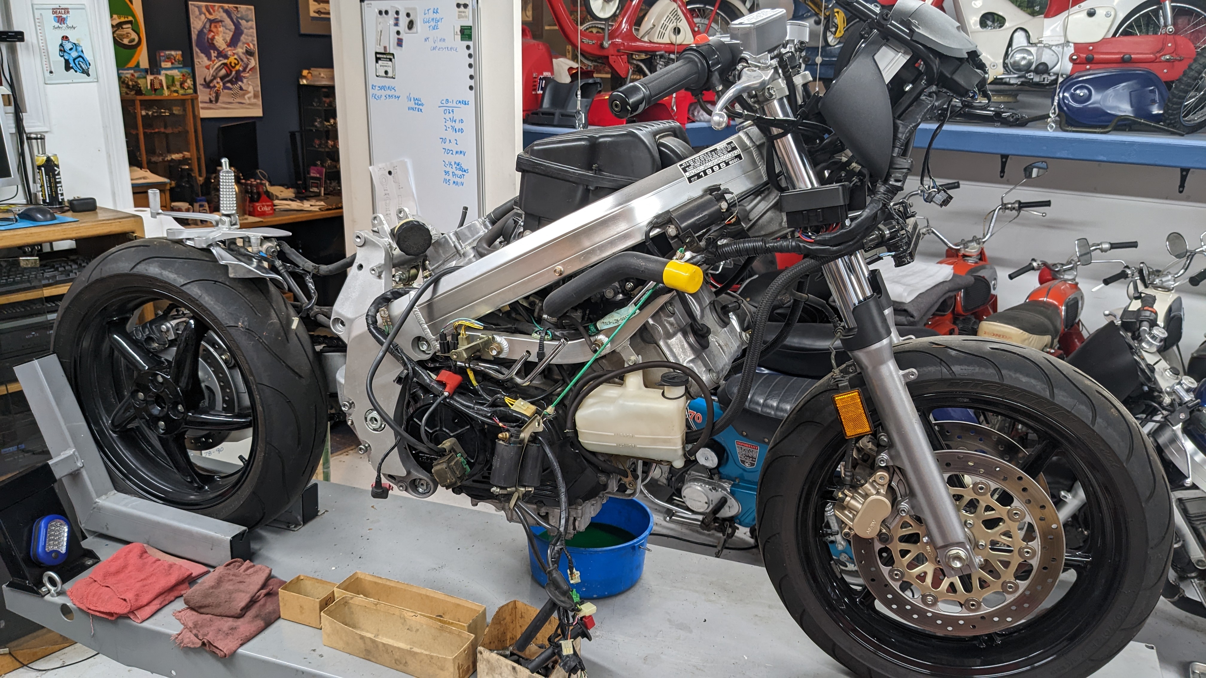

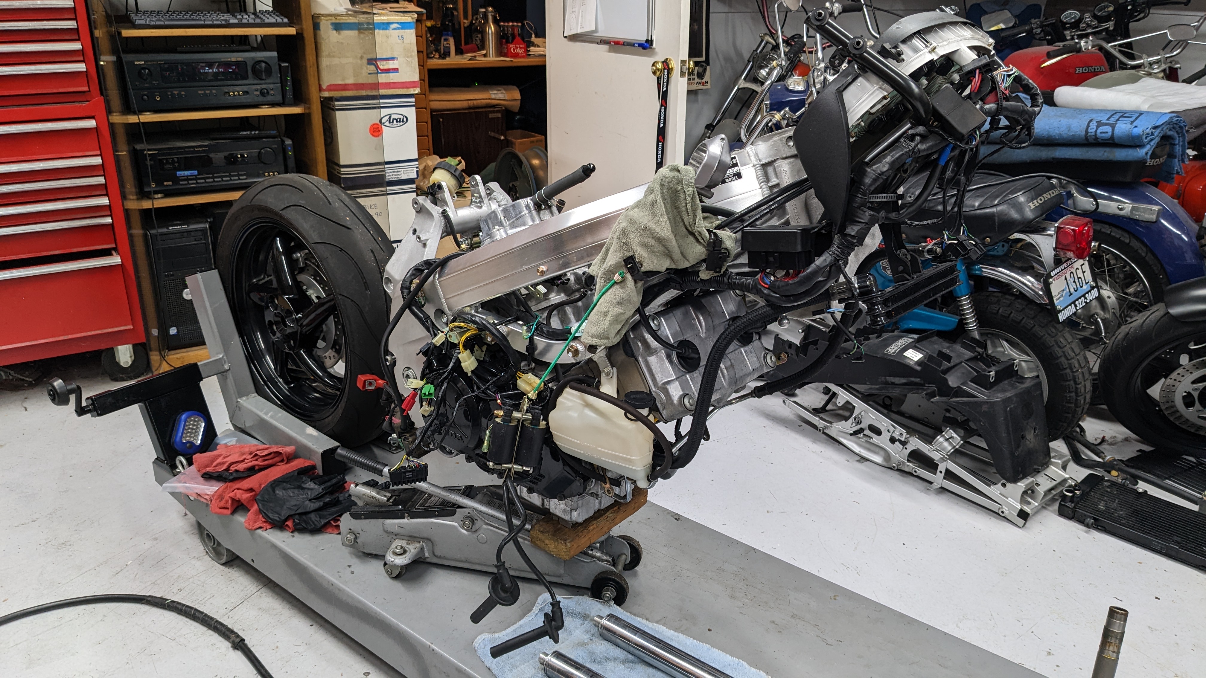

Plans are:
Steel braided front brake lines
Race Tech springs
Tapered steering bearings (future proofing while I'm here)

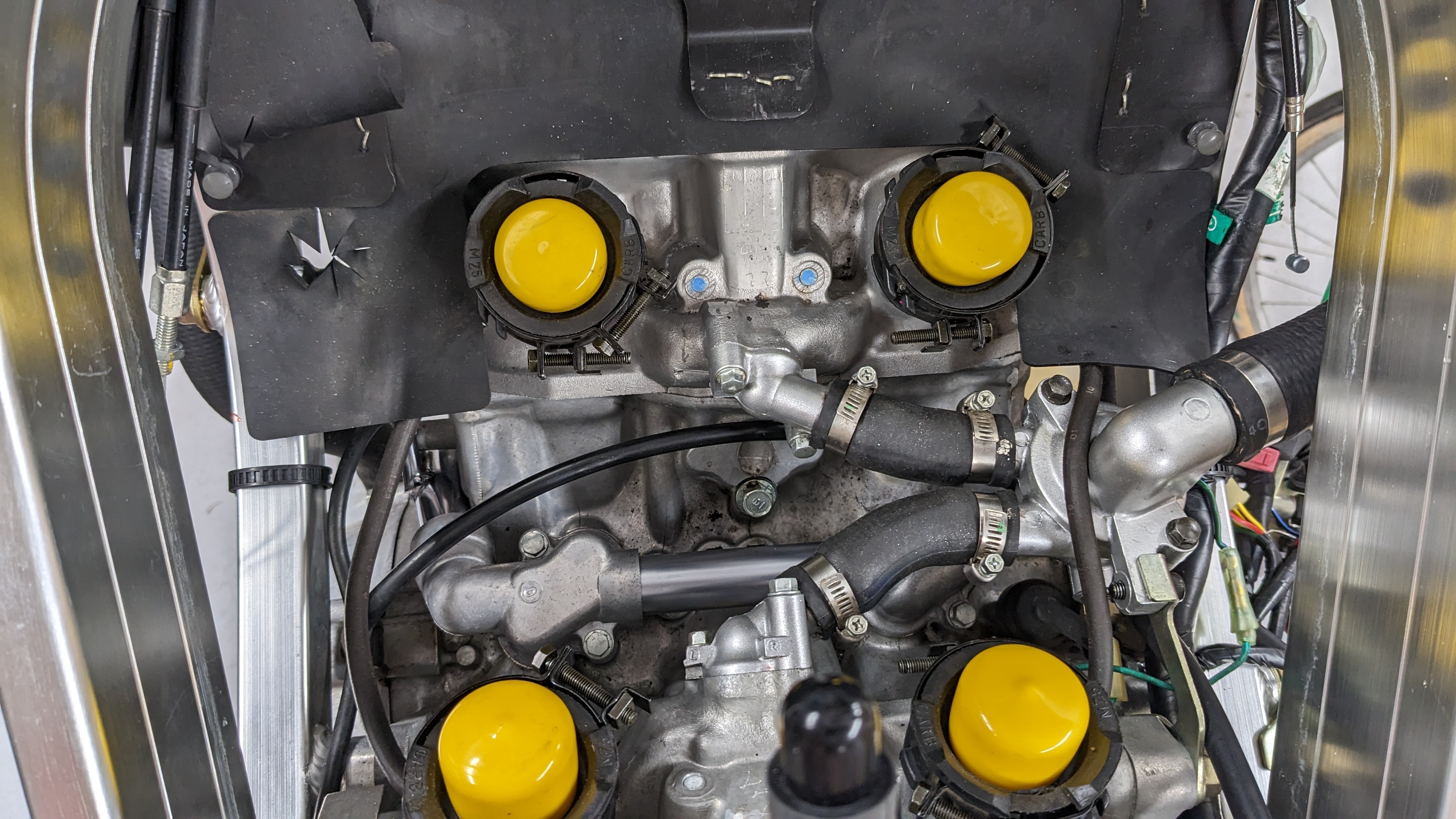

Pulling carbs and documenting (not sure if somebody's been in there)
Replacing all coolant orings

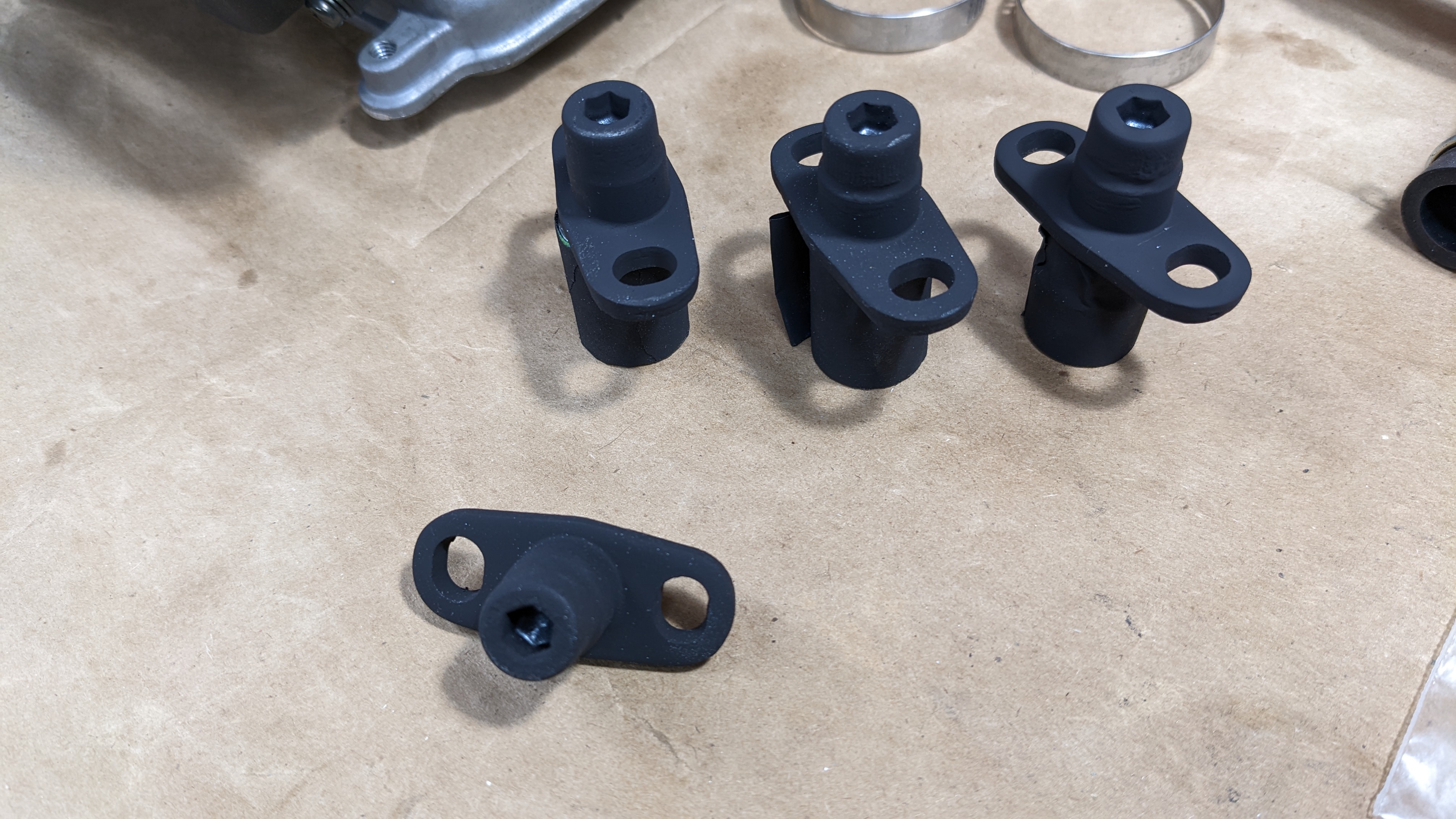

Remove PAIR (creating block-off plates with the original fitting ends)

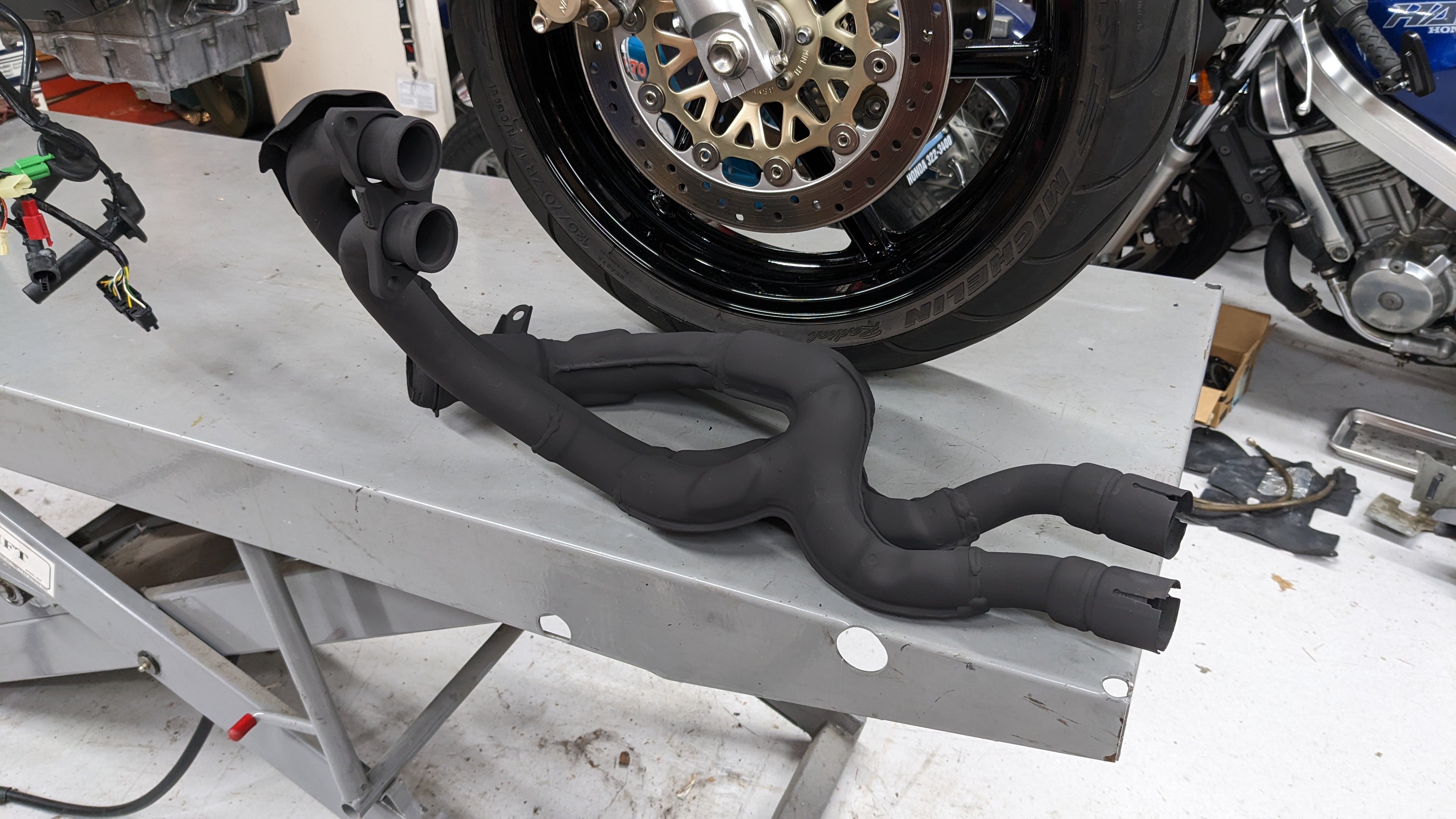

Repainting headers

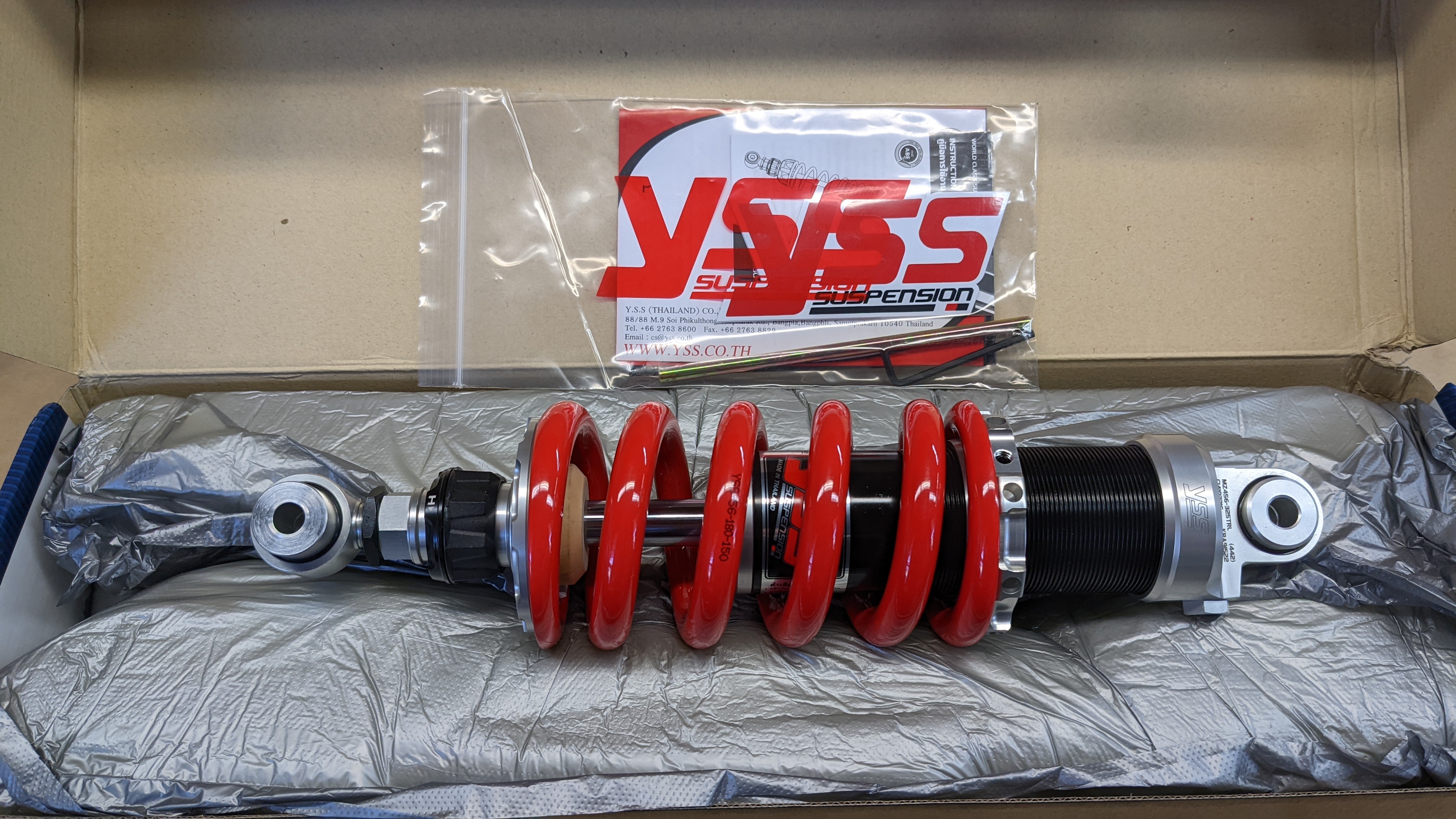

YSS shock (decided to do it while I had the whole rear apart)
Replacing Comp Werkes fender eliminator with a re-worked stock unit
I think that's it.  Getting even smaller...
Here's the shock

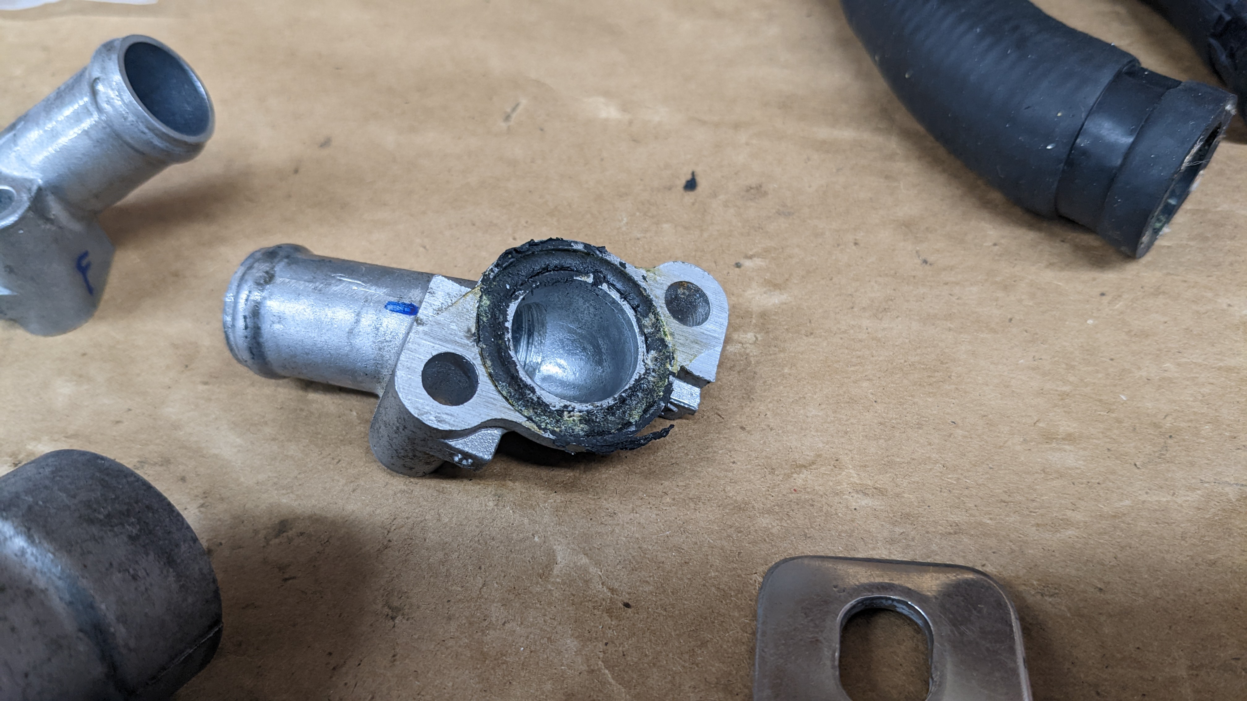

Glad I went thru the cooling system.  I was pretty surprised the two on the heads were this bad.  They were almost goo...

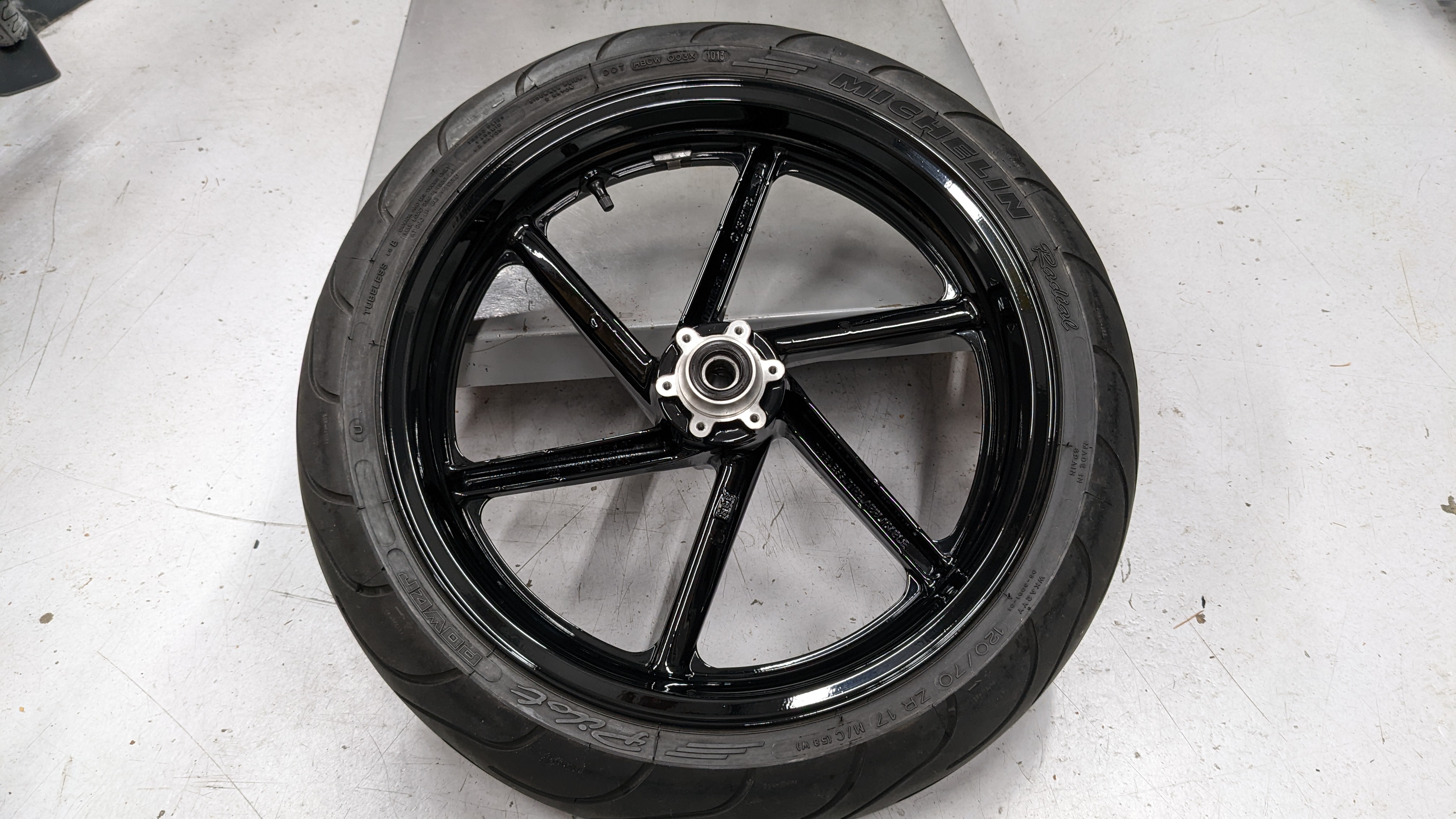

For the next set of tires, I have a 8 spoke rear (off the 90) and an extra front wheel that will get a nice Honda Metallic Black paint job and the perfect originals can go into boxes.

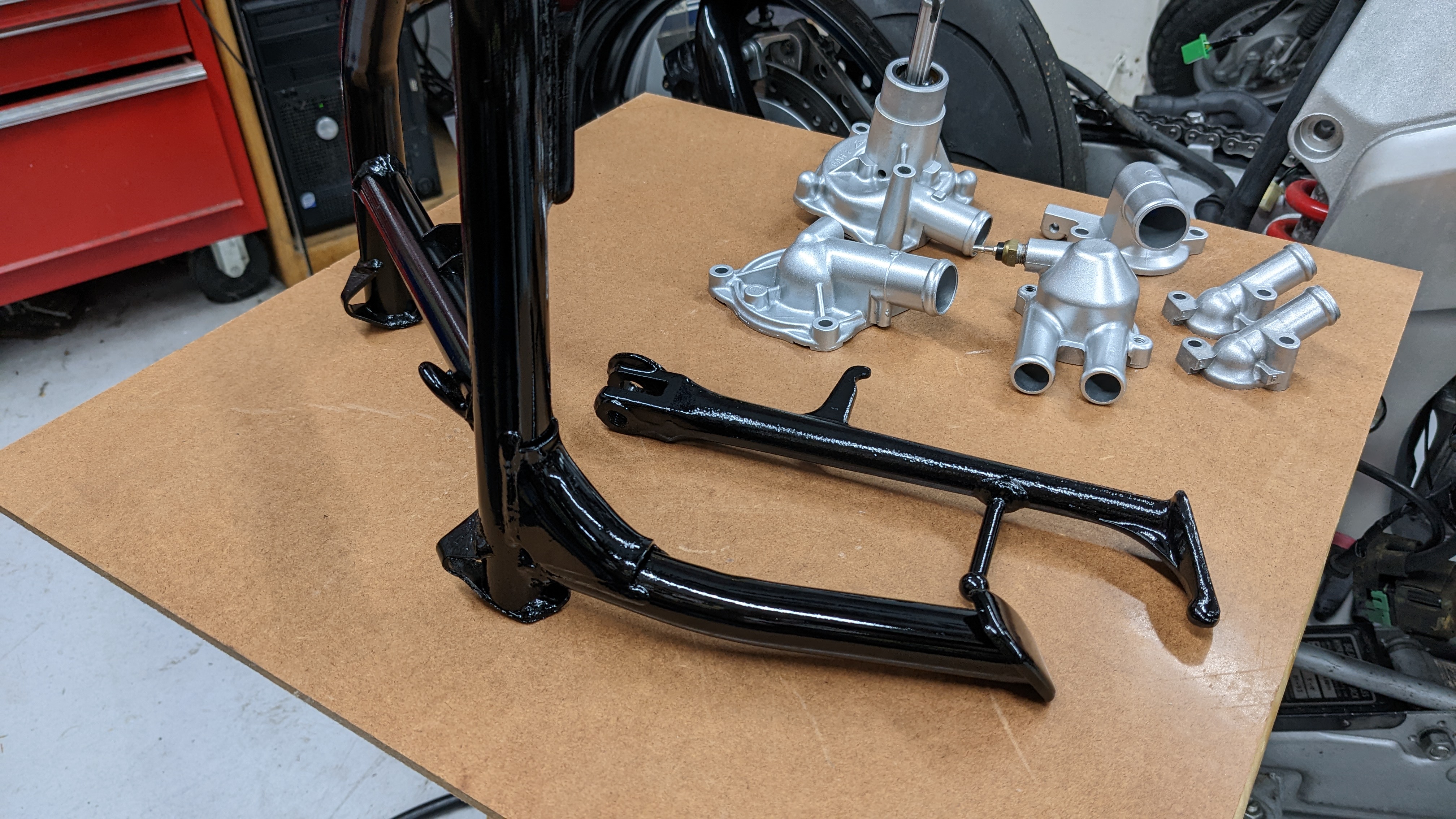

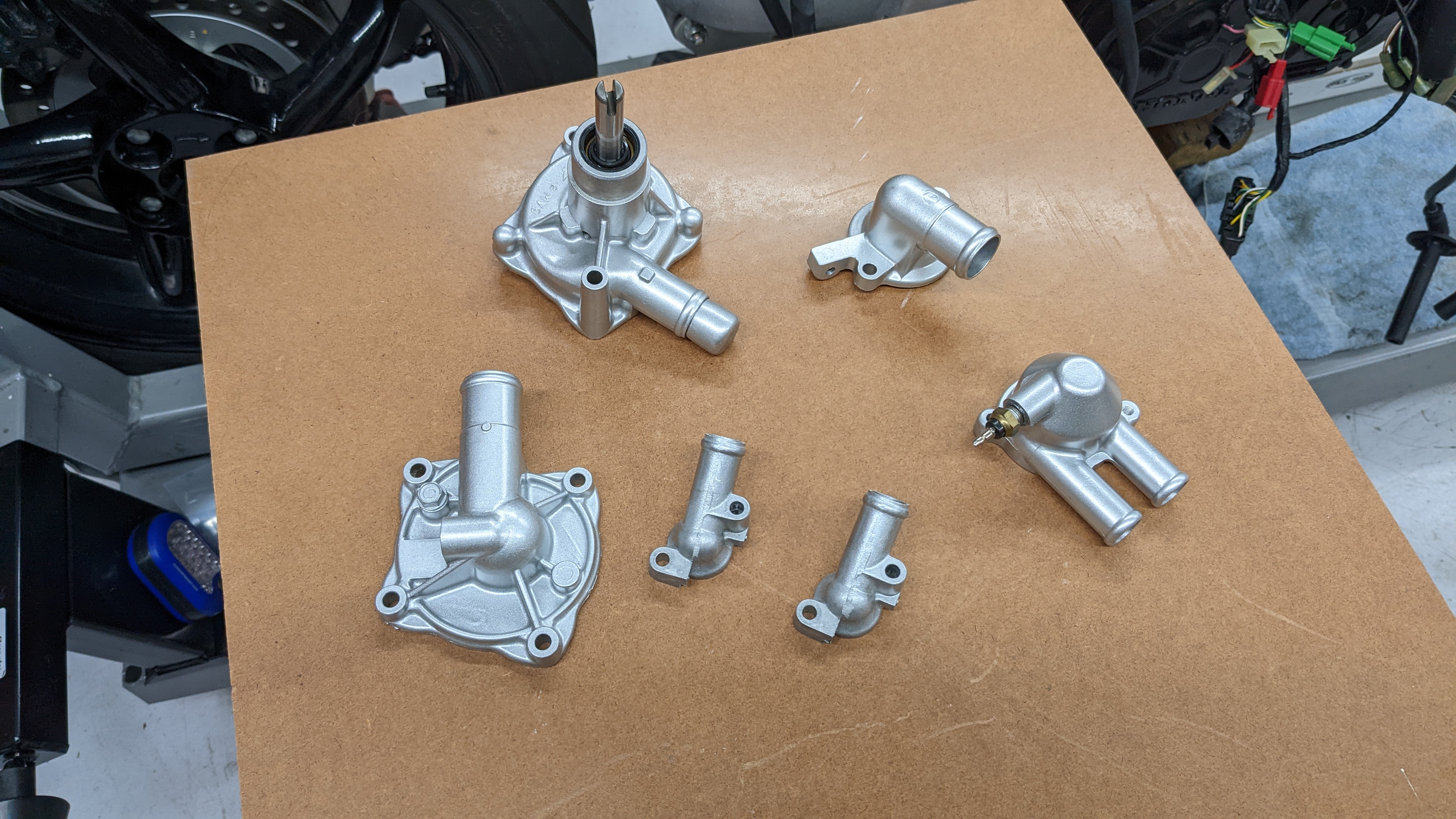

Cooling system components all cleaned up and re-finished.  Ready for the new o-rings that just showed up.
Very nice looking finish, is it from glassbeading or cleaning and painting?
If it is from cleaning and painting you must spend a lot of time masking off the seals etc, or you just replace them
Cleaning and painting.  Duplicolor Wheel Coating, Metallic Silver.  Sprays out nice and is very durable.  Been using it for years on applications like this (and wheels) with zero issues.

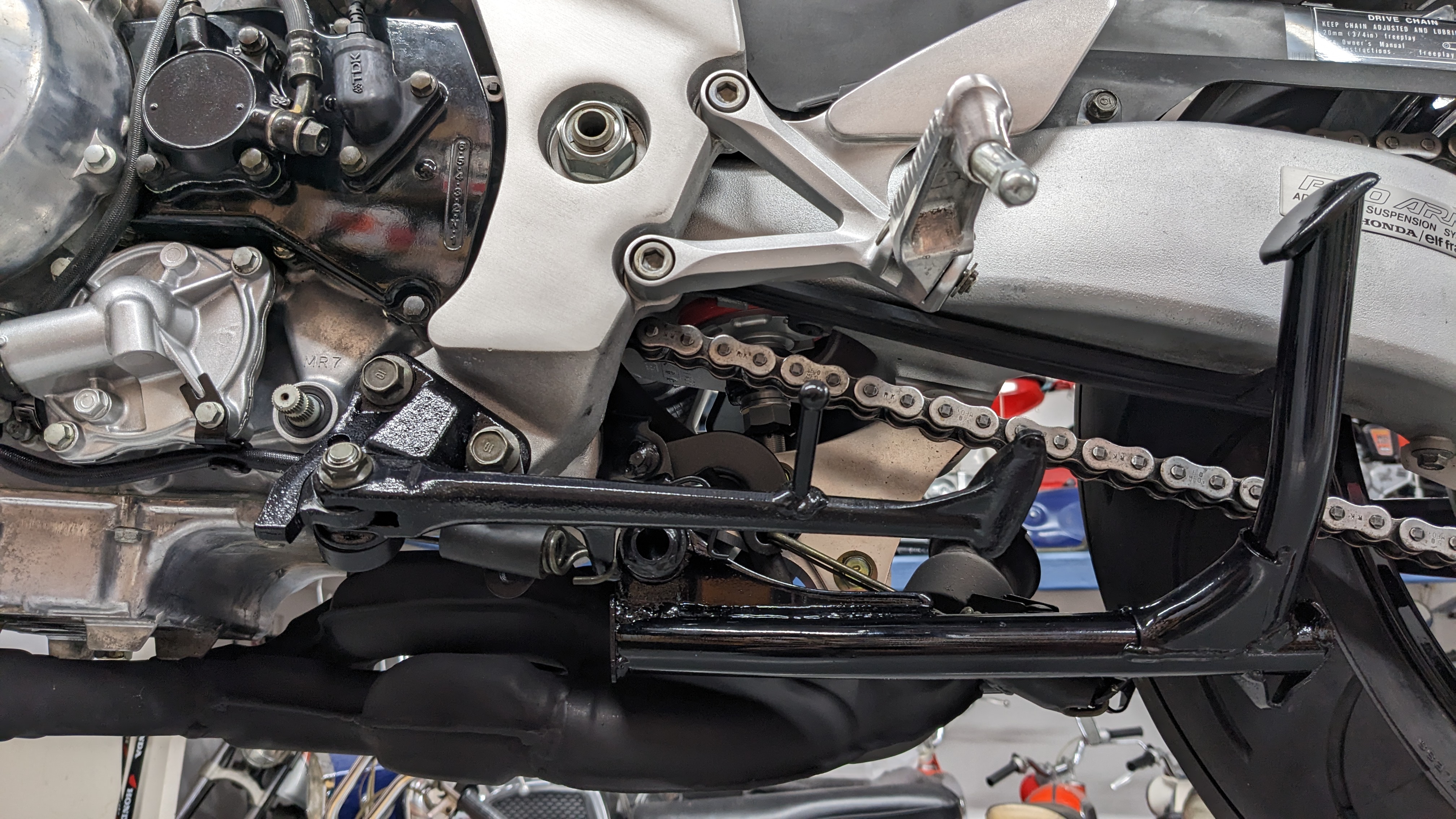

Center stand, side stand and bracket, bar ends and lower triple clamp (and some associated brackets) all done in Honda Nighthawk Black Metallic with 3 coats of clear.
The Metallic isn't as pronounced as a factory applied finish unfortunately, but it looks great.  I did a spray out test on a small piece of plastic and it is VERY close to Granite Blue Metallic, which is good cuz I have a couple lower cowl pieces on the 92 VFR that will need some love.

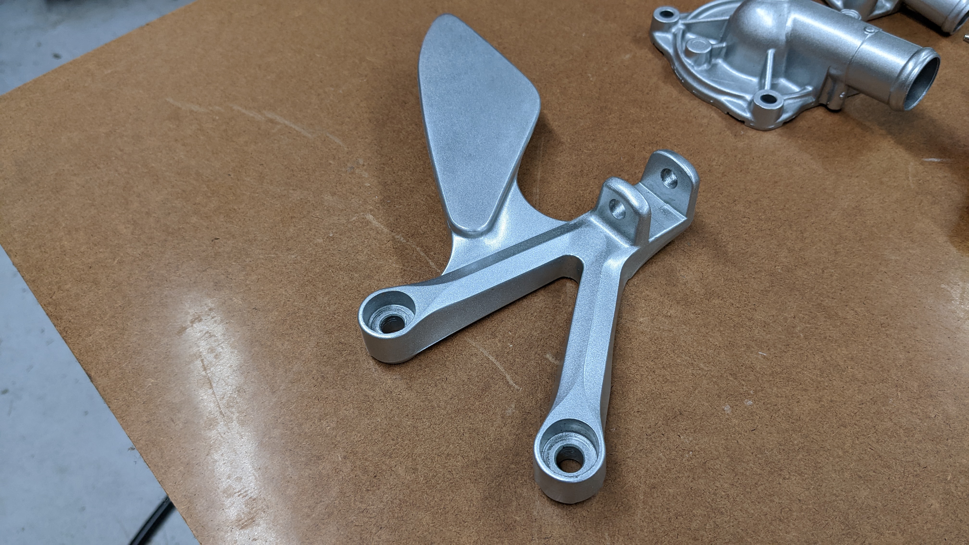

Since the passenger peg delete brackets were painted after modding, I decided to spray the front brackets but masked off the heel guards.  3 coats of clear too.

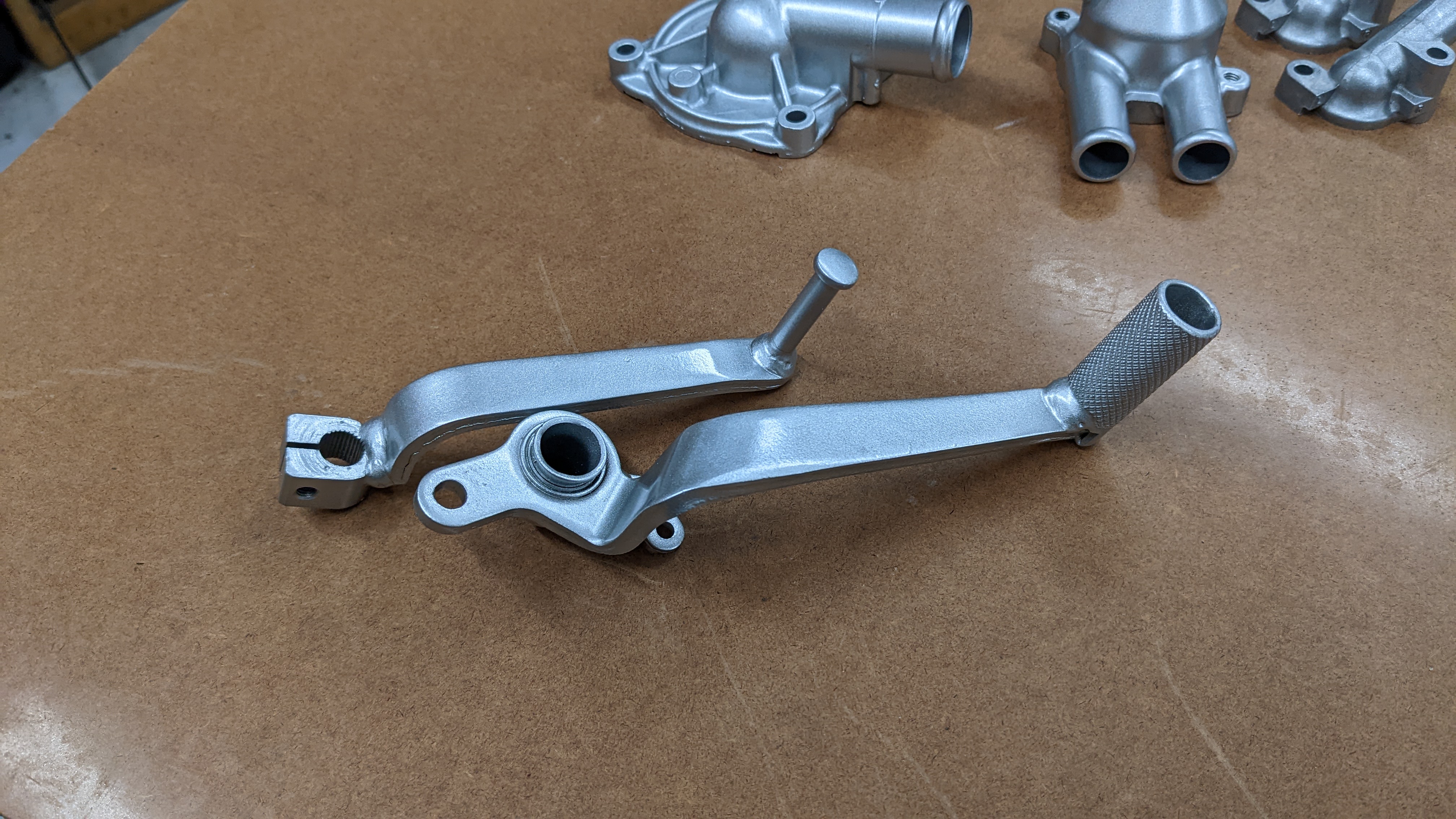

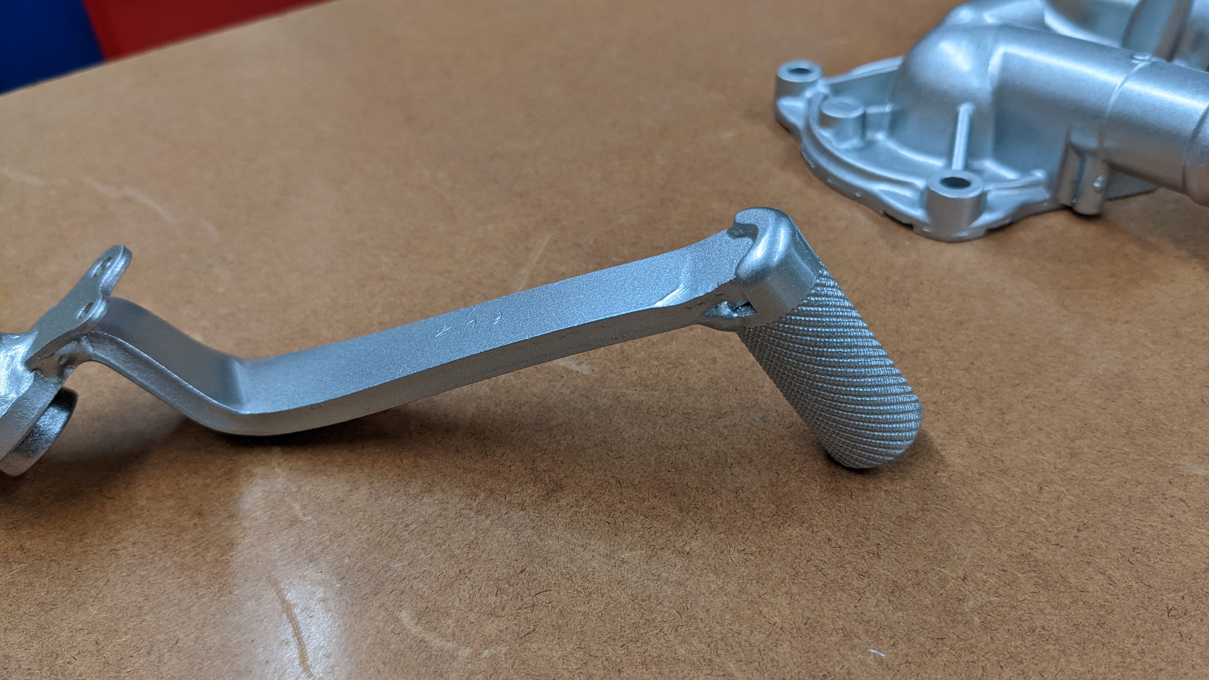

Pedals got some love too.
I radiused the back edge of the knurled post too for a more finished look.  Same on the back end of the shifter.

PAIR delete block off plates.  Made from the original hard line fittings and some old hex bolts.
On 12/7/2022 at 10:28 AM, Captain 80s said:
ok ......i got to work with grinder and files, sandpaper and polish to make that cheap-lookin stamped metal part look like a cast alloy part from italy.  just a matter of rounding the edges and blending.  (can't find my pix) takes hours but looks alot better than stock.
I get it. The front edges got a little love too.  But it's a fucking brake pedal on 95 VFR.  Jesus Christ.  I spend plenty of time on shit (hours actually) blending and shaping, like the passenger peg deletes..  You know...  the ones that are more than 10 inches off the ground.  I got a bunch more to do, and a shit load of other bikes to work on.  I really don't think this is gonna be a distraction to the rest of the bike.
I've seen the pic of that pedal.  It's one of 7 pictures you seem to have, I'm surprised you couldn't find it.  It looked great.
The time I spent on the pedals was partly cosmetic and partly in case of a tip over.  Go look at your 97 and notice the sharp crescent shaped indentations in the frame right behind the pedals.  It was probably the reason you had the pedal off in the first place to straighten it and file out the rash.
Thanks for your kind words, as always.

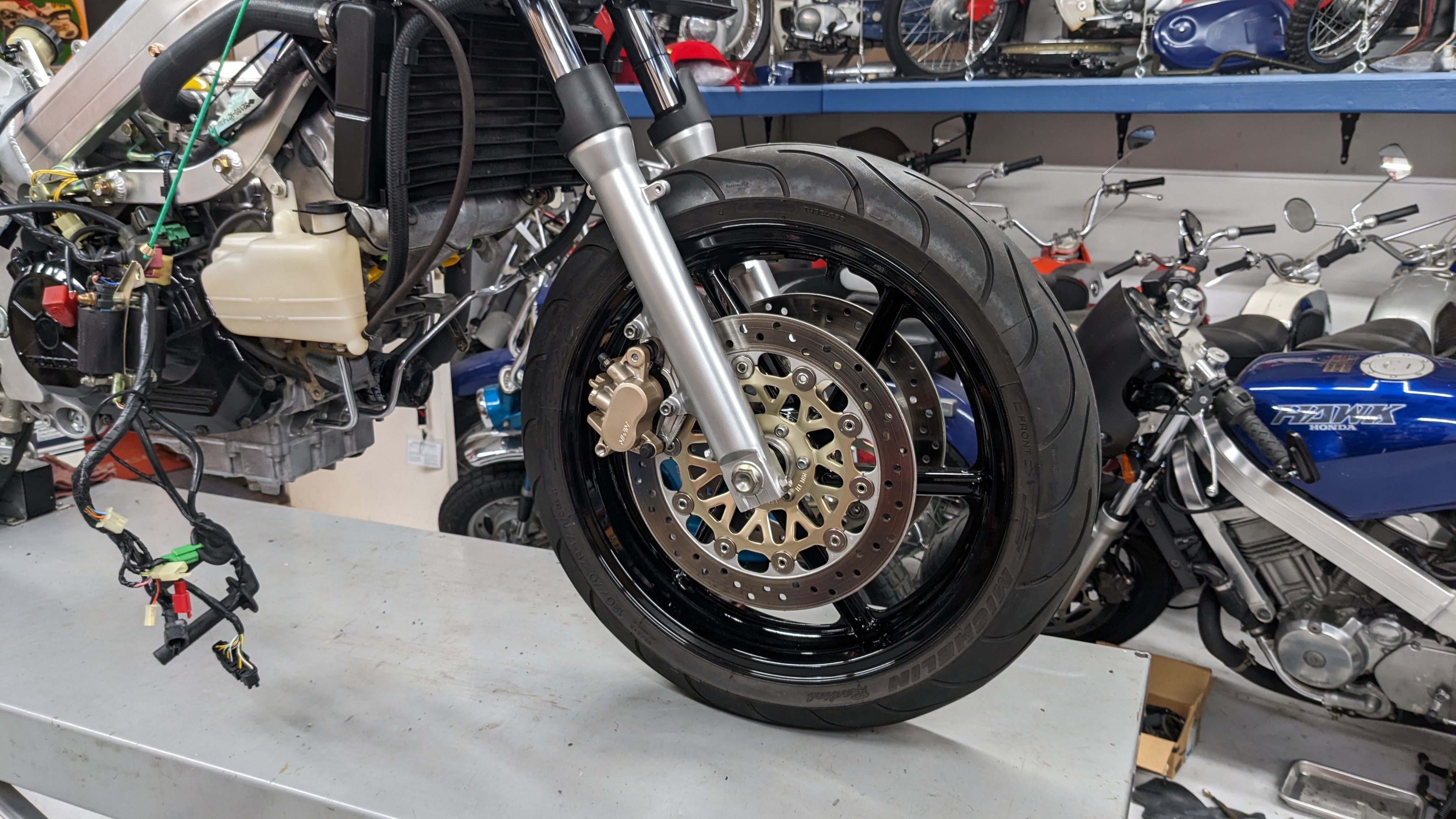

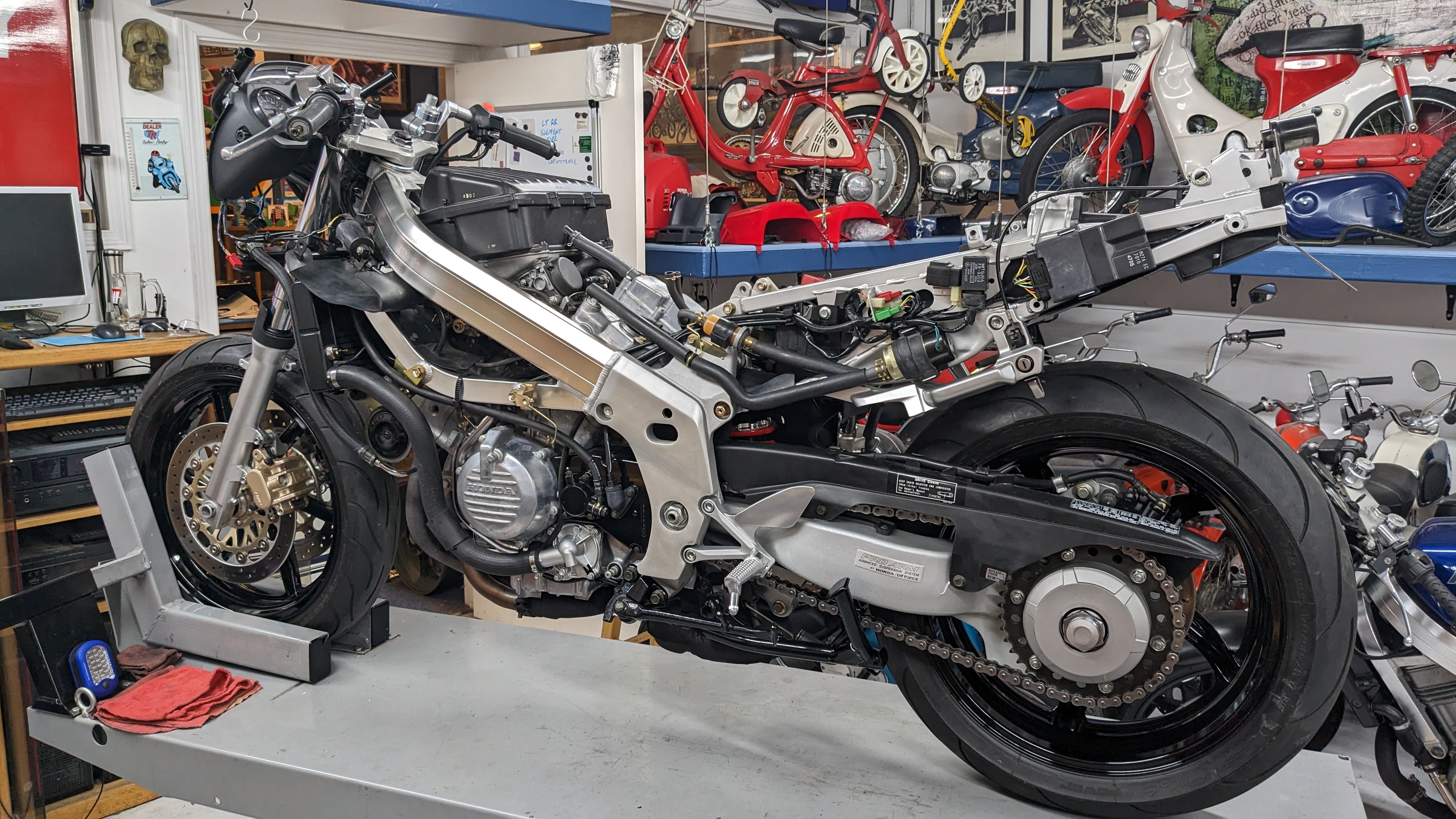

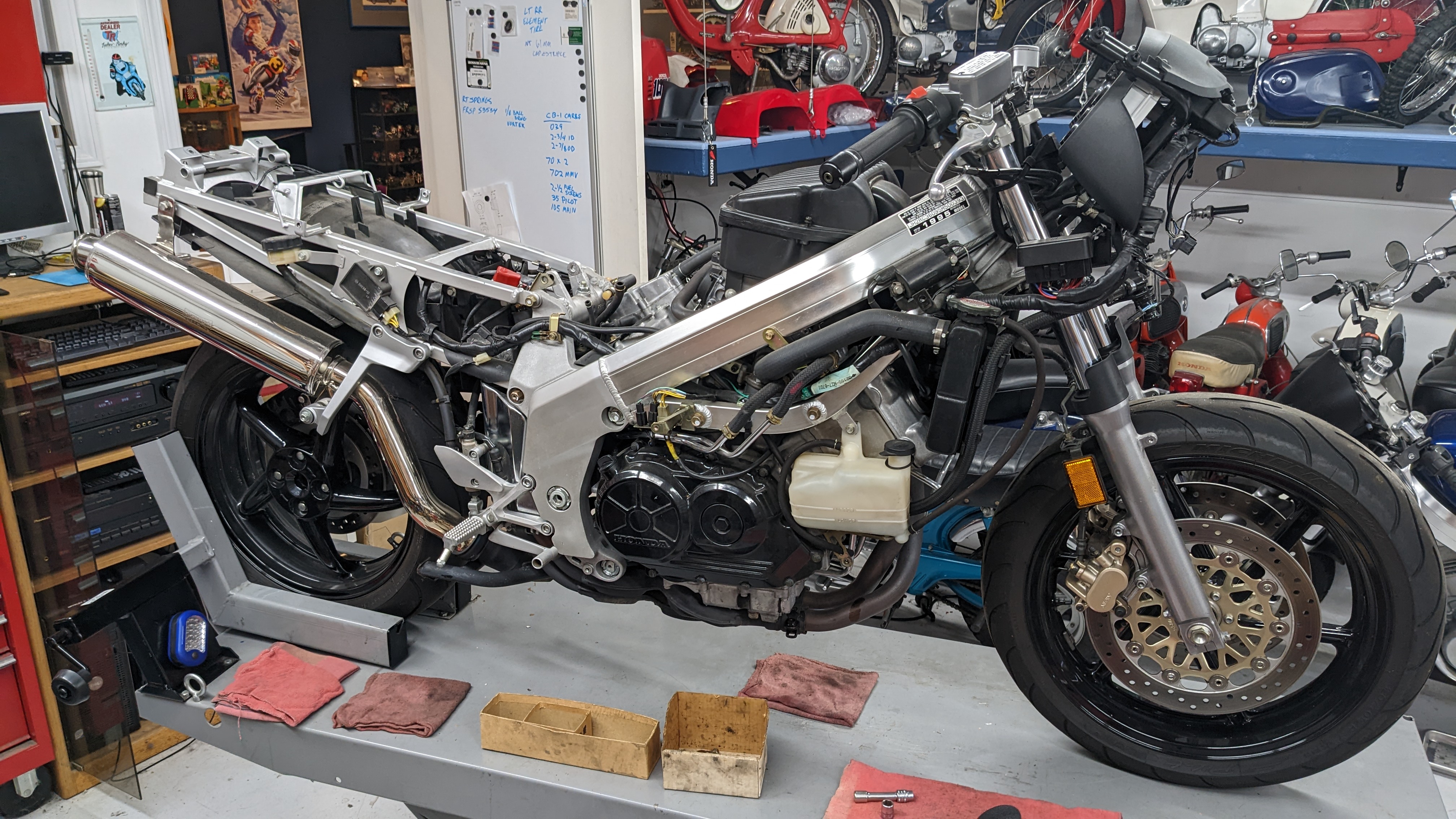

Cleaned, polished and waxed the front wheel while it was off
Front end (mostly) back together
RT .09 Springs
Fork oil level set with new fluid
New tapered steering bearings installed with painted lower triple clamp
(factory paint can be light on them and it showed signs of a little exposure)
Cooling system back together with all new o-rings
Re-finished the exhaust
  • Like 4

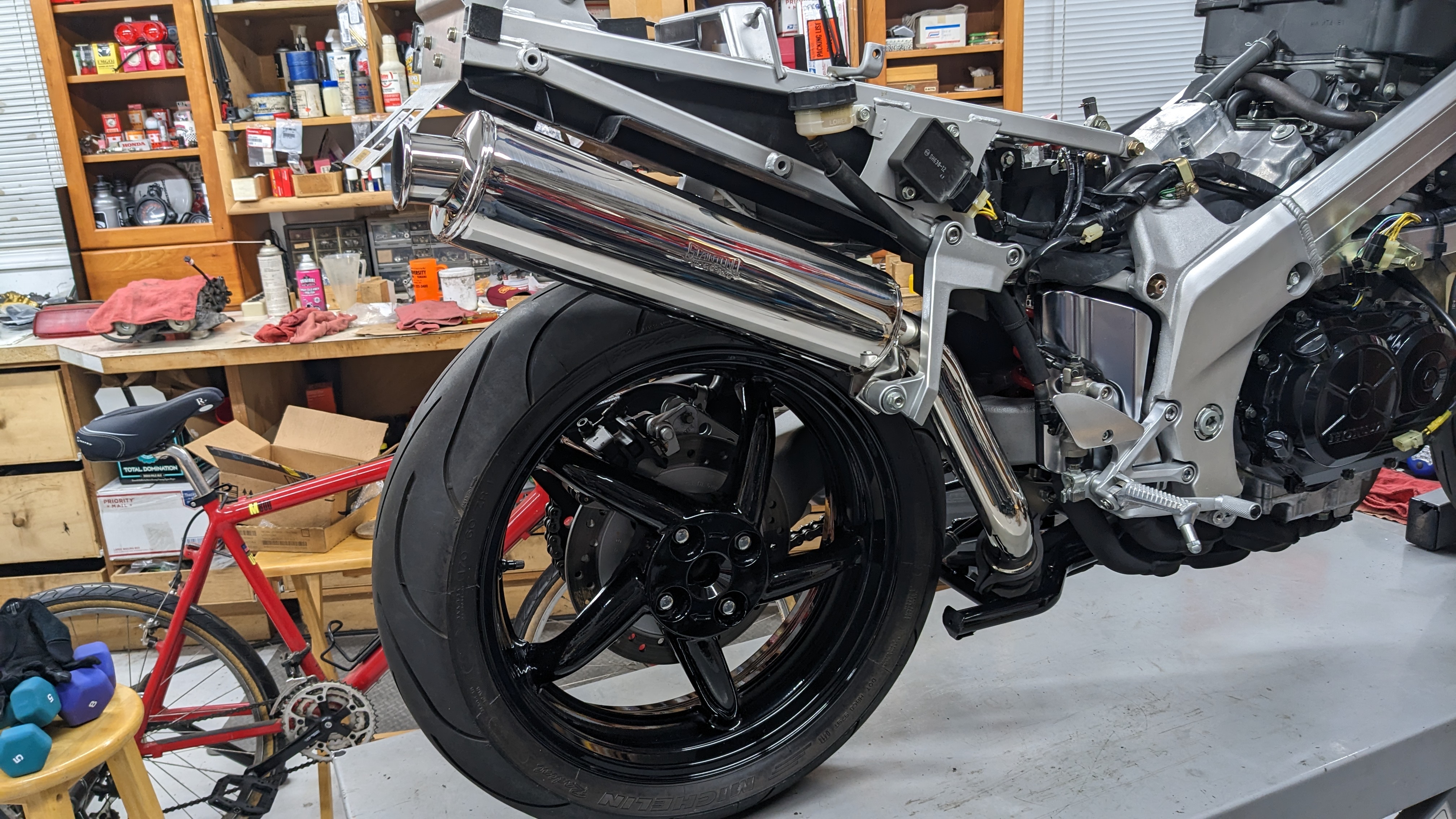

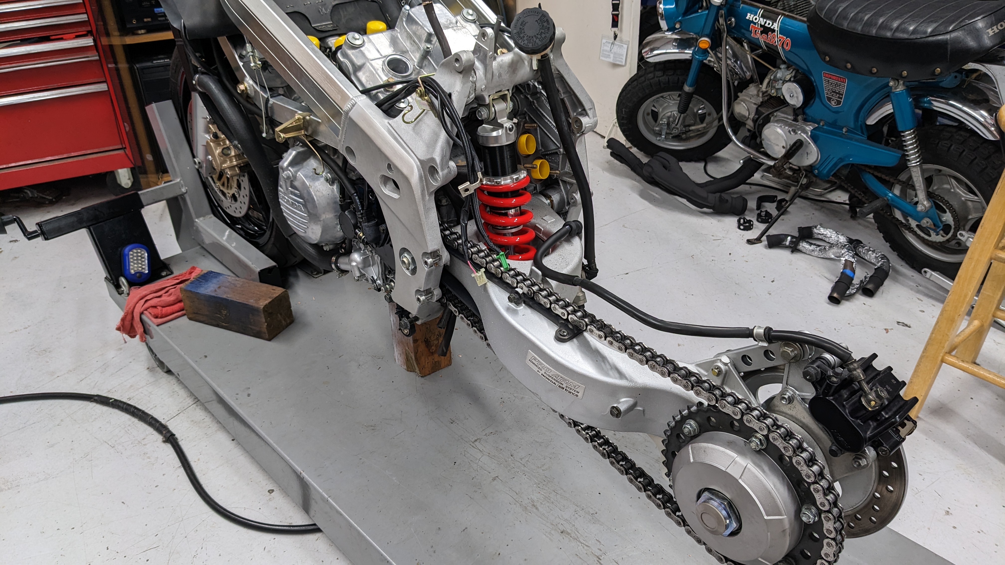

New shock installed.
Refinished stands and controls installed.
Subframe re-populated.  Staintune polished up.
I bought another inner / rear fender to trim down a little smaller than stock and use a plain license bracket.  It was perfect and even had the correct year stickers.  I just couldn't bring myself to cut on it.  So I cleaned up previous trim work that was done for the Comp Werkes fender eliminator and will run this for a while still.  I don't mind it, but wanted to switch over while I had it all apart.  I'll look for yet another fender to mod.
