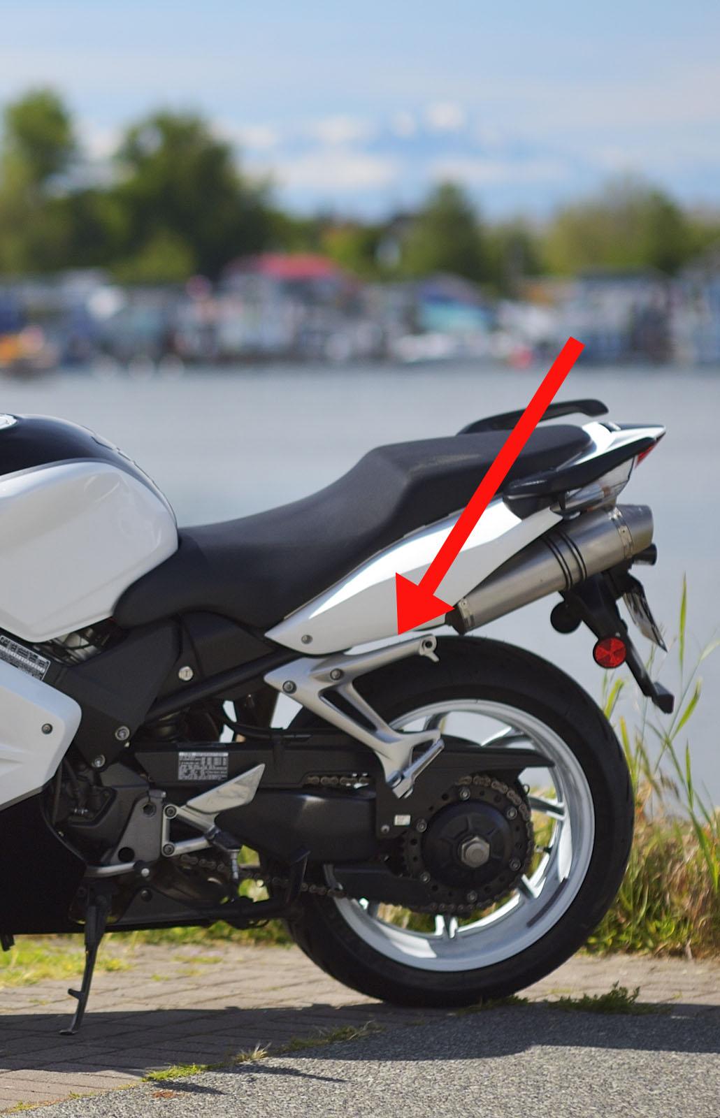

Member Contributer Lorne Posted June 27, 2022 Member Contributer Posted June 27, 2022 4 hours ago, Kbear said: Is there a technique that you guys have a handle on that may give me more confidence in lifting this motorcycle to the centerstand Good advice so far, but your reply is vague as to where you hold onto the VFR. I hold the left handlebar with my left hand, foot on the centrestand, and right hand palm-out holding the passenger peg/pannier bracket as indicated below. So long as the ground is level your VFR should be quite stable while you lift. As the others note, press down and lift at the same time. 1 Quote

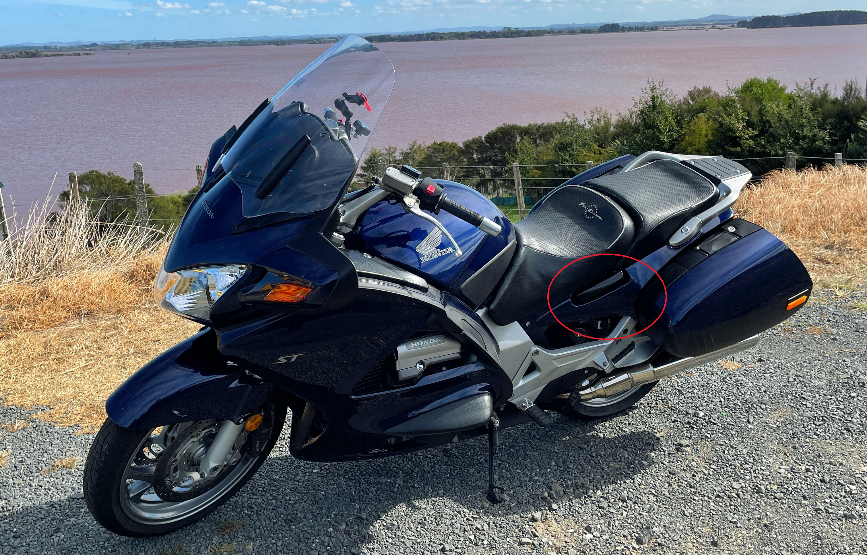

Member Contributer Terry Posted June 27, 2022 Member Contributer Posted June 27, 2022 2 hours ago, Kbear said: I've sure given some thought to rolling the back wheel onto a small piece of plywood (3/4 thick maybe) or something to assist me in lifting it. I have a rear seat cowl so that makes it difficult to hold on in that area. Really I don't find much of anything to hold on to for lifting. Unless I remove the luggage cases. Makes me remove the rear cases every time I would like to lift the rear for chain maintenance. I guess if that's what needs to happen in order for me to keep it from falling away from me. With panniers on I imagine you can't get to the handy rail that Lorne highlighted, so maybe you do need to remove the left bag. My ST1300 weighs a LOT but does come with a fold-out handle for hoisting onto the centerstand. I make things worse for myself (but good for my Mancave floor) by having plywood under the stand, so I get to lift the bike even higher that standard. Without the handle, that would be a no-show. 1 Quote

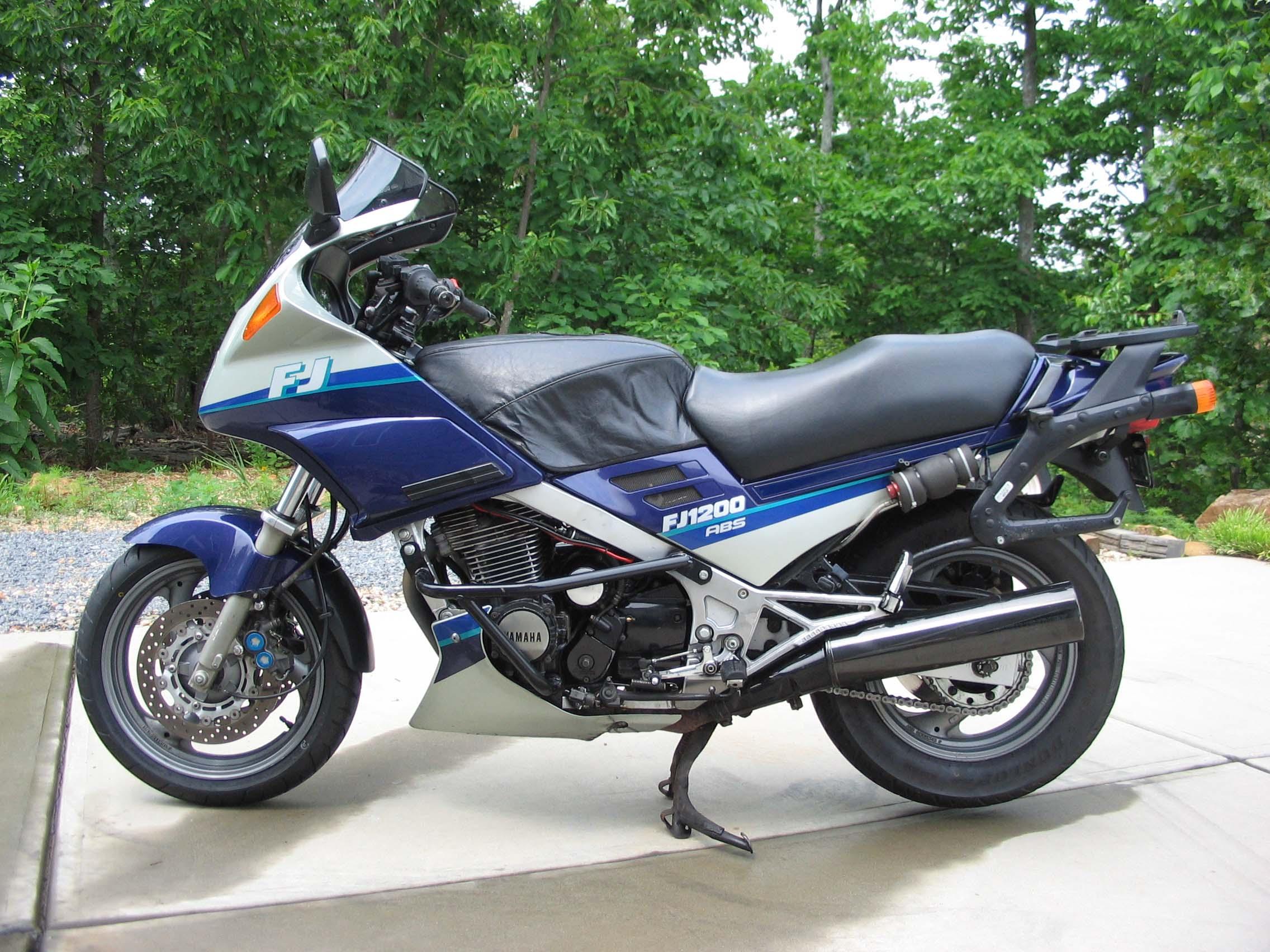

Member Contributer FJ12Ryder Posted June 27, 2022 Member Contributer Posted June 27, 2022 I'll absolutely agree with what's been said: your issue is right in the title: LIFTING TO CENTERSTAND. You don't lift, that's an easy way to a bad back or hernia. 🙂 When you get the centerstand legs on the ground, both of them, concentrate on pushing the centerstand into the ground, use the bike for leverage to help in pushing down. Don't consciously lift up, just press down, done right, the bike will all but leap onto the centerstand. Of course this is all a lot tougher if the bike has been lowered. Quote

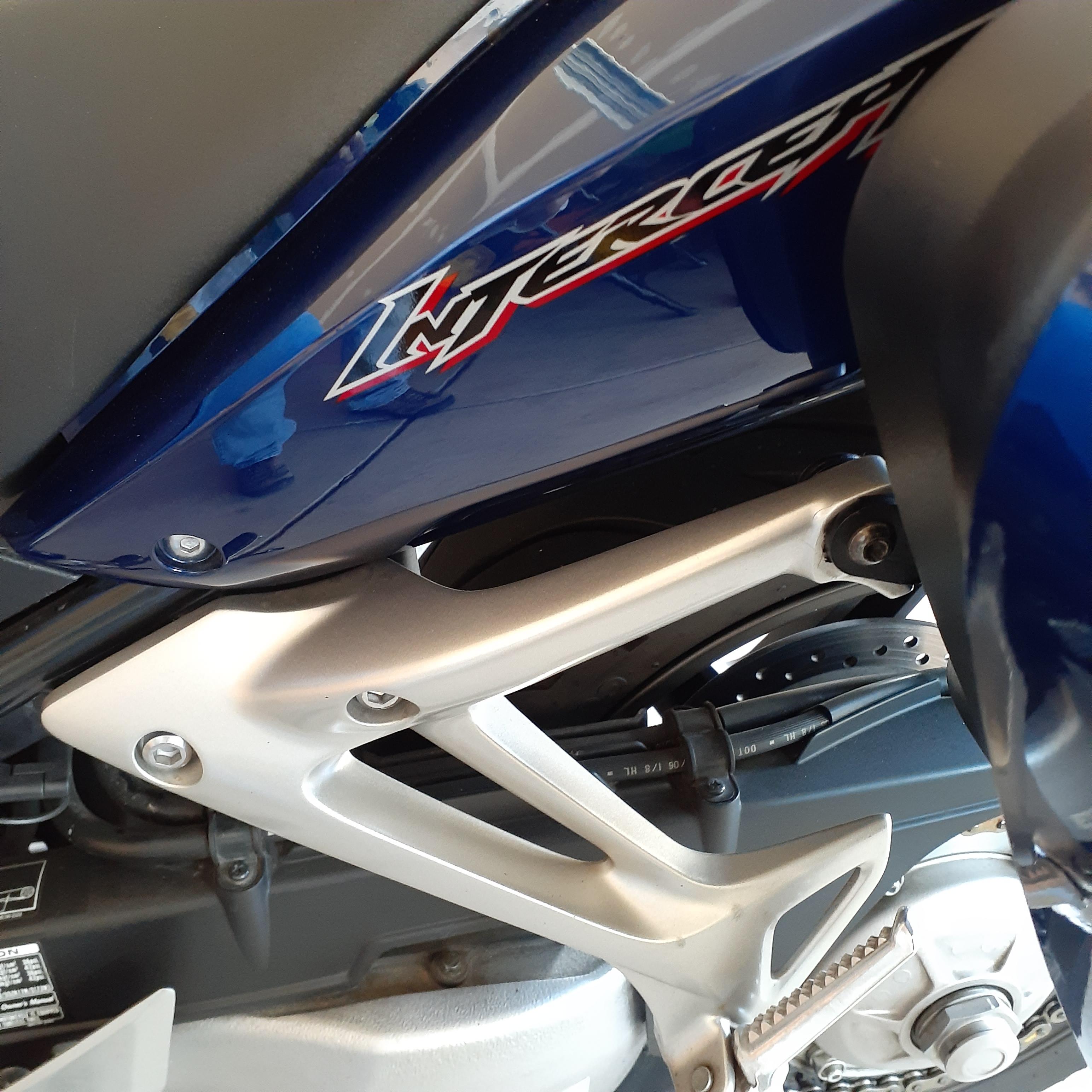

Sparkie Posted June 29, 2022 Posted June 29, 2022 I have a few tips to go along with what everyone else said. Use the ball of your foot. You have more power there. Wear boots. I use my passenger footpeg bracket for my hand to grip. I use my knee against the bike for stability til both legs of the center stand touch the ground. Then I put all my weight on the center stand while pulling up on the footpeg bracket with my right hand, and pull backwards on the handlebar with my left hand. I have used a board under the rear tire, it does help, but I don't anymore. My goldwing buddy just uses reverse to get on his center stand. I hate that! To get off, put the bike in gear so it doesn't roll away. Put the side stand down. Rock forward and keep it balanced. Good luck. It gets easier with practice. 1 Quote
