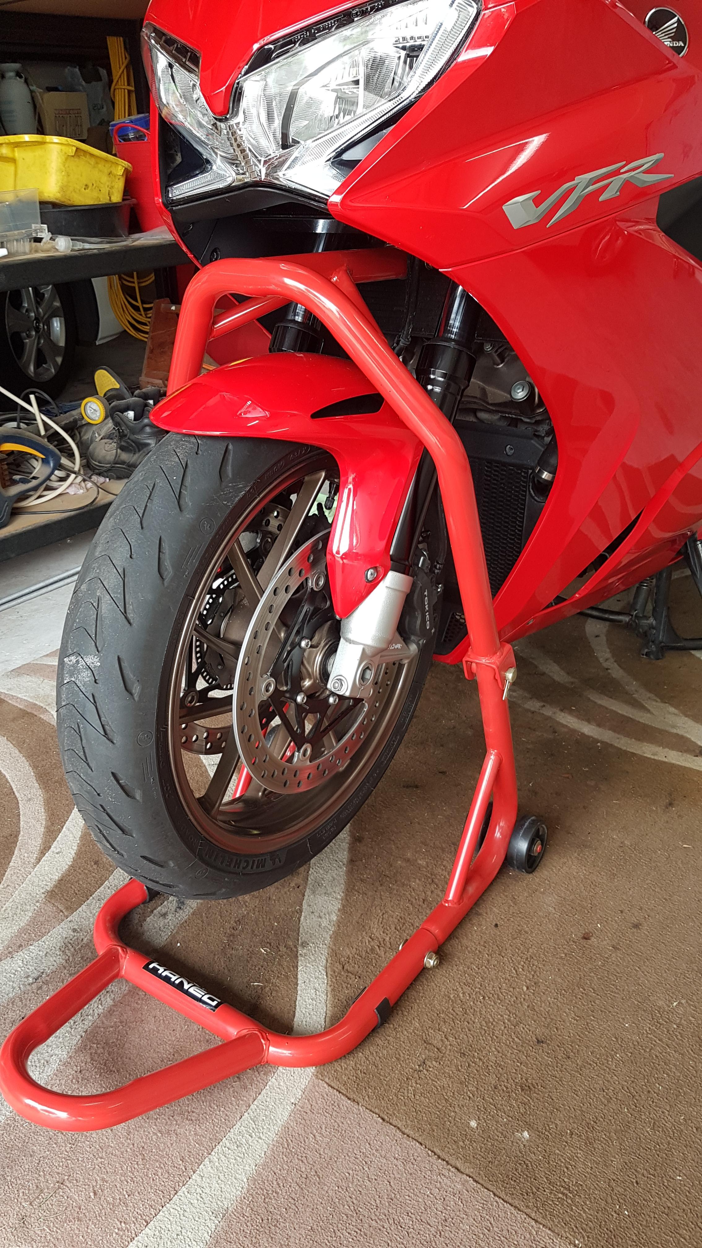

Member Contributer Grum Posted April 21, 2022 Member Contributer Posted April 21, 2022 53 minutes ago, VFR78 said: I have a 2014. I always take off both calipers, but have never removed the abs sensor. Same here on my 2014. Just add a small amount of Loctite 243 threadlocker to the caliper bolts on the install. The head lift stand makes the job a cinch. Quote
StrayCat2 Posted April 21, 2022 Author Posted April 21, 2022 cheers guys, i've got a head lift stand Quote

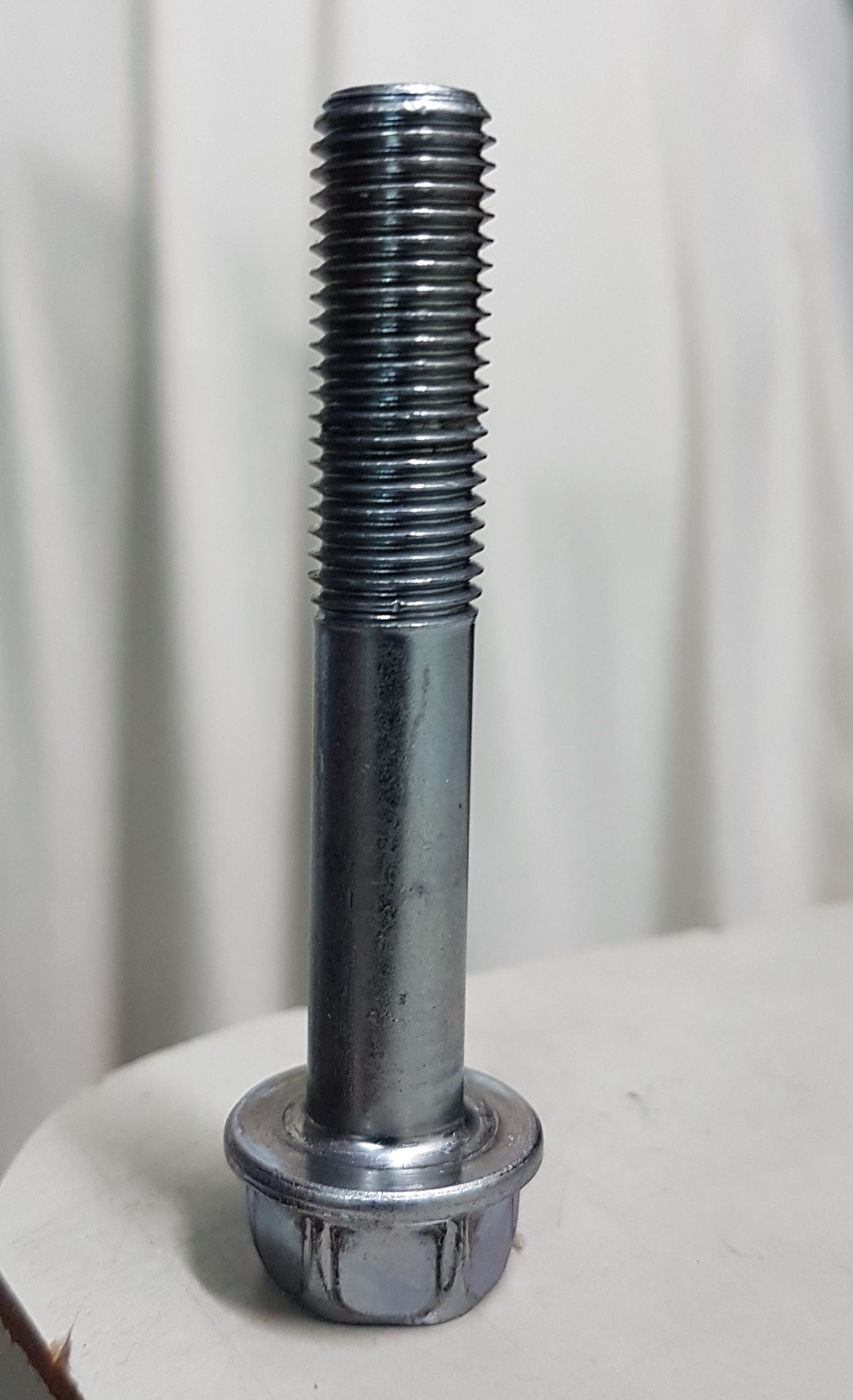

Member Contributer Grum Posted April 25, 2022 Member Contributer Posted April 25, 2022 8 hours ago, JZH said: You've never seen a stretched steel bolt threaded into alloy, then? They look like this: https://www.triumphrat.net/attachments/tiger-brake-bolt-jpg.63642/ If a bolt is repeatedly stretched, it will eventually snap. Only a question of time... Ciao, JZH Pity there's no info about the bolt being stretched. Was it done for demonstration? Was it incorrectly torqued? Perhaps the N-m torque value was incorrectly read as Ft-lb? Was the bolt faulty from manufacturer? How many reuse cycles had it done? What would be the state of the internal threads after such over tightening? I inspect my caliper bolts before reinstalling, none have ever looked anything like the photo, I'd certainly bin it if it did, will continue to keep a close eye on them. As mentioned I never over torque them and use a little 243 threadlocker when installing. I guess there's a similar analogy to those who believe chains should only ever be replaced with new sprockets! Just for the fun of it! Took out one of the caliper bolts. 90,000k's and with brake pad and tyre changes has now done seven removal and installs. And most certainly.....YMMV. 1 Quote

Member Contributer Grum Posted April 26, 2022 Member Contributer Posted April 26, 2022 Did a bit of a search. These bolts seem to be as rare as rocking horse shit in Australia! According to Honda's recommendation of one use only, you'd need 4 new bolts every time you either drop the front wheel off for a new tyre or to fit new pads, and that these bolts are used on multiple bike models, there should be thousands of these bolts readily available, there just isn't! No wonder they are rarely if ever replaced! Part Number 90131-MEL-000 Flange Bolt 10×57mm. Quote
