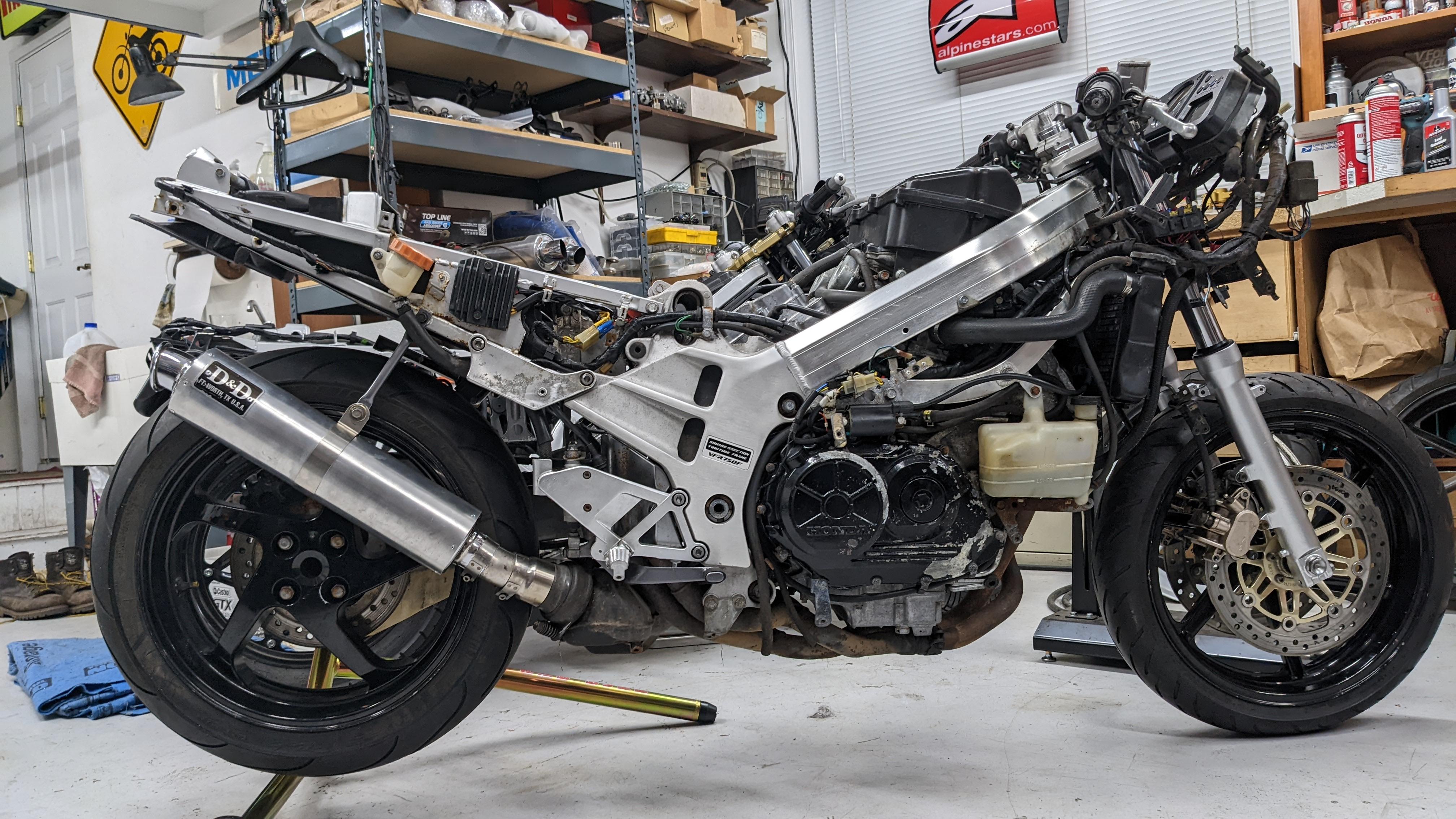

Member Contributer Captain 80s Posted April 4, 2022 Author Member Contributer Posted April 4, 2022 Rear subframe and inner fender back on and the wire harness re-routed. Cleaned up, straightened and painted the brake pedal and shifter. Shot the muffler stay while I was at it. New steering head bearings installed and forks back on after a quick clean up and some paint. Finally rolled it outside Saturday afternoon for a proper running. D&D sounds amazing. V4 growl without being obnoxious at all. Really happy with it. Bike ran great with no oil leaks (whew...). Smoked a little at first but cleaned up as it came up to temp, I'm sure it was just from sitting for a few years and all the PB Blaster I sprayed in all of the exhaust junctures. Engine didn't make any funny noises, sounded like a healthy gear driven cam V4. Bike revved up great and settled into an idle as expected. Oh, and all the exhaust leaks are gone now after going thru the mounts. Tested the fuel pump and it works. Checked the charging system, Low 14s. All good news. Temp gage didn't work at first, but after disconnecting the wire and reconnecting it started working. Didn't want to restart one time until I sprayed some WD40 down around the kill rocker, and worked it a few times. Had a little weirdness while manipulating one of the fuses, so the fuse box needs love too. There's still a bunch of connectors I need to go thru, along with the fuse box and kill switch. Had to use a 1986 VFR rear brake fluid res on a small bracket. The original unit's screws were rusted frozen and the plastic was pretty hammered. This one fits in the rear cowl no problem and you can still see the level thru the sight hole. I cleaned up the hack job somebody did on the rear fender, and straightened the subframe brace where the seat latch mounts. Was bent down a bit from years of people slamming the seat into the latch. I always open the latch manually when installing seats and release with pressure on the seat. Getting close to a test ride. I'll grab a short video clip the next time I take it outside to heat cycle it again. 4 Quote

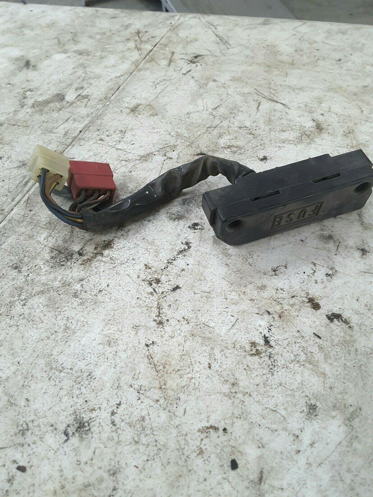

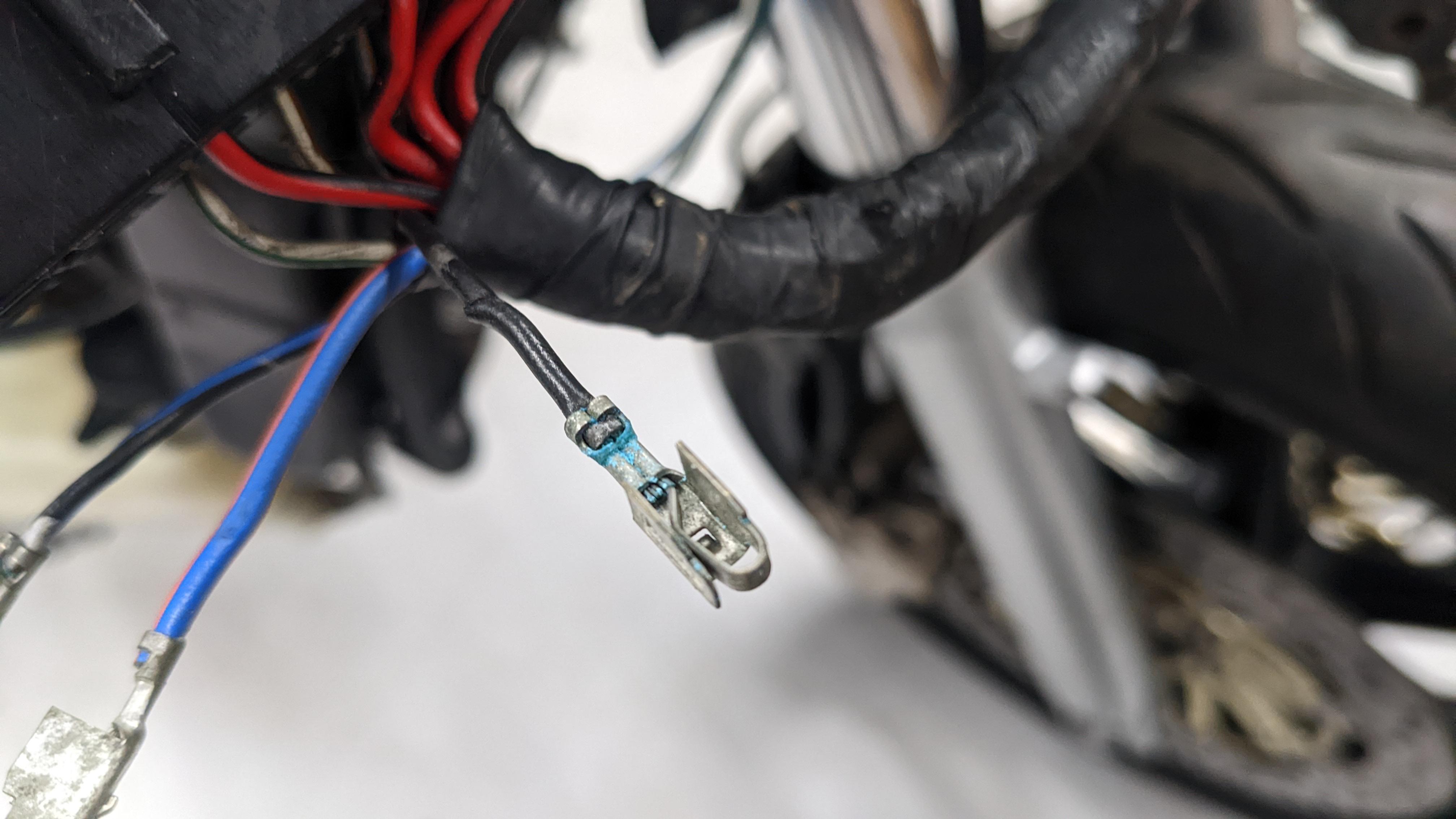

Member Contributer Captain 80s Posted April 5, 2022 Author Member Contributer Posted April 5, 2022 My fuse box is a corroded mess. Anybody got a line on the fuse holder connectors for the fuse box? Quote
Member Contributer DannoXYZ Posted April 5, 2022 Member Contributer Posted April 5, 2022 13 hours ago, Captain 80s said: My fuse box is a corroded mess. Anybody got a line on the fuse holder connectors for the fuse box? Can you extract one and post photo? I can probably match it up to tin-coated connector you can replace with to cure corrosion forever. Quote
Member Contributer Captain 80s Posted April 5, 2022 Author Member Contributer Posted April 5, 2022 Will do. I have a couple pulled from the box. Snap a photo when I get home later. Exploring grafting on a different design that is more serviceable and then can be unplugged from the Main Harness. Something like this. The 3rd and 4th Gen are hard wired to the Main Harness. Kinda Un-Honda-like compared to ALL of my other bikes. Quote
Member Contributer Captain 80s Posted April 5, 2022 Author Member Contributer Posted April 5, 2022 Most everything is this color... Quote
Member Contributer JZH Posted April 7, 2022 Member Contributer Posted April 7, 2022 I haven't seen anyone offering replacement terminals for Honda fuse boxes, but I'd bet the terminals are available somewhere. This would be a more modern type of sealed fuse box which might work: https://www.delcity.net/store/Sealed-MINI®-Fuse-Panel-with-TPAs/p_806637.h_806638 Ciao, JZH 1 Quote
Member Contributer Captain 80s Posted April 7, 2022 Author Member Contributer Posted April 7, 2022 I thought they looked pretty unique too. Pretty sure I'm going to graft on a Honda Fuse Box from a different year VFR or maybe CBR. I have a couple on the way, plus a couple "in stock", to compare and see which one is the best candidate. I have some donor wire harnesses I can source the harness side plugs too. Should be pretty easy actually. Still find it very UN-Honda like to have the fuse panel hard wired. Maybe they did it that way moving forward, all my shit is "old". 1 Quote

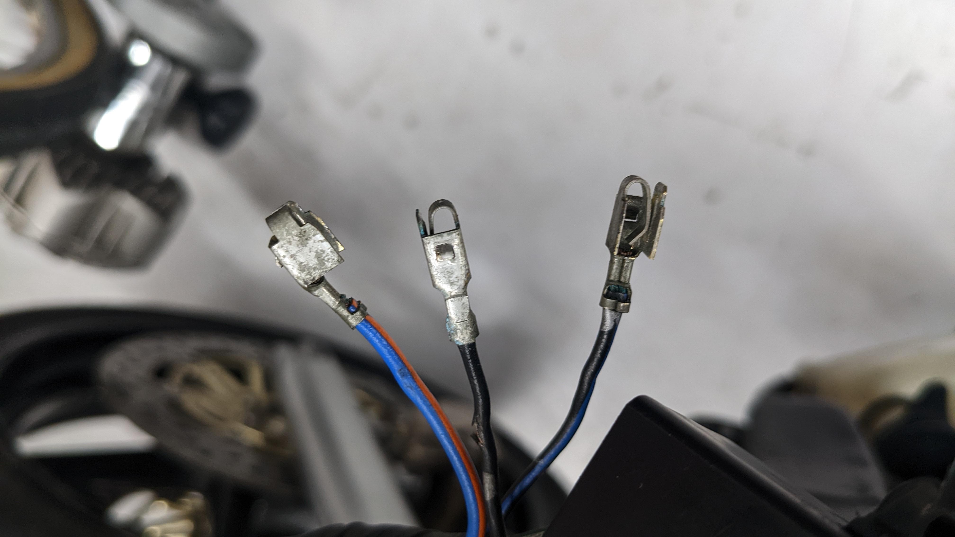

Member Contributer DannoXYZ Posted April 9, 2022 Member Contributer Posted April 9, 2022 Those terminals are zinc coated, which are OK. Corrosion is actually from uncoated wires. Personally, I always use silicone pre-tinned wires. What you can do in this case is remove corrosion with Deoxit spray. Then solder over the crimped wire-ends. This will improve conductivity as well as seal uncoated wire-ends from moisture. Which tends to creep down wire-ends and cause internal corrosion. Quote
Member Contributer Captain 80s Posted May 6, 2022 Author Member Contributer Posted May 6, 2022 Electrical gremlins are sorted, was able to clean up and retain the stock fuse box. The last item was the neutral switch on the crankcase that becomes finicky when hot and flickers slightly. Well with the sidestand down that meant it is cutting ignition every time it flickers. My temp "solution" before replacing the neutral switch was to jump the wires and make the bike think the side stand is up. Because it's a 3 wire switch, I can still retain the Side Stand warning light functionality when down. I ran a whole remote fuel container with zero issues. Bike runs sweet, revs smooth and idles perfect. No oil or fuel leaks, and doesn't smoke at all now after a few heat cycles. Should be ready for a Spring Sale pretty soon. Time to go. 1 Quote

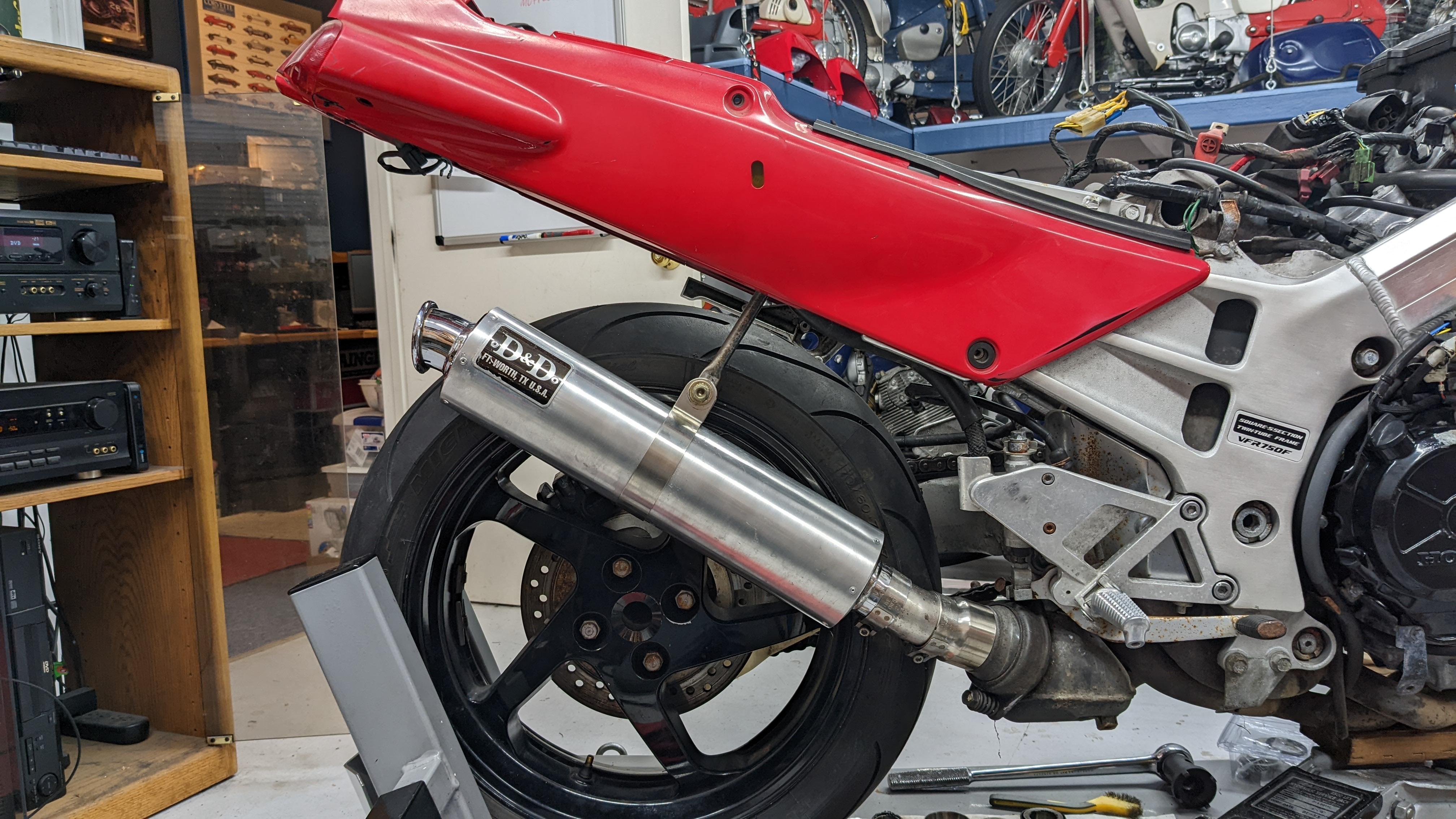

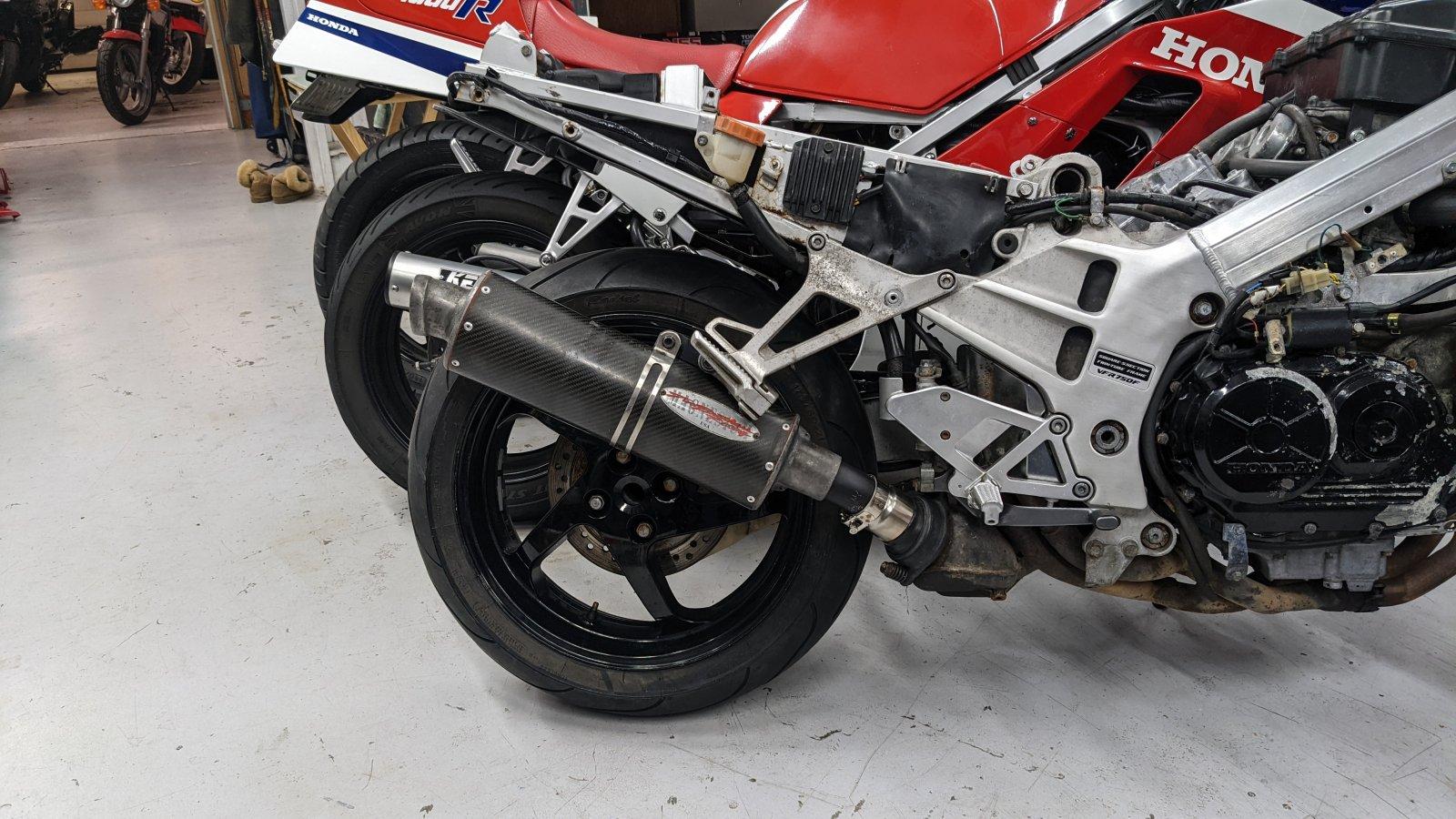

Member Contributer Captain 80s Posted May 6, 2022 Author Member Contributer Posted May 6, 2022 OK... another change. Bought another shitty muffler for the flange and fabbed up one more slip-on for a fairly crappy Two Brothers Oval CF Magnesium slip on. It had been cut down a bit and rebuilt after some damage and was on a 1986 VFR with a Kerker 4-1 I bought off a friend. I also swapped the passenger peg brackets off of the 1992 on to this. Probably better to have some passenger pegs on the bike I'm selling. I'll use the modified ones I did for this on the 1992, that will eventually have a left exit Full TB. In the meantime while I go thru the 1992 systems, before the resto and full exhaust, I can run the original D&D slip on I made that I like better. 1 2 Quote

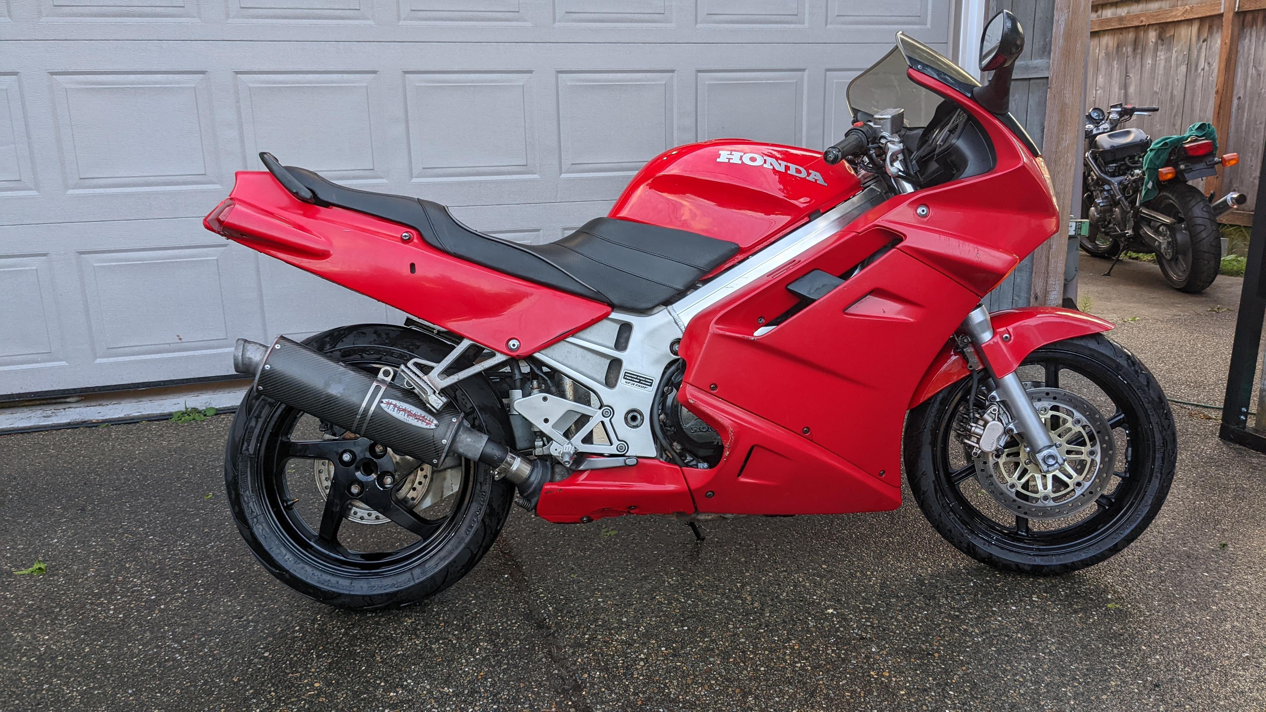

Member Contributer Captain 80s Posted May 19, 2022 Author Member Contributer Posted May 19, 2022 OK. Did a push for a couple evenings. Here it is now. It is idling using it's own fuel supply right there. I had to swap out the fuel pump with another used one I had, it was acting funny. Pretty close to sellable. Bike: 400 RR wheel: 200 Front wheel, discs and new Dunlop (date code 2020): Free. I got a full refund from the seller when I contacted him about some damage and a slightly bent disc that wasn't described in the listing. He didn't want it back. I straightened the disc, Shock: 100 Steering head bearings: 50 Slip on: Free. Came on a 1986 VFR I bought. Well, the adapter piece was 15. Tank: 150 Mirrors: Free. Came off the 92, which I have perfect ones for from my 95 that has 01 mirrors on it. Here's what I got off of it. 8 spoke rear wheel (+ stock front wheel) Stainless front brake lines RT fork springs Fox Twin Clicker VERY nice original fuel tank 1 1 Quote
