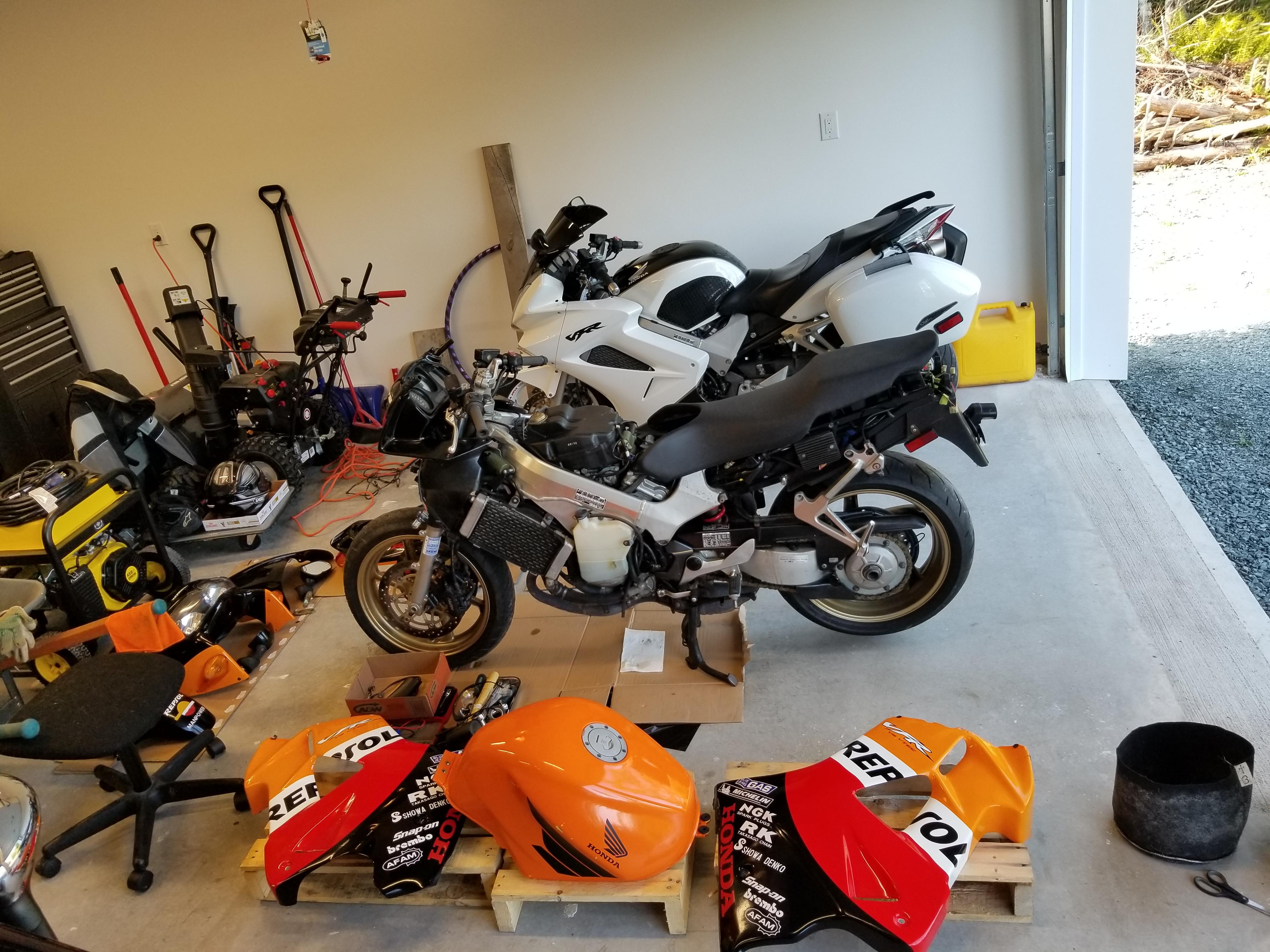

Doing the daily search online, find a local 5g which has a write-up indicating that the fuel tank rusted out and the bike wont run due to debris.   He just wanted to get rid of it... we emailed and chatted... I rode over to take a look.  $900 and 3 hours later he's taking it out of his truck in my driveway.  Was it fate?  I did NOT expect a VFR to be my <$1000 project, and I couldn't be happier!
So we have a 1999 VFR800.  Not quite 47000km. Original colour was yellow.  Non-running currently.  New battery.  Ancient scary tires.  No exhaust can. Cheapy ebay REPSOL fairings with paint runs under the clear & decals... good from 10ft [they will attach better than in pics; mount points on bike are tweaked, and there are only a few bolts currently holding all the plastics on... yikes].  Bike lived outdoors for a couple years per the PO, and parts are weathered.

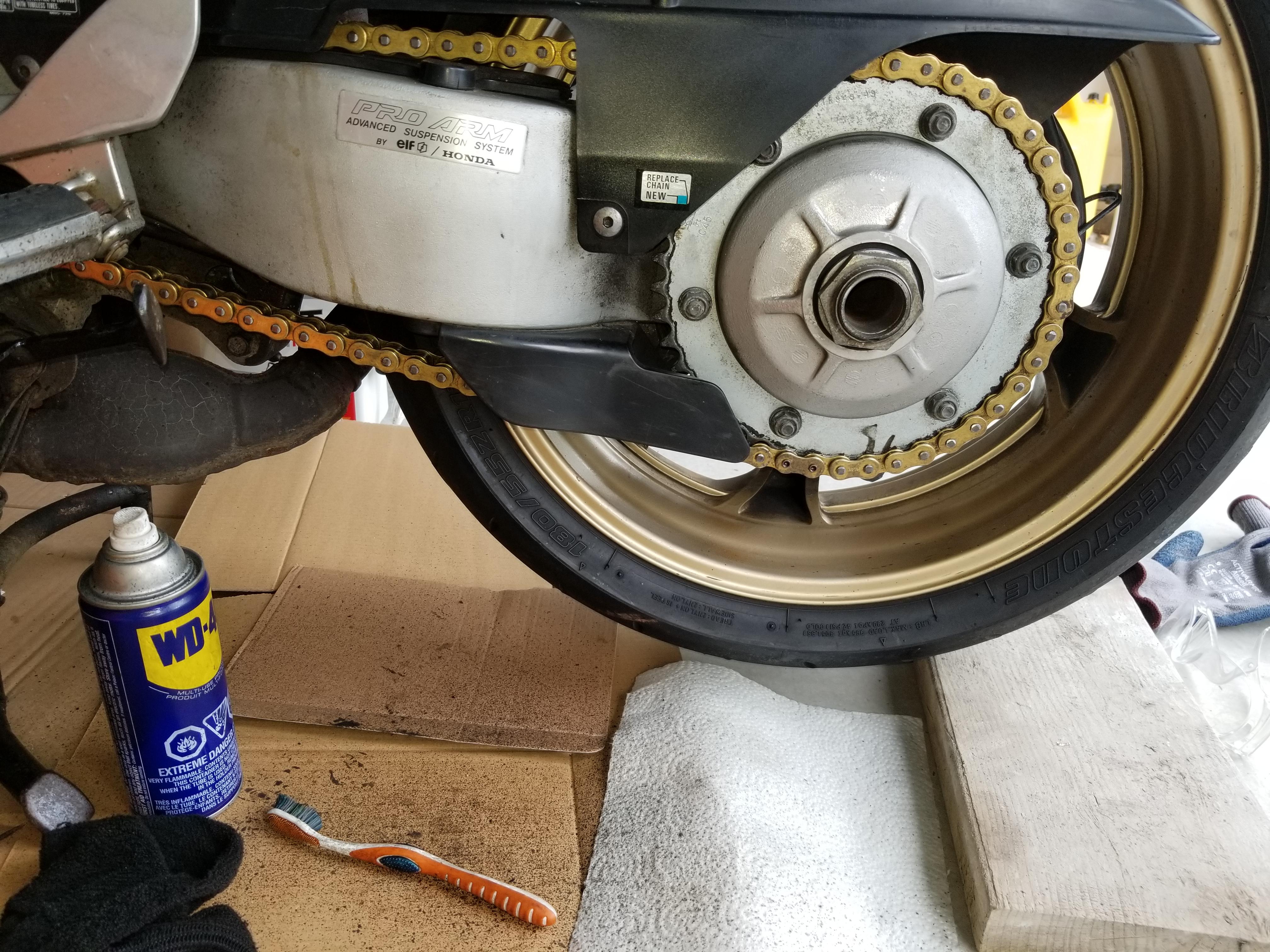

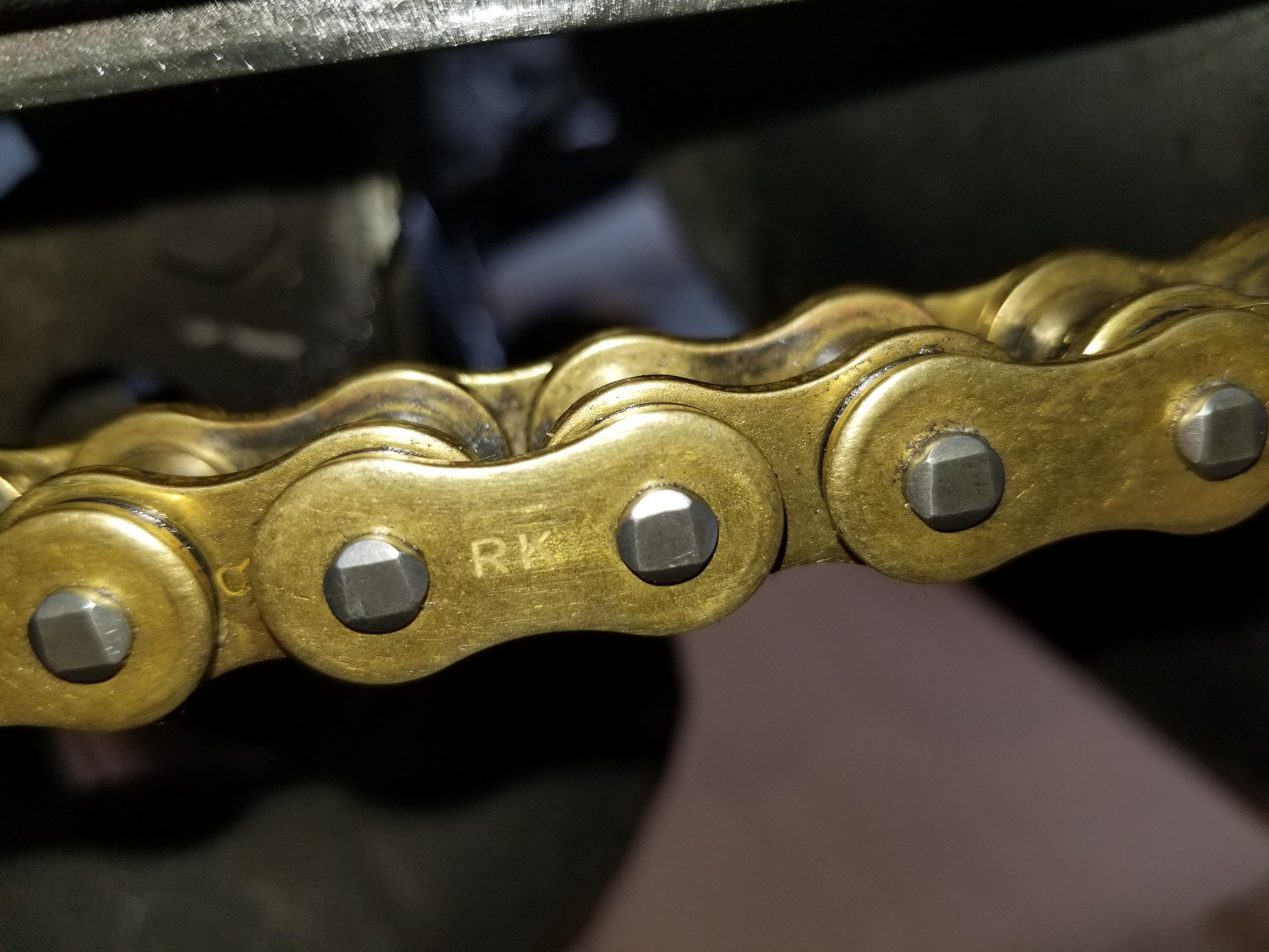

Spent some time cleaning up the chain a few months back; it looks to be in good shape along with the sprockets.

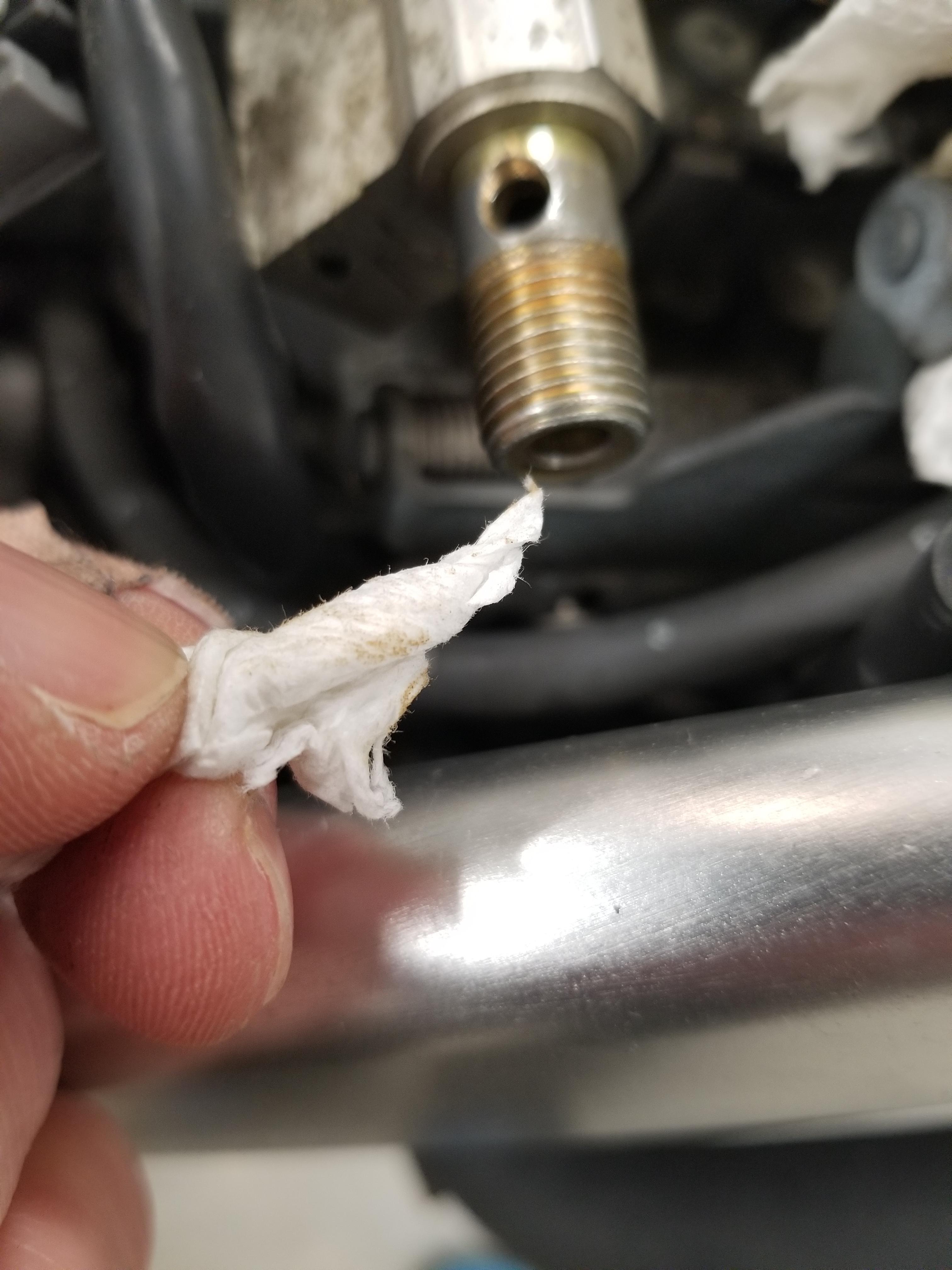

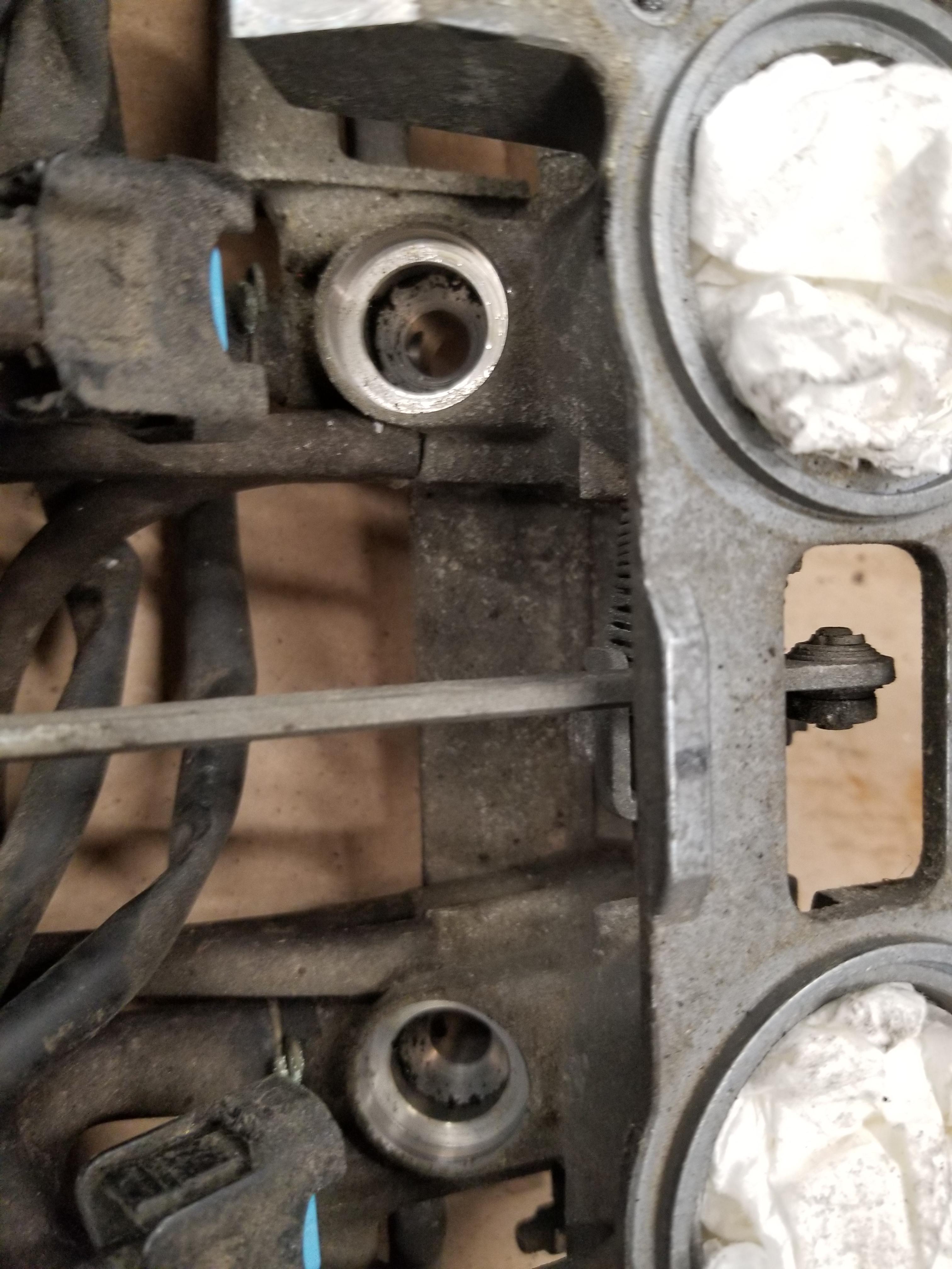

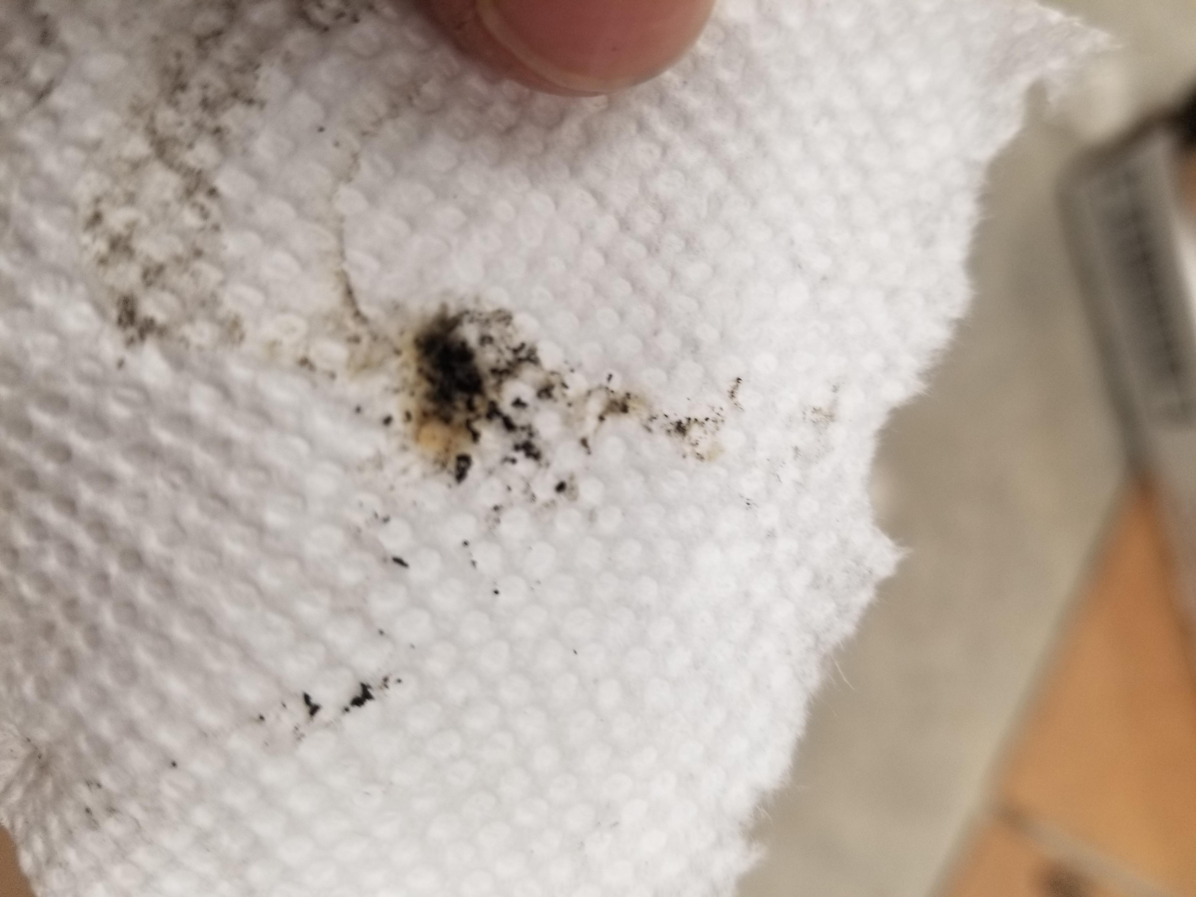

The bolt which connects fuel line from tank to fuel rail had been removed during previous troubleshooting.  I also removed it, and pushed some paper towel into the rail to see if there was rust / debris contamination from the fuel tank.  Didn't take a pic at first, this was a re-do (and a poor one), but yes the first swab was all brown and rusty.  I swabbed the end hole and the hole which lines up with the banjo on the fuel line from tank.  Same result in both, rust.

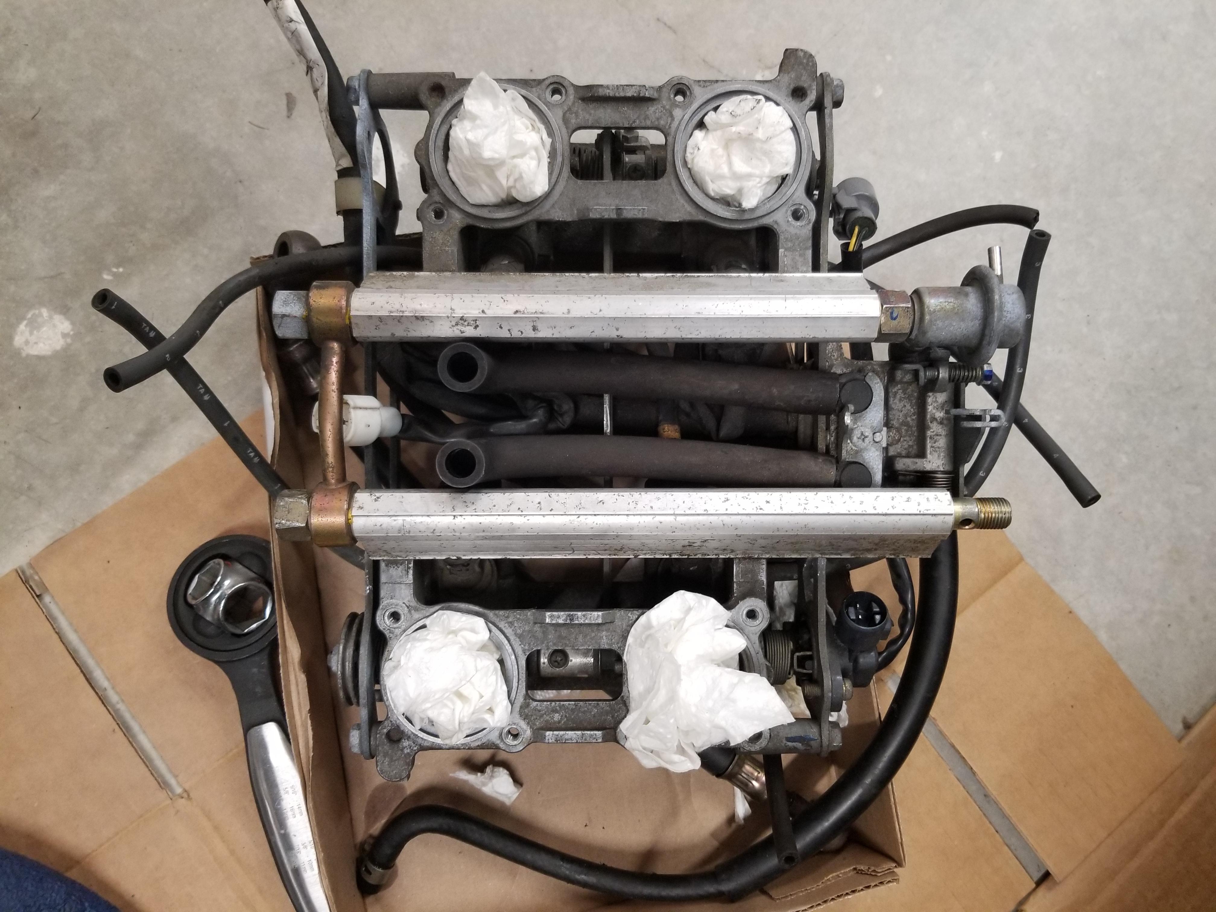

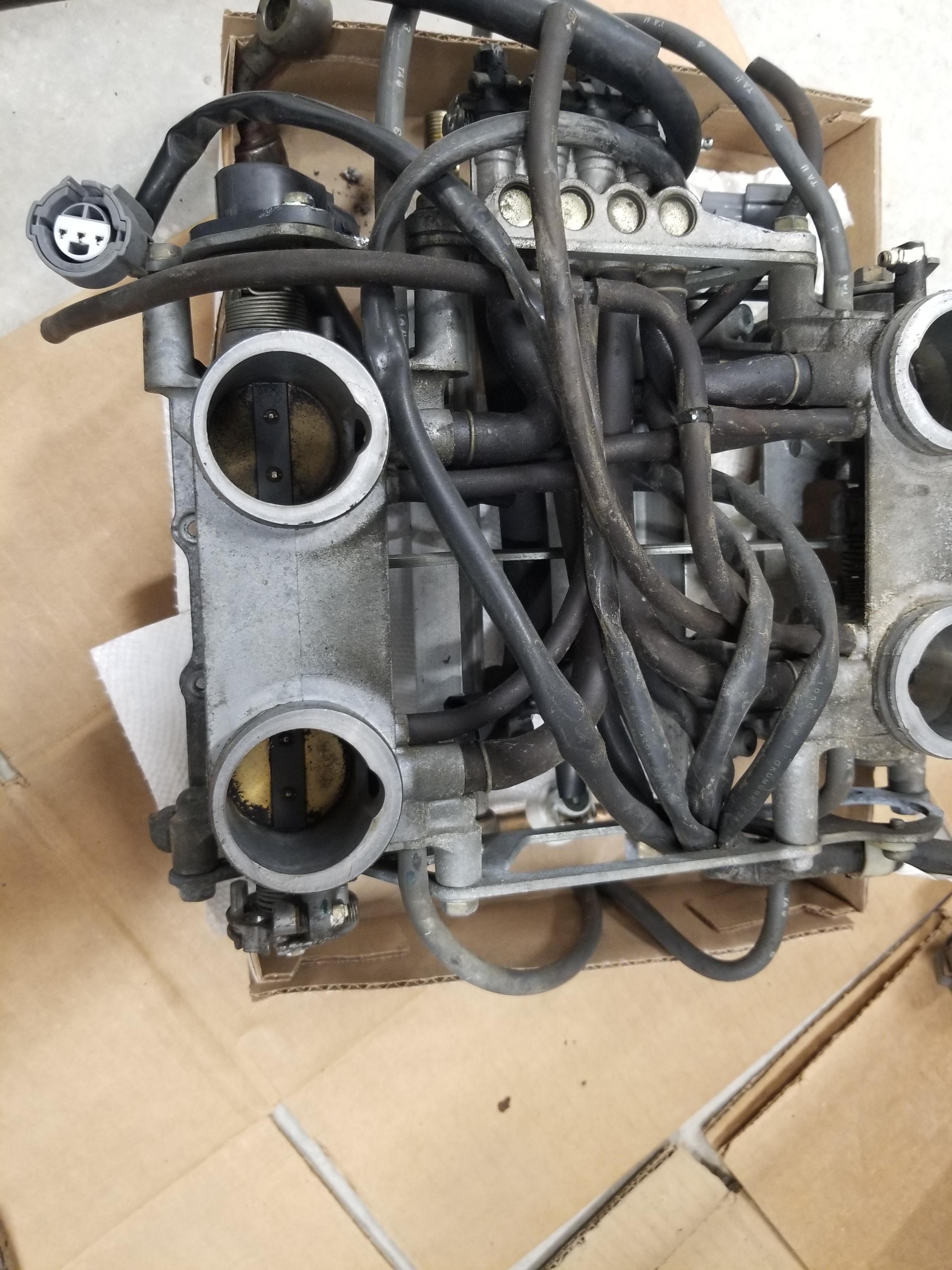

So that said, the throttle bodies will be coming off so I can attempt to clean the fuel rail and injectors.

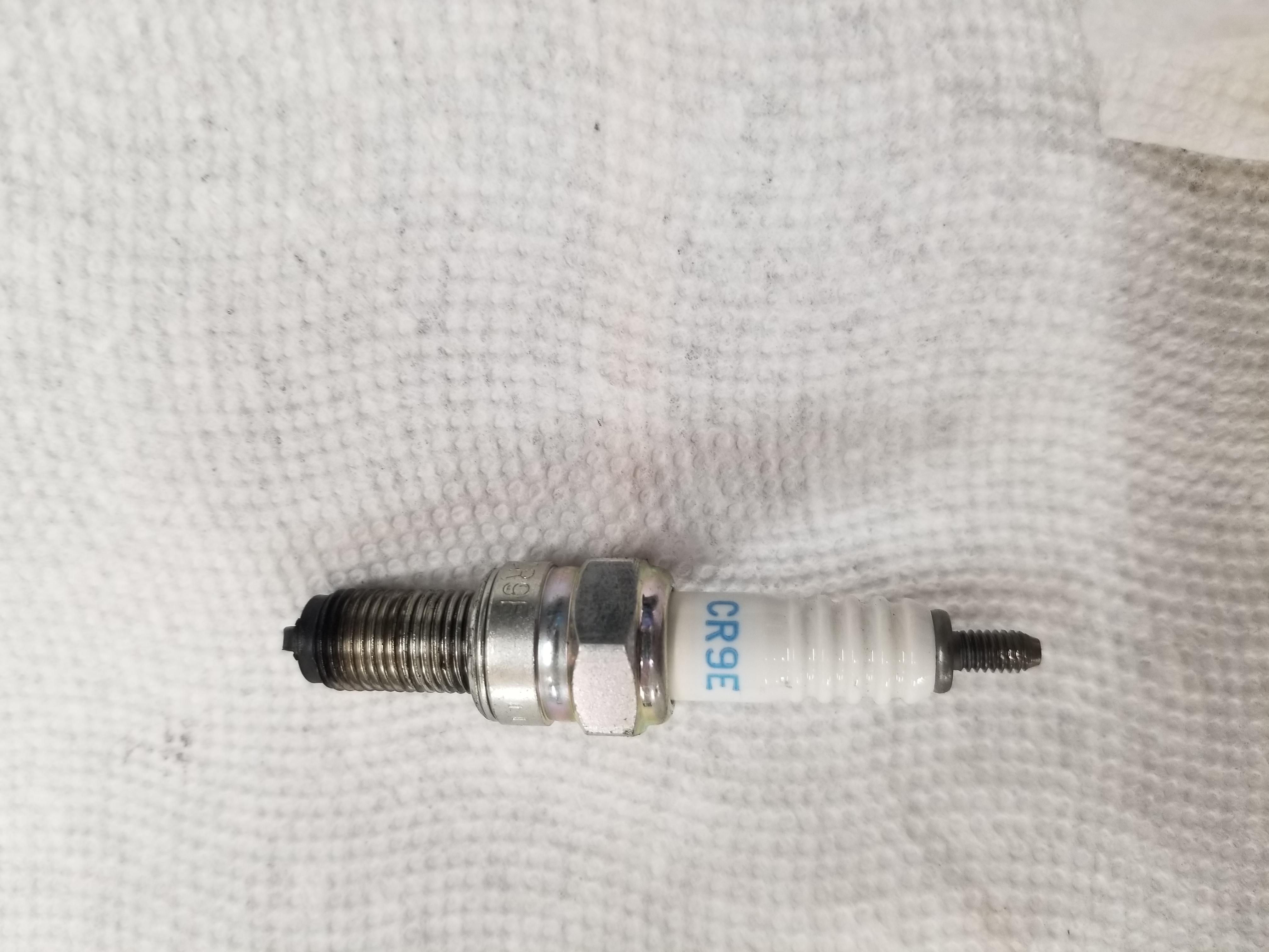

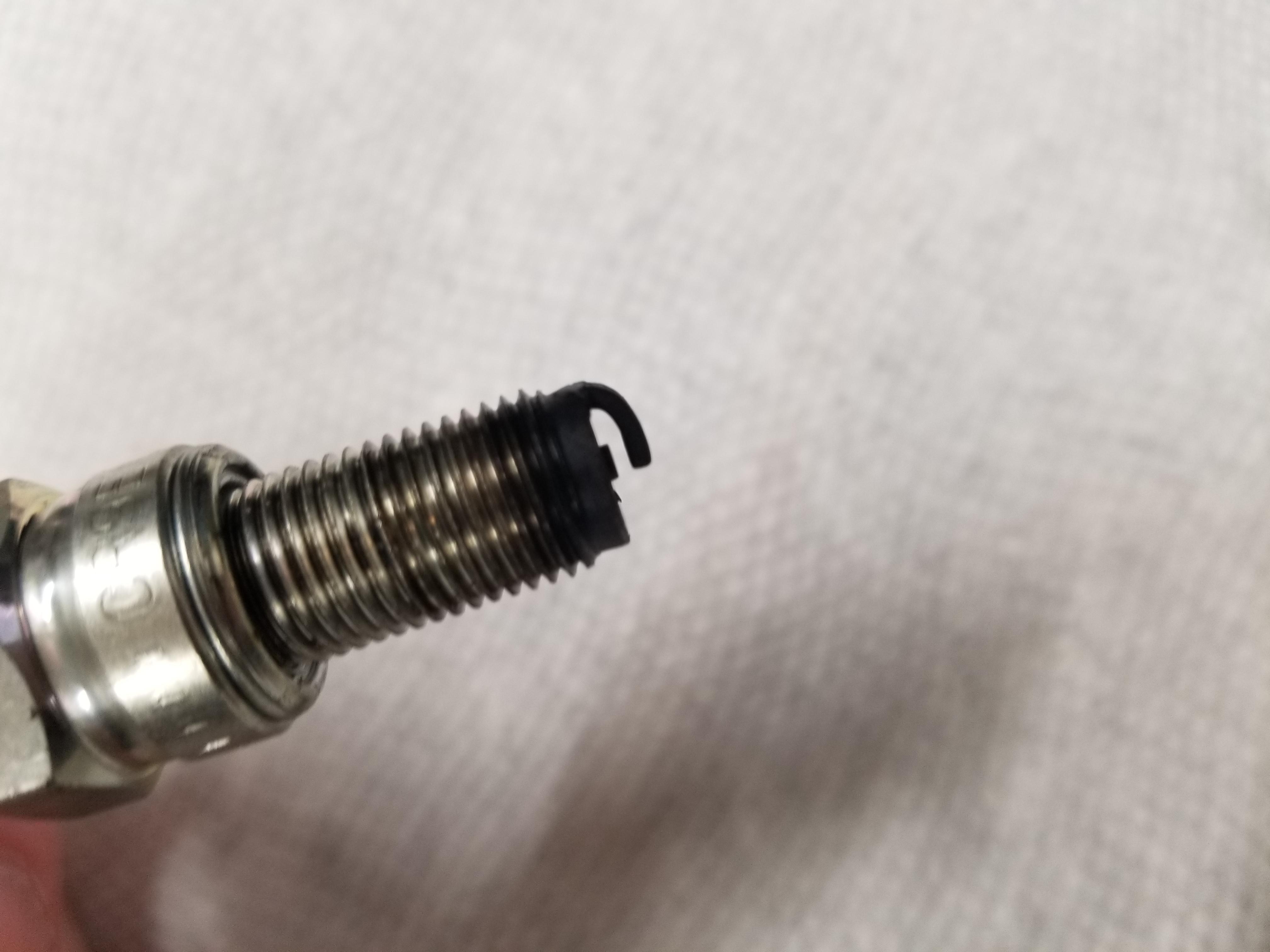

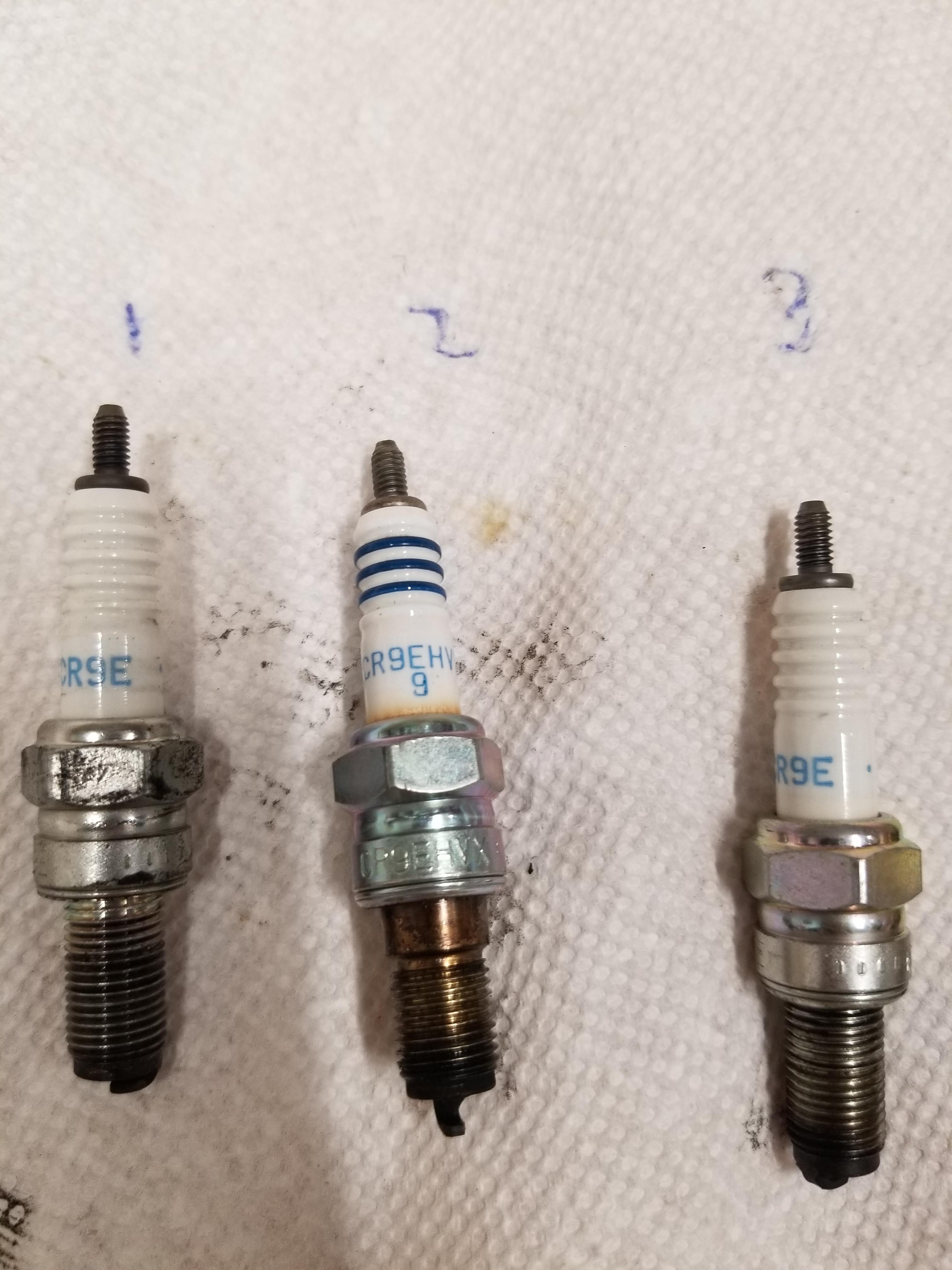

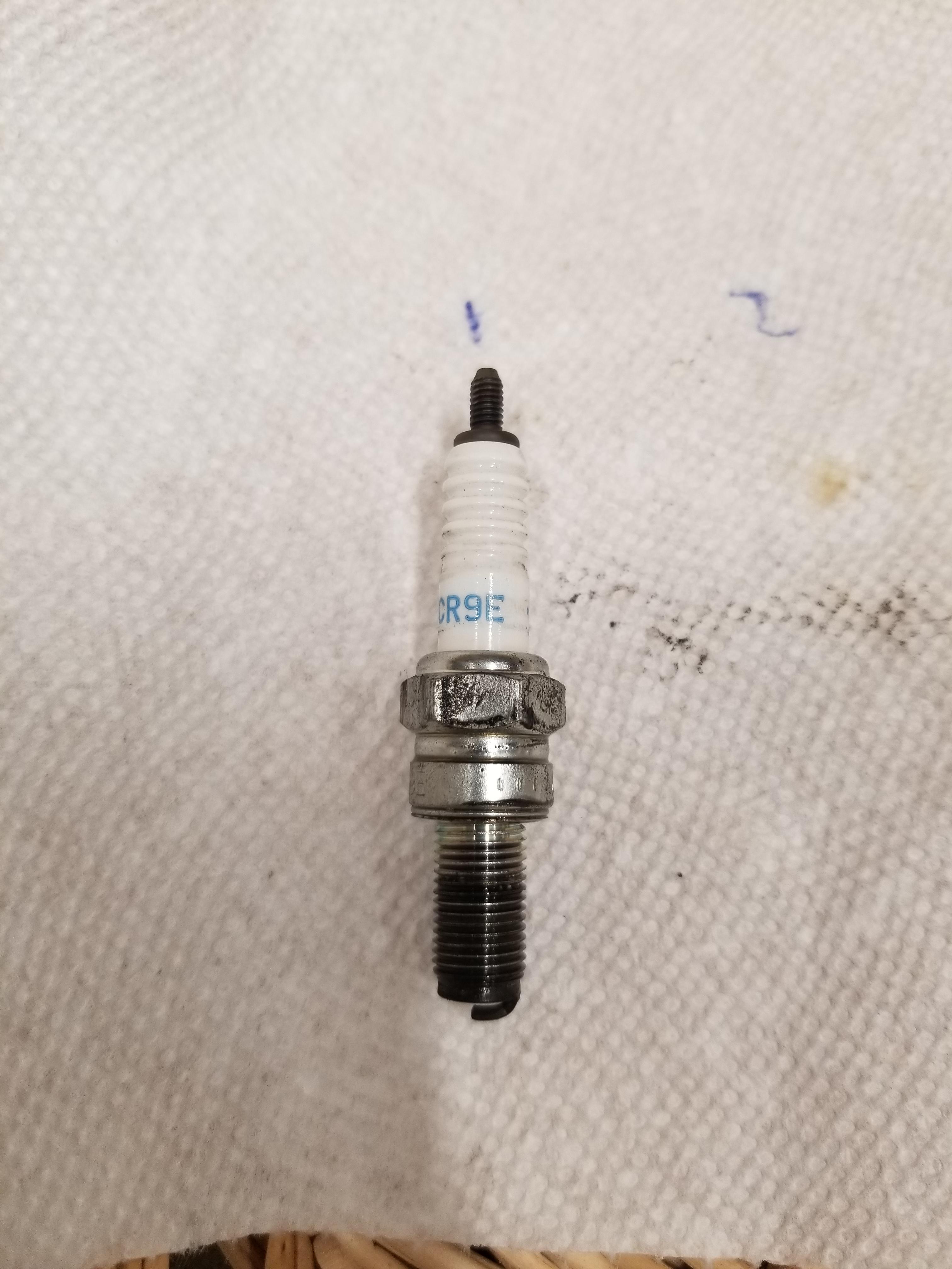

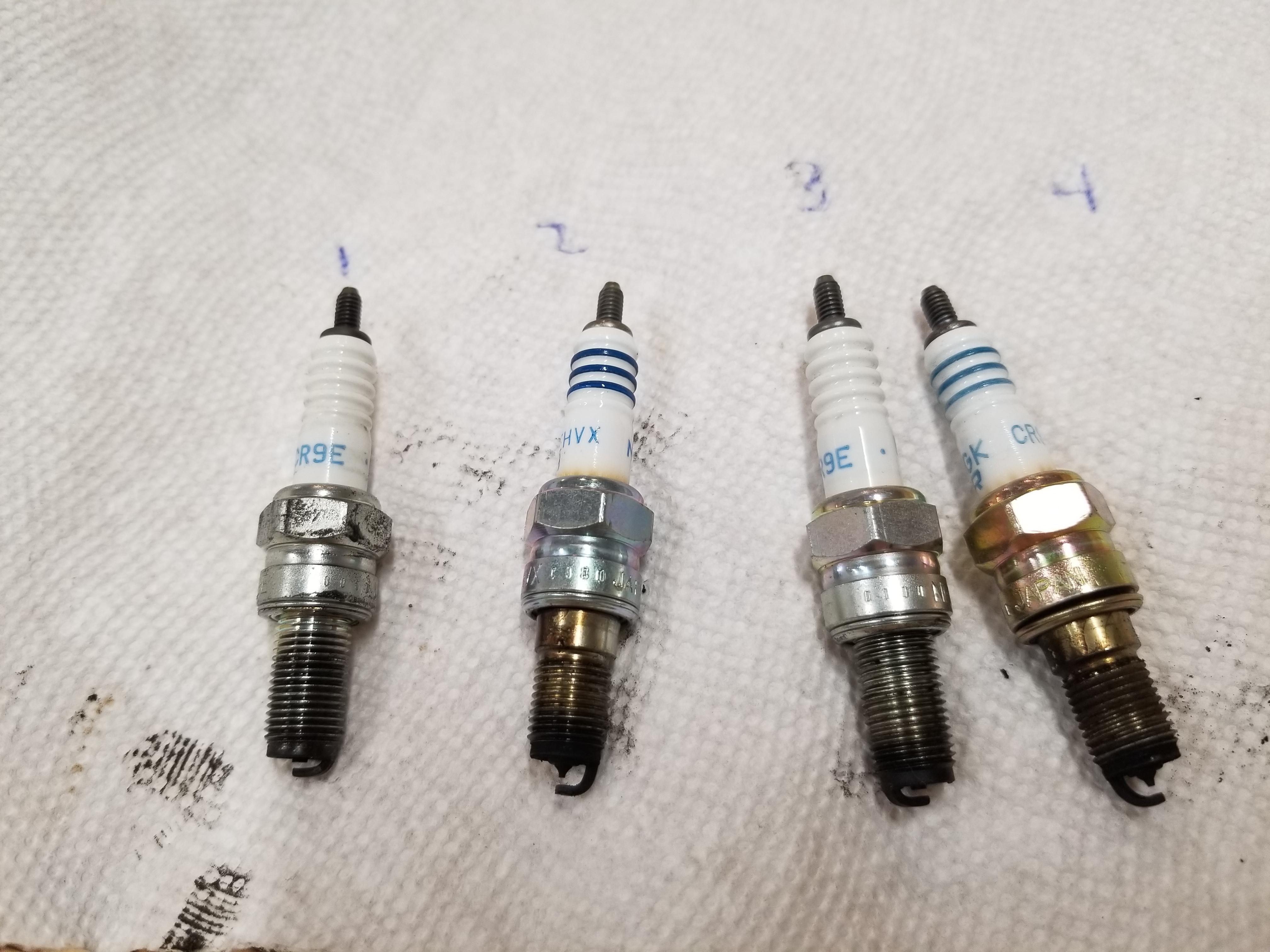

Since there is an unknown maintenance and troubleshooting history, and with the tank already disconnected I never tried to run it, I figured I would pull a spark plug next and see if there was any noticeable issue there.
Looks like a spark plug ... no rust or debris ... anyone see a problem here?  I think its all good, will pull the other 3 eventually to be sure.

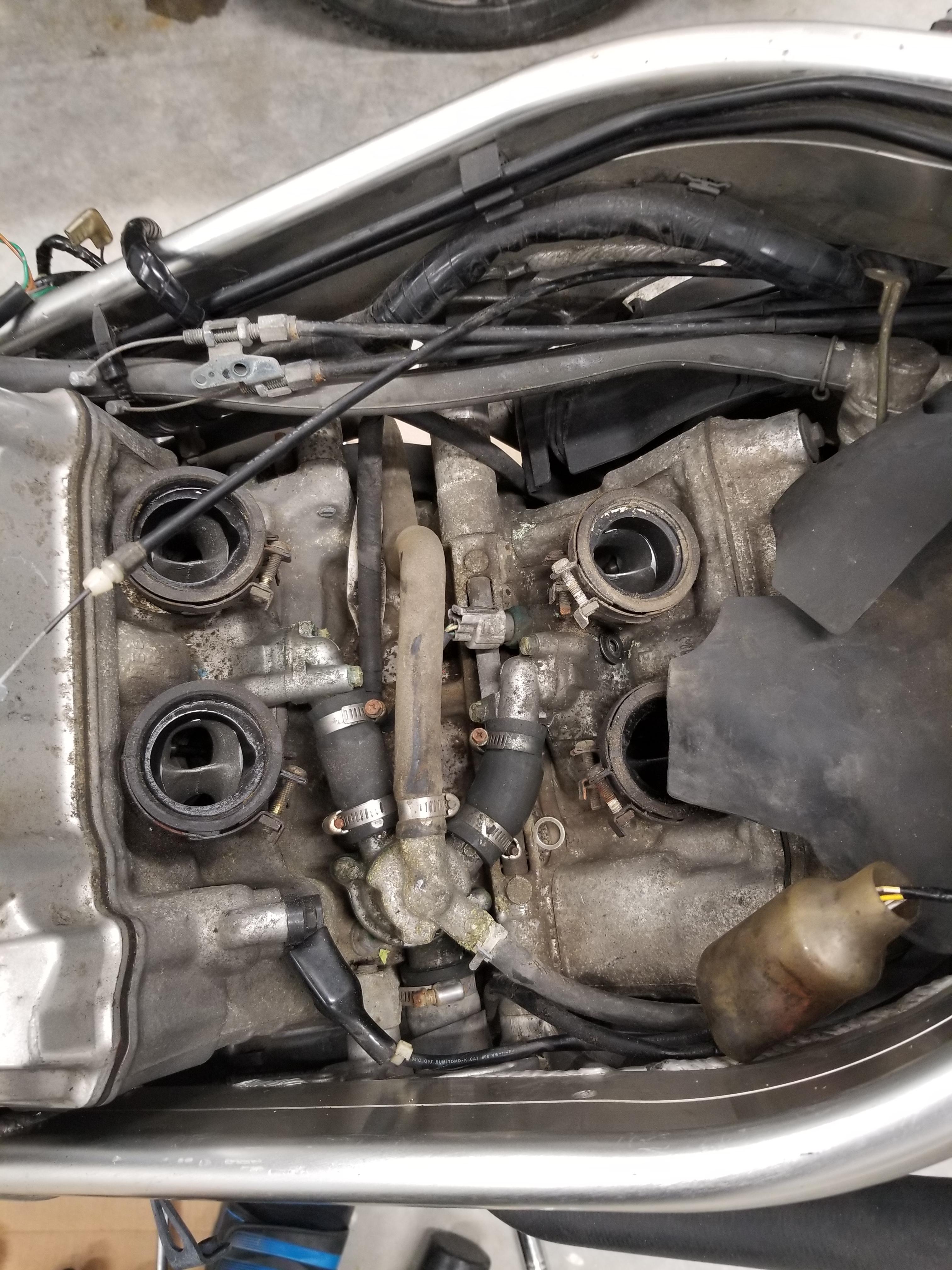

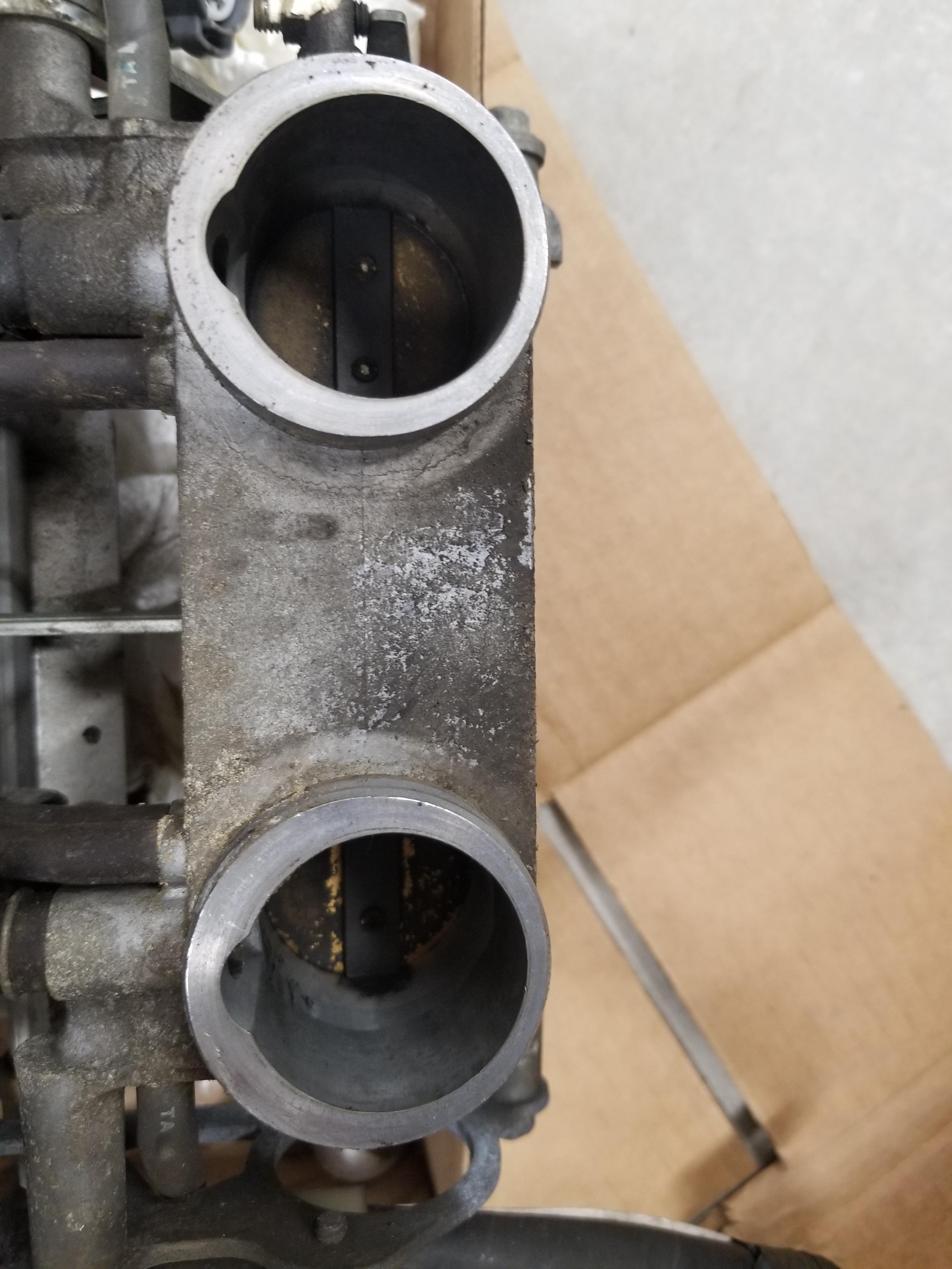

So that said, I'm optimistic that the rust and crap from the fuel tank only made it as far as the rail & injectors.  So lets pull the throttle bodies; never done that before, have avoided it on my 02 through the years... but its time
This is as far as we've taken it today.  Tomorrow I will get into the throttle body.
Still undecided on how far to go with this... original plan was just get it to run, ride it for a bit and sell it.  But now I have a 5g... why would I want to sell it?  Trying to decide how heavily to clean the V... and whether to start buying parts or focus on getting it running.
To be determined!
Plug looks like super-rich mixtures. If that's #3 or 4 with #1&2 being clean, you may have failed FPR.
Thanks Danno... appreciate the feedback.  FPR is definitely a potential culprit for the poor running condition that I have basically zero info on!
It is #3.... I'll pull the others in the next couple days and post for comparison.

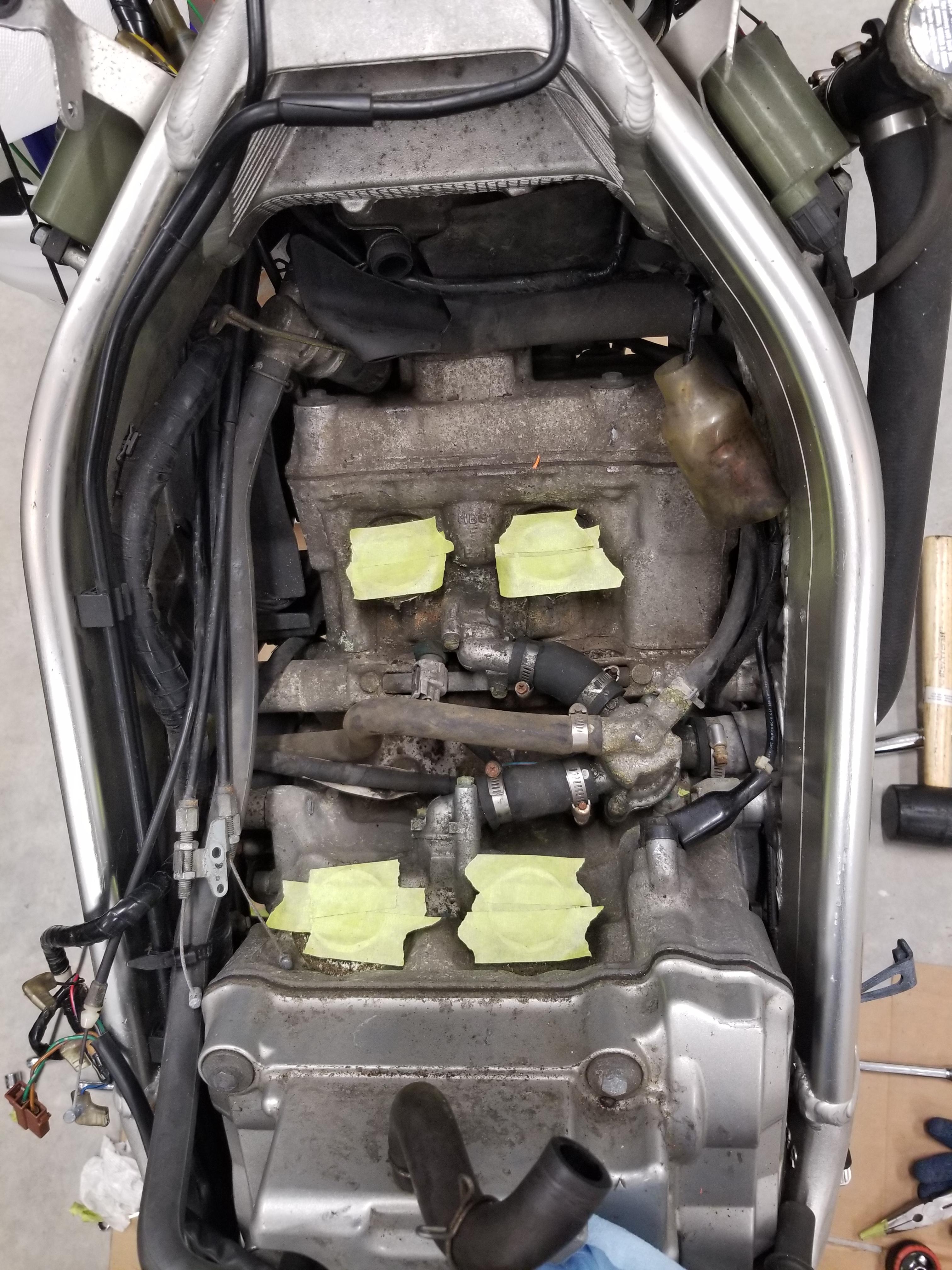

2 things going on here today...
First, starting point after yesterday's endeavor

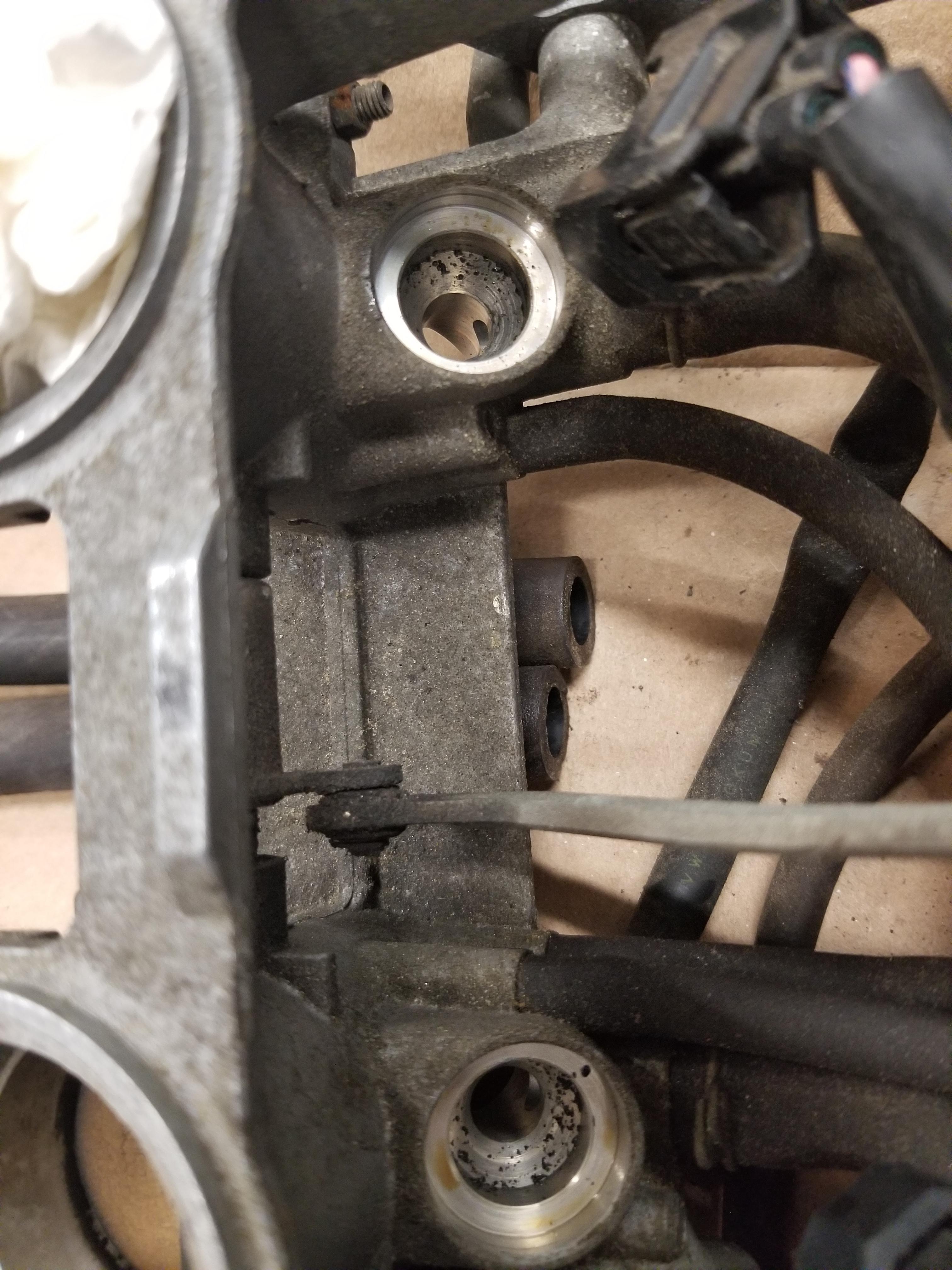

Lets take a look at the throttle bodies...

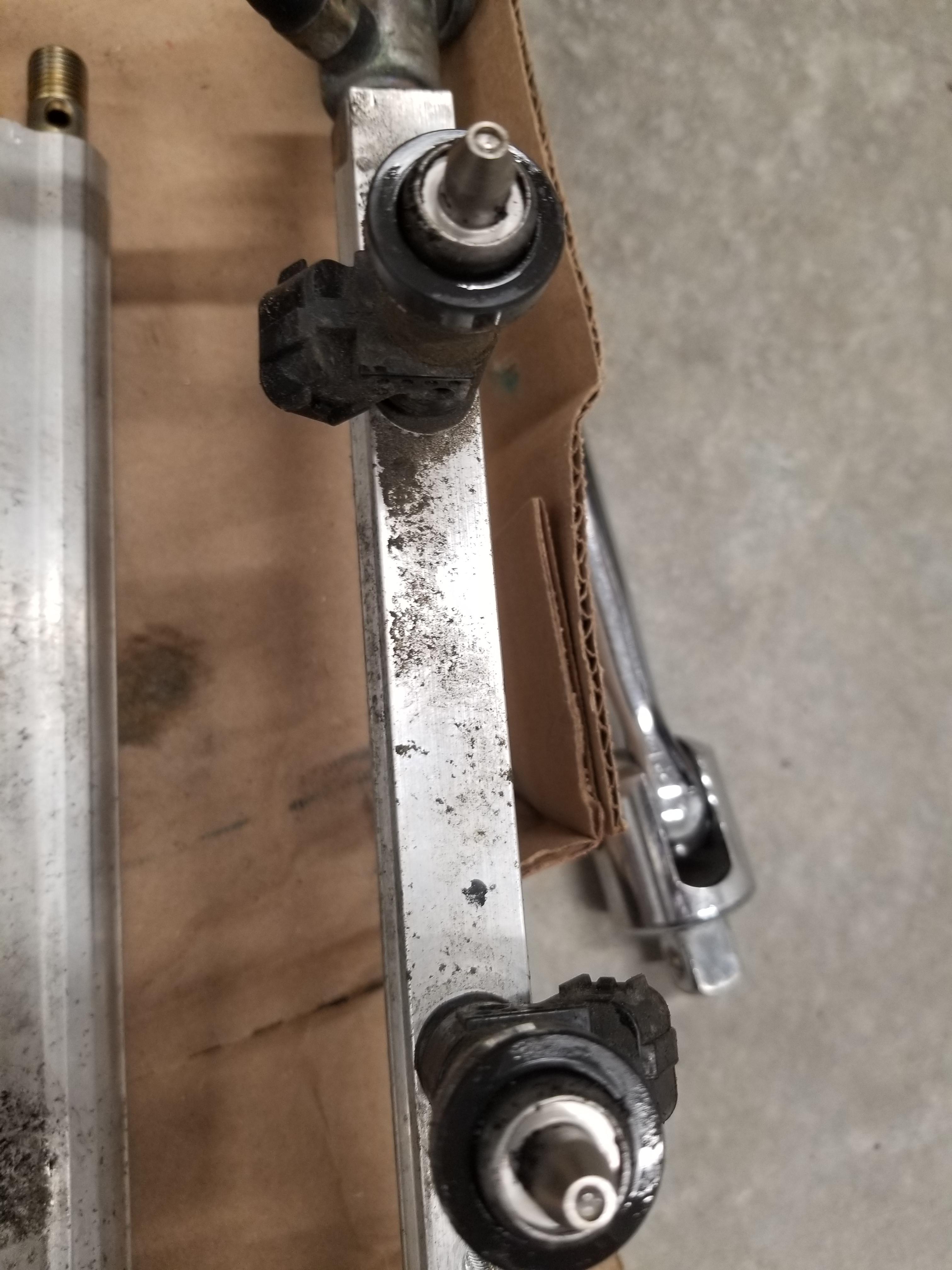

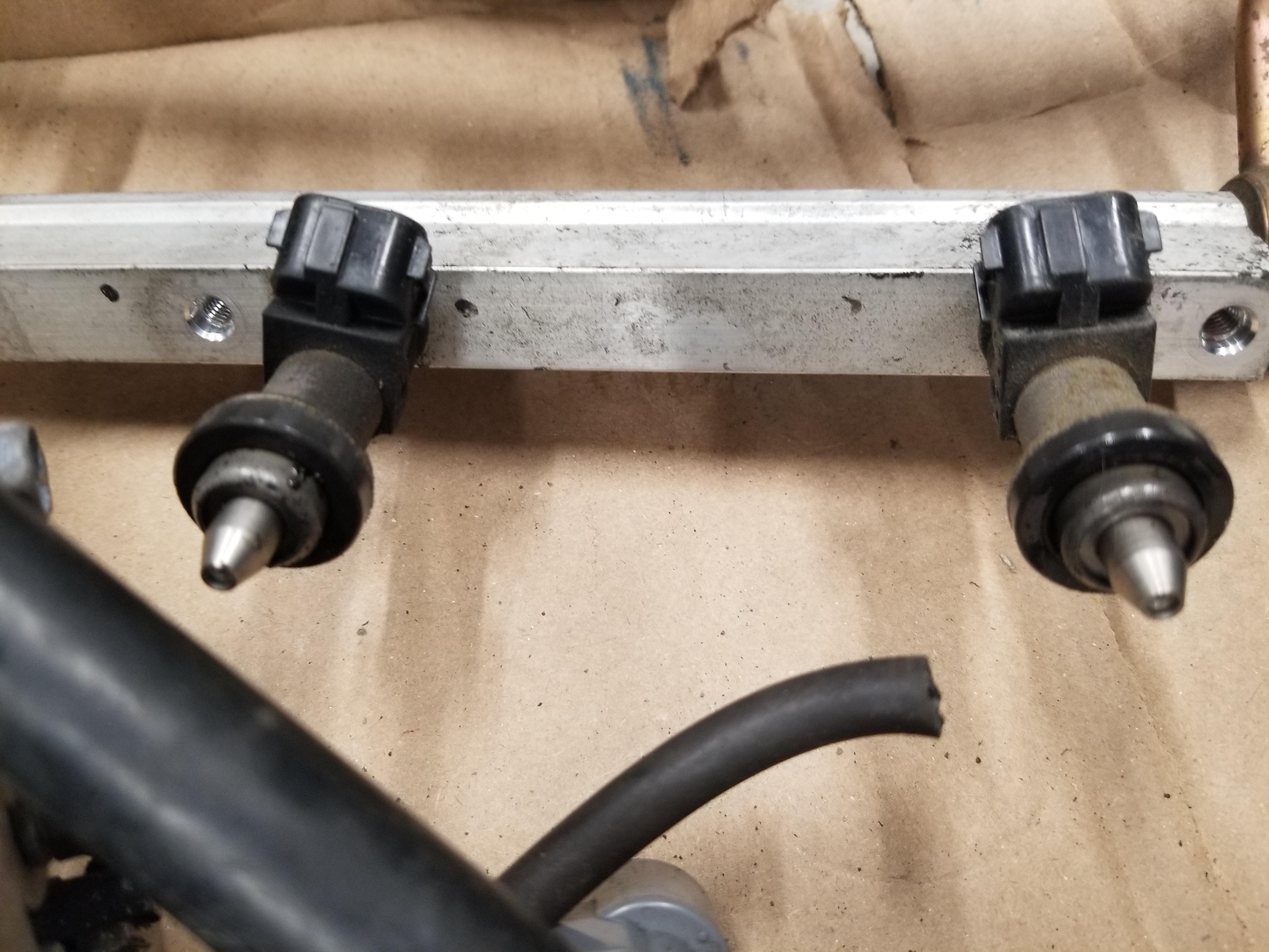

The injectors themselves...
Their seats in the fuel rail... complete with debris
Gunk appears to be rust particles and gasoline from said crudded up fuel tank...

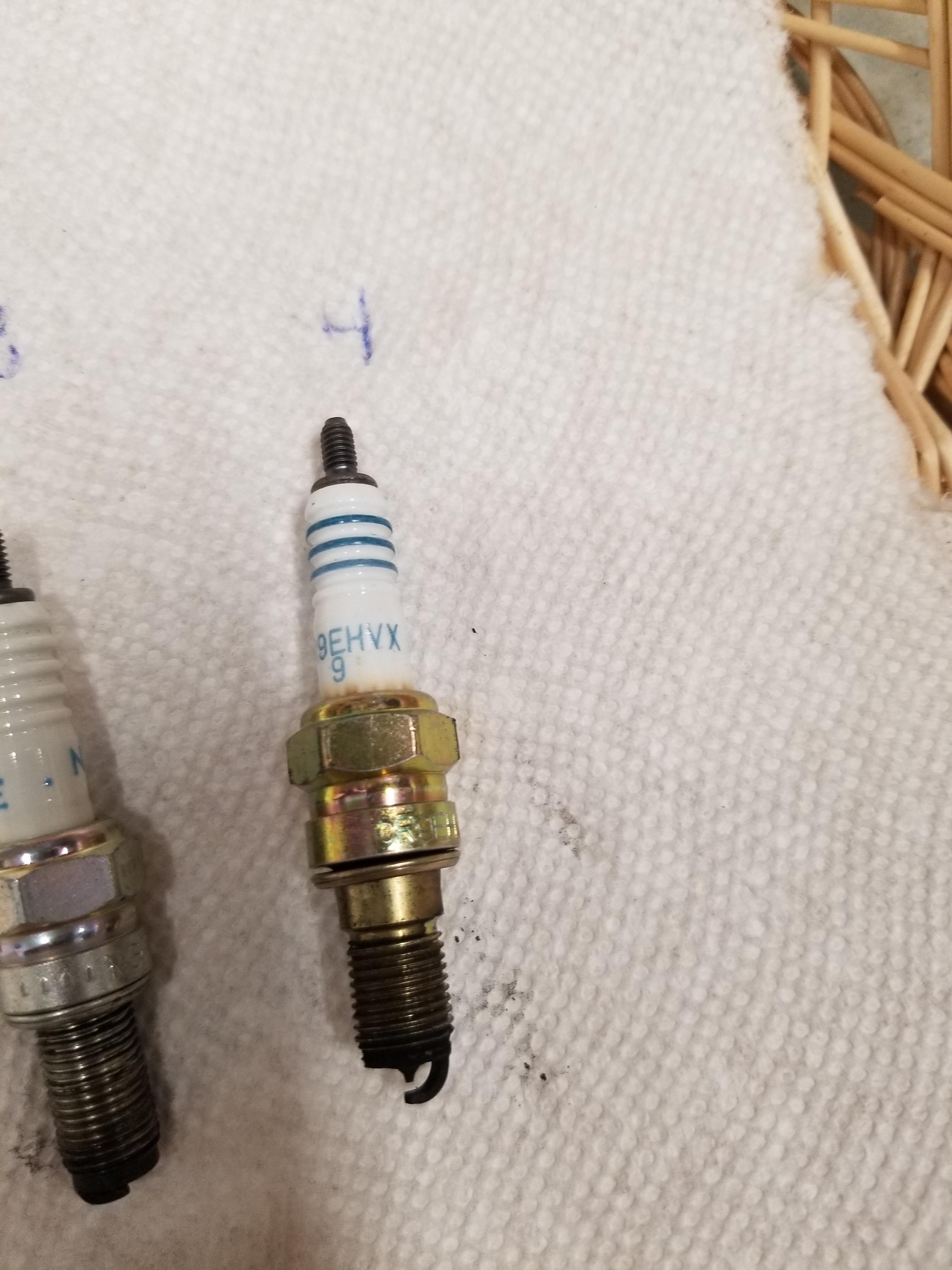

At this point I figure I'd better pull the other 3 spark plugs and see whats up... I had already pulled #3, it came easy (felt 1/4 turn past finger tight).  #1 was stiff and I was immediately worried about whoever had played with it before... but after a bit of pressure it let up.  I then went around front and moved the oil cooler; #4 and #2 were both 1/4 turn past finger tight, and I was perhaps a little surprised to see what came out...
So if I were guessing, the front bank #2 and #4 are original or at least have been in place longer than #1 and #3. They have more burn on the porcelain and more soot on the electrode end. #2 and #4 are the same type, the CR9EHVX  9.  However #4 is gold colored base, #2 is silver colored base.
#1 and #3 are identical, CR9E.
Service Manual says CR9EH-9.
Continues to make me curious about what has gone on with this bike 🙂
Hopefully I can get these parts all cleaned up and go from there.  Will remove the injectors from the rail and start cleaning that up this afternoon... think I should replace these plugs?  I'm inclined to want 4 known new/good/ all the same

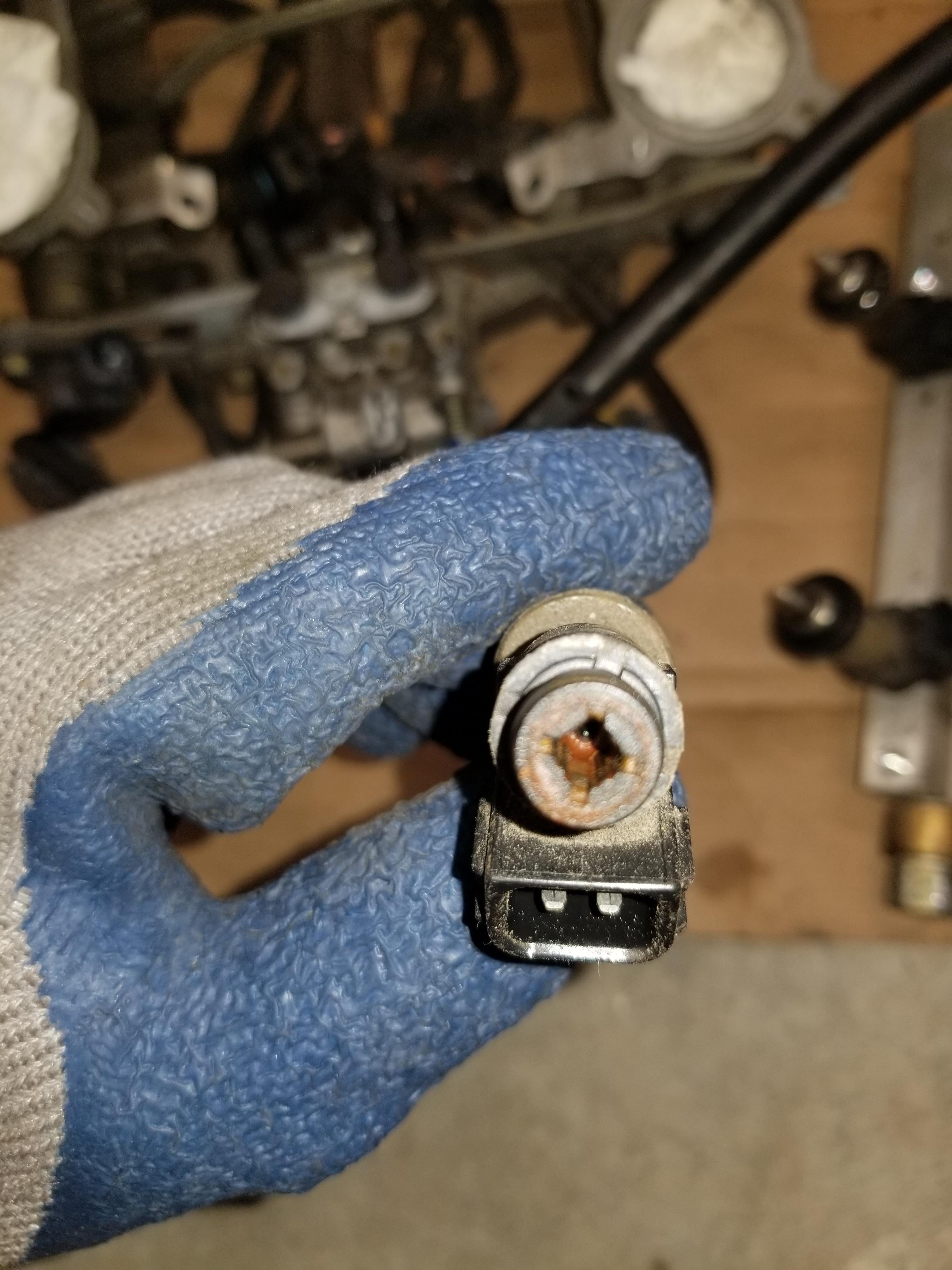

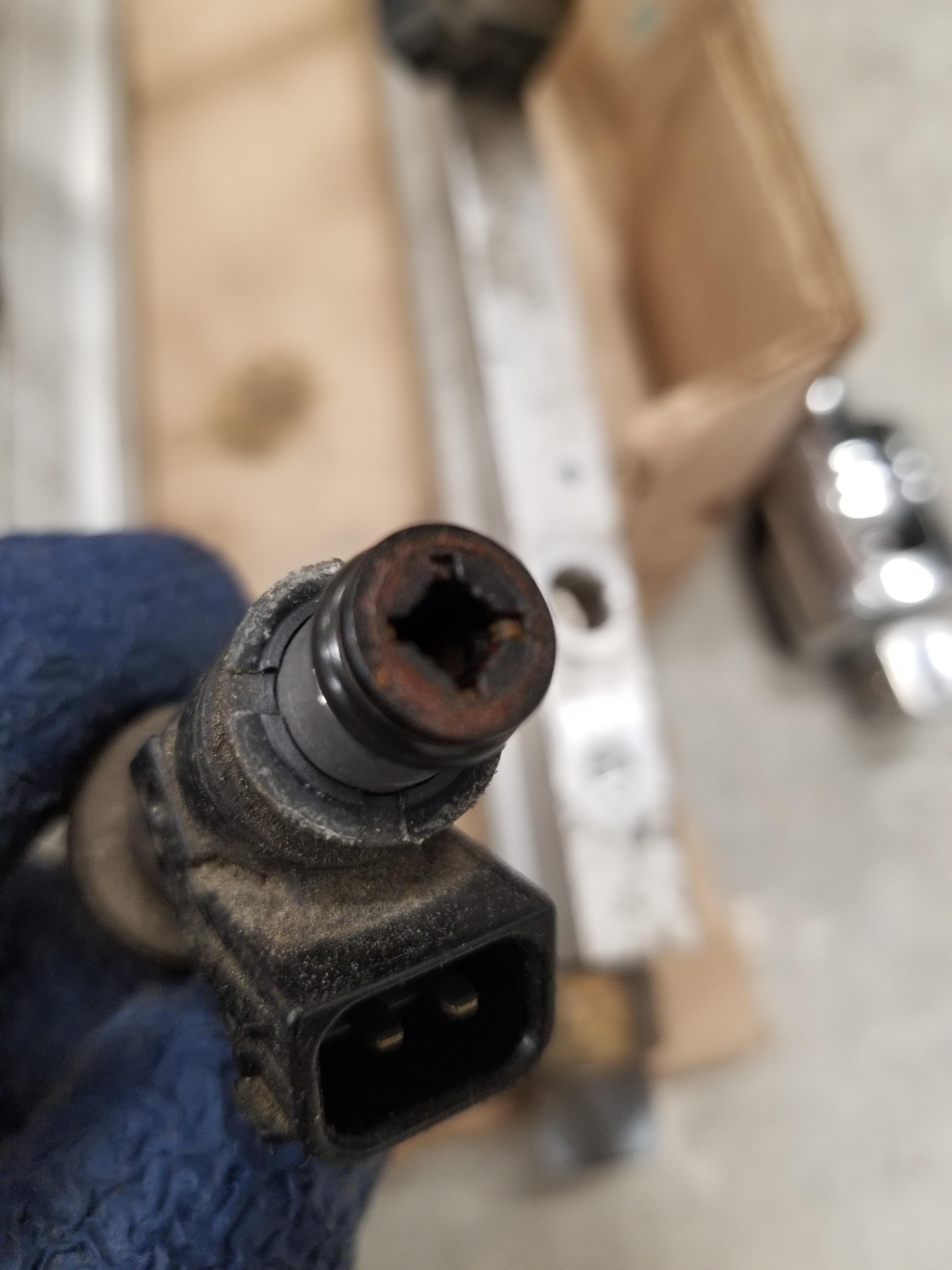

So we pulled the injectors... plenty of rust crap on top and in the inlet.

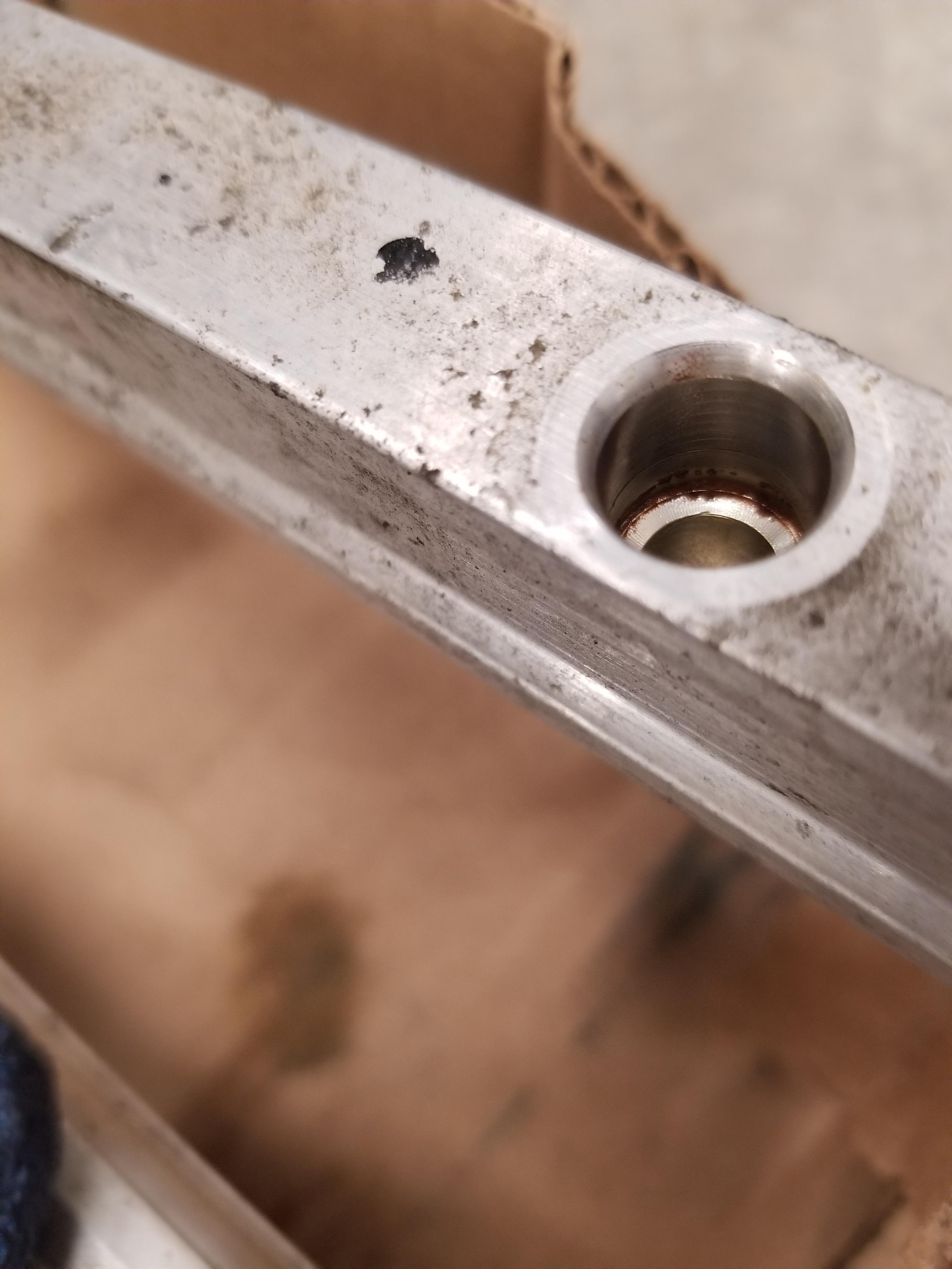

And some rust remnants on the rail output
I guess at the moment the goal is to try to flush them with carb cleaner and do the 9v battery trick... will see what happens and go from there.  If I can get a reasonable spray, hopefully these are salvageable... we have a good local company who does injector cleaning, had my 02 injectors done a few years back.  If they aren't salvageable I can replace them.  More than anything I just want to get to a 'good enough' state FIRST so that I can put everything back together and test fire the bike.  I knew all about the rusted out tank and the crud dragged through the fuel system.  What I don't know is if the PO was being forthright... ie is the engine snafu'd?  Really want that answer before I start paying for parts.

you'll want to flush injectors backwards. Toyota has kit for this. I suppose you can use carb spray/air-compressor, some rubber hoses and 9v battery
