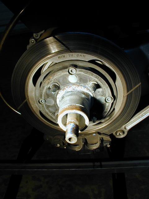

Walker1 Posted July 17, 2021 Posted July 17, 2021 Ok guys.. the chin adjuster seized so I decided to take I apart.. Took off the exhaust, broke the axle nut (with some great force and effort), removed the brake caliper and then I was stuck... The sprocket would not come off.. Using a piece of wood and a lump hammer (and a few days soak with penetrating wd40) and a few wacks eventually the sprocket came off.. wahoo! The unfortunate part is I am now stuck here.. I got a bigger wood and a bigger hammer and have given the axle a few more belts but nothing.. not a budge. Iam stumped.. any suggestions? Quote

Walker1 Posted July 17, 2021 Author Posted July 17, 2021 3 hours ago, Skids said: Are you following the Service Manual (downloadable from this site)? I haven't taken the rear hub off a VFR for a few years and I can't remember any differences from the 5th Gen, but I thought you needed to remove the brake disc assembly? I'm sure someone more knowledgeable will be along soon. Yes sir.. I have it done along with the manual.. I believe that it has corroded on as the full sprocket should slide off and the axle should slide out! Quote

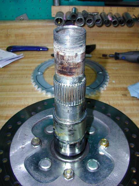

Member Contributer BusyLittleShop Posted July 17, 2021 Member Contributer Posted July 17, 2021 What you are dealing with are the negative effects of of corrosion... mainly due to riding in the rain or hitting your prize with a garden hose... both acts promotes corrosion in all the little nooks and crannies hidden from view... The pitfull is that metal is etched for life... Your axle is probably frozen at the wheel bearings due to corrosion from either rain riding or washing your bike with a garden hose... if the rubber hammer fails then you need more force like a large steel hammer... to protect the axle and threads source a hard wood block or plastic... installed the nut backwards so the flange faces you... strike the wood / plastic against the nut... the force to budge the axle maybe extreme so be prepared for the bike to move about... also be prepared for the axle to propel free in a shot... having a second body helps to control the reaction to the hammer force... after the axle is out check to make sure the wheel bearings are still seated in their place... a little grease will prevent this from happening again... Heat helps... always tackle disassembly after a ride when all the parts are up to temp... working with room temp parts is more resistance... 1 Quote
Walker1 Posted July 17, 2021 Author Posted July 17, 2021 2 hours ago, BusyLittleShop said: you are dealing with are the negative effects of of corrosion... BusyLittleShop you legend. Got the bugger off. Put the nut on, gave it a belt and bing bang boosh! Lots and lots of corrosion.. the inside of the sprocket looking not so good nor the axle itself.. any tips to clean these bad boys? Also you nailed it on the head.. I use this bike year around and also washed it down a couple times with the hose Next part is to remove the caliper mounting plate.. also wont budge!! Wahoo Quote

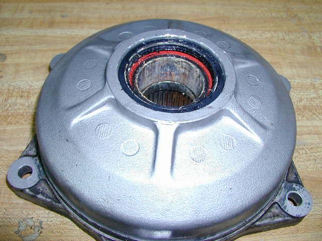

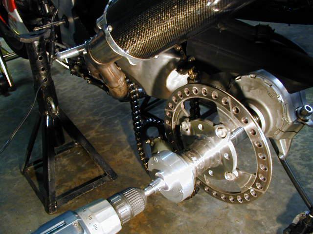

Member Contributer BusyLittleShop Posted July 21, 2021 Member Contributer Posted July 21, 2021 On 7/17/2021 at 11:58 AM, Walker1 said: BusyLittleShop you legend. Got the bugger off. Put the nut on, gave it a belt and bing bang boosh! Lots and lots of corrosion.. the inside of the sprocket looking not so good nor the axle itself.. any tips to clean these bad boys? Here are my axle care notes that I send out to RC30/ RC45 owners... you'll have to download the photos for the lesson to make sense... Because the RC30 and RC45 employ the same caged needle bearing the rides directly on on the rear axle I offer my method to clean both the axle and bearing... Once you have the bearing removed you employ a two jewelers screw drivers and carefully lift each roller from the cage... Give the rollers and cage a bath in gasoline... you be surprised at all the dirty deposits hidden in the old grease and every nook and cranny... you're looking at the deposits after only 10K miles of normal operation... Once the bearing are really clean lay them out and inspect each roller for scoring... Dirt mixed with the old grease will leave a trail of deposits on the axle at point B... Spun in a Lathe... it's easy to remove the deposits employing a gray micro fine 3M pad... it's soft enough that it does *not* remove any precious metal... employ a soft wire wheel to bring the other parts of the axle back to a luster... What you'll end up with is an axle with the deposits remove plus giving the metal a nice luster... 1 Quote
