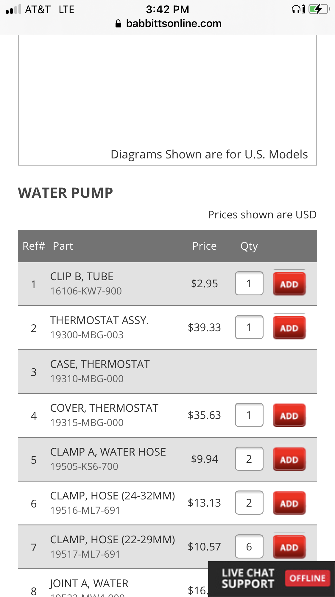

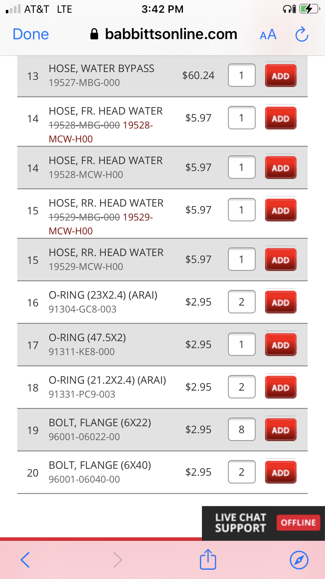

Member Contributer interceptor69 Posted July 4, 2021 Author Member Contributer Posted July 4, 2021 Thanks Duc for all the info. I have the new fan in the cart and will add these o rings to it. I believe I'm going to order a hose kit from AS3. Should I order all new clamps as well? Or will they be reusable? I'm worried about how much crud will be in/over them. Also I was looking through a few other threads relating to replacing the hoses/thermostat and noticed 2 gaskets that were completely disentegrated. They didn't appear to be rubber but not sure. I was wondering if you knew which ones I'm referring to and if so are they in the above list? Sorry for so many questions but this will be the only time these hoses will be replaced (hopefully) and I want to do it right. Quote
Member Contributer ducnut Posted July 4, 2021 Member Contributer Posted July 4, 2021 1 minute ago, interceptor69 said: Thanks Duc for all the info. I have the new fan in the cart and will add these o rings to it. I believe I'm going to order a hose kit from AS3. Should I order all new clamps as well? Or will they be reusable? I'm worried about how much crud will be in/over them. Also I was looking through a few other threads relating to replacing the hoses/thermostat and noticed 2 gaskets that were completely disentegrated. They didn't appear to be rubber but not sure. I was wondering if you knew which ones I'm referring to and if so are they in the above list? Sorry for so many questions but this will be the only time these hoses will be replaced (hopefully) and I want to do it right. You want the AS3 clamp kit, as they’re wider and of more substantial design in the screw/tightening area. Silicone hoses don’t compress like rubber, so they require more clamping force and the AS3 clamps reliably get that done. There are no paper gaskets; only O-rings. However, aged O-rings can look paper, in poor pics. Quote
