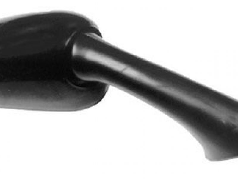

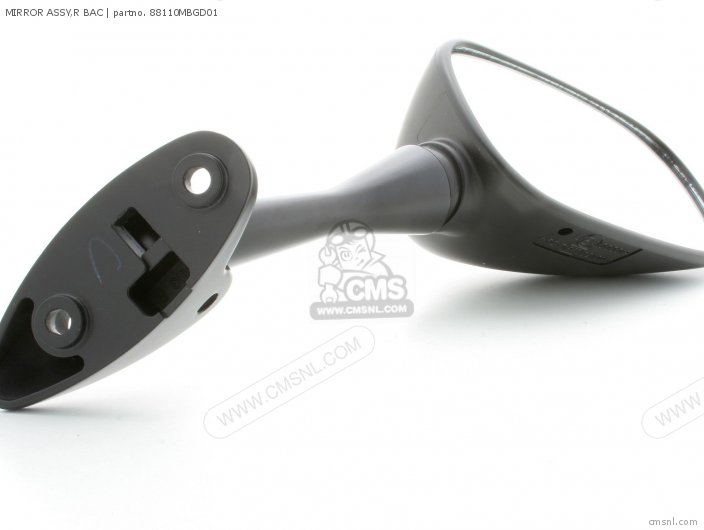

Here's pictures of the mirrors of the 99 compared to the skinnier 00 model.
1999 Part Number R/H = 88110-MV9-003ZA
2000 Part Number R/H = 88110-MBG-D01

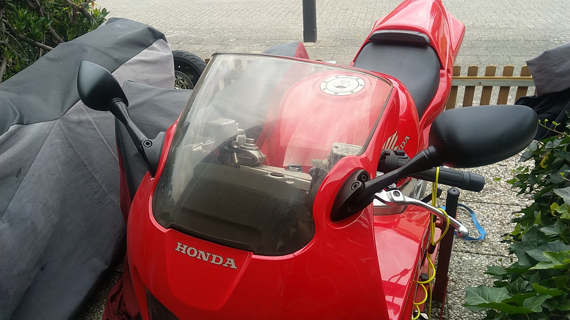

Unless you specifically like the condom mirrors or you are keeping it completely original I would say just replace both mirrors with the EMGO 00-01 mirrors. You get to dump the tired, shrunken (at least mine were) rubber condom OE mirrors and the bonus is that the replacements have stalks that are a little longer than yours so you'll gain a little rearward visibility and see less of your shoulders. It was win/win for, not to mention cheap
I would prefer the no condom look. As long as the mounting holes/system is the same, I will go with EMGO.

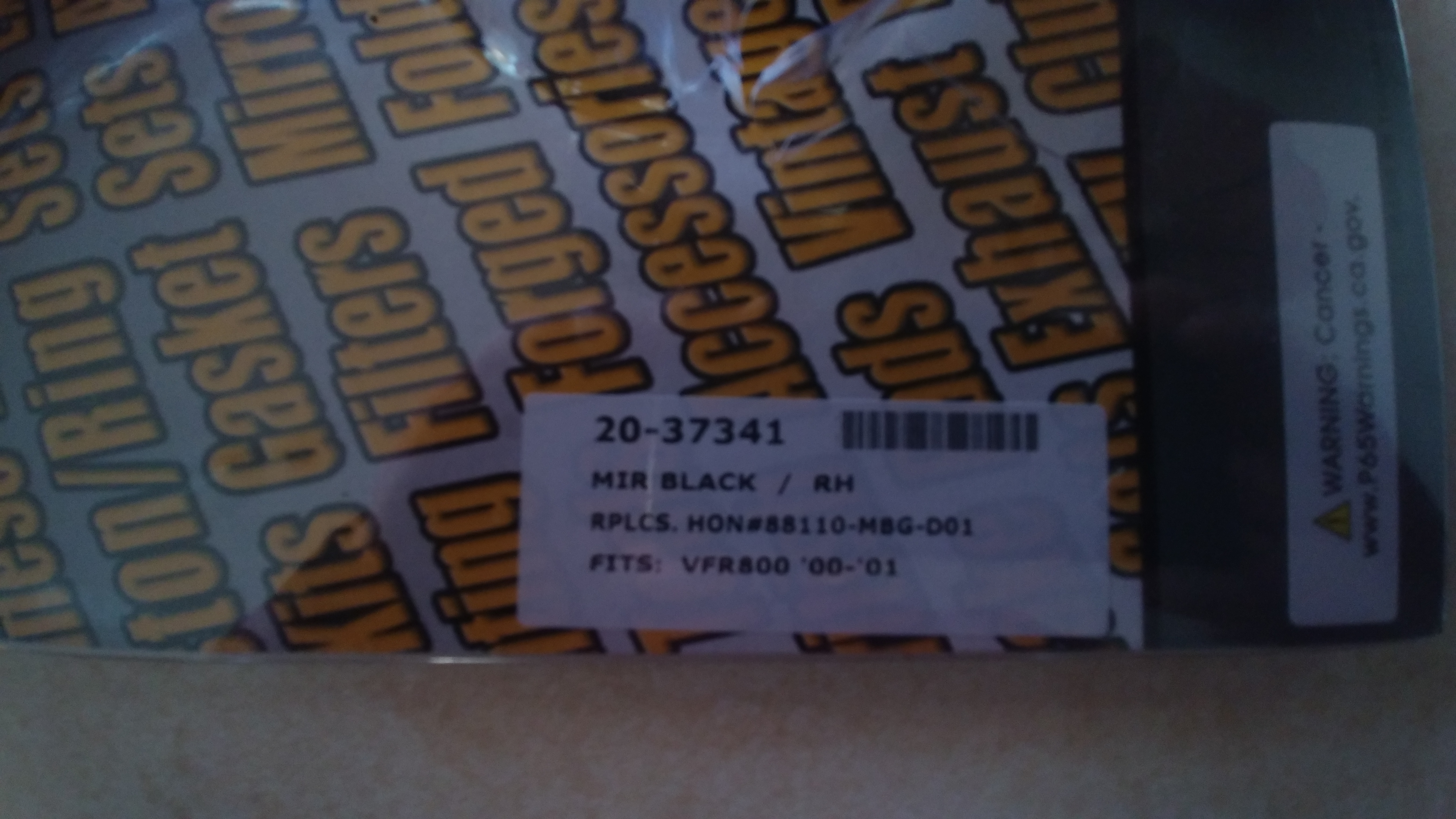

The ones I see on line here (Canada) are part number 20-37341 and 20-37342. Not 00-01 like you mention adkfinn.

Not sure if it was a misprint or what by the Canadian supplier, but the part # given matches with a 00-01 VFR, adkfinn was right.
The pic is of my replacement mirror from Emgo.
Yes you can make your own, a bit of  truck inner tube, razor knife and a hole punch and 10 minutes will give you pretty much an oem gasket.
The part number shown in your photo is the same part number I mentioned earlier.
I misunderstood adkfinn when he wrote EMGO 00-01. I thought he was referring to a part number. It was the EMGO mirror(s) for the 00-01 VFR he meant, which are indeed part numbers 20-37341 and 20-37342.

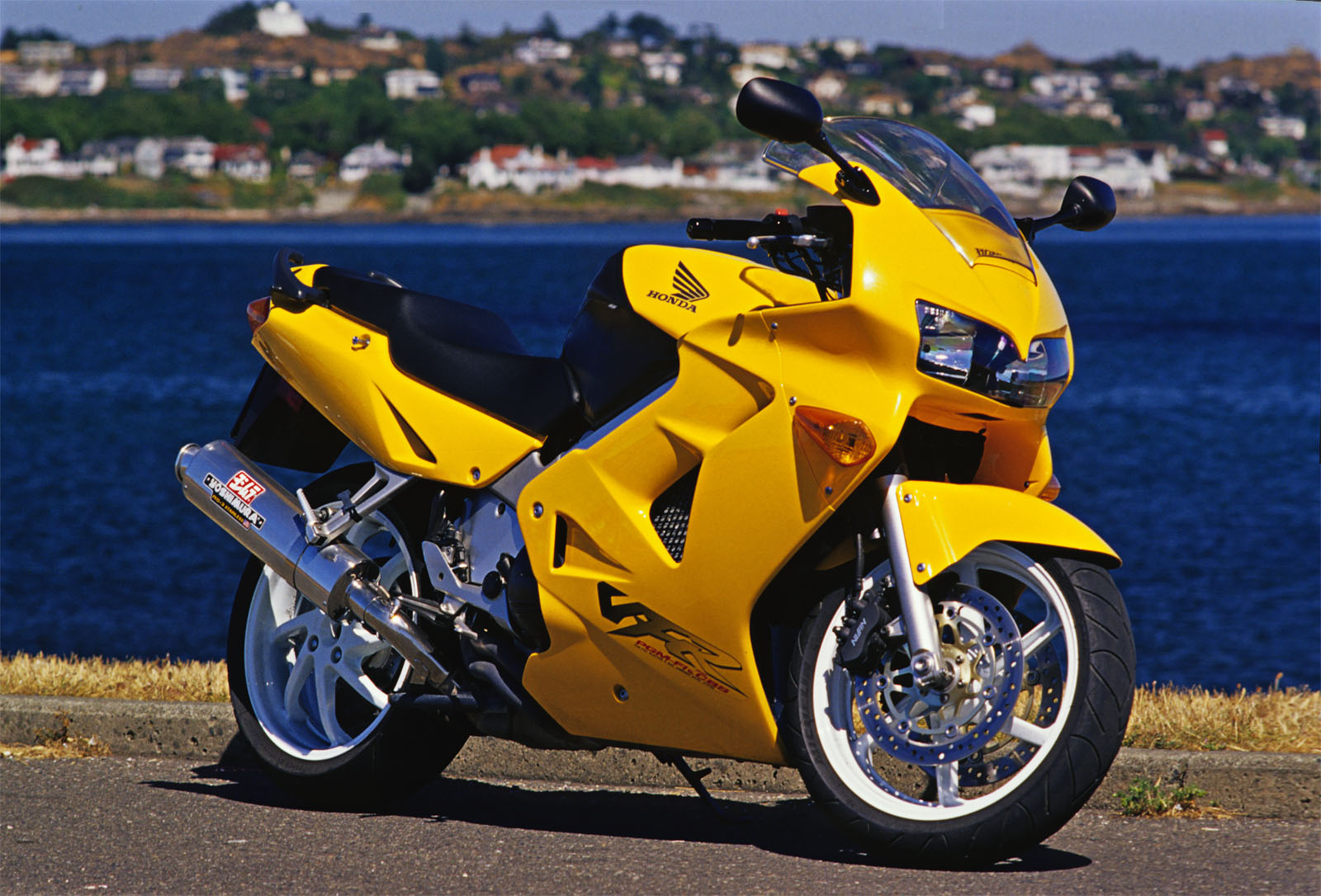

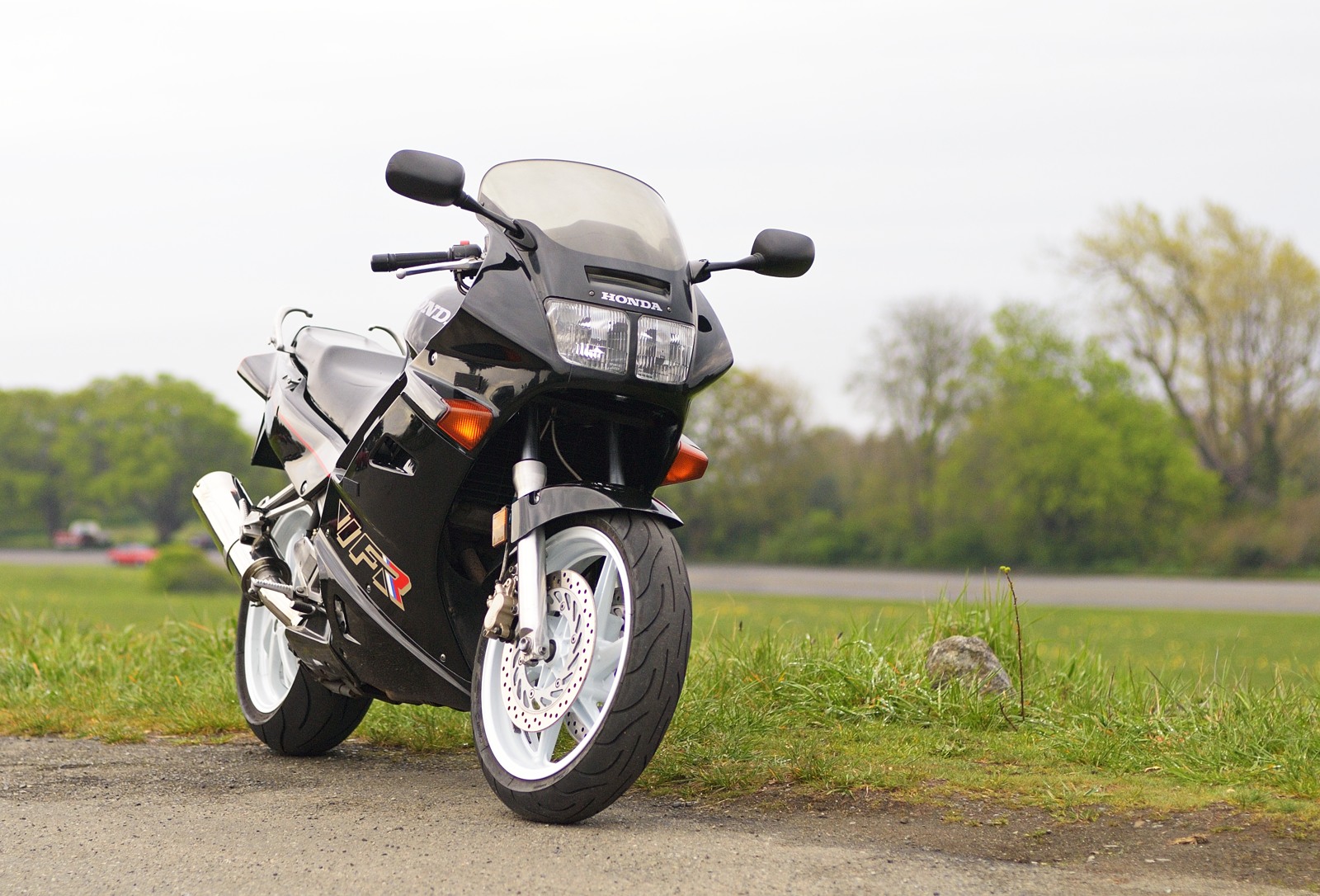

Yep, I put a set on my yellow '99 VFR800, and a few years later put that same set on a '92 VFR750 that I'd picked up. Sadly both bikes are lost, like tears in the rain.
Anyhow here are pics of them on my bikes.
They look far better without the condom. My current mirrors are on extender blocks and frankly I never liked the look of the condom/extender block look. I'll have to get some OEM size mounting bolts as well.
