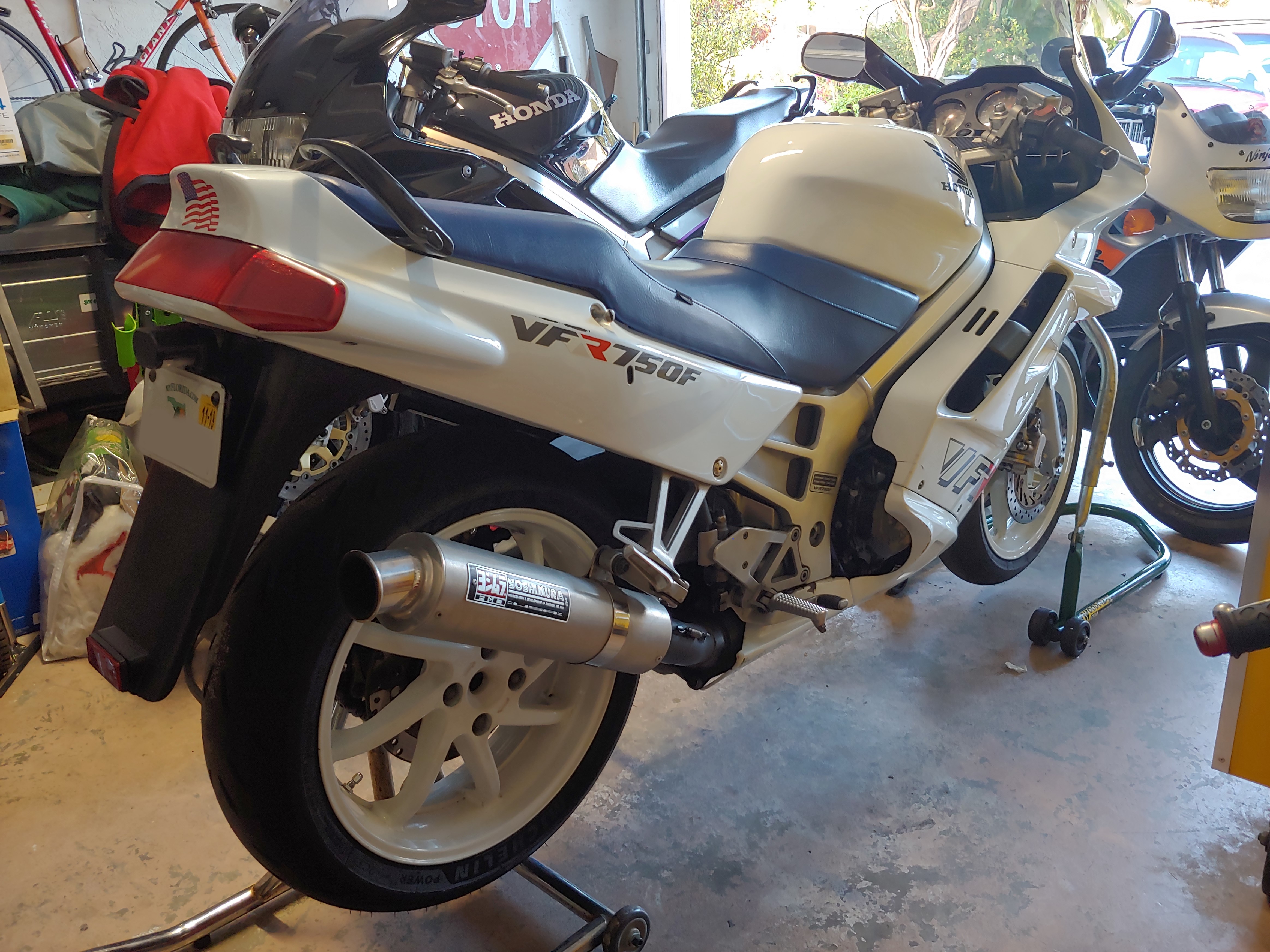

Rescuing a '91 VFR750F

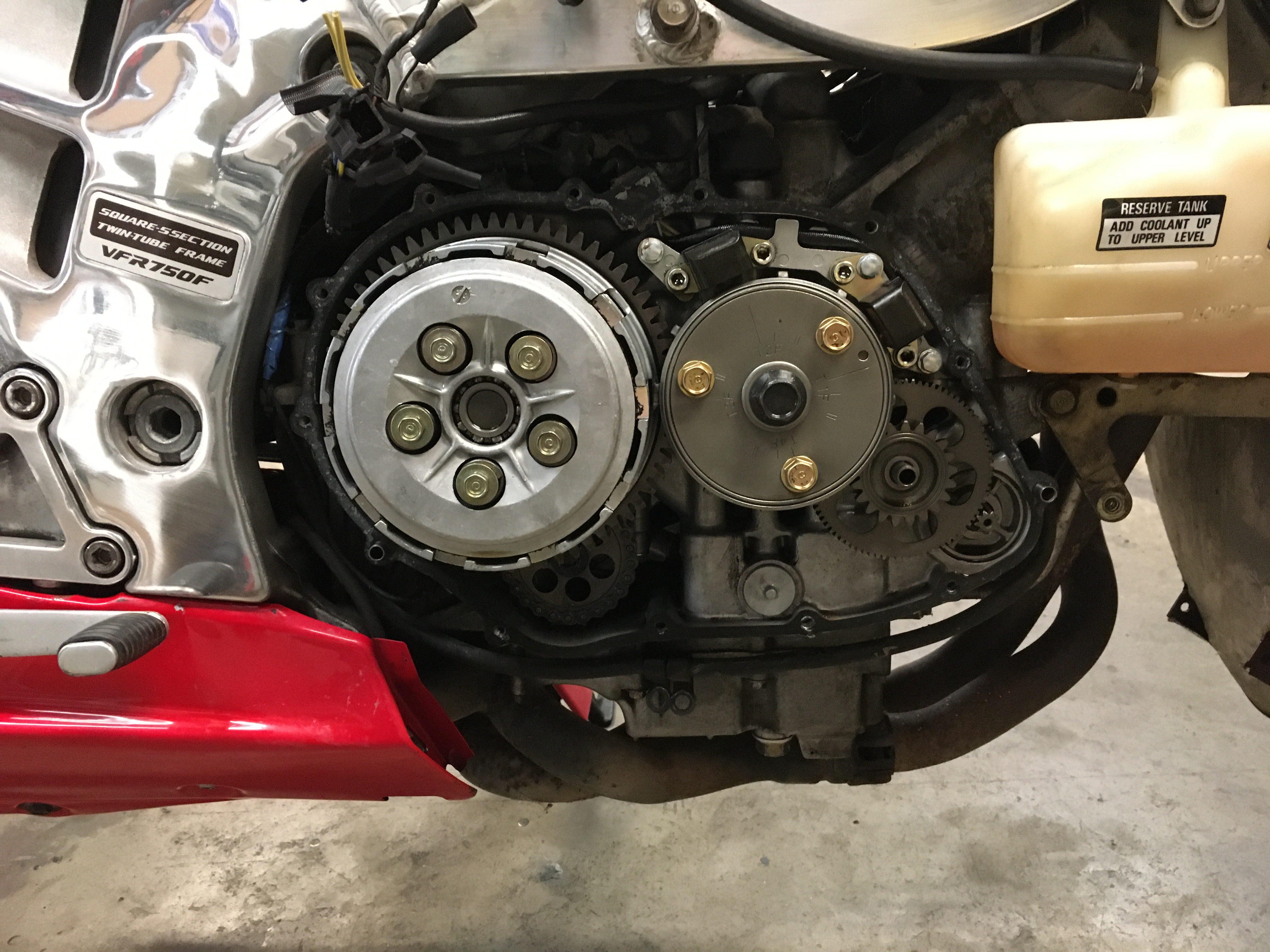

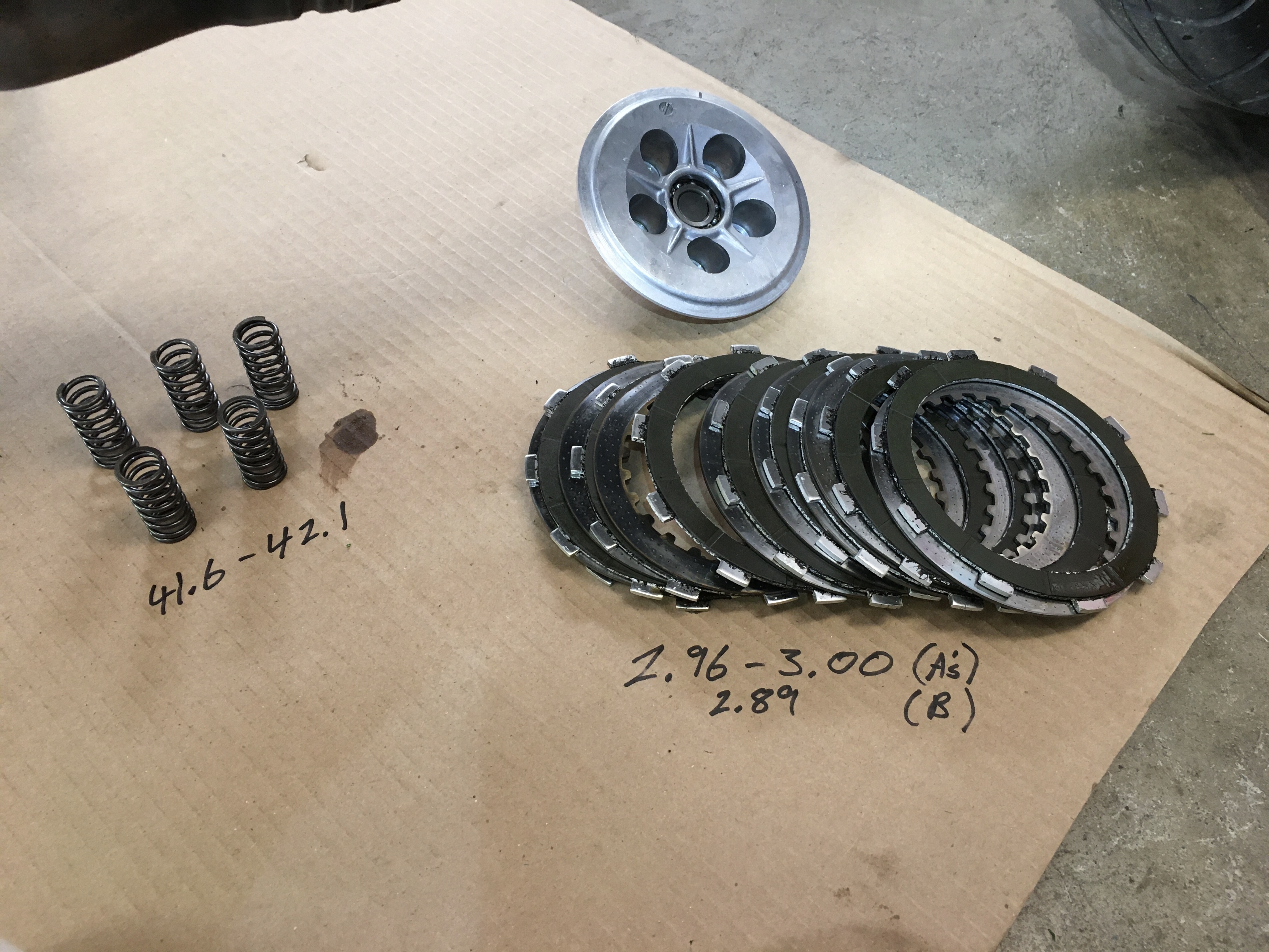

Removed right side case cover and inspected clutch.....and the gasket did not tear!  Stayed 100% stuck to the engine side so I am expecting I won't need a new gasket.
Anyway, on some of my other bikes (can't remember which), you measure the complete stack of fiber and metal disks to determine wear.  On the VFR you just measure the individual fibers.  All were in spec, as were the springs.

If you havent put the clutch back together yet, I recommend getting some EBC clutch springs.  Even though yours measure in spec, the EBC are slightly stiffer and will improve feel and extend the life of the clutch.  They are like 10 bucks and with the hydraulic clutch the pull isnt really affected.
Link to comment
Share on other sites
Good idea.
Luckily the side case cover comes right back off easily and since the gasket is intact I could certainly do that!  Interestingly, I mentioned I found some maintenance records and on 2/12/95, at only 4 years old and with 16k miles, it says the clutch springs were replaced. Hmmm, this is the same time period when the Brembo brakes were installed and the Yoshimura exhaust can was added.  I would bet that when the clutch springs were replaced that it was done with Barnett or other aftermarket spring.  Still we are talking about 25 year old springs and I'm not saying they couldn't use replacement.  Bike has 35k miles on it now.
Link to comment
1 hour ago, mtnpat said:
Good idea.
The EBC kit comes with 6 springs (multiple fitments) and I have replaced 3 of 4 of my VFRs, a friend's, and one spare engine (that got installed on a frame swap).  I got the "Buy 5, Get One Free" deal.

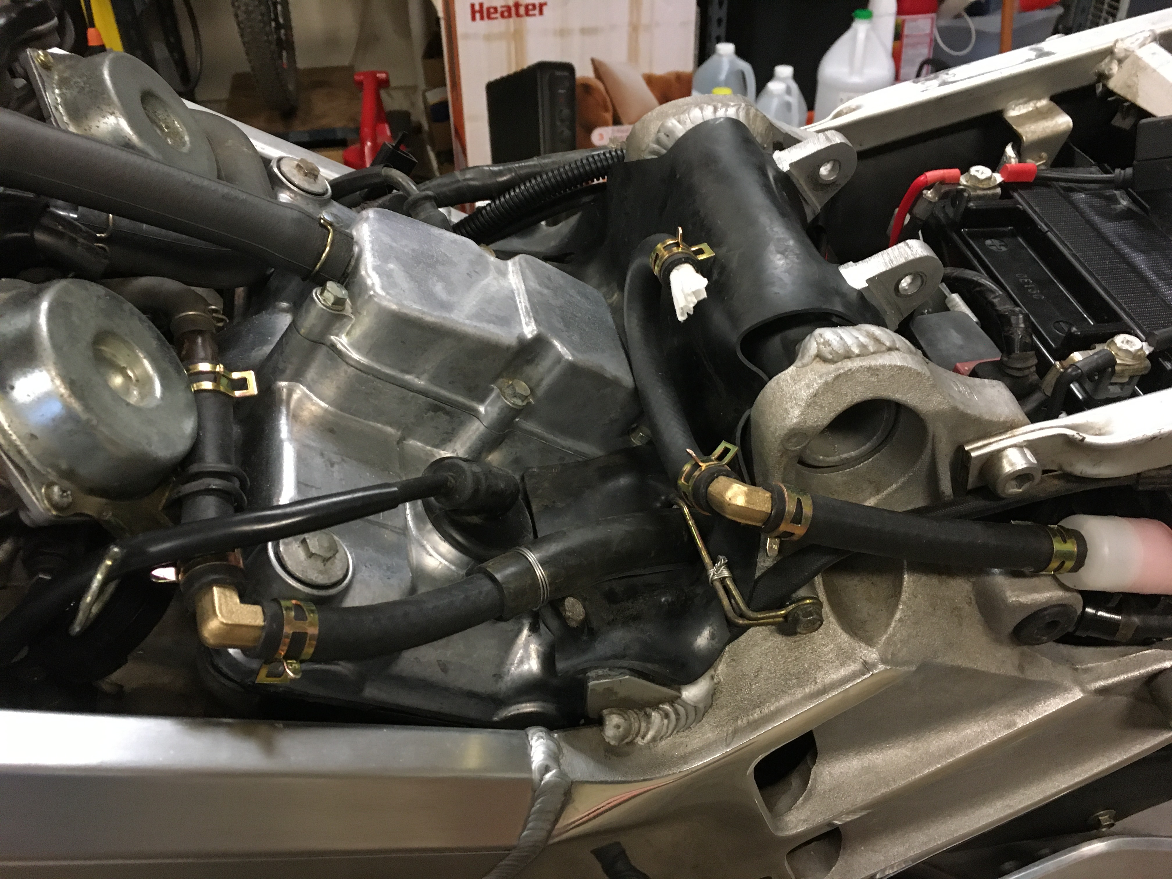

On 12/6/2020 at 9:25 PM, ridervfr said:

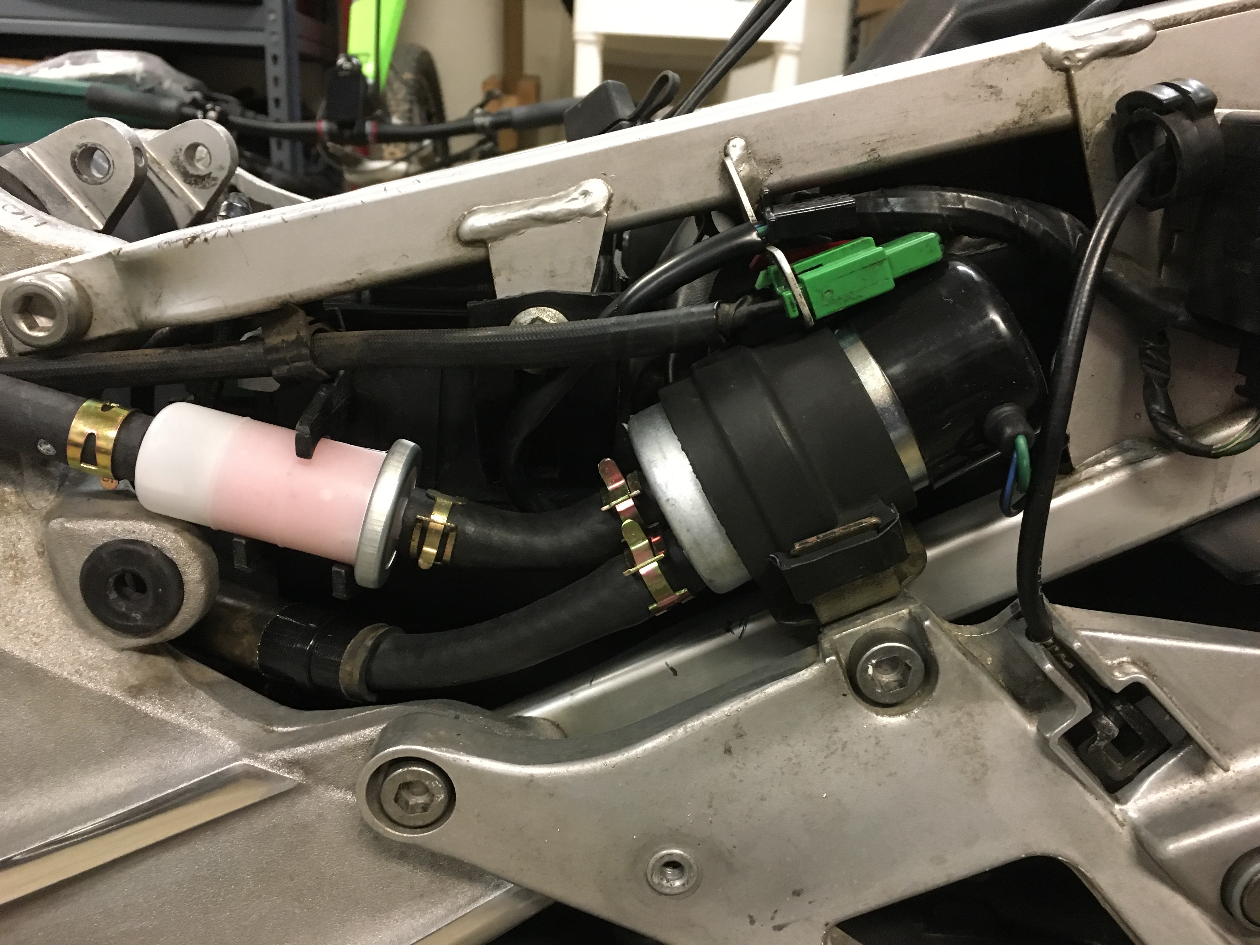

I like what you did with the fuel lines and how you repaired the tatty carburetor plastic tray. I was able to get OEM replacement fuel lines when I needed them and ended up getting Samco radiator hoses from the UK for both of my bikes.
I ended up having to remove the inline petcock I was planning to use, because, of course I didn't check to see if the rear cowling and seat would fit with it at that location.  It doesn't.  I did however get the OEM style clamps installed everywhere though.  I need to get a petcock that bolts right to the tank, either OEM or a Pingel with adapter.  The one I have now was missing parts and not rebuildable.   For now while just getting the bike going, I will just use what I have and be careful when I take the tank off and on and it has gas in it.
I also installed a new fuel pump because the one that was on the bike was looking pretty corroded.  While you can buy fuel pumps for this bike for $25-40, I decided to go with the one sold by K&L because it is made in Japan the same as the OEM was and I'm feeling the build quality will be just a bit better, it costs quite a bit more than $40 but less than an original if you can find one.  The K&L has the same exact Mitsubishi symbol on the bottom as the pump I took off, I can't say for sure if it was the one that came on the bike from Honda or not but there was nothing in the maintenance records about it being replaced.

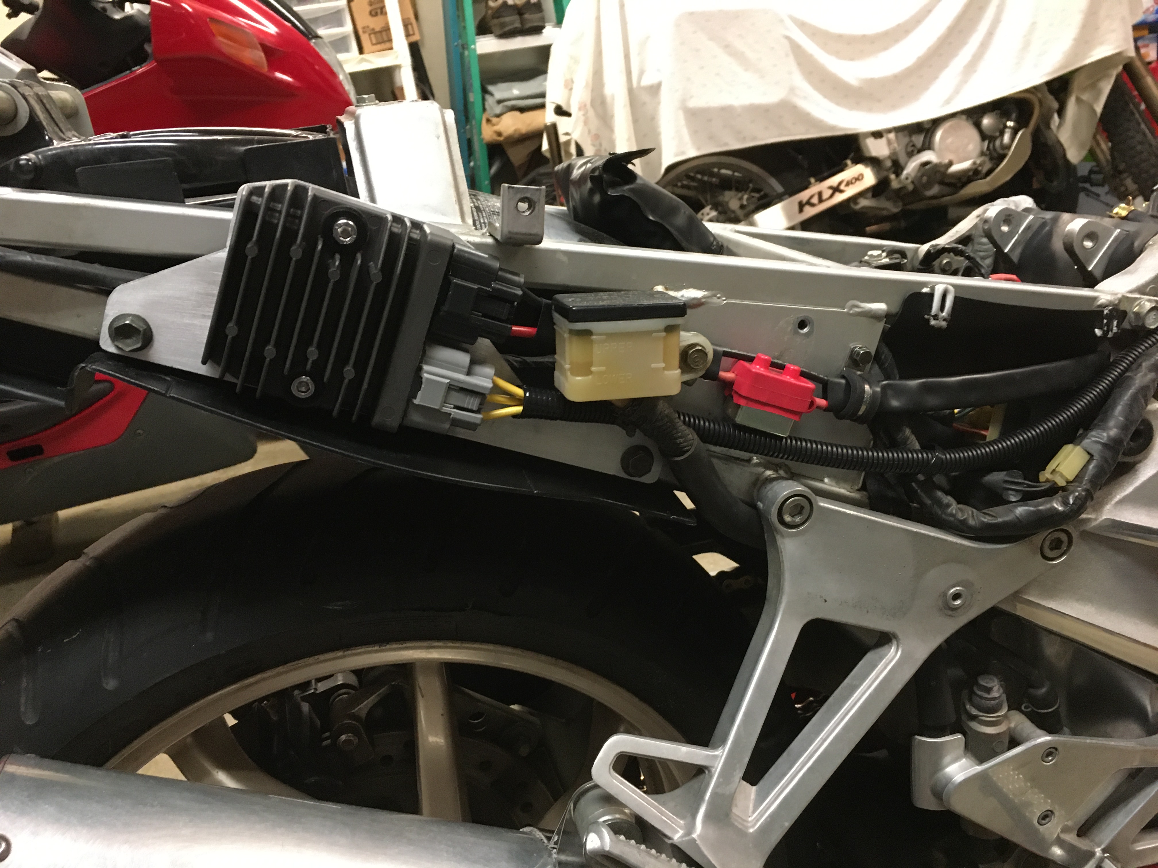

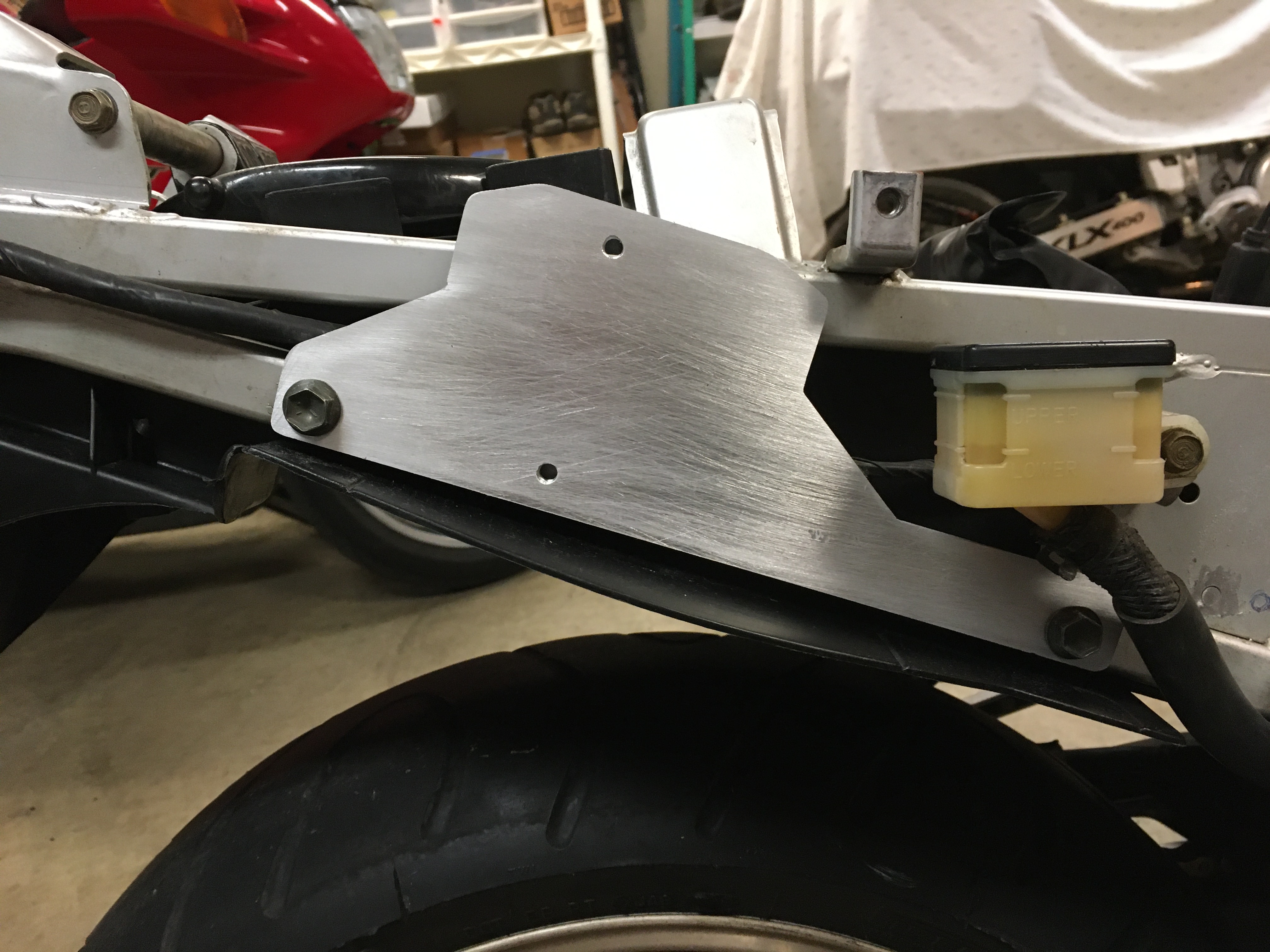

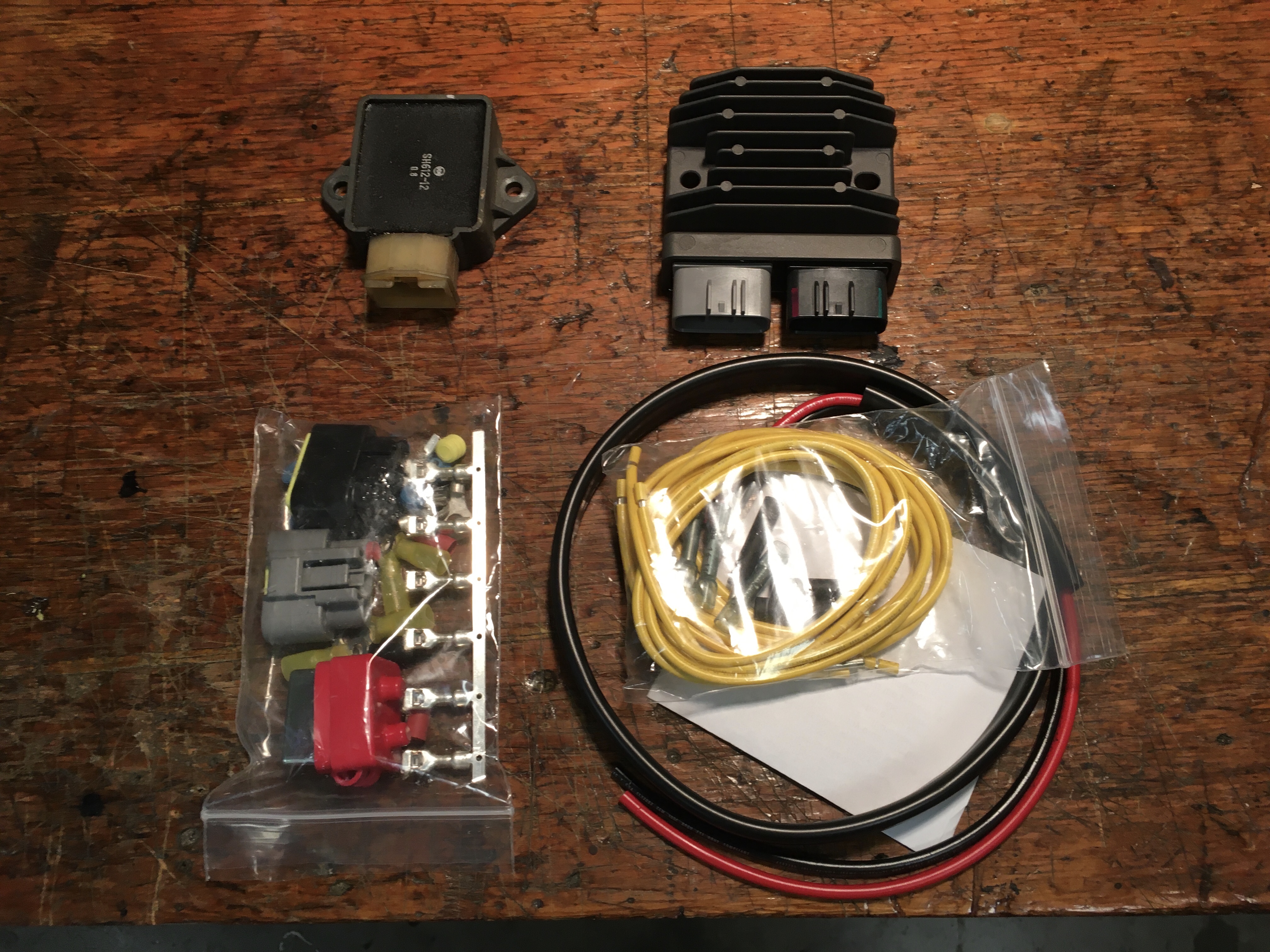

I recently bought a new voltage regulator/rectifier and installed it.  I went with a genuine FH020AA from Roadstercycle.  When I got the bike it was not charging the battery at all, nothing.  It was also ooozing a bit of its insides, outside from probably overheating.  It was the original style regulator/rectifier.  While you can buy inexpensive (read as cheap) R/Rs, from what I have seen in the reviews they are a waste of money.  I went with a product that is known to be excellent quality with quick and easy customer service.

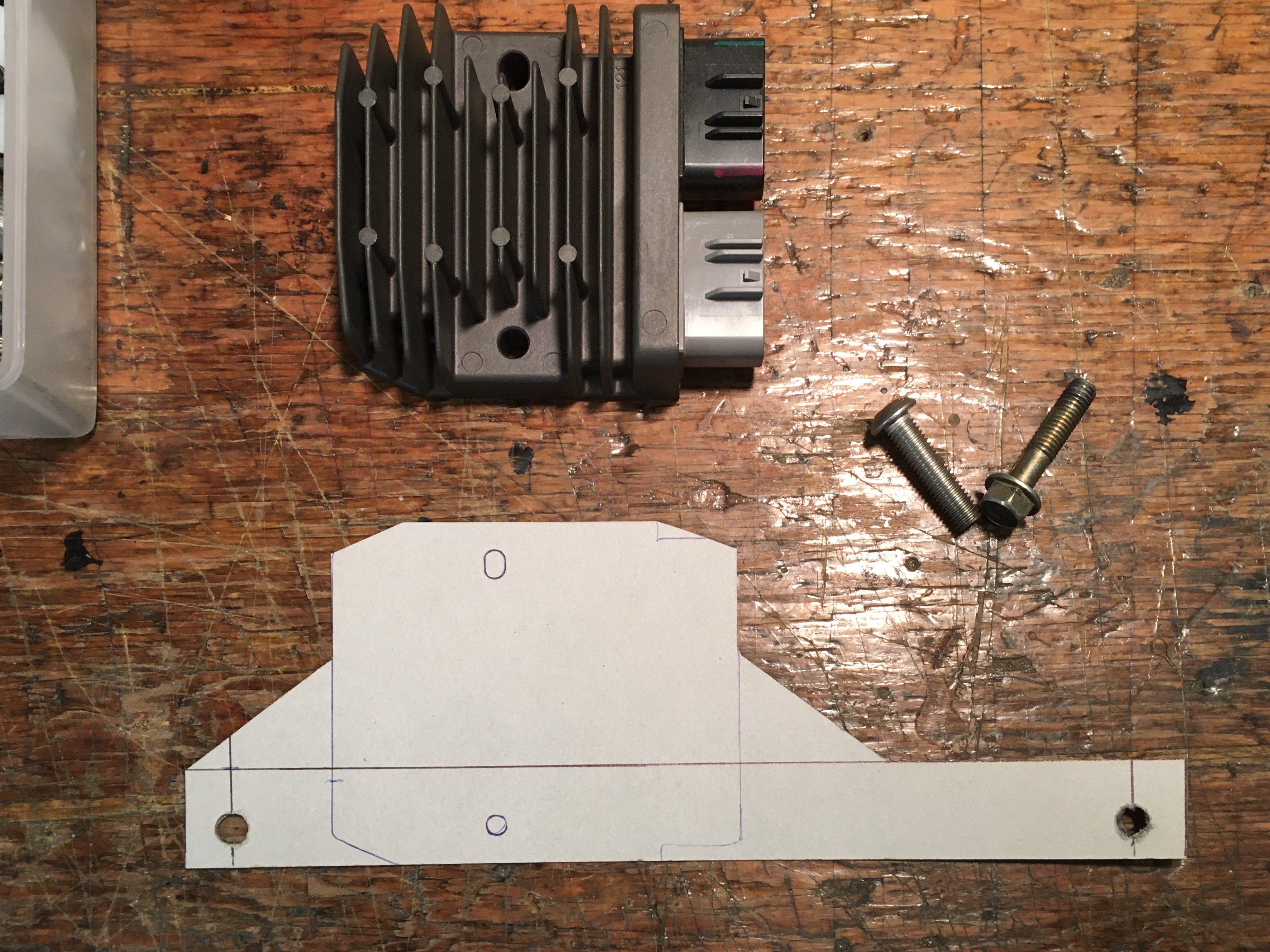

Copying what Hingley did (March 2019 post on this forum), I chose to not mount my new Shindengen R/R at the stock location, instead I made a bracket and placed it behind the rear brake fluid reservoir.  Great idea Hingley!
The FH020AA is quite a bit larger that the stock style R/R and while you can fit it at the stock location it is a tight fit and rubs the body work.  I tried it several ways and did not like it, in the end decided to move it back where there is a ton of room.  I mean it is a cavernous space comparatively.  Mounting further back mirrors the location of the ECU on the other side.
I cut a bracket out of 1/4" aluminum and while it is overkill for holding this electronic part in place I wanted it so that I had adequate thickness for tapping M6 size holes to mount the R/R.  The bracket itself bolts into the 2 existing M8 size holes already tapped in the subframe.  I have not fired the bike yet to see the voltage being supplied yet.  I did test the stator before replacing the R/R and it is believed to be good.  Will report back when I do.

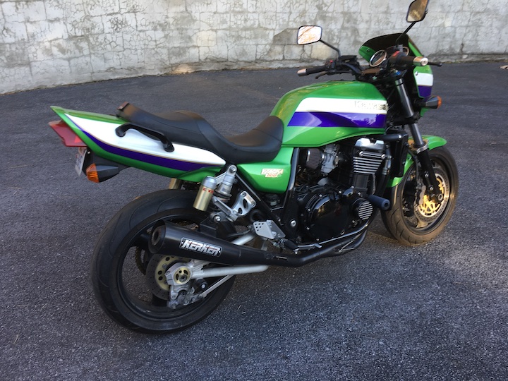

Went for a ride Friday!
No, not on the VFR, not yet.  Instead took out the Kawasaki for the last ride of the year before topping off the gas tank and covering her up for the Winter.  I was riding through a local small town, in a 25 MPH zone just crossed some railroad tracks, looking around I see a family sitting on the front porch of their house, maybe a grandmother and a couple of small boys.  One of the boys gives me the "twist the throttle" gesture so I pulled in the clutch and gave them a blast with the Kerker, he seemed to appreciate it!  Obviously a motorcycle fan. 👍
This is one of my favorite bikes ever, some day I would like to have one.
Are you sure the RR will not be in contact with the tail fairing? At least, this sounds more elegant than my own version ;-)
