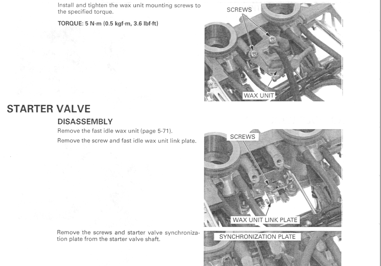

GreginDenver Posted September 13, 2019 Posted September 13, 2019 6 hours ago, Terry said: Actually Greg you are probably correct but the manual is not that easy to figure. Looks like the WU connects and pulls the SV open for cold, then releases them for hot, so shorter cold/longer hot seems more likely from closer inspection. The key in any case is to check whether the SV's are being lifted when cold and set down when hot, which is easy enough to visually spot. Here's a short video somebody made explaining the wax unit on a 6th Gen VFR: https://www.youtube.com/watch?v=k4oVVbzTvVo Quote

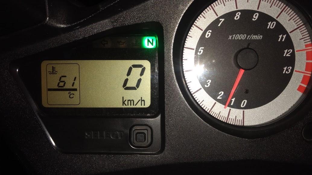

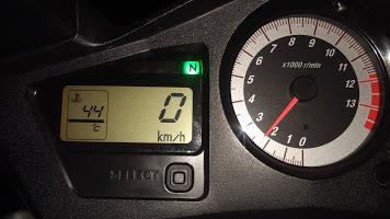

Member Contributer TriumphTraitor Posted November 1, 2019 Member Contributer Posted November 1, 2019 Just in case anyone was curious.... this is how a cold bike sitting for 3 weeks starts with a semi dead battery at 1 degree Celsius (34F) with the fast idle was nut adjusted to 3 turns. It will rev up to 2000 rpm until the cold oil gets flowing then up to 2300 rpm until a coolant temperature of about 44C (111F) where it slowly comes down until the temp reaches 60C (140F) where the rpms will go back to the normal 1200 rpm idle. And, yes, even before the swap it was this slow to start in the cold especially after sitting so long. I should also mention, the idle when cold used to be around 800-900 rpm VID_20191101_171655712.mp4 1 Quote
