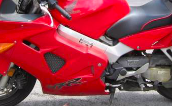

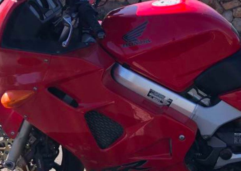

EazyRider Posted August 31, 2019 Posted August 31, 2019 I noticed this odd thing in a picture of the local VFR I'm considering. I haven't seen it in person yet, waiting to get the money together before i inspect and test ride. But this VIN sticker is bothering me. At first, I thought maybe someone tried to peel it off and part of it tore, but then I noticed the location looks off. Every other picture I can find of this sticker shows it positioned a little below this one. Makes me wonder. Is there a VIN tag anywhere else on the frame, like near the headstock tube ? Quote

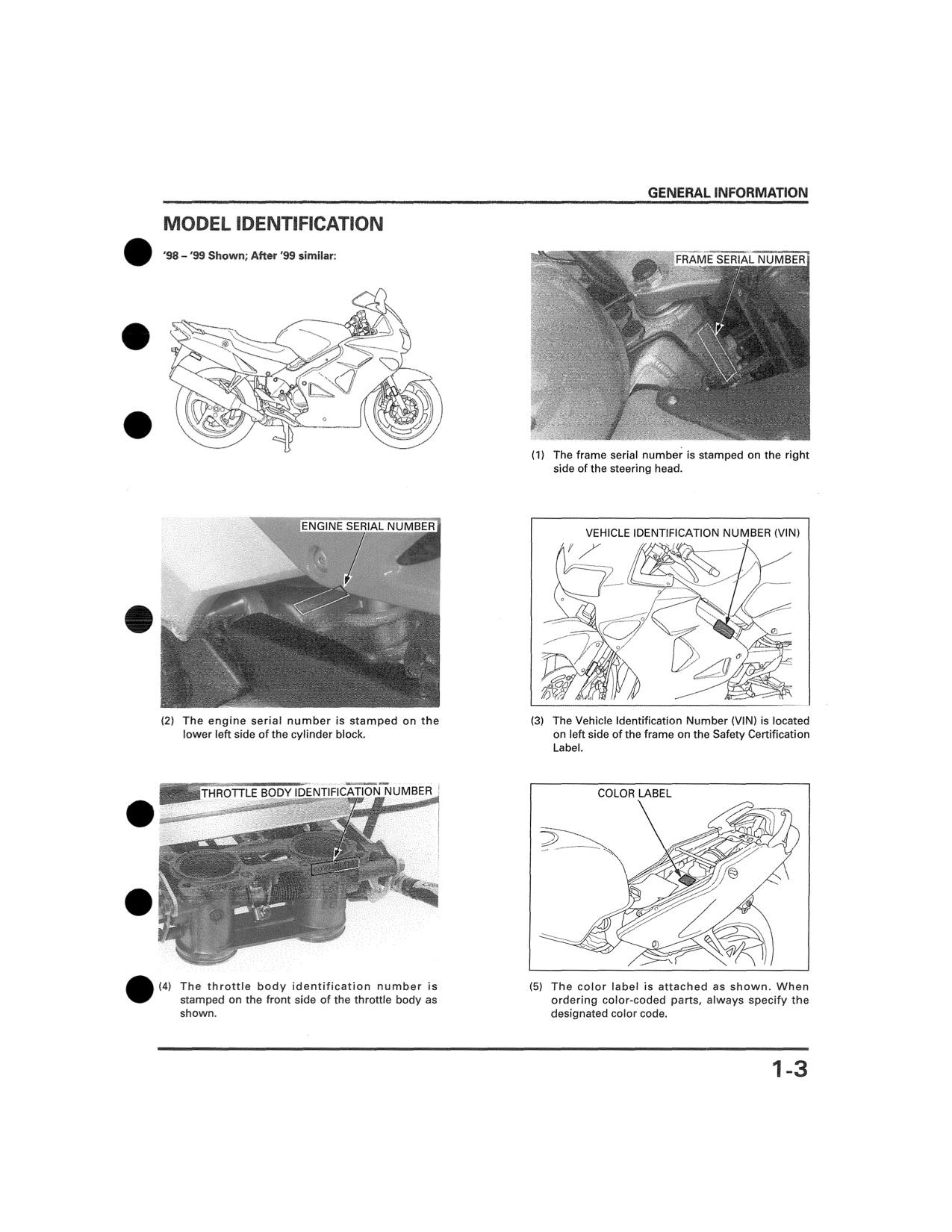

Member Contributer Lorne Posted August 31, 2019 Member Contributer Posted August 31, 2019 1 hour ago, EazyRider said: Is there a VIN tag anywhere else on the frame, like near the headstock tube ? No VIN tag, but the s/n is stamped onto the headstock and on rear of the engine just ahead of the shock. The 1998-2001 service manual shows this Page 1-3, and much more useful information as well. Peruse the Downloads section of this very forum and you will find a pdf version freely available. In the meantime: Quote
Member Contributer JZH Posted August 31, 2019 Member Contributer Posted August 31, 2019 It does seem a bit high. My US-spec bike has it lower, too. Ciao, JZH Quote

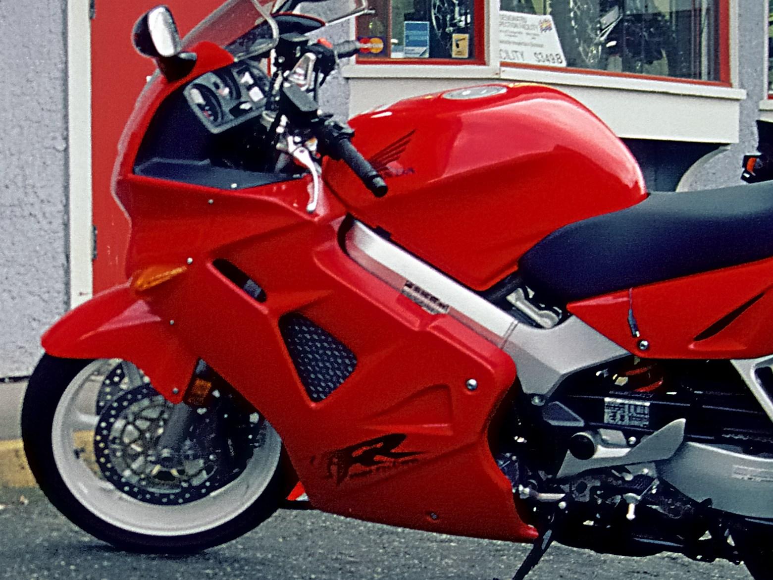

Member Contributer Lorne Posted September 1, 2019 Member Contributer Posted September 1, 2019 Fwiw, here's how the VIN tag was positioned on my '98 VFR800 (Canadian model) when brand new. What's important is whether the frame & engine number match, and match the number on the tag. Quote
EazyRider Posted September 1, 2019 Author Posted September 1, 2019 Thanks for all the very useful replies. I will check the frame and engine numbers. My concern is the frame was swapped at some point and the sticker reapplied from the original. Lorne, your photo lines up with all the others I've seen on the internet. The top of that sticker is always lined up with the "crease" in the frame. The one in the picture I posted looks fishy. Quote
Member Contributer Dutchy Posted September 1, 2019 Member Contributer Posted September 1, 2019 I would walk away from this specimen.. Plenty VFRs out there. Quote
Member Contributer Marvelicious Posted September 1, 2019 Member Contributer Posted September 1, 2019 Drop it like it's hot... 'cause it probably is! Quote

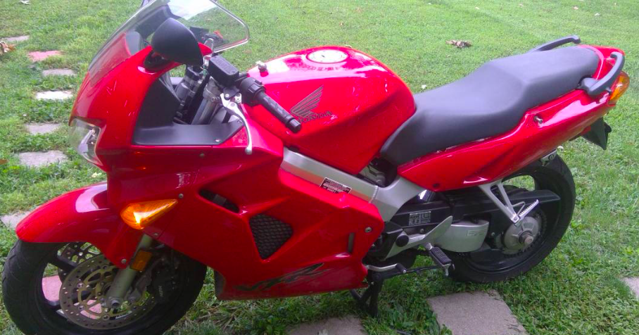

EazyRider Posted September 1, 2019 Author Posted September 1, 2019 After searching craigslist for an hour, I managed to find another 2001 in a different state (VA) that has the sticker in the "high position". I wonder if it's a production variance ? I haven't seen this with any other year. And I've found other 2001's that look just like Lorne's '98. Very strange. Also during my search effort, I found a 2001 with only 14k miles for about the same price as the local bike with 40k miles and dodgy sticker. It looks really mint, but not a lot of upgrades besides a slip on pipe. Only catch is it's about 1500 miles away. Decisions decisions... Quote

Member Contributer KevCarver Posted September 1, 2019 Member Contributer Posted September 1, 2019 Looks like the way my ‘99 came. Small crash pushed the edge of the fairing into the sticker and tore it a little. Eventually I peeled it off and it’s on my toolbox. Quote
