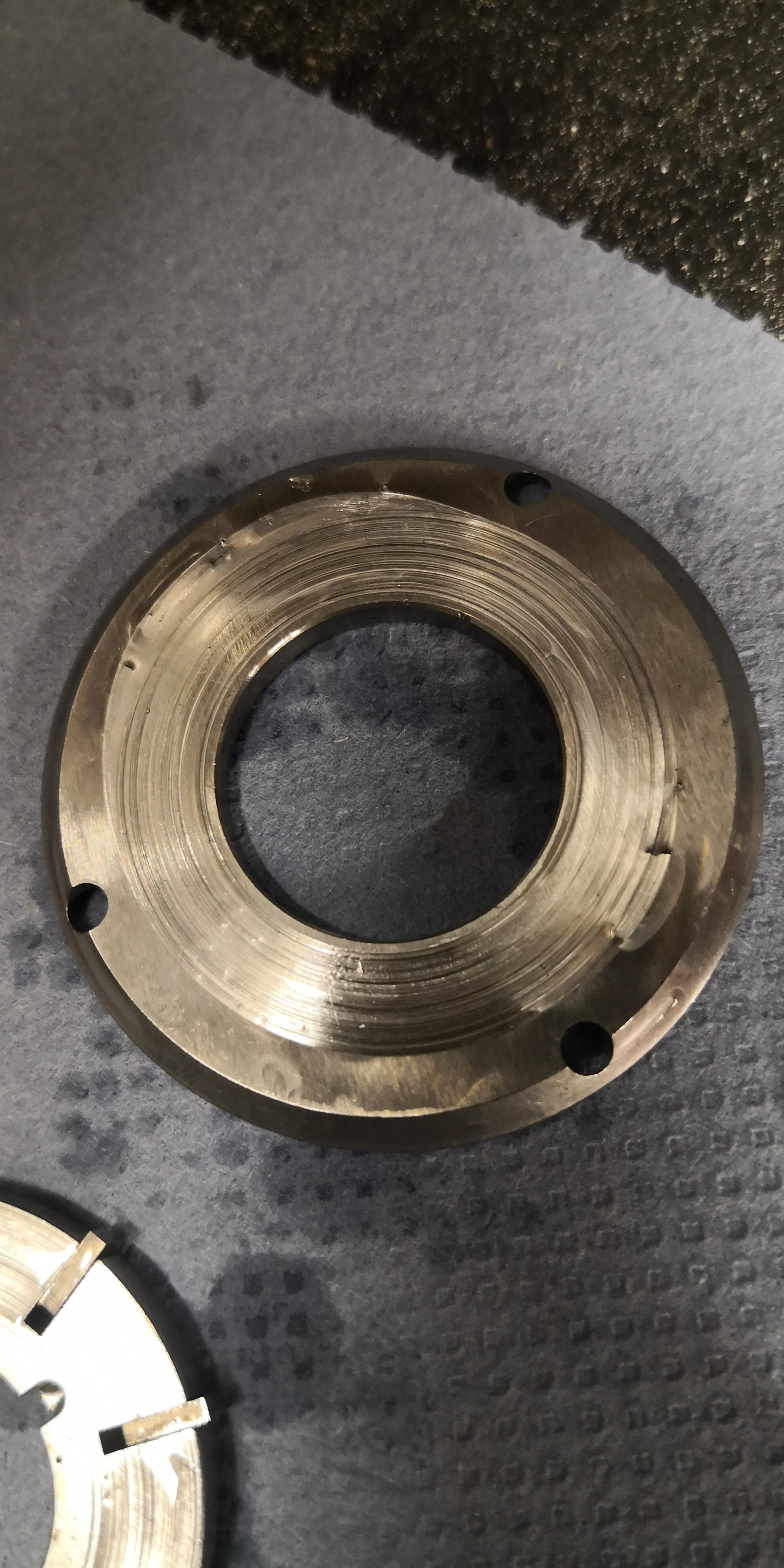

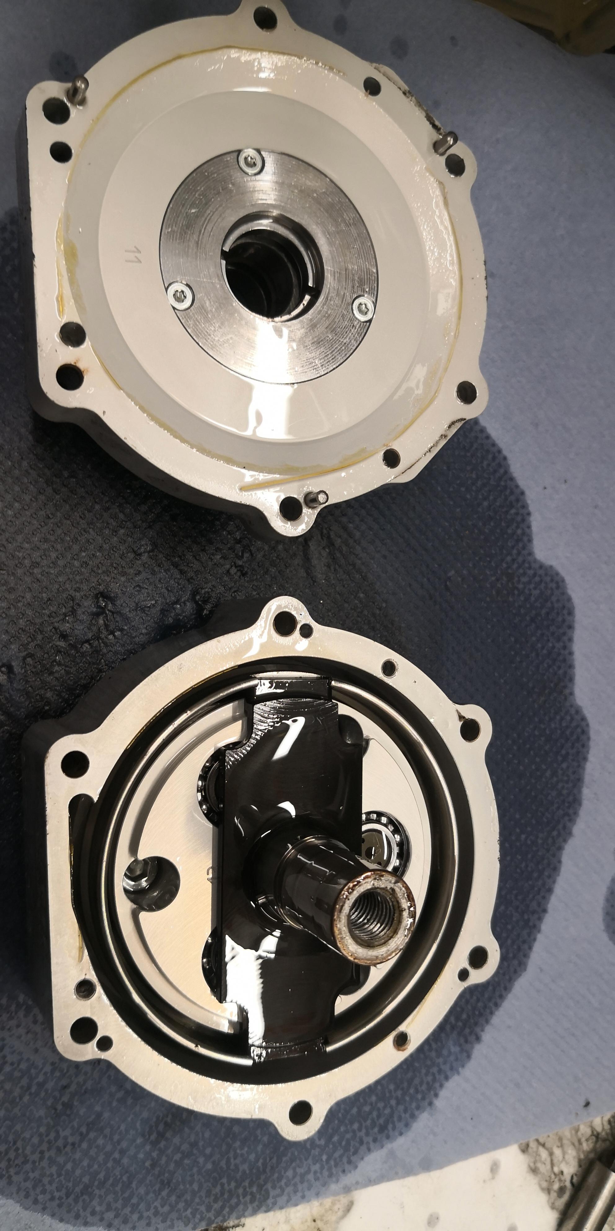

Today I had the time to sneak the vfr past all my projects and in to the shop.
It's a wierd feeling because I am super excited to find the cause of the loudest supercharger i ever heard - and I've been at top-fuel dragster shows many times!
I have this diseases that finds pleasure in mechanical faults, even on my own stuff... It's a great feeling to finally tear a rotrex down as i e been itching to se how it's made.
Time to spend mad amounts of USD, again...

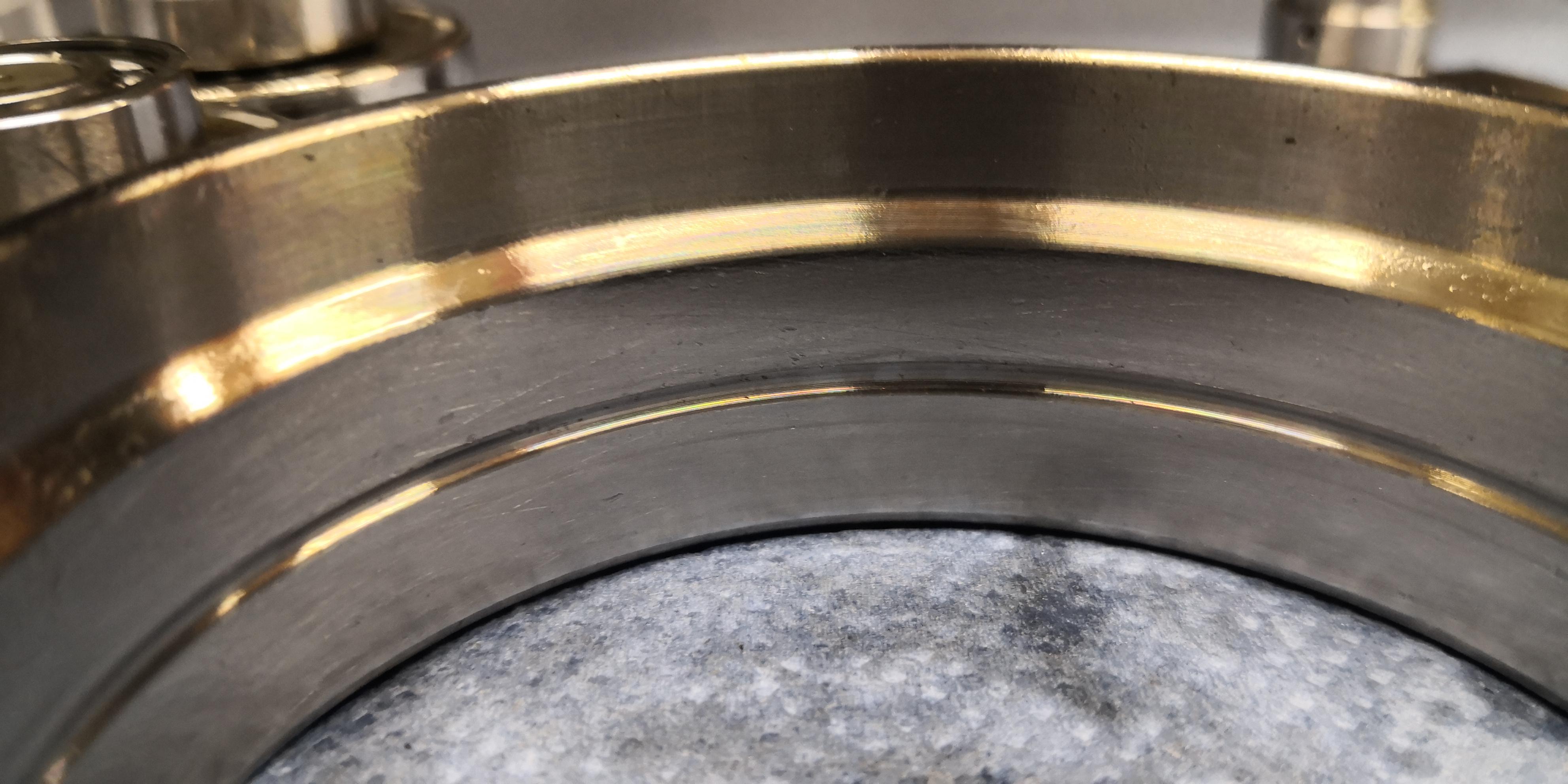

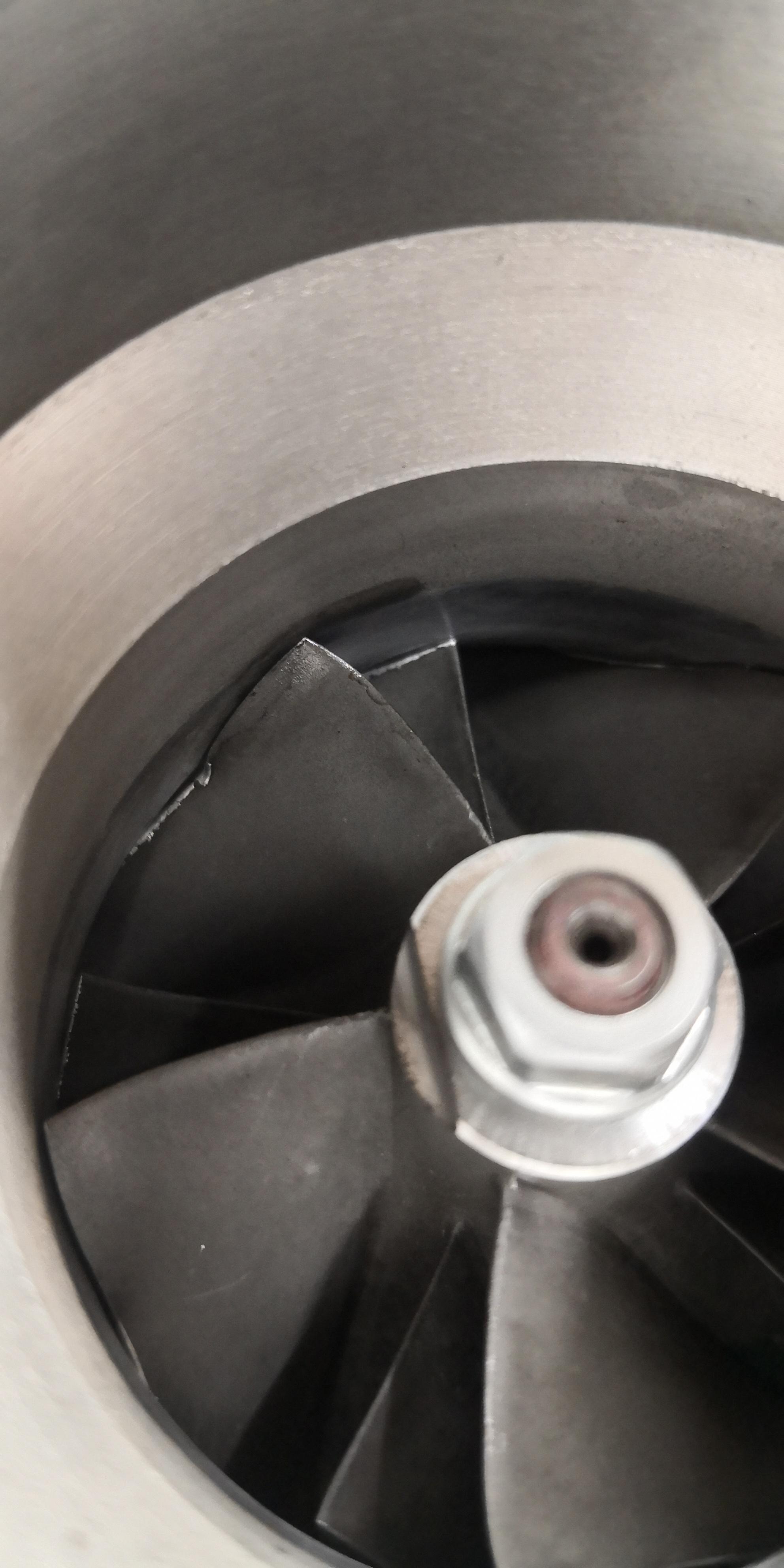

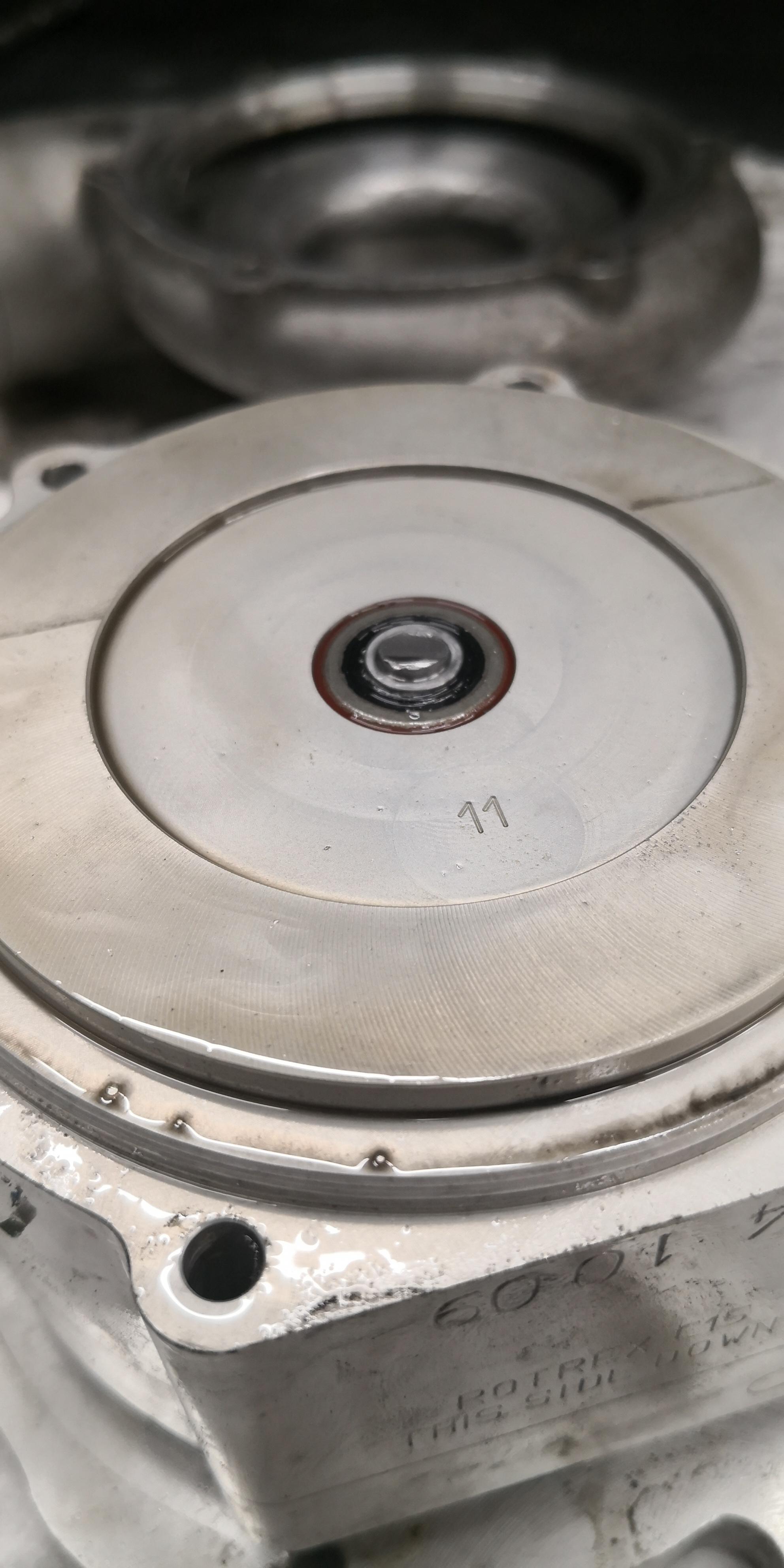

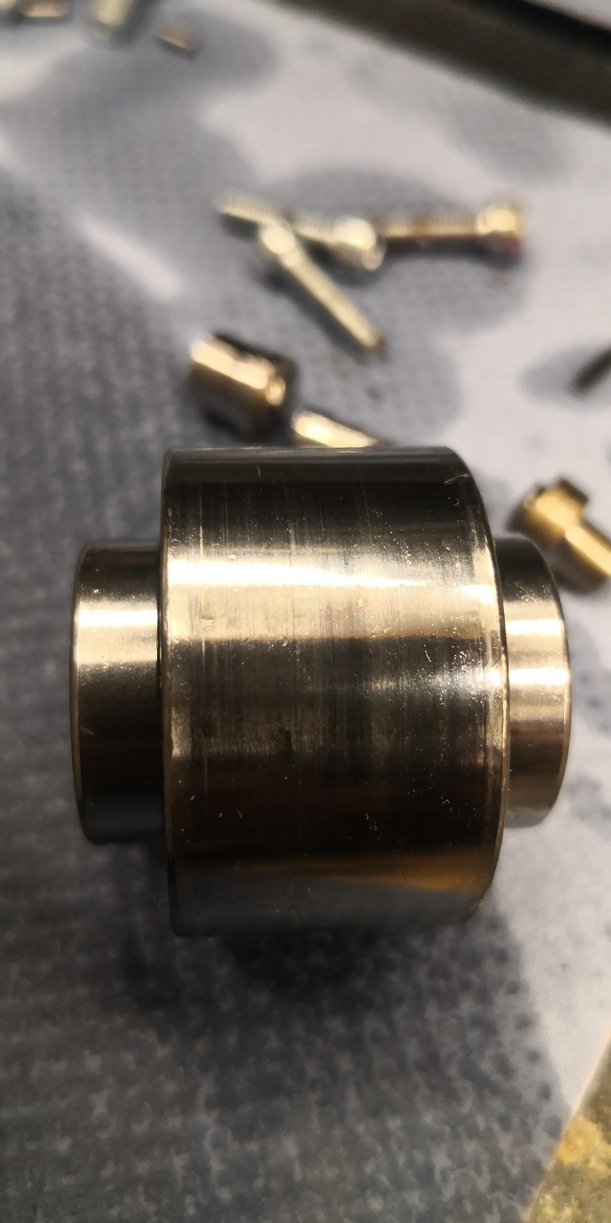

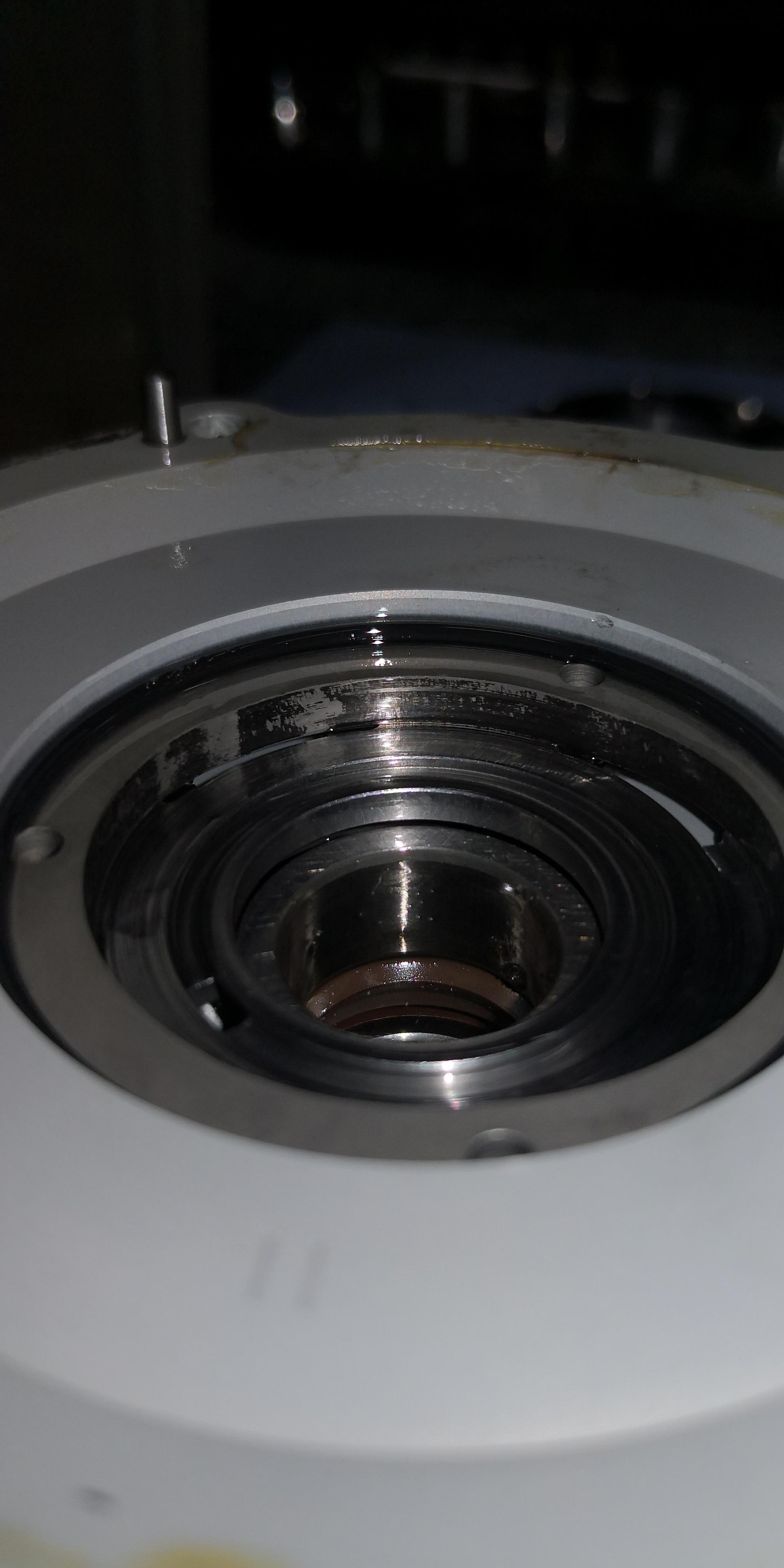

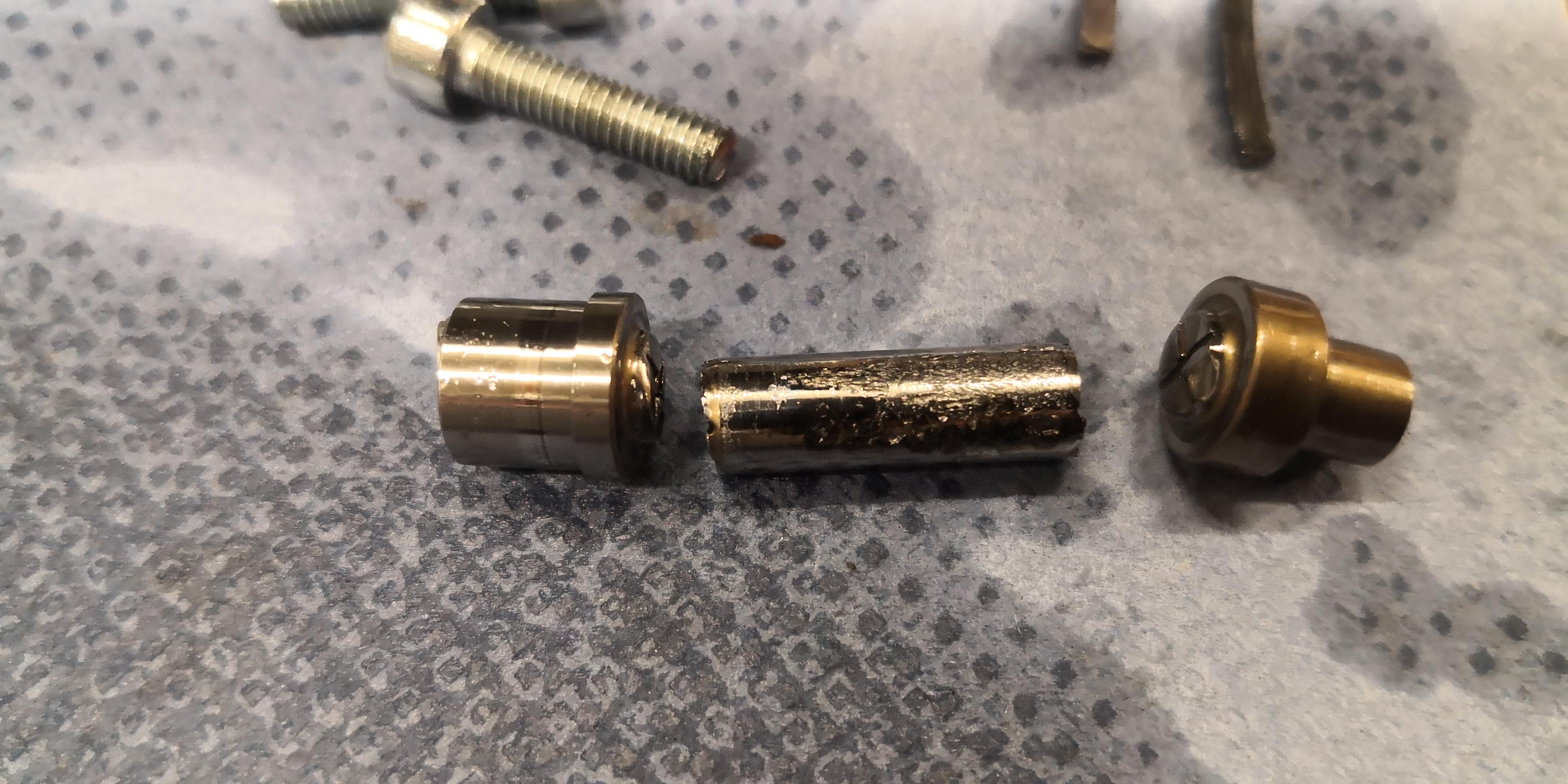

I'm ashamed! She does not look pretty without her clothes!
Let's see what we can do about this...
I've made some research and tried to analyze the charger failure.
There might be some very interesting information coming up for us rotrex guys as a result of this blown piece of danish technology.
What do you have cooking? I'm interested to hear your findings.
I am aware that the newer iteration of the C15 does not use a shaft oil seal, and so all the oil needs to be located below the centerline of the shaft. I've taken that into account with my current installation. I've also added an oil cooler for the Rotrex oil.
