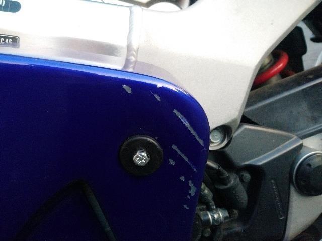

Ragaroah Posted January 8, 2019 Posted January 8, 2019 Hey all! New (Dutch) VFR 800 Fi '99 owner here! Bought mine in December from someone, and already put about 400km on it during the cold month. Now I'm looking for some stuff though, and I'm hoping someone can help me... Seeing I'm a new rider, I'd love to protect my fairings. I know about the following ones: R&G Racing sliders - Need to cut the fairings, not a big fan of that. Even though they will probably offer the most protection Lust Racing sliders - See here. These mount on the fairing holes, which will probably totally destroy the fairing when I land on those, right? They fit like on this CBR. Thurn Motorsport sliders - See here. Probably the most interesting to me. No cut, while they still mount to the frame. Will probably on help in tipovers. Can't find a single review or whatsoever on these though, outside of the pictures on their own site. What would be my best option? R&G obviously provides the most protection, but it's quite a big sum + cutting into the fairing. Plus it won't prevent any damage in any medium speed lowside, obviously. Beyond that... The previous owner dropped the bike on the left side on a parking lot, damaging the left fairing (1 bolt hole broke off, and some nasty deep scratches), the rear cowl (scratches, small cracks near the handles), and the front cowl below the blinker cracked. Making the only undamaged panel the right side. Now, talking to someone to see if he can repair this and all respray this, but in the case it gets too expensive I might look at Auctmarts, seeing they're reasonably priced and injection molded. I can't find any reviews on the fifth gen fairings though. Does anyone have any experience with those? Thanks in advance all, loving the veefer! Quote

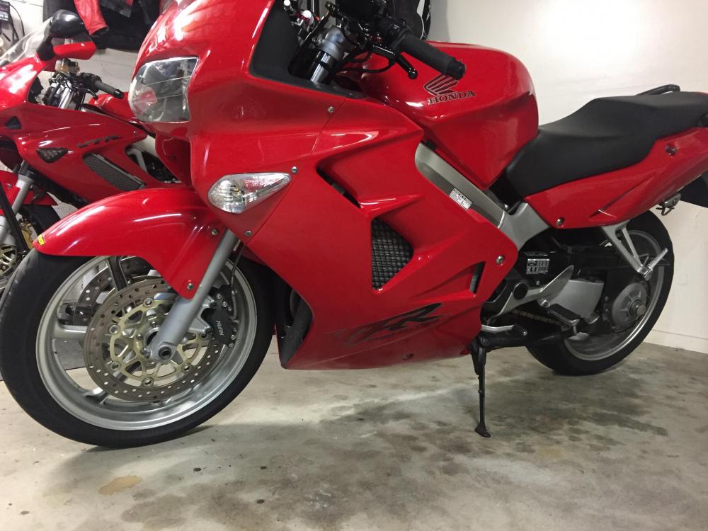

Member Contributer Terry Posted January 9, 2019 Member Contributer Posted January 9, 2019 Auctmarts fairings for the 5G are compression moulded, not injection. I have a set on my 5G and they are pretty good provided you don't mind massaging a few holes. I sent them a chip of my old fairing and they did a decent colour match for me to match the tank, fender and the OEM L side panel which I retained. 2 Quote

Member Contributer MaxSwell Posted January 22, 2019 Member Contributer Posted January 22, 2019 On 1/8/2019 at 6:53 PM, Terry said: Auctmarts fairings for the 5G are compression moulded, not injection. I have a set on my 5G and they are pretty good provided you don't mind massaging a few holes. I sent them a chip of my old fairing and they did a decent colour match for me to match the tank, fender and the OEM L side panel which I retained. That looks great. I'll have to remember (fat chance) this. Well, that was a little disappointing; no yellow. Quote
