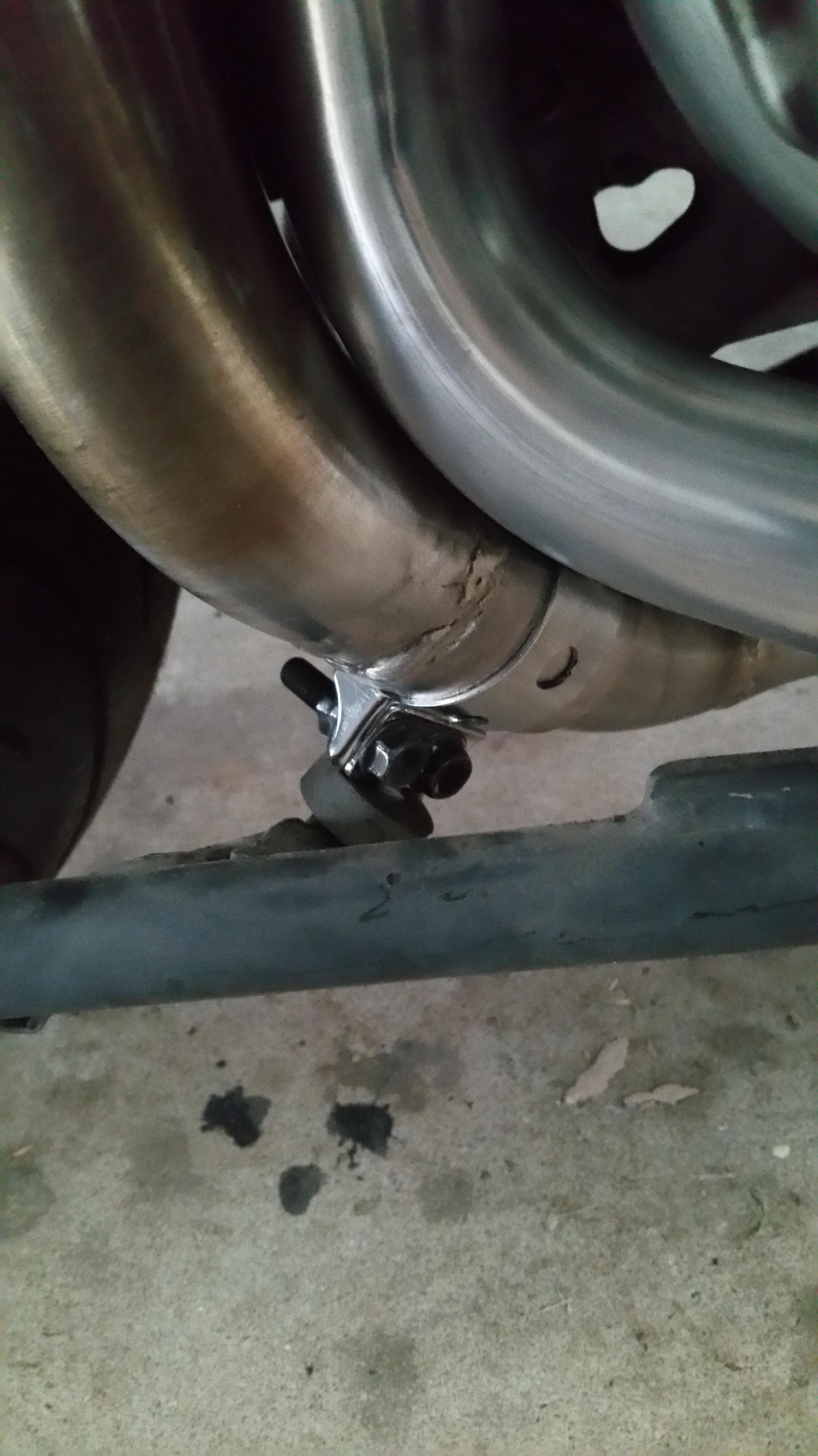

Member Contributer boOZZIE Posted April 13, 2020 Member Contributer Posted April 13, 2020 Not to take anything away from Sebs mad skills, more so if I can find a cheap arse solution I'll try to... and I did. That's the original stop sandwiched between the jaws of the slightly modified ( ground the leading edge flat ) strap clamp 2 Quote
Member Contributer boOZZIE Posted April 13, 2020 Member Contributer Posted April 13, 2020 Nope that didn't work. Smh Came back from a ride and it was about 1mm away from braking off. Zip tied to C stand 4 now Quote

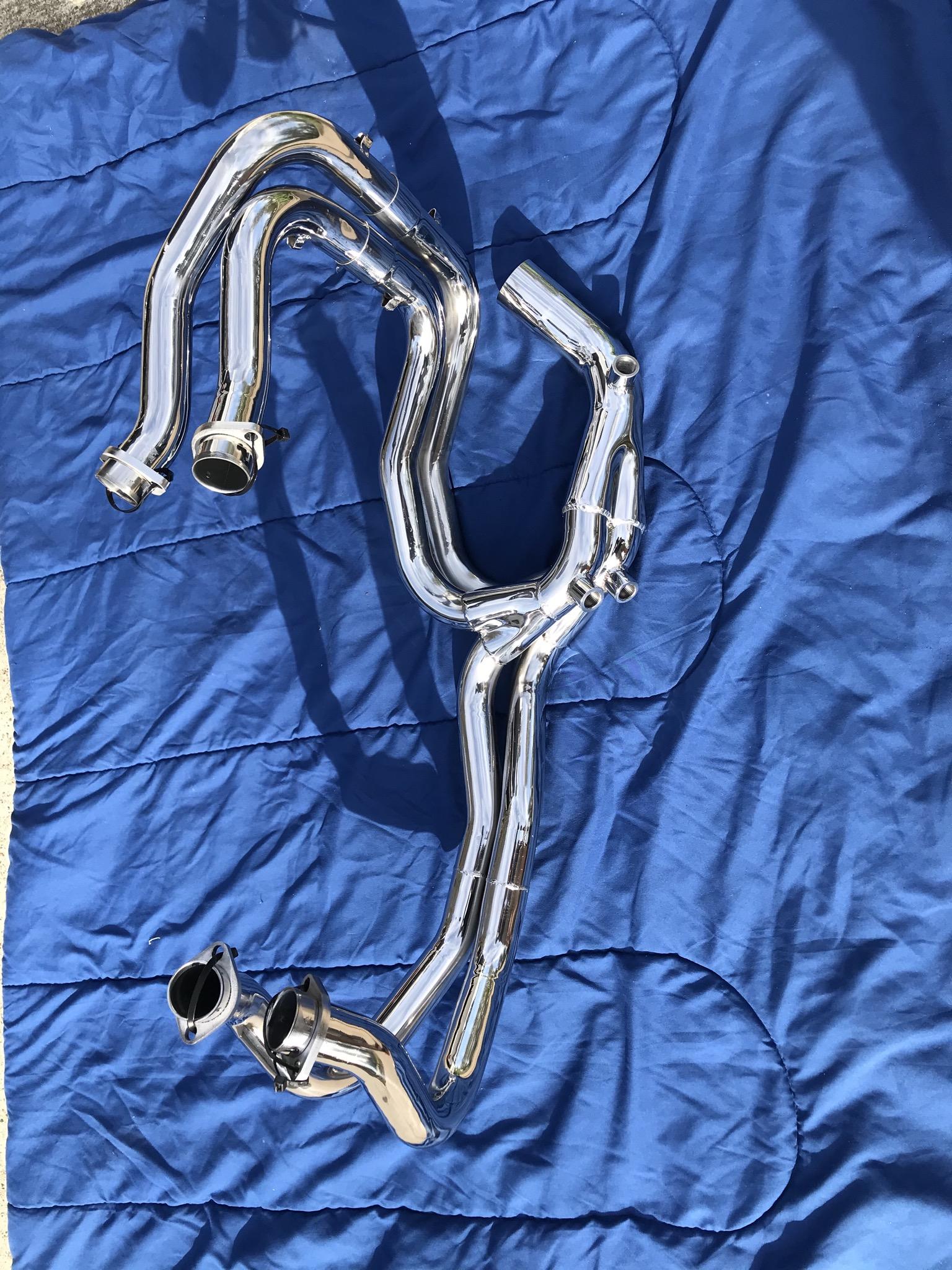

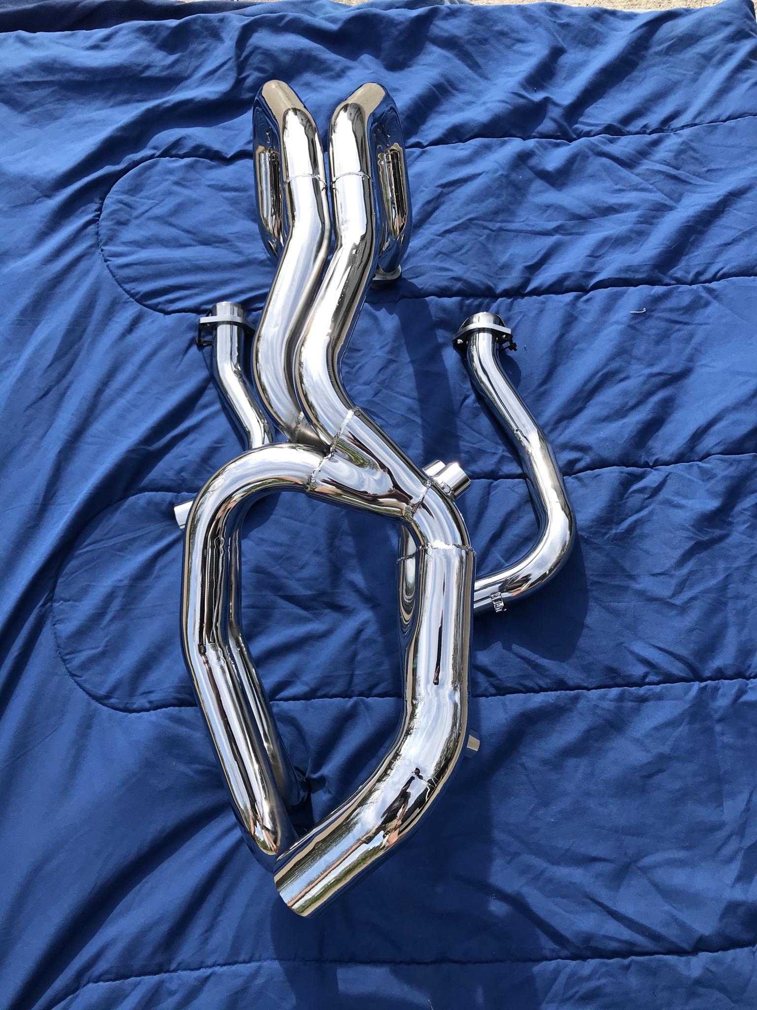

Member Contributer ducnut Posted April 19, 2020 Member Contributer Posted April 19, 2020 I think, I’m done with it. Hopefully, I’ll get it installed this week. First pic is before and I tried to take the 2nd pic in similar light. Edit: Looks like the forum platform resized the pics, so the clarity is gone. 7 Quote
Member Contributer MBrane Posted April 20, 2020 Member Contributer Posted April 20, 2020 That's awesome, but I didn't bother since it wouldn't look like that for long on my bikes. Quote
Member Contributer sfdownhill Posted April 20, 2020 Author Member Contributer Posted April 20, 2020 On 4/13/2020 at 12:23 AM, boOZZIE said: That's the original stop sandwiched between the jaws of the slightly modified ( ground the leading edge flat ) strap clamp Cool beans, boOZZIE. Even simpler than the T-bolt clamp solution we were struggling with. Quote
Member Contributer sfdownhill Posted April 20, 2020 Author Member Contributer Posted April 20, 2020 6 hours ago, ducnut said: I think, I’m done with it. Hopefully, I’ll get it installed this week. First pic is before and I tried to take the 2nd pic in similar light. Edit: Looks like the forum platform resized the pics, so the clarity is gone. Jawdroppingly gorgeous tubeset, ducnut. Fine work. 1 Quote

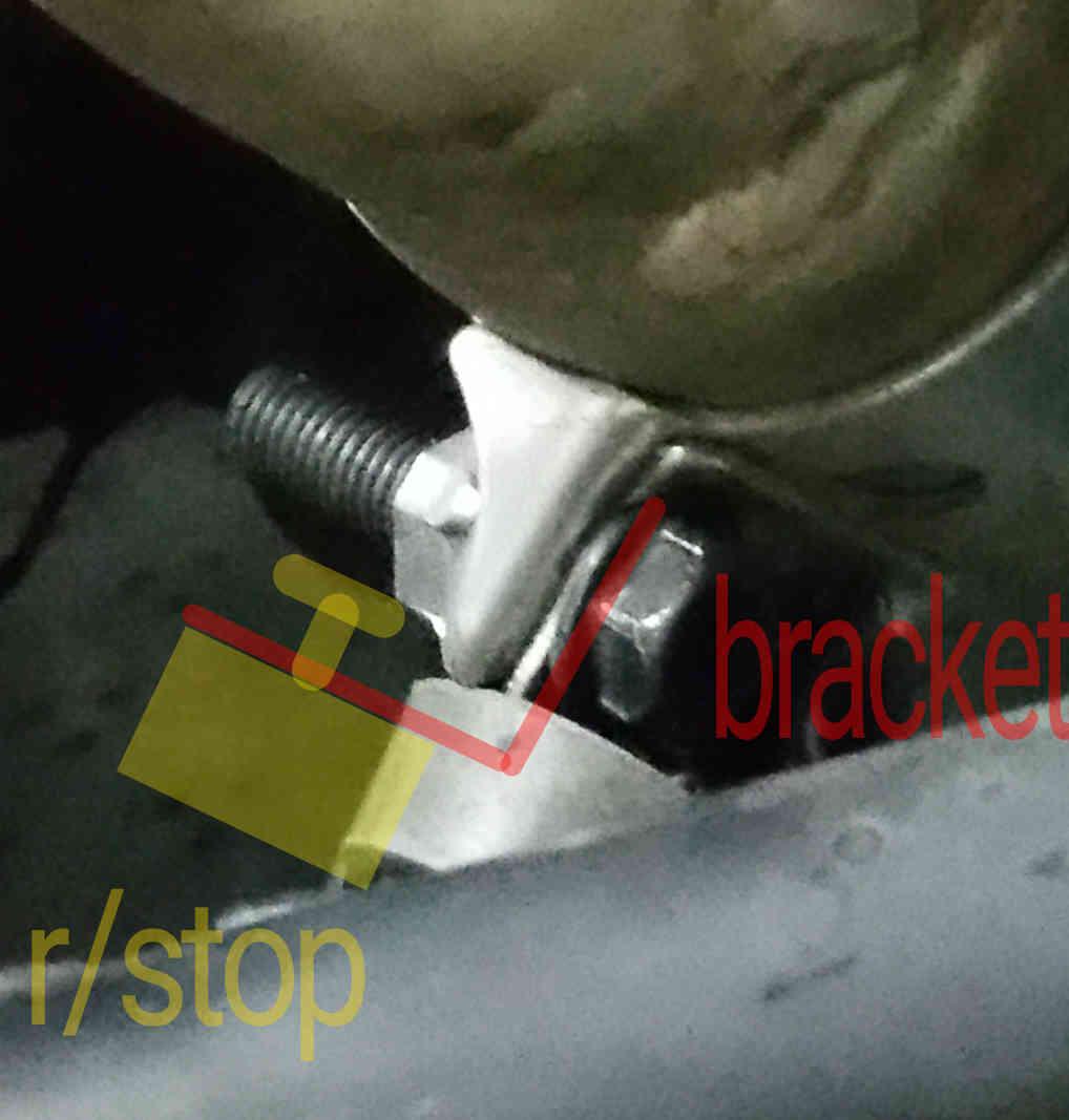

Member Contributer boOZZIE Posted April 20, 2020 Member Contributer Posted April 20, 2020 4 hours ago, sfdownhill said: Cool beans, boOZZIE. Even simpler than the T-bolt clamp solution we were struggling with. Nah, it didn't work mate. The little rubber nipple thingy on the stop that pushes thru a hole in the OE exhaust almost sheared off and has been separated now. I do have a solution for anyone who has the "complete" OE rubber stop and the OE 2 bolt strap clamp. You just need a little right angle bracket with a hole for a bolt of the strap clamp and a hole for the nipple of the rubber stop. 1 Quote
