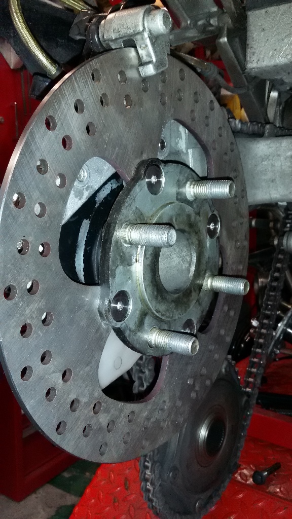

Member Contributer JZH Posted June 7, 2016 Member Contributer Posted June 7, 2016 I see you're using narrow-head M8 bolts for the brake disk. I found that titanium BMW S1000R disk bolts were almost perfect when I wanted to be able to use an RC46 rear wheel on my RC36 rear axle. However, I found that some aftermarket bolts had thicker heads than others! Maybe this is possible because this bolt is not in a DIN form?  Ciao, 1 Quote
VFRRR Posted June 7, 2016 Author Posted June 7, 2016 HI JZH, it's a 6 mm bolt, because the disc is for the HRC RC45 axle, but eventually, when I receive the right disc, then it will be with 8 mm bolts, and with the same head. Â I do not think the heads on bolt follow a specific norm, other vice than the socket size, or hex head size. If that's what you mean, when writing it is not in a DIN norm? Â Quote
Member Contributer Mohawk Posted June 7, 2016 Member Contributer Posted June 7, 2016 I used VFR400 Titanium sprocket carrier bolts for my disc bolts when I changed the axle. They are flat headed, so fit inside the recess on the wheel side of the axle plate. Quote
Member Contributer JZH Posted June 7, 2016 Member Contributer Posted June 7, 2016 There are international standards, such as DIN and JIS, for bolts, nuts, washers, etc., and most aftermarket fasteners are made to meet these standards so that an "M8 cap screw" is interchangeable with any other "M8 cap screw". But many motorcycle-specific fasteners are not manufactured to any particular standard. I was just suggesting one reason why the "titanium BMW S1000R rear brake disc bolts" I had purchased from different suppliers had 1mm different head heights. Only the ones sourced from BMW are guaranteed to be correct for a BMW; the ones supplied by the low-volume titanium fastener companies I was using are a bit hit-and-miss.   This is an RC36 axle/disc set-up to run an un-modified RC46 rear wheel (using the BMW bolts mentioned above). Head height was critical because the wheel flange fit flush to the axle surface.  Ciao, Quote

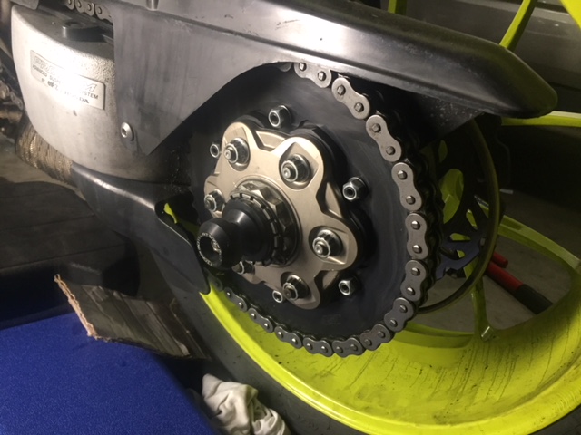

keef Posted November 14, 2017 Posted November 14, 2017 Ken, I'm using a ducati 1098S forged alloy rear wheel in a 5th gen arm - a spacer and a shim, fits right in. Quote

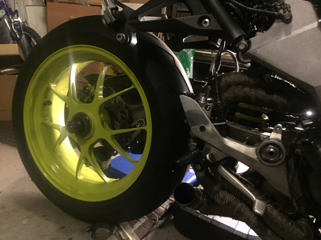

keef Posted November 15, 2017 Posted November 15, 2017 18 hours ago, RVFR said: Photos? or its not for real Keef   its real, and a lurid colour. 4 Quote
BiKenG Posted November 15, 2017 Posted November 15, 2017 Hey keef, I see you're using Ducati (style) nuts on both ends of the axle. Is that because the nuts fit the Honda axle (in which case, which axle) or are you using a Ducati axle? Quote

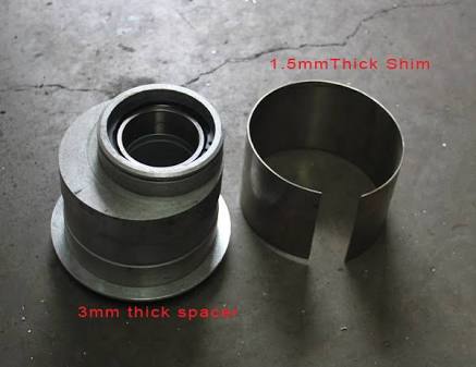

keef Posted November 15, 2017 Posted November 15, 2017 11 hours ago, BiKenG said: Hey keef, I see you're using Ducati (style) nuts on both ends of the axle. Is that because the nuts fit the Honda axle (in which case, which axle) or are you using a Ducati axle? Ducati axle. It is a... vfr arm, axle/hub/eccentric removed duke 1098 axle, etc 1.5mm shim as the duke stuff s 3mm smaller 5mm spacer to centre it in she goes. Although it might be a 2.5mm shim and a 3mm spacer, it was 5 years ago, now. Custom extreme creations sprocket on a Ducati driven quick change hub, duke rear rotor, duke rear caliper, ex creations caliper bracket.  848 stuff won’t work, only 1098.  I over complicated the second version of my front mount rad, but the rear wheel conversion was kept simple. Quote
keef Posted November 15, 2017 Posted November 15, 2017 I googled my bike to find the pic 1.5mm and 3mm  2 Quote
RVFR Posted November 15, 2017 Posted November 15, 2017 Curious here in the rear wheel offset, I had a 1098 rear wheel where I was going to use, then found that the offset is different, maybe you fixed this with the Ducati eccentric ? This is still on my bucket list to do if and when. Thanks for the photos  ;) Oh, btw the color is spot on. Quote

keef Posted November 16, 2017 Posted November 16, 2017 3 hours ago, RVFR said: Curious here in the rear wheel offset, I had a 1098 rear wheel where I was going to use, then found that the offset is different, maybe you fixed this with the Ducati eccentric ? This is still on my bucket list to do if and when. Thanks for the photos  ;) Oh, btw the color is spot on. I gave a 1098 wheel to extreme creations to figure out. Ben ha a spare 5th gen arm to test on. I thought he would need to make an adapter plate like carrozzeria used to. He noticed that the Duke eccentric would fit, so we went that route. I've seen complete 1098 arms for $300 aus. You could take the eccentric and sell the arm on. Same sort of thing guys who raced vfr400's out here used to do to change to a 17 inch rear wheel. colour is ford citric acid from the xr6's. Kinda fluoro yellow, kinda snot green.  Oh, and slightly related to what Mohawk is saying - I know a guy (and internet streetfighter building friend) whoi used a crf MC for his rear because the integrated res looks cool. Doesn't really work on an OEM vfr rear caliper.    Quote
