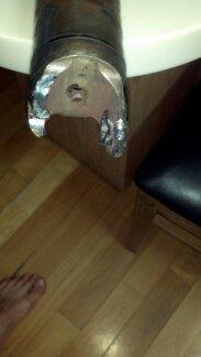

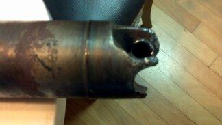

Dae Posted January 23, 2016 Posted January 23, 2016 (edited) I should have kept the failed shaft drive but tossed in the trash last year. I hope the dealer let's me into the work area and see if I can see if their is any difference in the new unit. Edited January 23, 2016 by Dae Quote
Member Contributer Switchblade Posted January 23, 2016 Member Contributer Posted January 23, 2016 There claiming it's just a assembly problem so should be no difference but yeah it would have been interesting to see if there was any changes. Quote

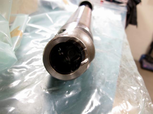

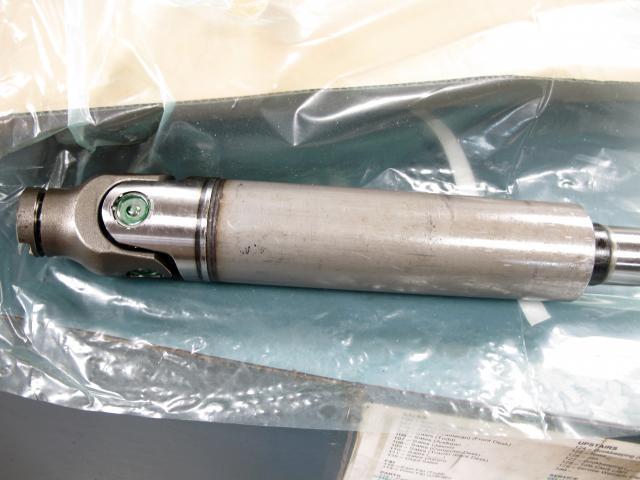

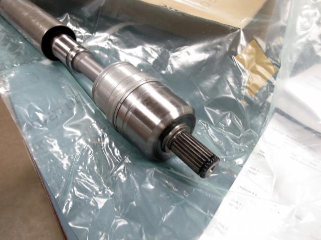

mikep Posted January 24, 2016 Posted January 24, 2016 (edited) Here is the new shaft we will all receive, this was taken at my dealership today. Edited January 24, 2016 by mikep Quote
