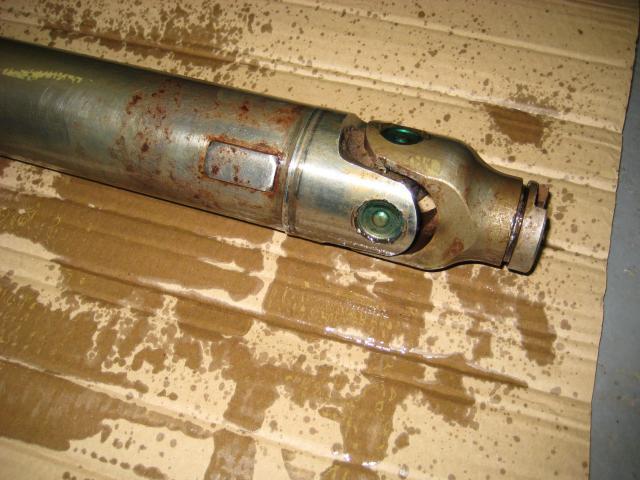

750 Posted December 30, 2015 Posted December 30, 2015 Thanks Dave. This might sound a bit special, but how will Honda know I'm the owner? I'm assuming they only know the details of the original person who bought the bike from the dealer, or do they somehow use DVLA etc? Also, are there any signs this may well be ready to go wrong on the bike? I've got a ~350 mile ride from where it is, back to mine in London - would rather this not lock my rear wheel up mid bend...or at any point really! The bike's got 55k on it so I doubt it's about to go *ping* but you never know. Quote
Member Contributer hvfrdave Posted December 30, 2015 Member Contributer Posted December 30, 2015 Just to make sure, go to your nearest Honda dealer, when you know the re-calls in the UK have started, I will let you know, as soon as I know. As regards to your 350 mile journey, that should not be a problem. For minds sake, I can see of the photo, that your bike as a centre stand, put the bike on the centre stand, [do not run the engine when you do this], then on the left hand side of the engine, there is a rubber gator, just forward of the swing arm pivot, just un clip the gator so you can see the UJ of the prop-shaft, now do a visual check, if there is any sign of heat build up, ie purple or dark blue, around the UJ, [don't ride your bike] if all's well, make sure she is in neutral, and rotate the rear wheel, in a forward direction, now it should rotate freely and quietly, now at the same time have a look at the UJ while it is rotating, now put it in 1st gear and do the same, rotate backwards and forwards, there will be some free play, when you do this but there is nothing to worry about, they all do it., now if there is any sign of the UJ grabbing again [don't ride it,] But I am sure it will be ok. Because I know your bike will have been serviced, correctly. Hope this helps, enjoy your ride home, ride safe, Dave. Thanks Dave.This might sound a bit special, but how will Honda know I'm the owner? I'm assuming they only know the details of the original person who bought the bike from the dealer, or do they somehow use DVLA etc?Also, are there any signs this may well be ready to go wrong on the bike? I've got a ~350 mile ride from where it is, back to mine in London - would rather this not lock my rear wheel up mid bend...or at any point really! The bike's got 55k on it so I doubt it's about to go *ping* but you never know. A photo of a UJ in good condition. 1 Quote
