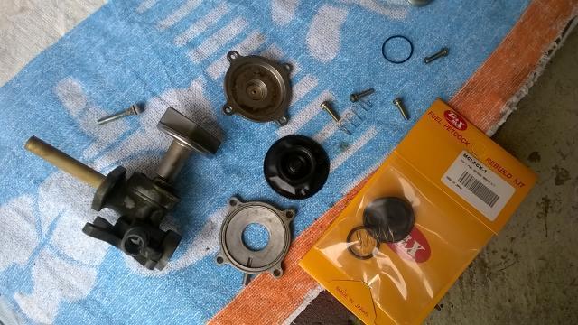

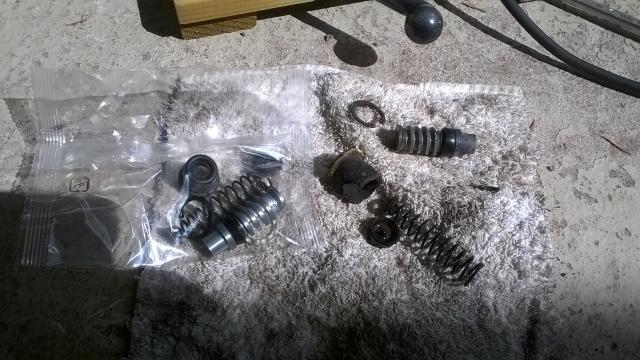

keny Posted May 20, 2015 Author Posted May 20, 2015 Some uppdates. As I posted in a other topic, even intention was here, some work is done, like new chain on, the Clutch has new seal both M/C and slave cylinder, was not to soon! Today I started whit the Fuel tap, and could just say mine has a 1986 style fuel tap, and the repair kit I did order was wrong But the bright side is that it seem OK, just some dirt in there. Now what still is a mystery is why the bike starve for fuel as the tank has lost bout 10l of fuel? I did change the vacuum horse to the fuel tap as I got home, still the bike did starve for fuel, come alive as I did let the bike over to left side. Hmmm.... Hopfully the small amount of dire in there is the reason and it will run fine now, it should have a 15,5 liter tank as a 1986 spec bike, even frame number say its a 1985....Swiss bike? I can see there is still parts available, like a vacum kit for the Fuel Tap: Quote

keny Posted May 20, 2015 Author Posted May 20, 2015 This might be of interest to you Keny ... He does more than just suspension http://www.daughertymotorsports.com/howto/tankvalve/tankvalve.html Thanks, it is, but the only thing is, my bike do not have a fuel pump! So why I am having same synthoms? that`s the big question? Quote

Member Contributer YoshiHNS Posted May 22, 2015 Member Contributer Posted May 22, 2015 Is it like on the VTR250 selector? With the face seal? That repair kit is just for the vacuum. Vacuum from one cylinder opens the fuel line. You can test to see if it works by using a vacuum pump (MityVac hand pump works great). The face seal hardens, deteriorates, and gets filled with gunk. Quote
Member Contributer MadScientist Posted May 22, 2015 Member Contributer Posted May 22, 2015 Had the stock vacuum petcock fail on the 599 (Hornet 600 for Europe). Decided to scrap the whole thing and put on a manual petcock. This may be an option for you if the petcock is accessible so you can manually turn it on and off. I used a pingel unit that fit on the stock 22mm threads. Not really sure how yours mounts, but they make a variety of different fuel tank outlet fitments. There may be something less expensive and more local for you though. Quote
keny Posted May 22, 2015 Author Posted May 22, 2015 (edited) Had the stock vacuum petcock fail on the 599 (Hornet 600 for Europe). Decided to scrap the whole thing and put on a manual petcock. This may be an option for you if the petcock is accessible so you can manually turn it on and off. I used a pingel unit that fit on the stock 22mm threads. Not really sure how yours mounts, but they make a variety of different fuel tank outlet fitments. There may be something less expensive and more local for you though. The stock petcock has a manual on/off/reserve + a vacuum operated valve, all in same bit. To make it manual all I need is to do like in the link that is in earlier posts or here again: http://www.daughertymotorsports.com/howto/tankvalve/tankvalve.html And almost did this mod, but as all seem nice , and as I did shorten a screw to plug the outtake for the vacuum tube, I noticed the adapter was loose, whitch mean it may/will eventually leak and perhaps shut the vacuum valve, so decided to test if it works for at least next ride. Aside opening the front calipper, as I still have not got the new seals for them, all is done (mounted new speedo cable today) so ready for a 200-300km ride tomorrow..... Edited May 23, 2015 by keny Quote
Member Contributer MadScientist Posted May 22, 2015 Member Contributer Posted May 22, 2015 The stock petcock has a manual on/off/reserve + a vacuum operated valve, all in same bit. To lake it manual all I need is to do like in the link that is in earlier posts or here again: http://www.daughertymotorsports.com/howto/tankvalve/tankvalve.html And almost did this mod, but as all seem nice , and as I did shorten a screw to plug the outtake for the vacuum tube, I noticed the adapter was loose, whitch mean it may/will eventually leak and perhaps shut the vacuum valve, so decided to test if it works for at least next ride. Aside opening the front calipper, as I still have not got the new seals for them, all is done (mounted new speedo cable today) so ready for a 200-300km ride tomorrow..... Neat mod. Also totally impossible to mount a pingel there; it's buried too far to turn the switch on and off. Best of luck! Quote

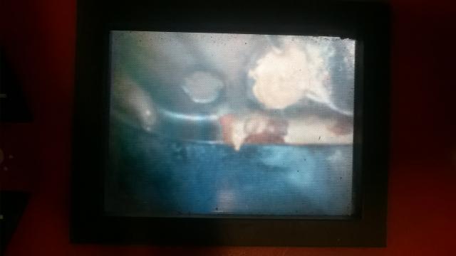

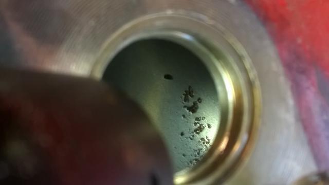

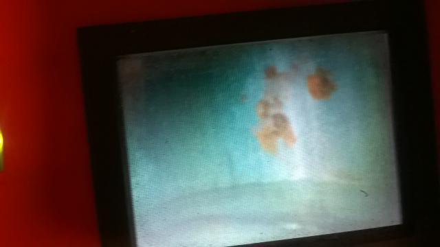

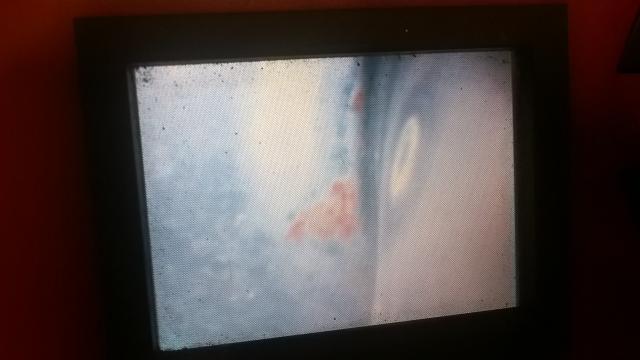

keny Posted June 20, 2015 Author Posted June 20, 2015 On ‎22‎.‎5‎.‎2015 at 4:03 AM, JZH said: Hope that "dirt" isn't rust...I just replaced the tank on my FP due to rust. Sitting unused for years and being shipped to Hong Kong and back did not help! Ciao, I do hope this dirt is not rust............. Quote
VFRBert Posted June 20, 2015 Posted June 20, 2015 If it is rust, electrolysis eill deal with it: http://thekneeslider.com/how-to-get-rid-of-rust-in-motorcycle-gas-tanks/ I have plans to deal with the rust in the tank of my cb550 in short time. After dealing with the rust, i will zinc coat it with the aid of electrolysis. http://home.comcast.net/~rt66tbird/website/zincplating.html Quote

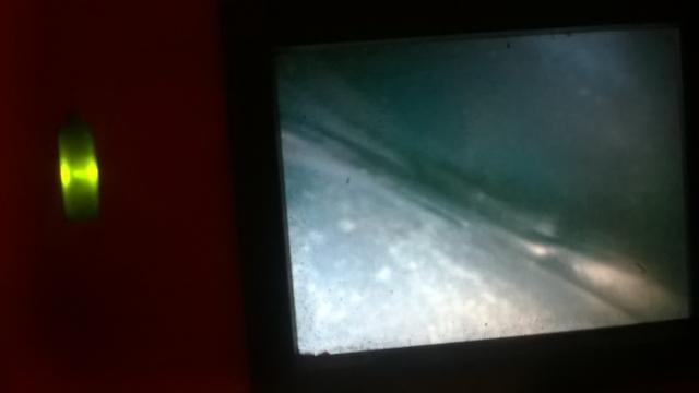

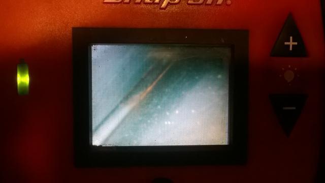

keny Posted June 24, 2015 Author Posted June 24, 2015 I had a snap on peak camera borrowed today from a friends work. Looks more promising than I had hoped. Actually the 4 pics whit some minor rust is all rust I did find in the tank, the rest looked like this So can the loose dirt/rust that was in the tank had come from a fill up from a petrol station whit a bad tank? Quote
Member Contributer Dutchy Posted June 24, 2015 Member Contributer Posted June 24, 2015 Hello Mod Team, please change Keny's forum name to "Endo" That is good news Endo! I have an air filter and a petcock repair kit (switched to OFF it doesnot stop the flow of petrol) coming in, so I will drain the tank on mine as well and see what I can see... As for engines blowing up, I re-read a one page summary from Practical Sportbikes, a magazine regarded as "in the know" no? They mentioned a few weaknesses of the F2, but valves were not mentioned..... The PO of my VF (and the PO before that) claim always to have used fully synthetic oil so that is what I will continue; hoping that this "better" oil contributes a a longer life..... (beats burning incense in front of a Ganesh statue.....) Quote
