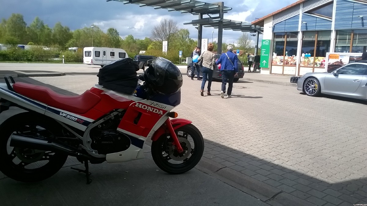

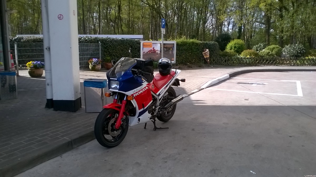

Saturday morning I head towards Germany and had first fuel stop just before German border, only made 140km just to see what the fuel consumption would be. First was 6,7l/100km, so quit high!
Next stop was in Germany, about 30 km south of Bremen in Germany, after the VF500 clock had turned 40k kms at the crossing of E30 and A1 88km before. Bike was running great, and fuel consumption was now down to 6,0l/100km :smile:

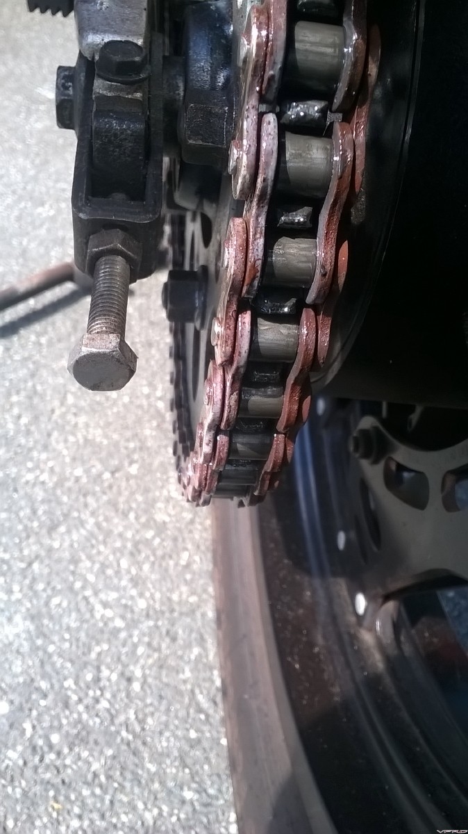

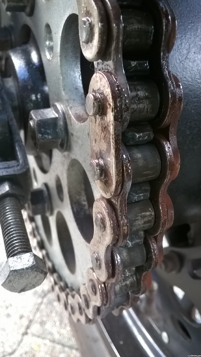

Then I started to lube the chain and suddenly I noticed not a nice thing :blink:
The chain lock clip was missing, and I had not even been speeding. I know the bike had a "cheap" chain, read no o-ring one, and a bike like this would need a chain whit a proper chain lock. I was in deep s___t.............. Called Leon, and he found out the cosets plase to get a chain lock was Bremen and Louis shop, slowly I did ride there..
The chain did not look that good at close inspection, came rust from it!
The brown in next pic is rust dust from the chain
So at Louis I first asked for a new chain, becorse it had stretch a bit alredy. They had non in stock, and as they didn`t stock Iris chains, only DID, they didnt want to sell me a chain look for the wrong brand. I had a explane 15 min that I just need the clip and they have no responsability selling it to me. Eventually got it, and had to buy a tool to get it mounted also. But all was not ok by this, becorse on my way to Louis, 11km after the fuel stop, the odo/speedo did stop work. Louise didnt have a new cabel in stock, so I had to just ride distanse by the navigater from now on. So I´m on the road again and had passed Hamburg at 1pm. Time for next fuel stop.

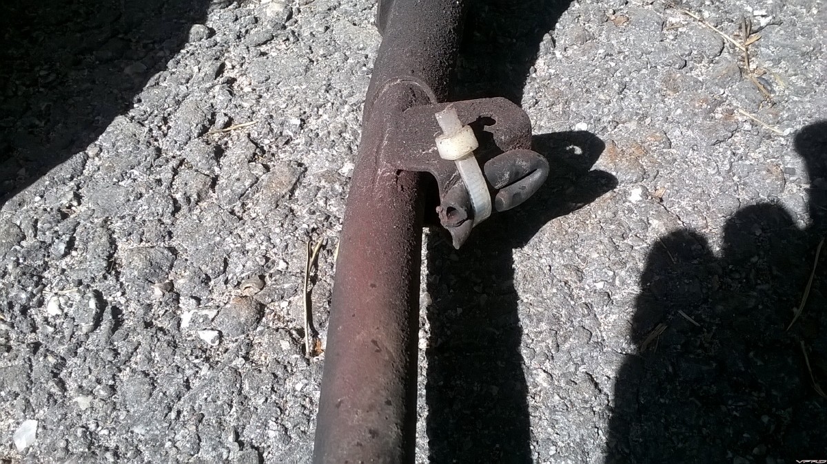

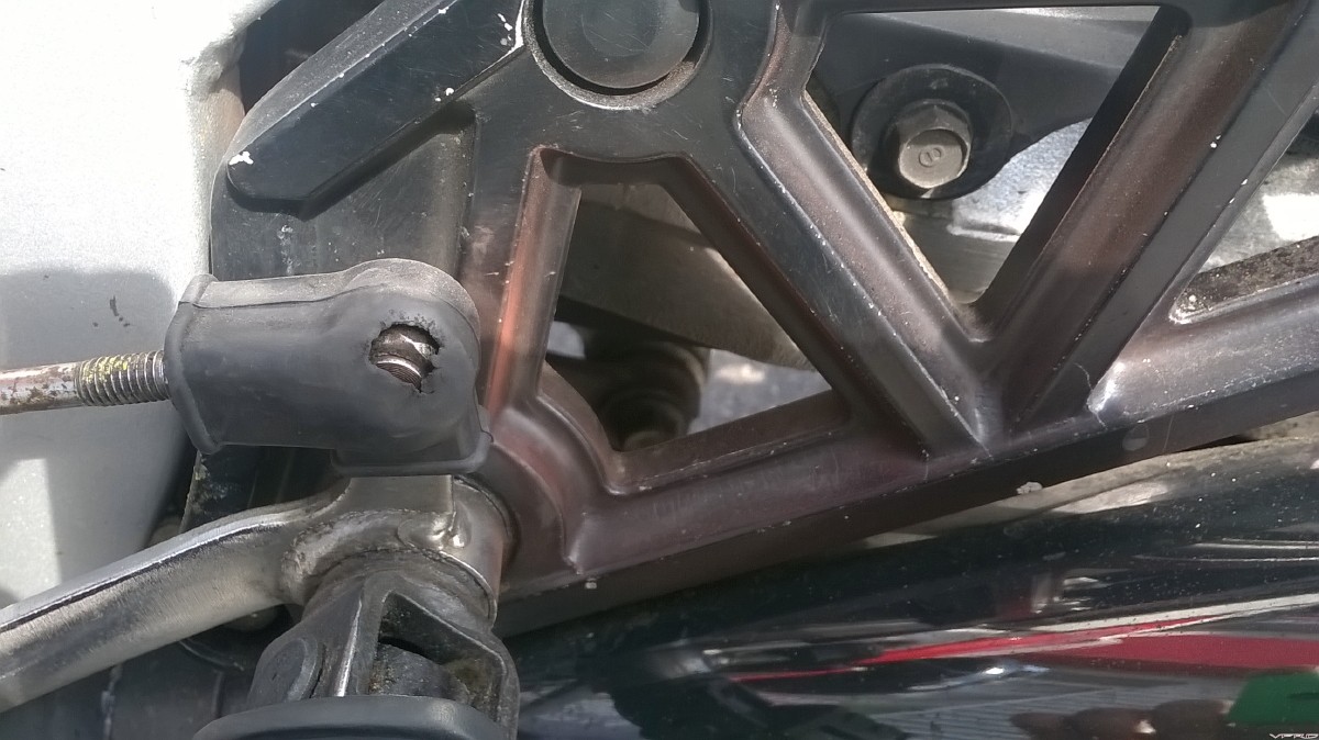

At that bridge the bike started struggle for fuel, and eventually did die, so I rolled to the road till station, payd the toll and pushed the bike to the parking lot and see what can be done. Eventually the vaccum pipe betwen the fuel tap and engine had gone brittle and leaked. The accumulator owerflow tube was same size, so I did borrow it and I was on the road again!

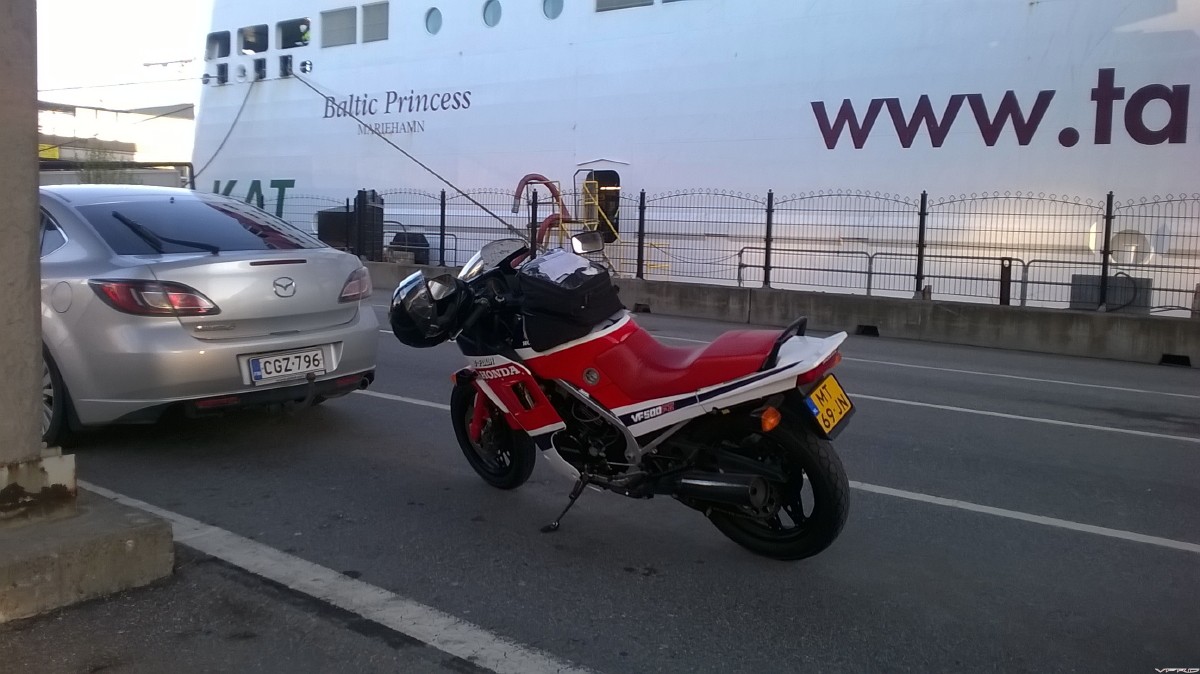

Here I wait to get on the ferry
And shes pretty tied up.....on the ferry

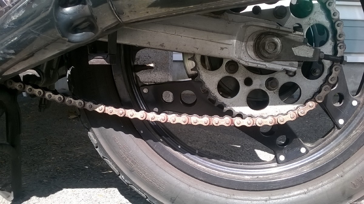

I got home, the chain did not stretch to much, even I had to shim the center stand a bit so chain did not rub it. I did not have tools along to adjust the chain! the rear axle tool was missing.......
The bad vaccum tube came handy for that whit a zip tie, was done during night ride in Sweden

Heard plenty of stories of missing clips, especially when the chain has stretched a bit, asto me it looks it has stretched quite a bit compared to what it looked like on friday.

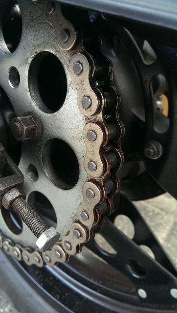

I did check the clip I installed in Bremen during every stay, and it did hold all way home. Its time for a new chain, thats for sure, a O or X ring and proberly a rivet linked...
I had to turn the adjusters at the rear of the swing 5 ½ turn to get it somewhat adjusted, still quite loose as its uneven stretched during the length

That chain had no grease left inside the rollers. This kind of chain need to be put in a can of heated grease every 1500 k. That explains the clip lock, because every 1500k you have tot remove the chain for greasing. Without grease the chain is gone in one long road trip.
Edited by VFRBert
Posted (edited)
Yes, its a non o-ring chain, mostly used on race bikes as low cc(125cc and smaller) bikes, becorse it has low inside friction (=rob less HP). The back side it needs careful lubrication regulary, best the way you describe. I do think that sinking that chain in a hot grease bath would not had help, becorse it looks like it been washed but not oiled after so water had been sitting in it and damage done. Just rust poring out of it tells that. I did lube it every stop I made (9 in total) and the 4 last stop it didn´t stretch any or very little, most it did stretch the 3-4 first stops. So I guess lube got in it after all to stop it wear further. It will be replaced whit a O or X ring chain for a longer life whit more ease. What has crossed my mind is if there would be sprockets to make a 520 convention....
Edited by keny
That brings back memories. Years ago i used to do that with my chains. Made by a company called Renolds http://www.renold.com/. Used to come in a big cake like tin then heated. In my case on my mums cooker, she used to go tits at the smell. Chain was basically soaked in molten grease then taken out and allowed to solidify. Very messy job!
