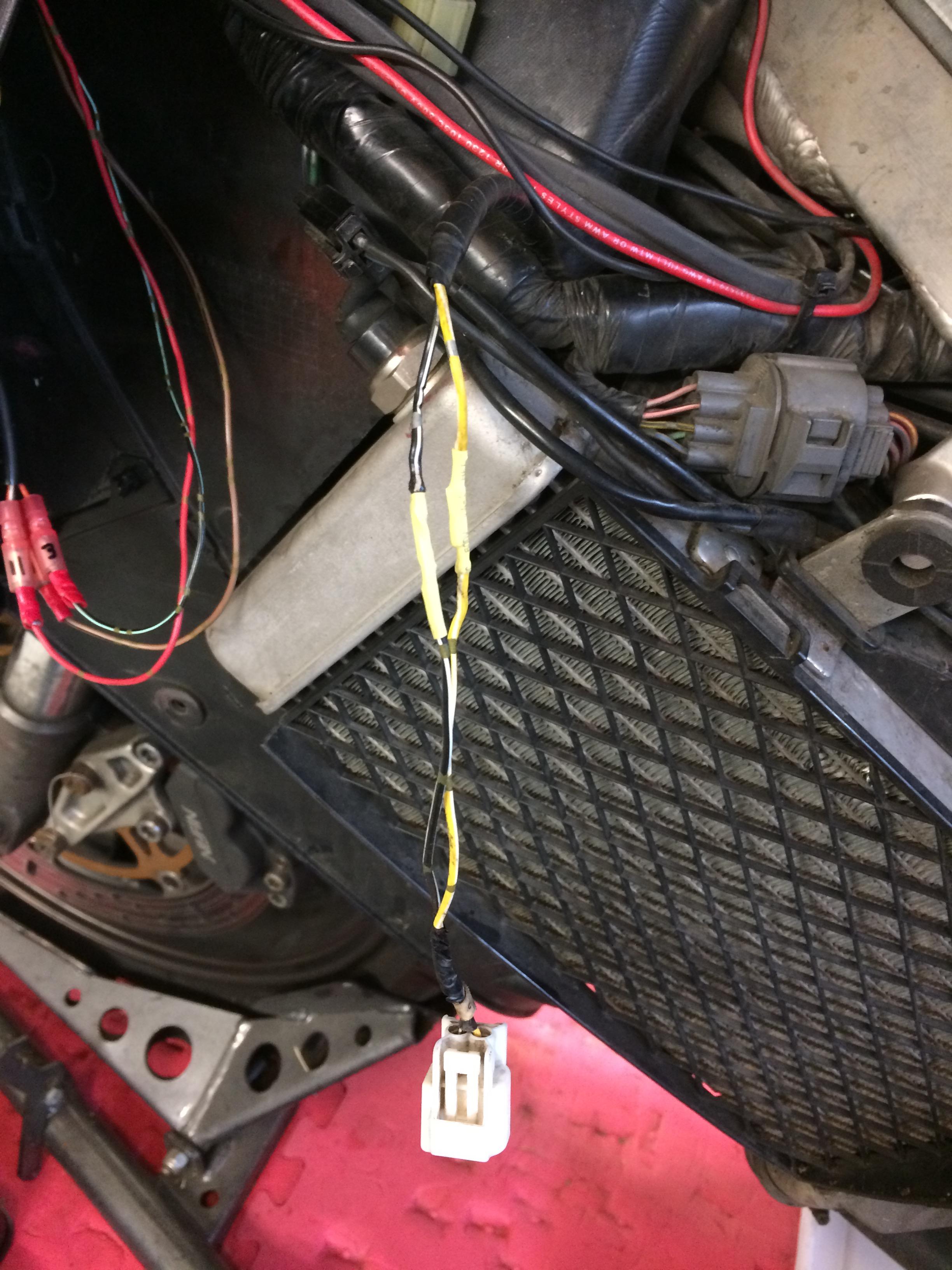

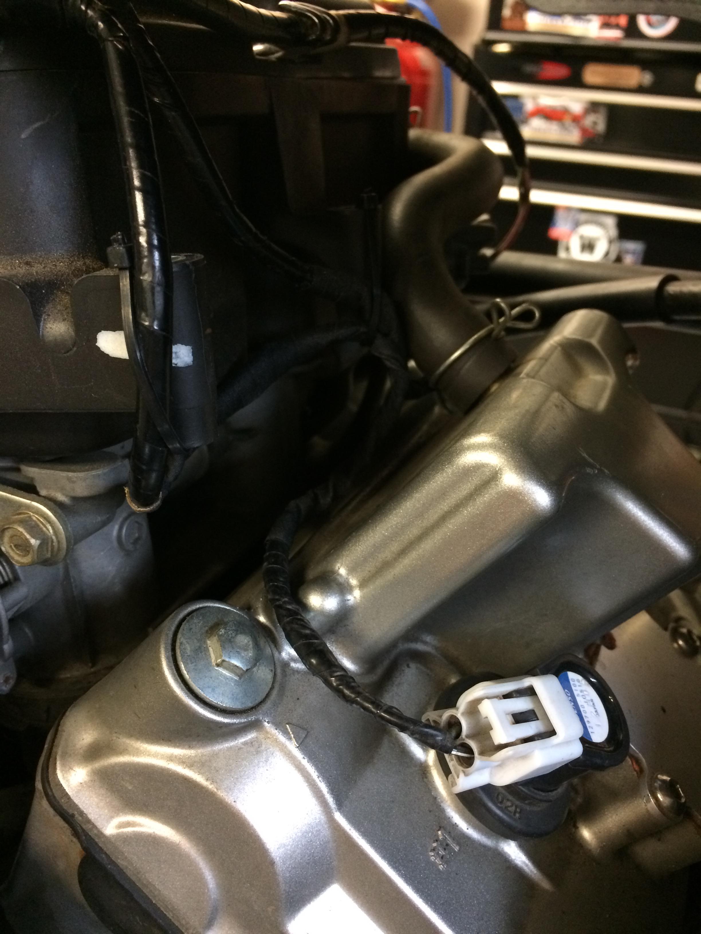

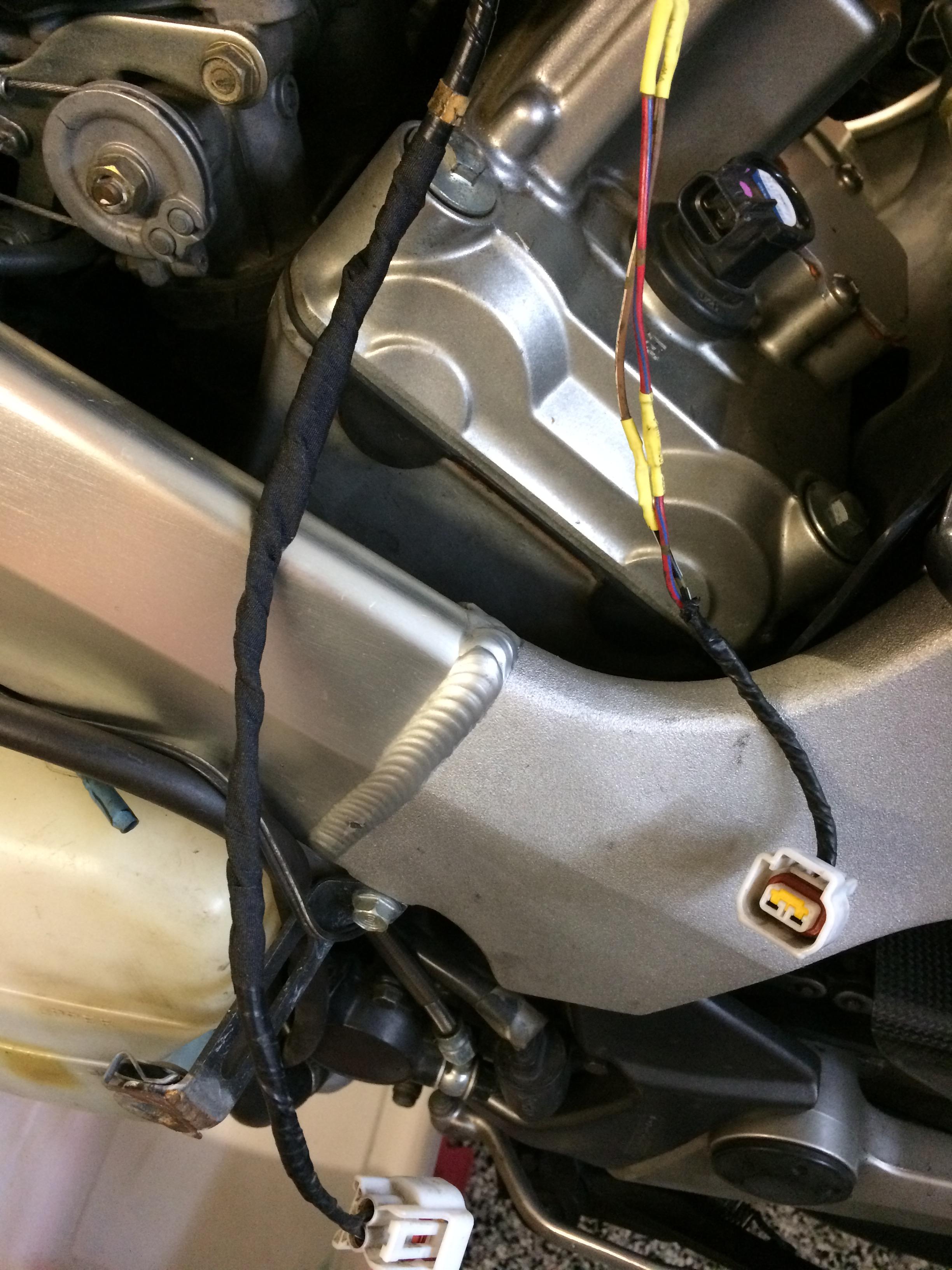

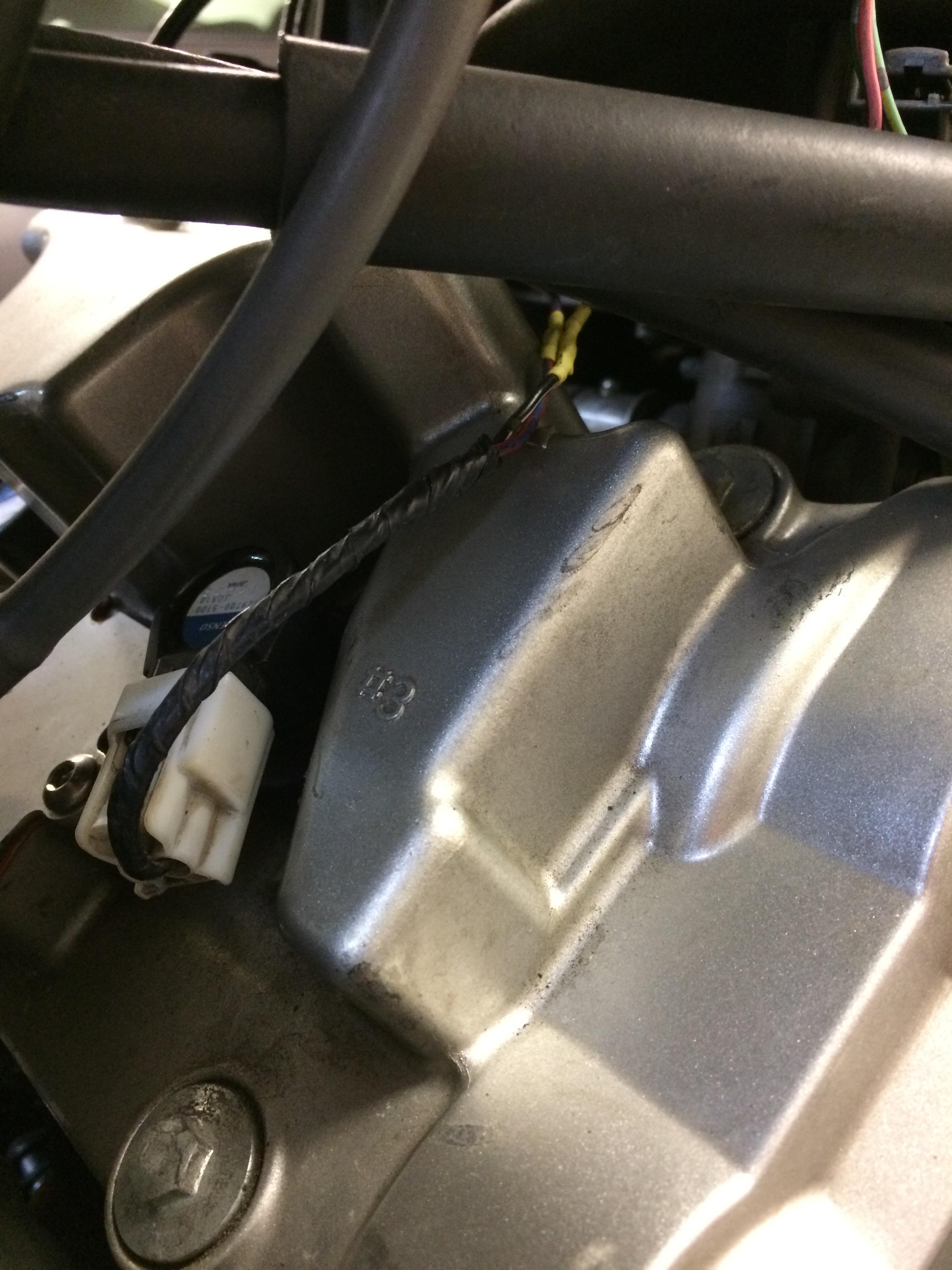

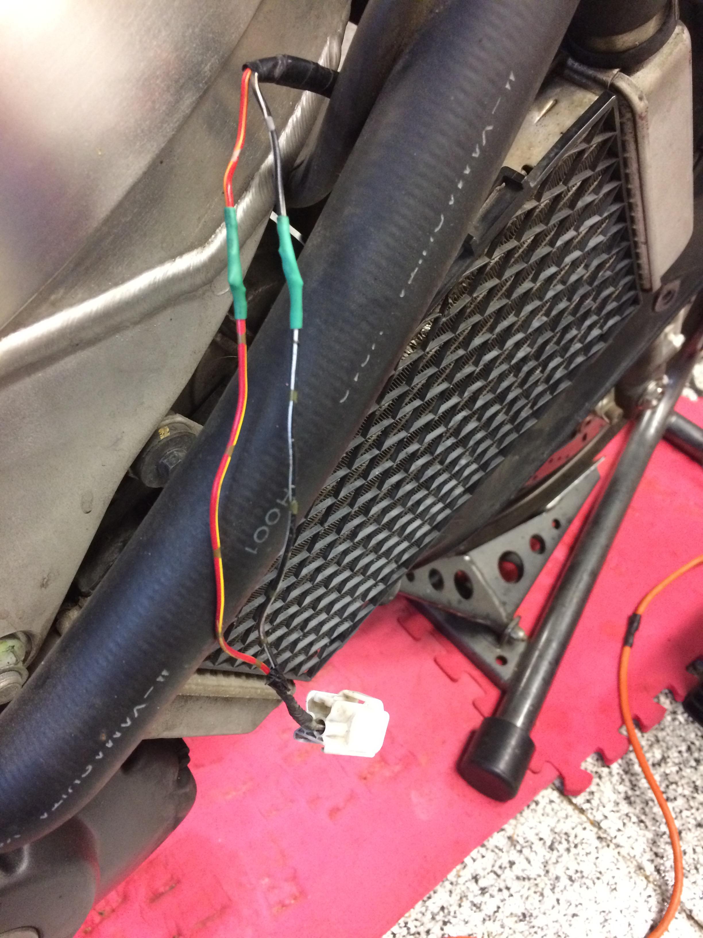

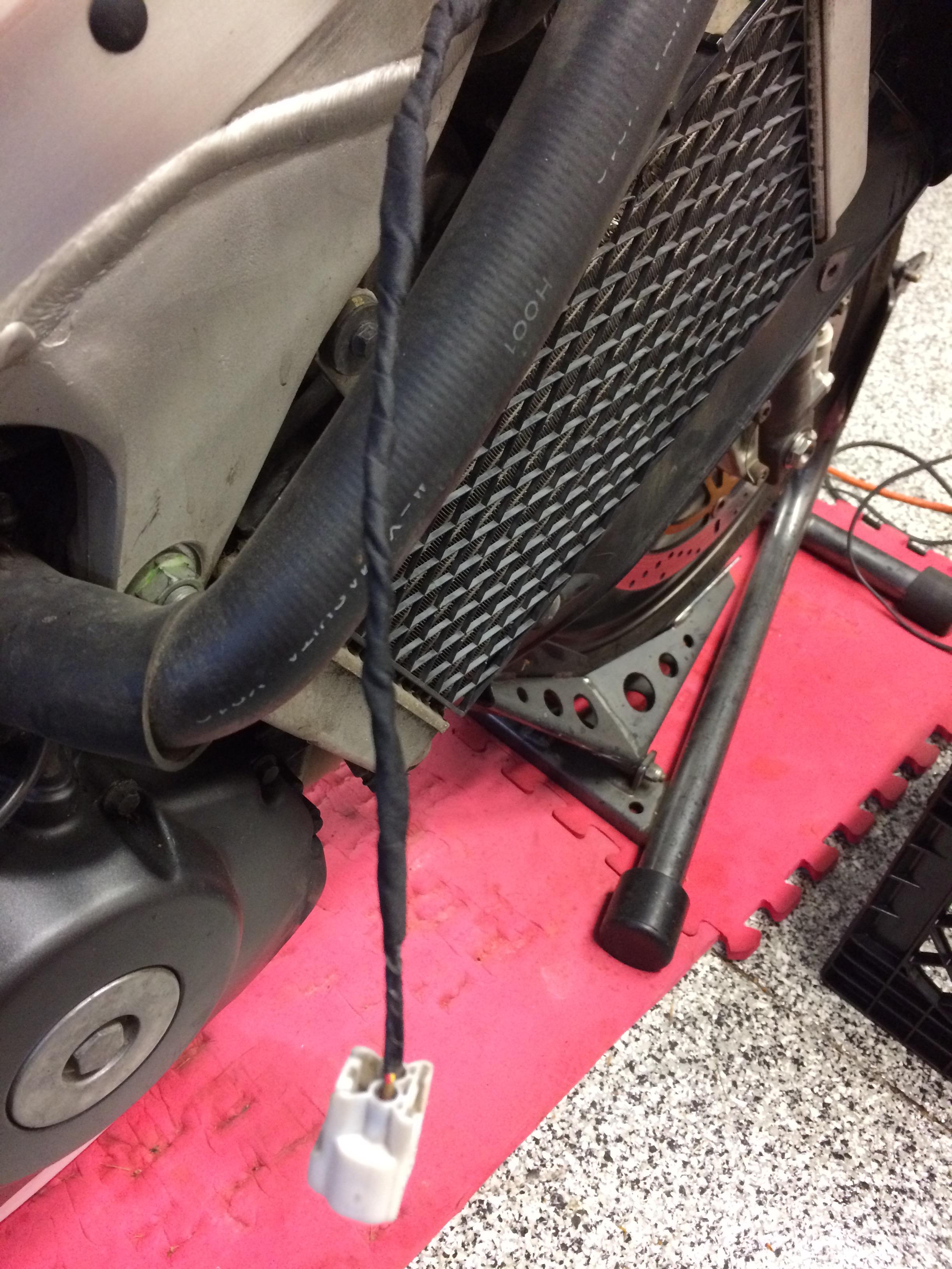

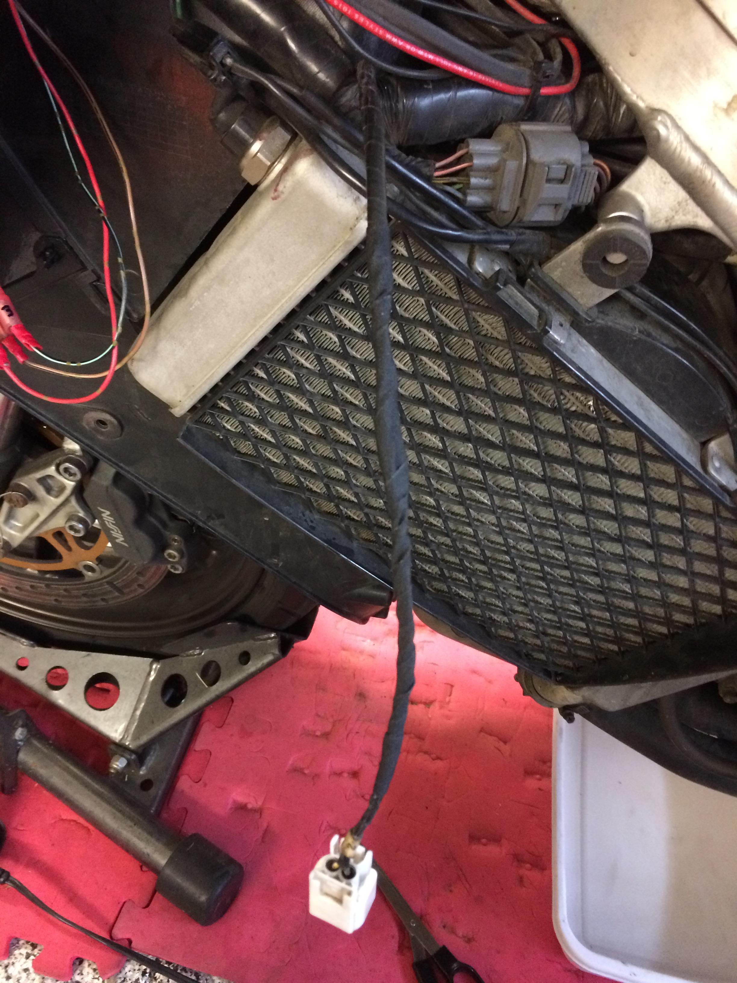

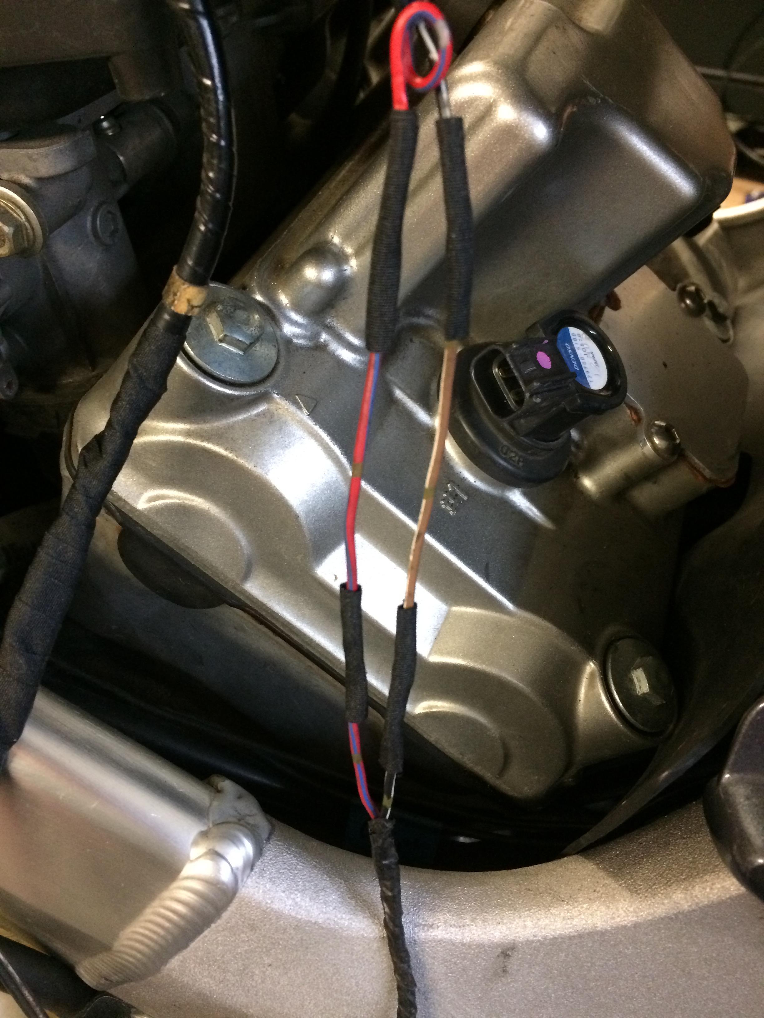

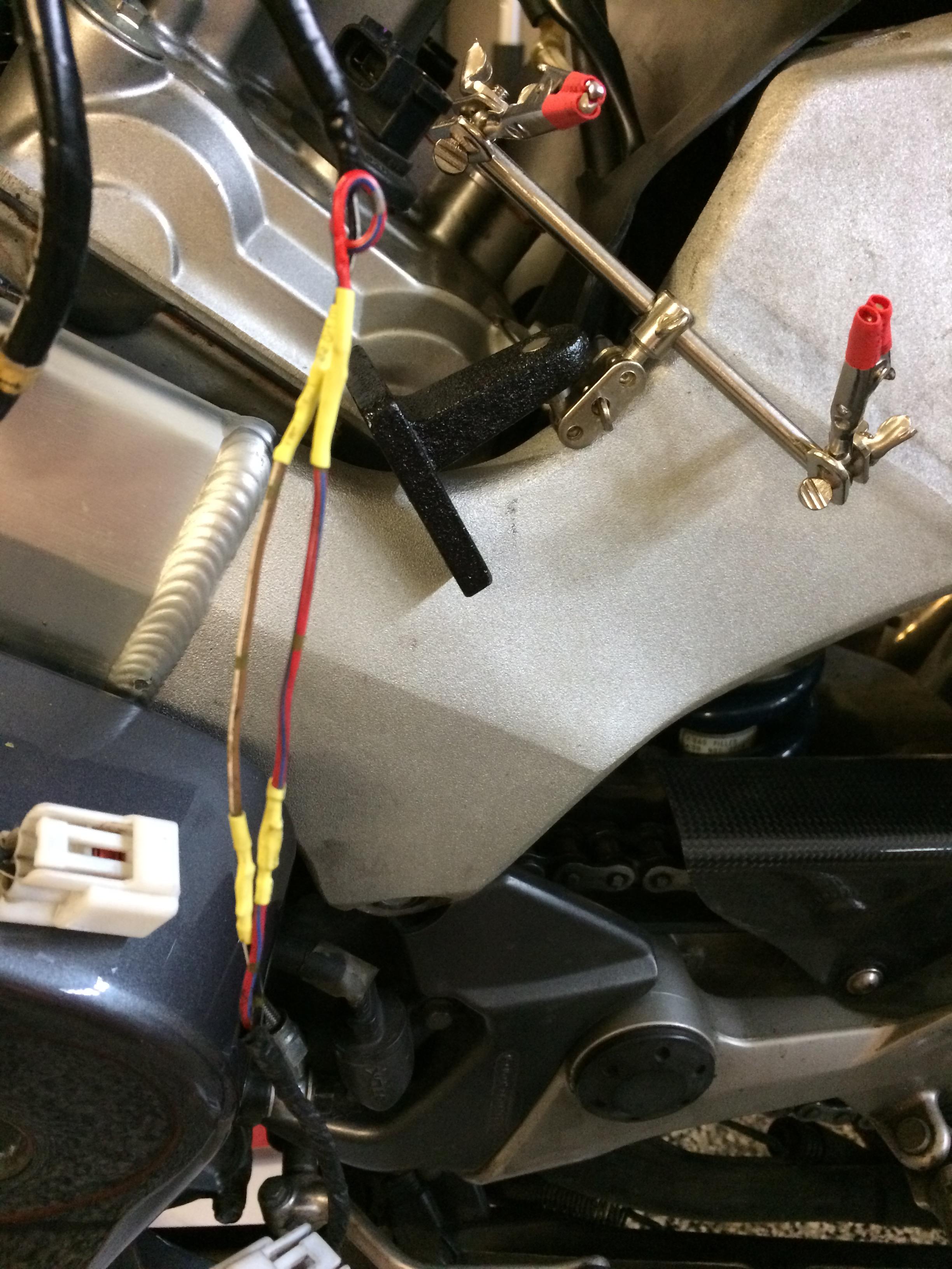

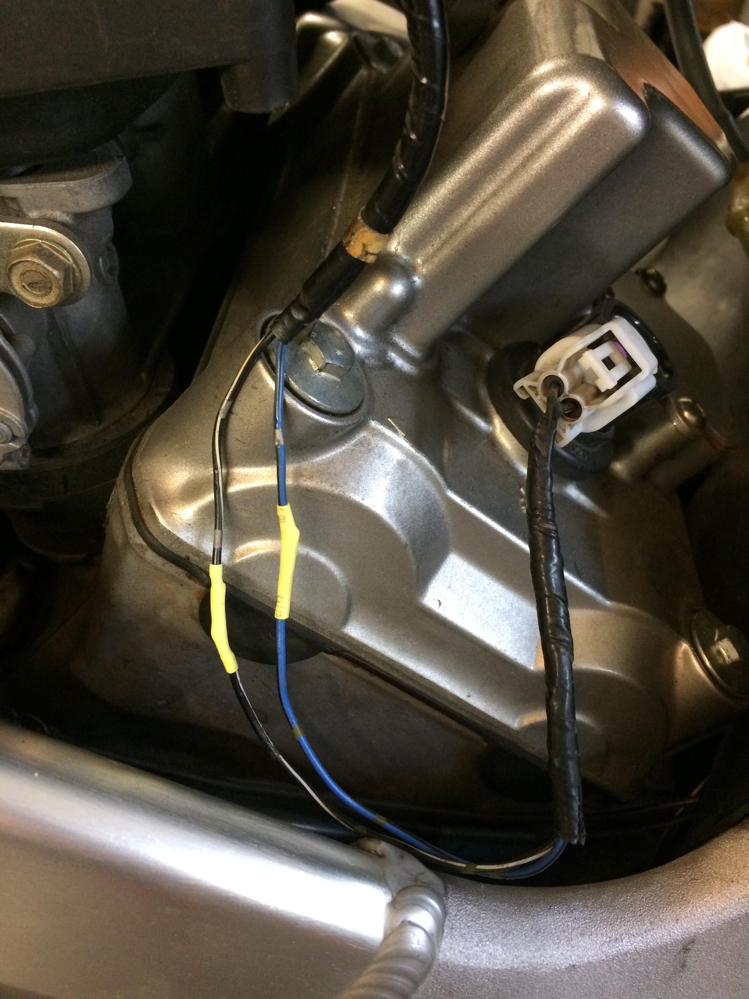

Got it fully finalized today. I bought some better soldering gear and heat gun for heat shrink tubing so I could permanently join the CBR plugs to the VFR harness.
#3 wire was a tad short making it tighter than I wanted, so I added some length. I have most of a ZX636 wiring harness and found one wire to match. The other will have to be brown...
I found some fancy high temp resistant tape used by auto manufacturers for under hood wiring.(Tesa 51036, btw) Figured it was worth a shot. More like a cloth than traditional stretch electrical tape. I still suck at wrapping, though...
I didn't trust my jenky soldering to not eventually poke through the heat shrink, so I gave each one a wrap of tape.
Starts on the button, as they say. Actually better than it had been recently. It was taking 2 pushes when cold, now it fires right up with the first push! I'll probably change the plugs at some point soon-ish. I don't remember how long they've been in there.

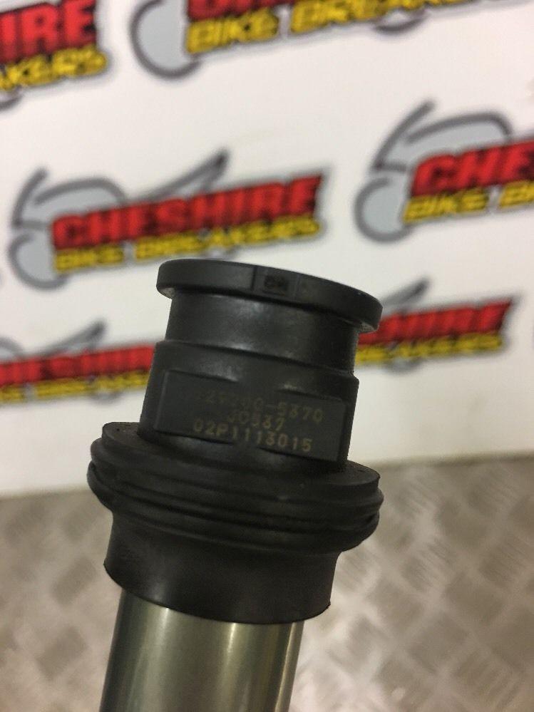

I posted this in my refurb thread already, so if you've seen it before apologies. I completed my COP swap recently and this thread was an excellent guide. I chose to use the boot/seal over the top style COP's common to GSXR's and, like others, found the length/plug engagement/and seal to work seamlessly on the VFR. One tip - I pulled the rubber seal and installed it first, then inserted the coil second. This ended up meaning the seals sat a bit lower on the coil, just below the notched area they sat in originally. The fit around the coil is a little tighter because of this, and the seal over the plug tunnel is very positive as well. We will see if they move around, I haven't had the bike back on the road yet. Here is a pic of the part #, thanks everyone for sharing the info:

Denso part number means like this ? 129700-5370
I searched some time ago and got the same pn. 129700-5370
That's the one--thanks, both.

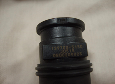

I saw an eBay ad for one recently (but not the pn. view) and it definitely looked like a Denso CoP.  The Denso part numbers all begin with 127900, but 5370 is not one I've seen before (or measured).  It looks like a CBR1000RR CoP, which is pn. 5150 (which is the same length as a 4400), but the grommet appears to be significantly wider--which would help "internal" sealing in larger valve cover openings.  Here is a picture of a 5150:
