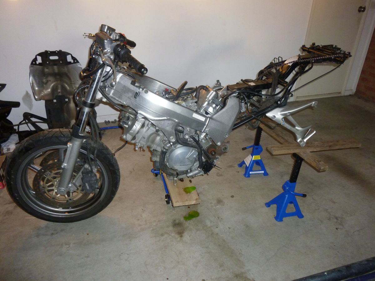

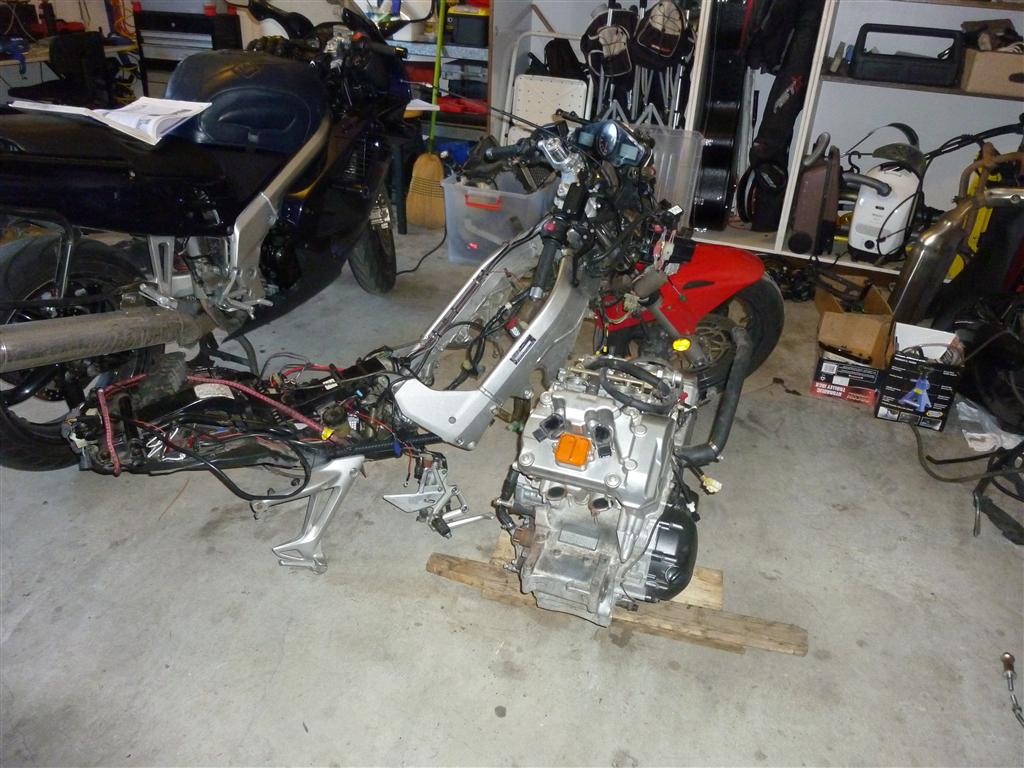

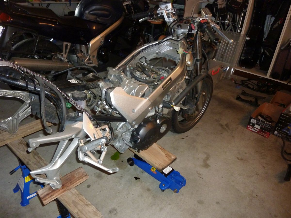

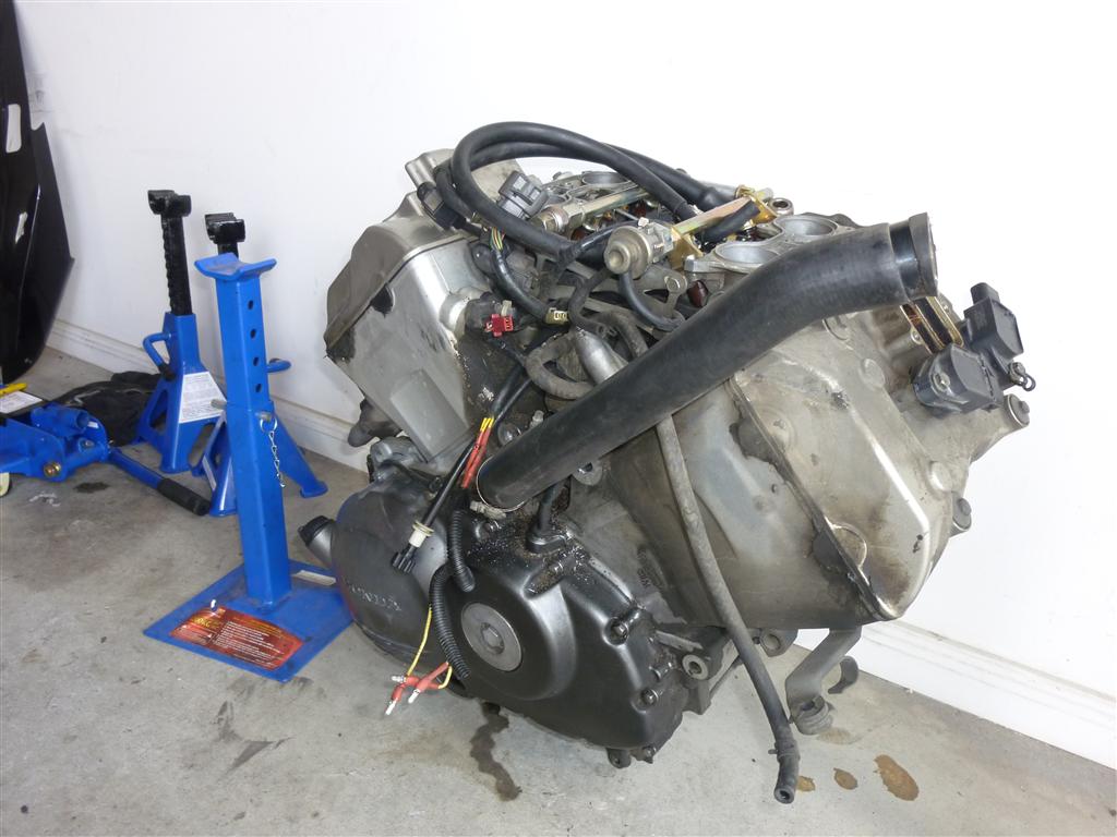

Member Contributer kaldek Posted August 24, 2011 Author Member Contributer Posted August 24, 2011 Righty-o, I've got the old motor out of the 2002 frame. I even did it by myself, without a jack. I just knocked the forks up through the triple clamps and lowered the bike down, then took the last bolt out of the motor. It was a close thing - much harder with the wiring harness in the way! I did notice though that either the new bike was missing some engine mount spacers, or I forgot that I took them out. If not, it appears that the new bike has had the engine out before, or it's a different engine than what I'm expecting...... Hmm, I wonder if there's an easy way to tell if the engine number is the original one that came with the frame? Quote
zRoYz Posted August 24, 2011 Posted August 24, 2011 Righty-o, I've got the old motor out of the 2002 frame. I even did it by myself, without a jack. I just knocked the forks up through the triple clamps and lowered the bike down, then took the last bolt out of the motor. It was a close thing - much harder with the wiring harness in the way! I did notice though that either the new bike was missing some engine mount spacers, or I forgot that I took them out. If not, it appears that the new bike has had the engine out before, or it's a different engine than what I'm expecting...... Hmm, I wonder if there's an easy way to tell if the engine number is the original one that came with the frame? Looking at the 02 & 06 frame parts the spacers are the same, they are numbered differently but use same part numbers, you will know if there are spacers you can't remember if you look around your garage you should have 2 of everything. http://www.powersportsplus.com/parts/search/Honda/Motorcycle/2002/VFR800+AC/FRAME/parts.html http://www.powersportsplus.com/parts/search/Honda/Motorcycle/2006/VFR800+AC/FRAME/parts.html The only way to know if engine was swaped which is unlikely is do a full registry check which will cost you & see if engine number matches VIN number on record, if it does it will tell you original motor or there will be a listing motor changed, if it doesn't match then motor was changed but not recorded with registry. Quote
Member Contributer kaldek Posted August 24, 2011 Author Member Contributer Posted August 24, 2011 The only way to know if engine was swaped which is unlikely is do a full registry check which will cost you & see if engine number matches VIN number on record, if it does it will tell you original motor or there will be a listing motor changed, if it doesn't match then motor was changed but not recorded with registry. Yeah, I did a vehicle status check - the engine number is registered to the VIN so either it's the original motor or the previous owner (prior to the smash) had it swapped out. Unlikely given the low kilometres on it. I must just have misplaced them! Quote

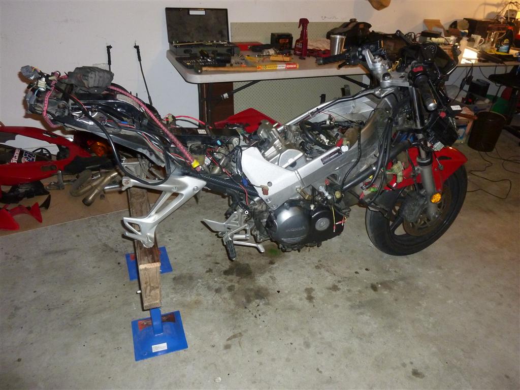

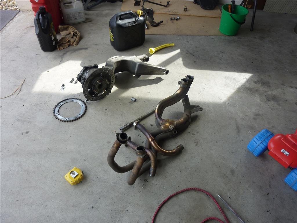

Member Contributer kaldek Posted August 26, 2011 Author Member Contributer Posted August 26, 2011 OK new engine is in the old frame - did it myself without a jack! The bike is now slowly being put back together. Of course, I forgot to put the chain back on when I installed the swingarm. Do I bother taking it off again or just buy a new link? Decisions, decisions.... Quote
Member Contributer kaldek Posted August 26, 2011 Author Member Contributer Posted August 26, 2011 Of course, I forgot to put the chain back on when I installed the swingarm. Do I bother taking it off again or just buy a new link? Decisions, decisions.... Gah, nobody has any link pins in stock. Looks like the swingarm's coming off again. Quote
zRoYz Posted August 27, 2011 Posted August 27, 2011 Of course, I forgot to put the chain back on when I installed the swingarm. Do I bother taking it off again or just buy a new link? Decisions, decisions.... Gah, nobody has any link pins in stock. Looks like the swingarm's coming off again. If an x-ring or o-ring you can buy any brand chain link that is that type to replace & even if they order your looking 3 days max so can be the last thing you do as I'm sure there is enough stuff to do until then. But as you have had swing arm off it would be easy to remove again. Quote
Member Contributer KevCarver Posted August 27, 2011 Member Contributer Posted August 27, 2011 Damn man, 5th gen you can leave it on... Quote
Member Contributer kaldek Posted August 27, 2011 Author Member Contributer Posted August 27, 2011 It's alright. Only took me 5 minutes in the end! I even left the shock connected. Quote
Member Contributer kaldek Posted August 27, 2011 Author Member Contributer Posted August 27, 2011 OK, bike is running. Won't speak for how well it's going - I'll wait until I've ridden it before making any calls. Couldn't fit the Motad headers back on though, as the downpipe gaskets were all chewed up and the fitment was always tight to begin with. I'll need new gaskets so in the meantim I fitted the stock headers from the new bike, which kinda sucks because they're so darned quiet!! Quote

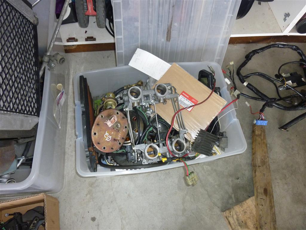

Member Contributer kaldek Posted August 27, 2011 Author Member Contributer Posted August 27, 2011 you gonna have a VTEC yard sale afterwards??? Hells yeah. There's the new fuel tank, the ECU and keys from the old bike, a whole bunch of stuff to hit eBay. Roy already claimed the ducktail too. Quote
Member Contributer kaldek Posted August 28, 2011 Author Member Contributer Posted August 28, 2011 It's done. I've ridden it, and she's OK. Mentally, I'm shattered. In 9 days of my free time I have completely disassembled two VFR800s and built one back up with all the electrics and mechanicals (swingarm included) of the new one. The new motor has a much better clutch - I've had to adjust my lever out for the first time in four years. It may also have a stuck open thermostat - not fully sure about that yet as it's a warm day. Quote

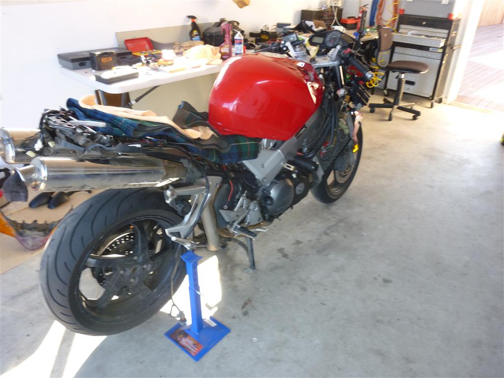

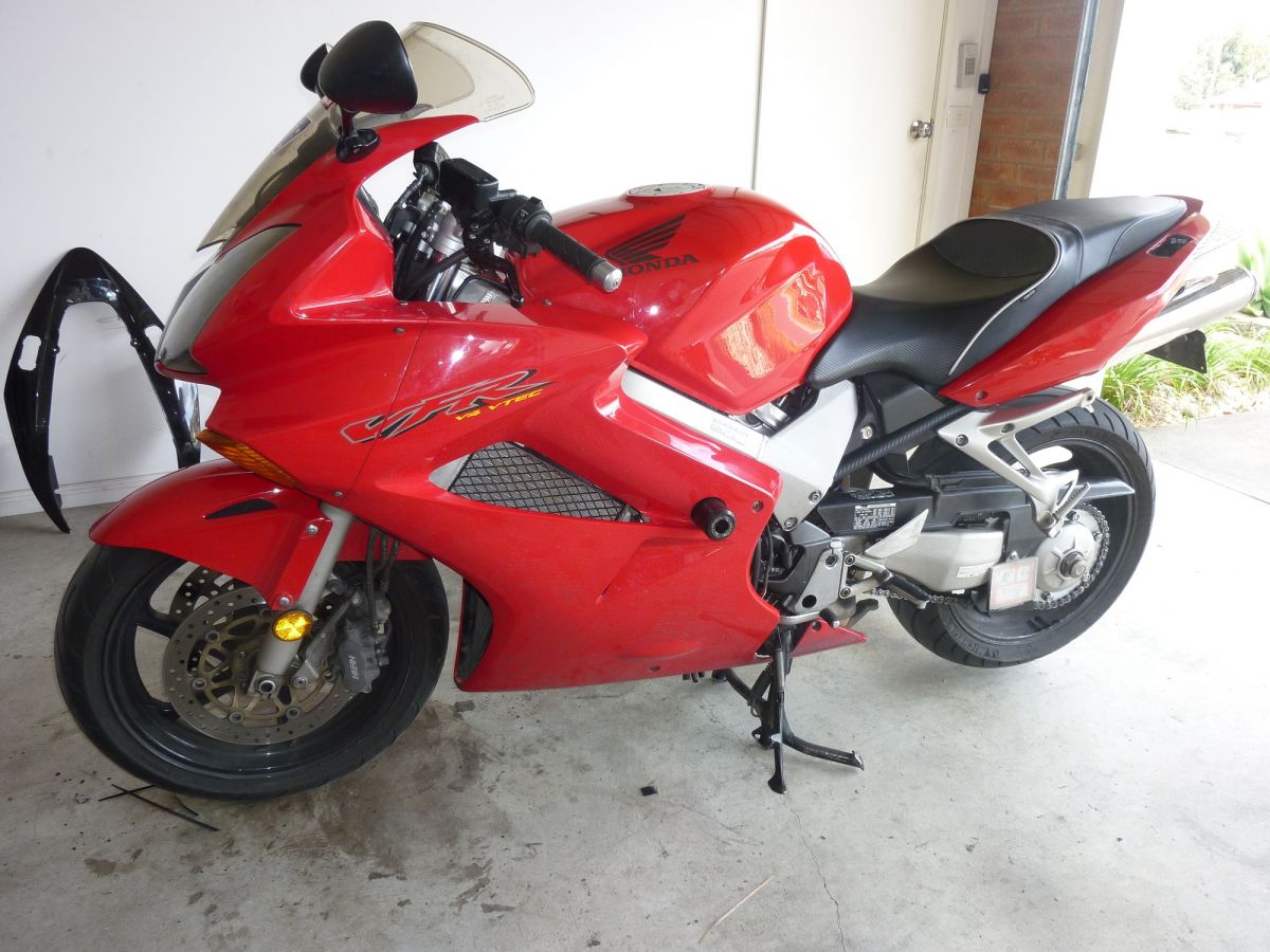

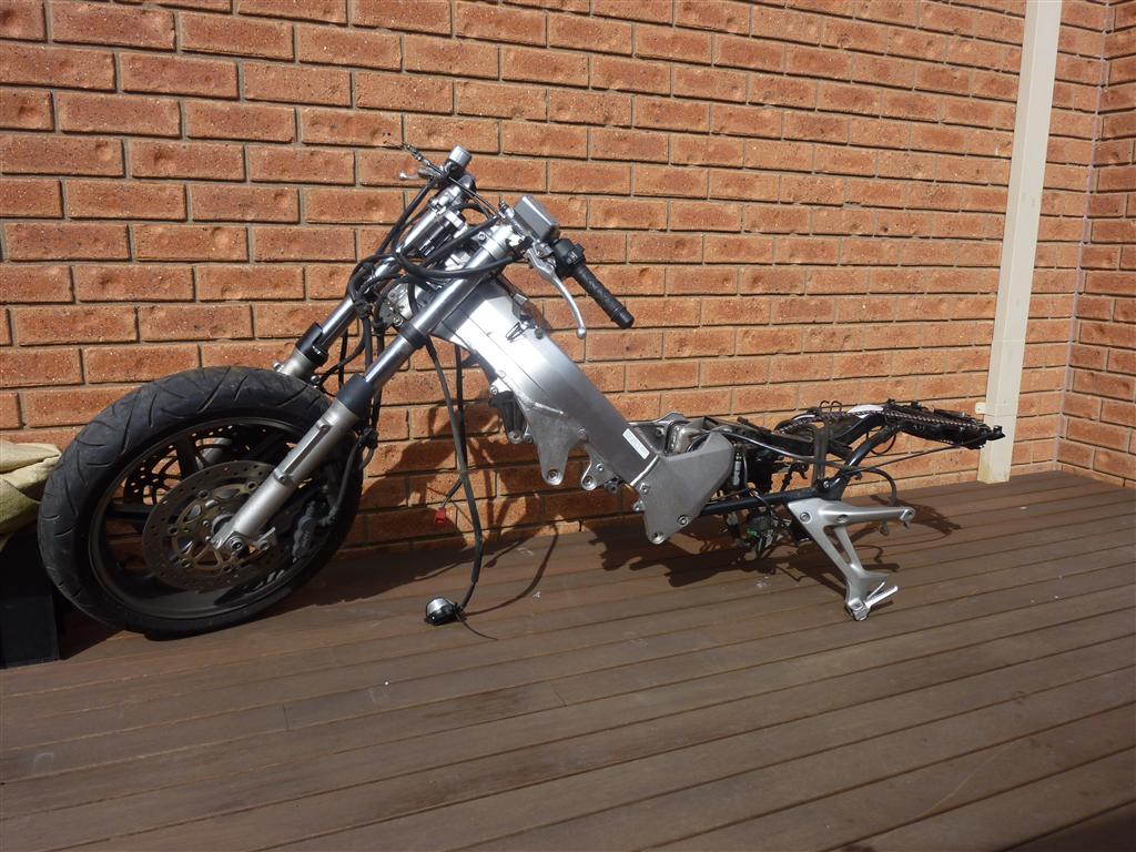

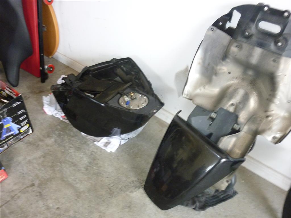

Member Contributer kaldek Posted August 28, 2011 Author Member Contributer Posted August 28, 2011 My bike before teardown New '06 stripped-right New '06 stripped-left New bike ready for the motor to drop out New bike still waiting for the motor to be dropped I toyed with the idea of using the jack for a while My bike ready for the motor to drop New motor, old frame. Soon to be together! All done? Anyone want a chopper? My poor Motad's couldn't be used for now. Parts, anyone? Plenty of spares forever more... What to do with the old motor? For sale! Quote
