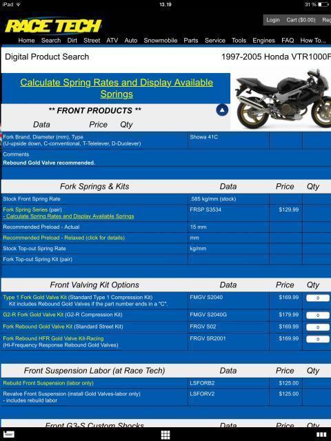

VfrViddy Posted July 21, 2015 Posted July 21, 2015 yo.. ok now I have the knowledge I need, I think. I did the DVS (Digital Valving Search) on Race Tech and recomended shim stack for me is c35 I'm 208 pounds. so.. what do you think Terry? should I also re-shim the rebound piston? Quote
VfrViddy Posted July 21, 2015 Posted July 21, 2015 Oh yea.. Oil level recomended was 140mm. Any reason you did not use gold valve on the rebound Terry? And.. Not shure if i should drill the hole or not. I'm thinking not, as that only counts for the forks without rebound adjusting? Or? Quote
